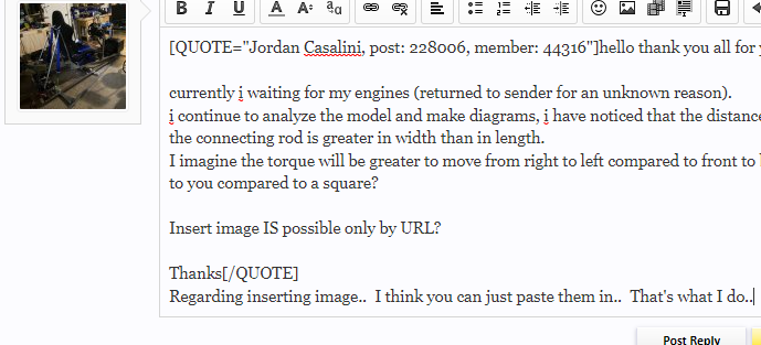

    Regarding inserting image.. I think you can just paste them in.. That's what I do.. and did right here.. Try it upload_2022-5-24_18-14-27.png

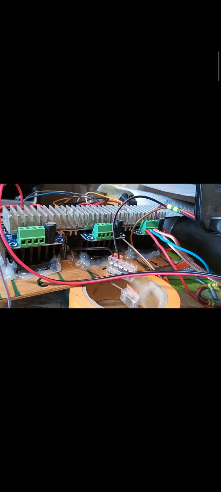

    Nice progress! I like that someone is testing with both 12 and 24.. Cool idea.. BTW before you really put a load on those IBT-2's you will want to mount a fan to blow on the heat sinks. I have not smoked any myself but I would rather be safe than 'waiting for another IBT-2' .. DMAX

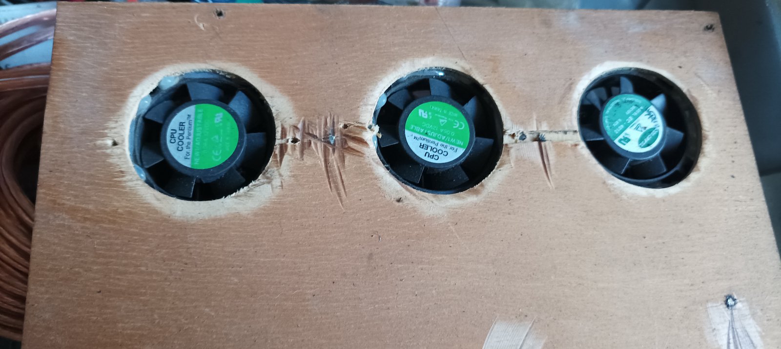

    Hi
    yes I heard it heats from 24v I added 3 fan and a second heater.
    Screenshot_2022-05-25-08-49-42-926_com.miui.videoplayer.jpg IMG_20220525_091144.jpg

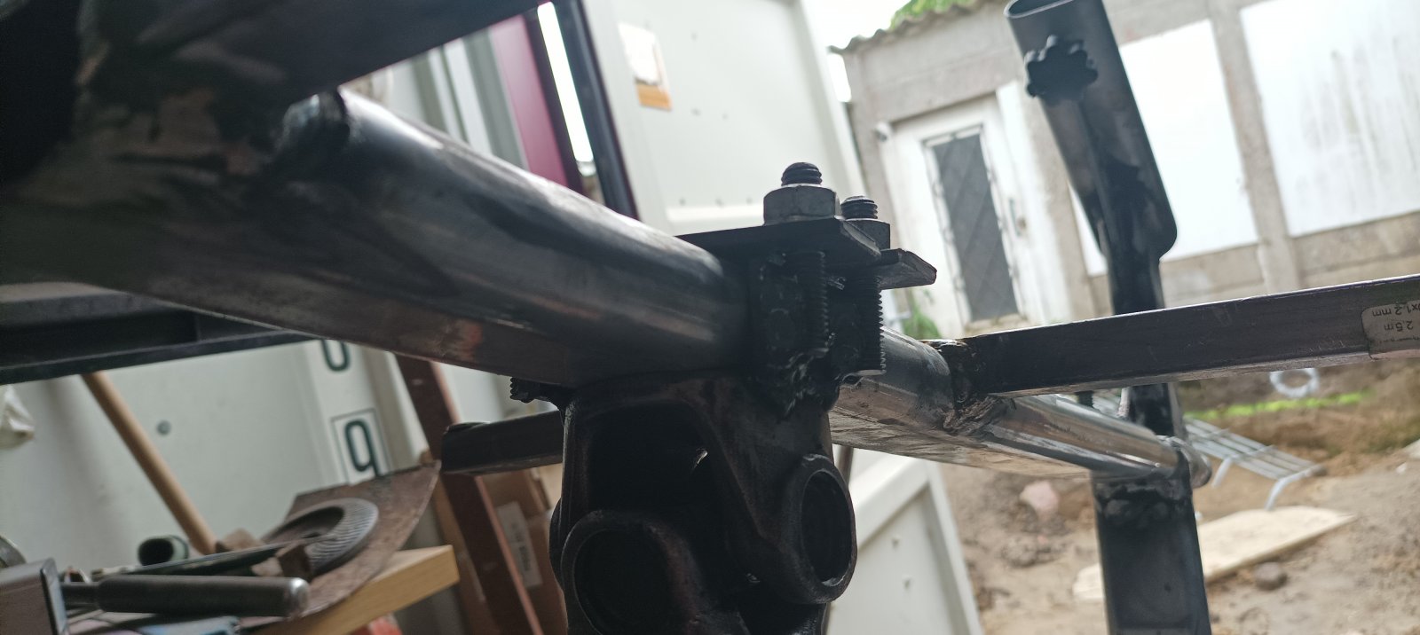

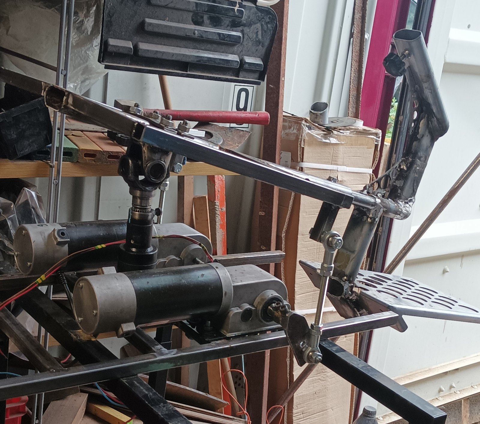

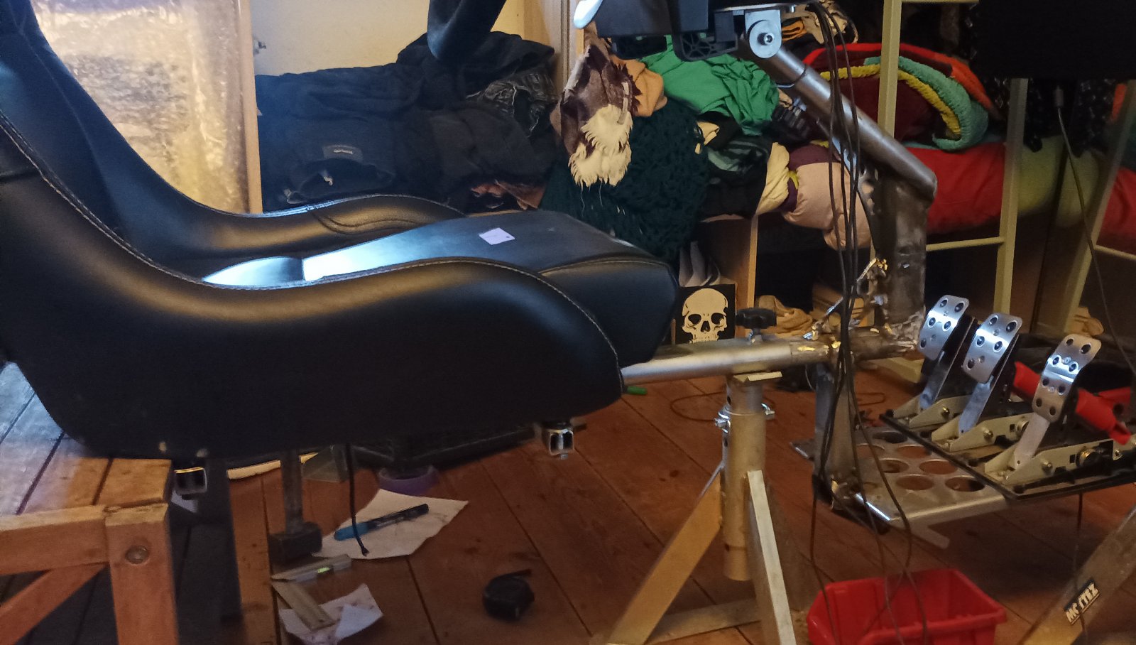

    hi
    i have finished modifying the playseat
    i am quite satisfied with the position much more realistic than original.
    i bolted the gimbal in order to be able to modify the position if necessary (once everything is installed i will check the center of gravity and adjust if need )
    i still need to install simtool and start tuning

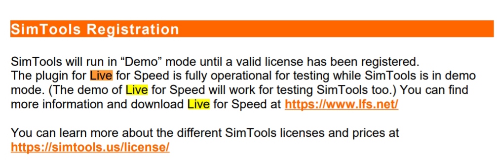

    i am installing live for speed
    i read that the plugin was provided in the simtool demo (2.5.1).
    but i see that there is still a plugin available which specifies the use of the loss of traction
    I have not yet installed the loss of traction on the simulator I would like to try part 2 dof already...should I download the plugin?

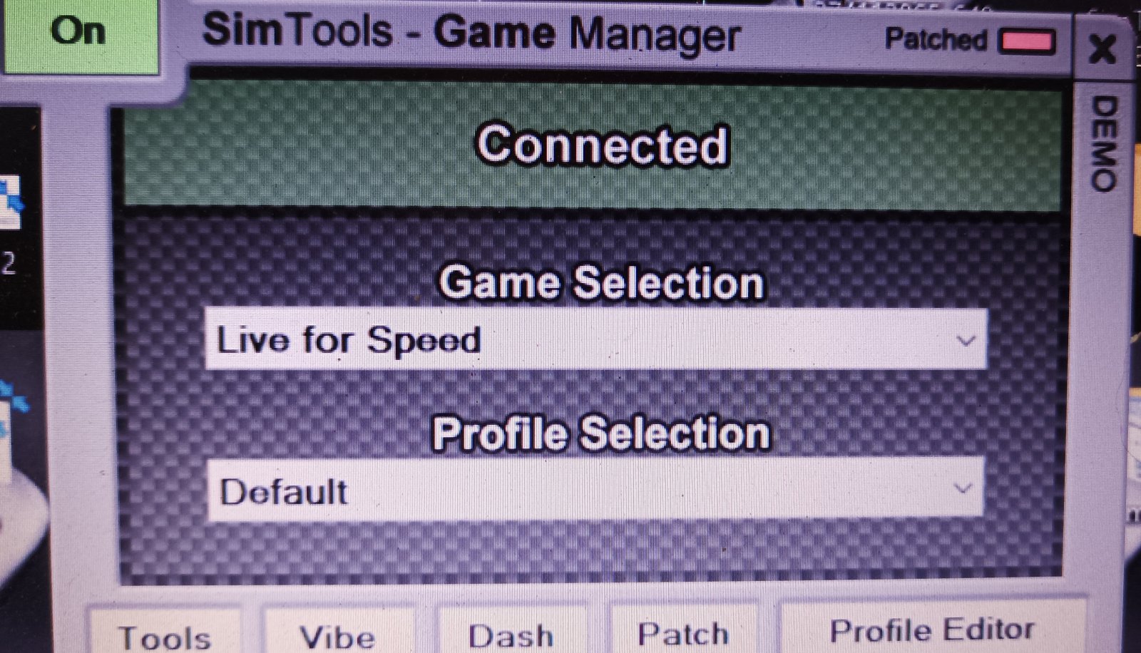

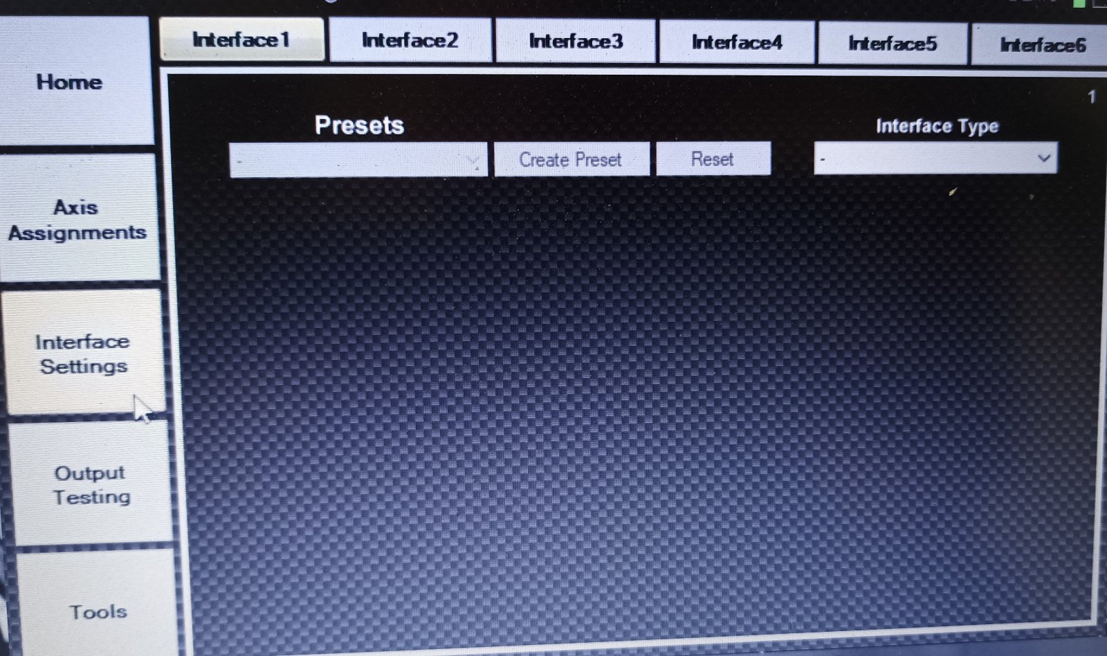

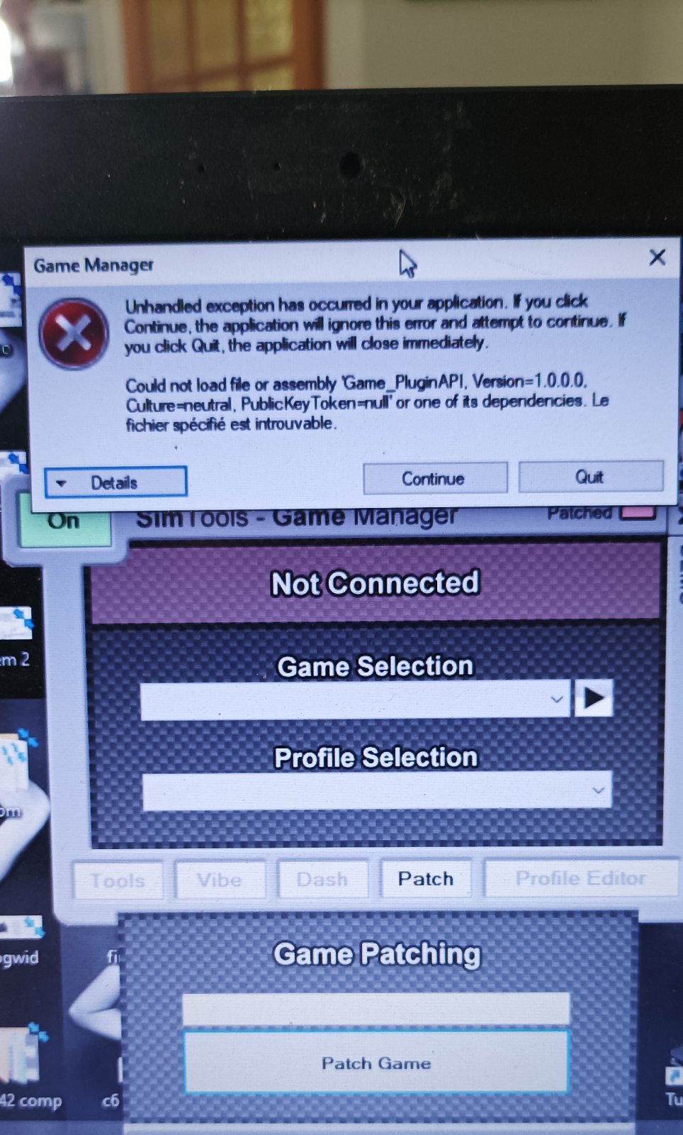

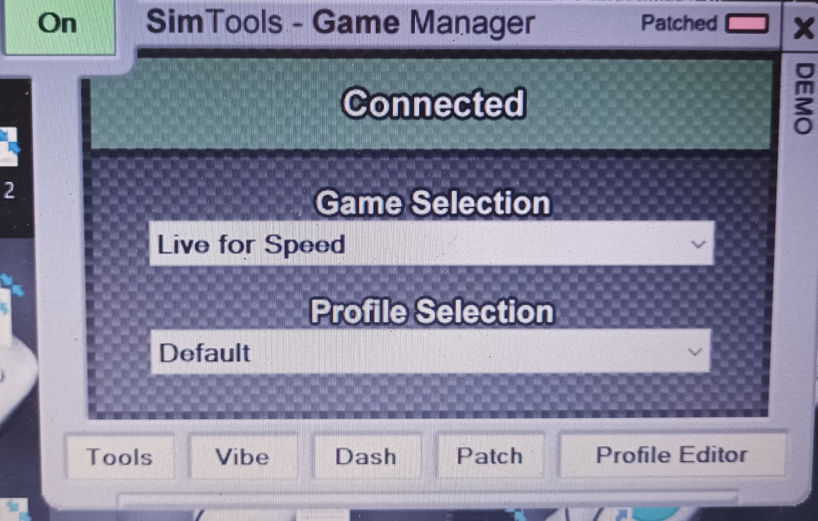

    I installed lfs and rolled a few turns on the keyboard...
    I wanted to start setting up simtool but in game engine interface settings everything is greyed out... do we have to have a license to try simtool with lfs?

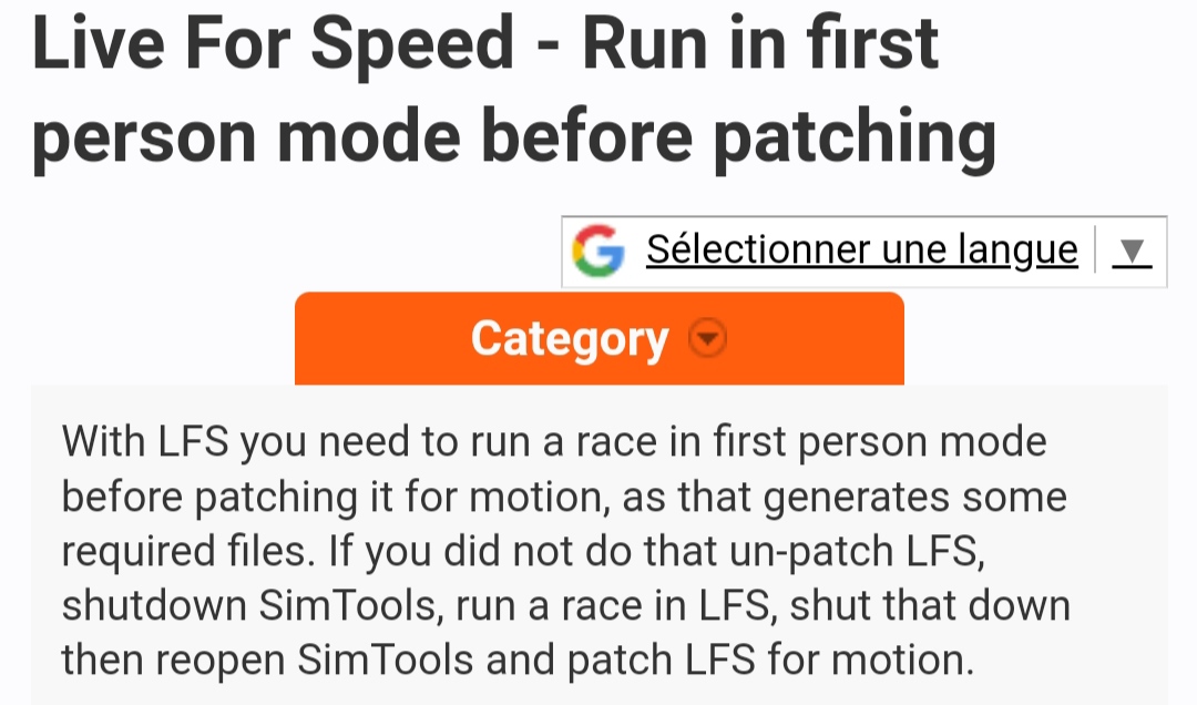

  13. noorbeast
    22,185
    154,750Coins
    +11,196 / 57 / -2
    Interface Type should be a drop down to select the type of hardware used. If it is greyed out something is wrong, try running SimTools as admin (should not be necessary), and if needed reinstall SimTools.
    Use the included plugin to get started, LFS needs to be run before patching it for motion: https://www.xsimulator.net/communit...run-in-first-person-mode-before-patching.365/
    Grab a copy of the SimTools manual and keep it handy for reference: https://www.xsimulator.net/community/faq/rtfm-start-with-the-official-simtools-documentation.117/

    +18 / 0 / -0
    so i uninstalled then reinstalled simtool following the pdf as the first time...
    i get the same result interface settings and greyed out.
    opening as administrator has no effect
    before i can set it must use the plugin but how to know if it is included and selected?

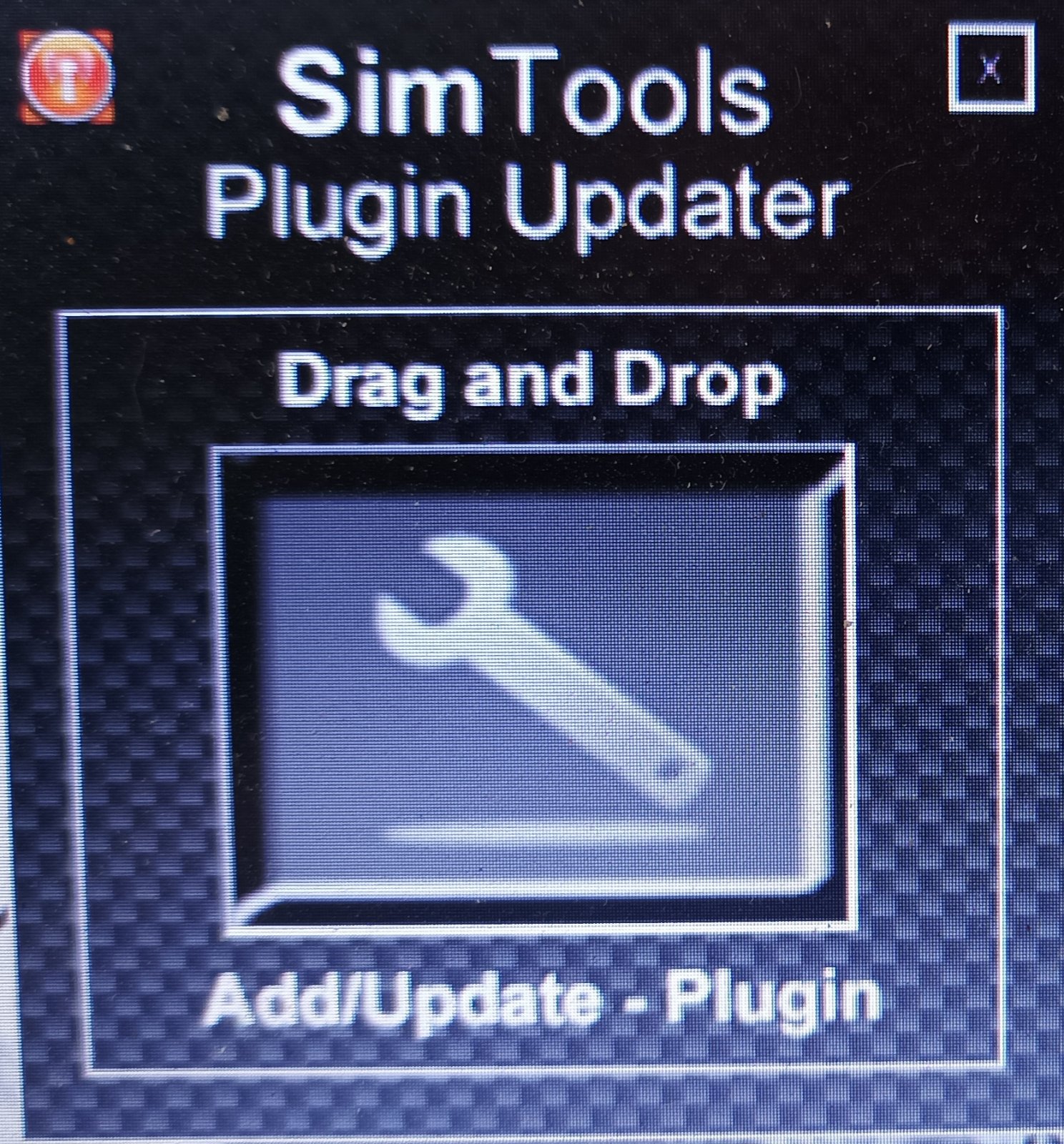

    Simtool plugin IS empty (drag and drop is written)

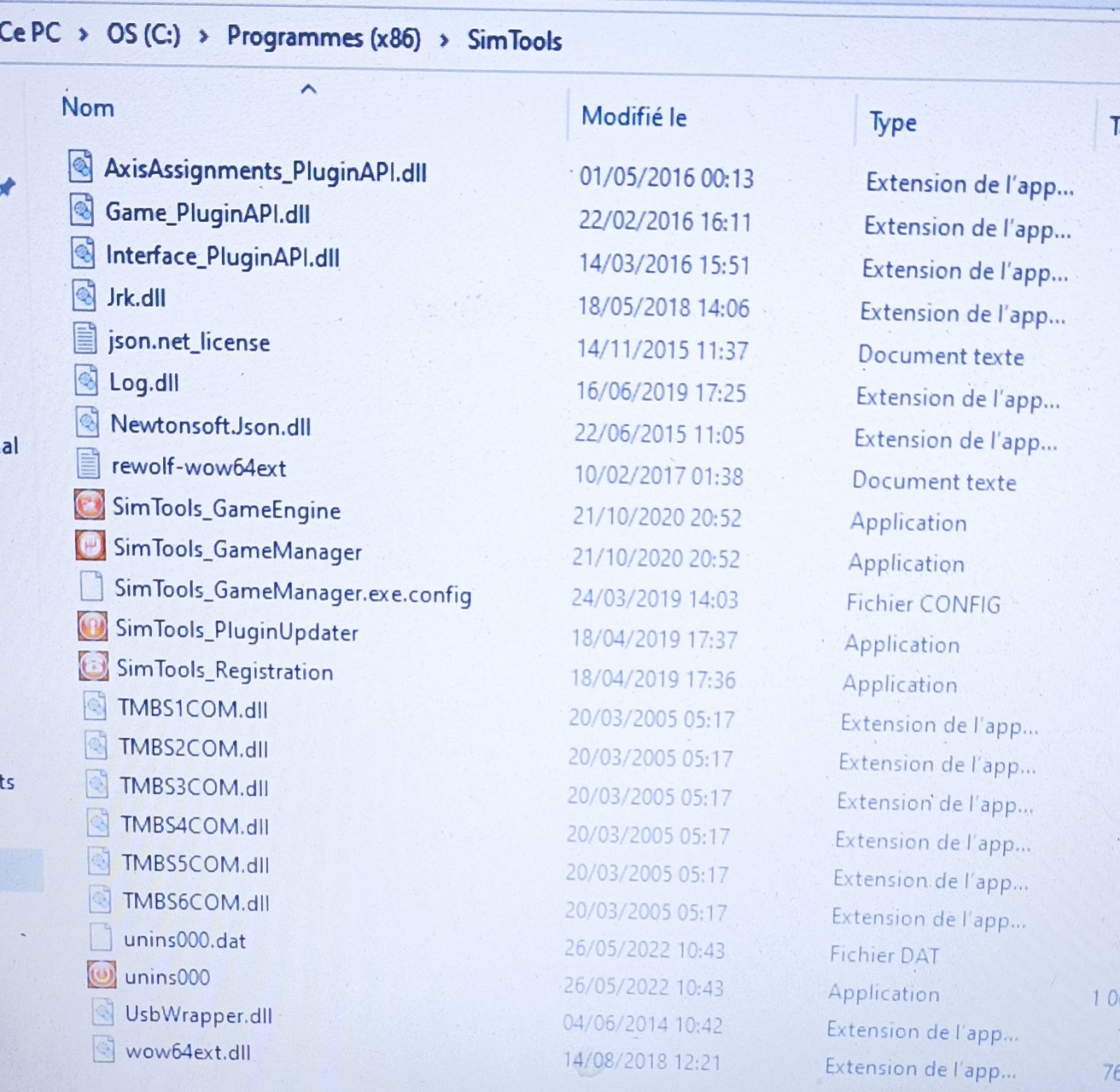

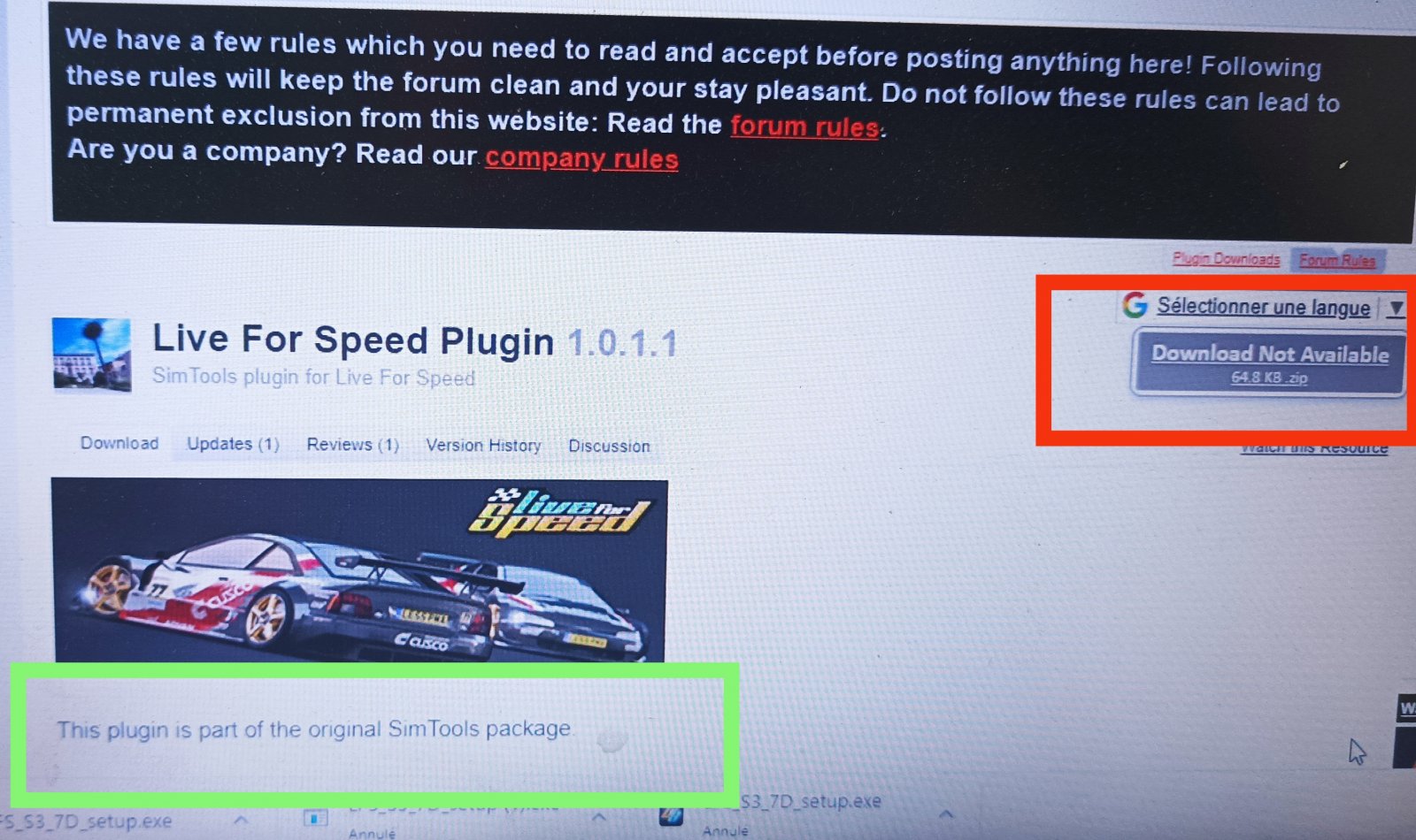

    I tried to patched
    it asks me to select the location (which I don't know)
    I click on simtool but it does not open the file from game manager.
    I have been manually open simtool
    I have drag and drop the plugin api file but it was not the solution...
    I now have to reinstall.
    where to find this plugin included for patched?
    I'm going to continue to advance the chassis.. I'm going crazy not to succeed in everything it's something that looks so simple written here :blush

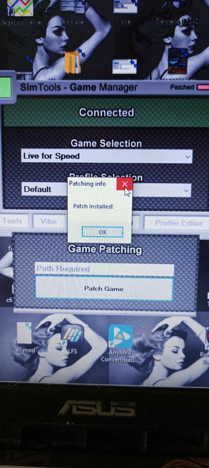

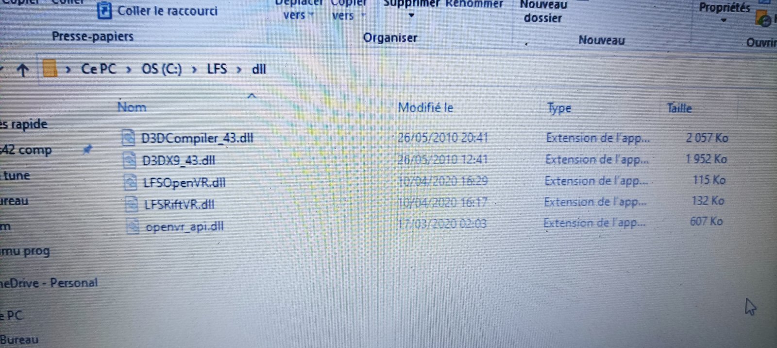

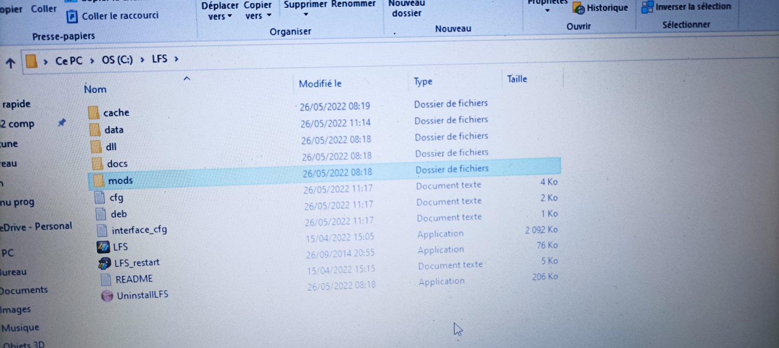

    I'm going to give exactly the details of what I'm doing.
    -Download Simtool 2.5.1.
    -Install it.
    At this stage game manager is on, connected and not patched.
    -I close Simtool and run on lfs.
    (Solo with keyboard)
    I don't no what does it mean first person
    -Then I click patch, patch game, he asks for direction of plugin.
    I don't know where it is
    I read that it was in the "simtool pack".
    It's not possible to download.
    I don't know if having done a lap with lfs created a file where it should be or this name.
  17. noorbeast
    22,185
    154,750Coins
    +11,196 / 57 / -2
    First off @yobuddy can you please advise why options seem grayed out?
    @Jordan Casalini you do not need to install the LFS plugin, it is already installed with SimTools.
    The patch path is where you installed LFS, If you don't know right click on the LFS launcher and check its properties to find the path.
    When you do want to get all the plugins you want then use 250 of your forum activity coins here, that will give you a week to download all the plugins you want to: https://www.xsimulator.net/community/shop/
    It is a good idea to set the computer to English Local, as there is a known bug: https://www.xsimulator.net/community/faq/simtools-language-setting-bug-change-to-english-local.233/

    Your patch path is C\LFS
