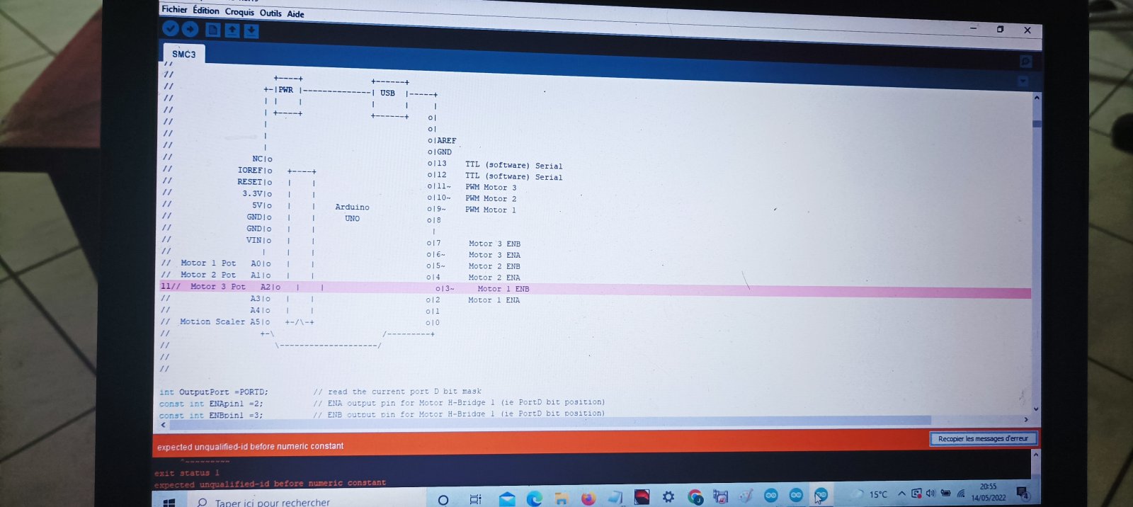

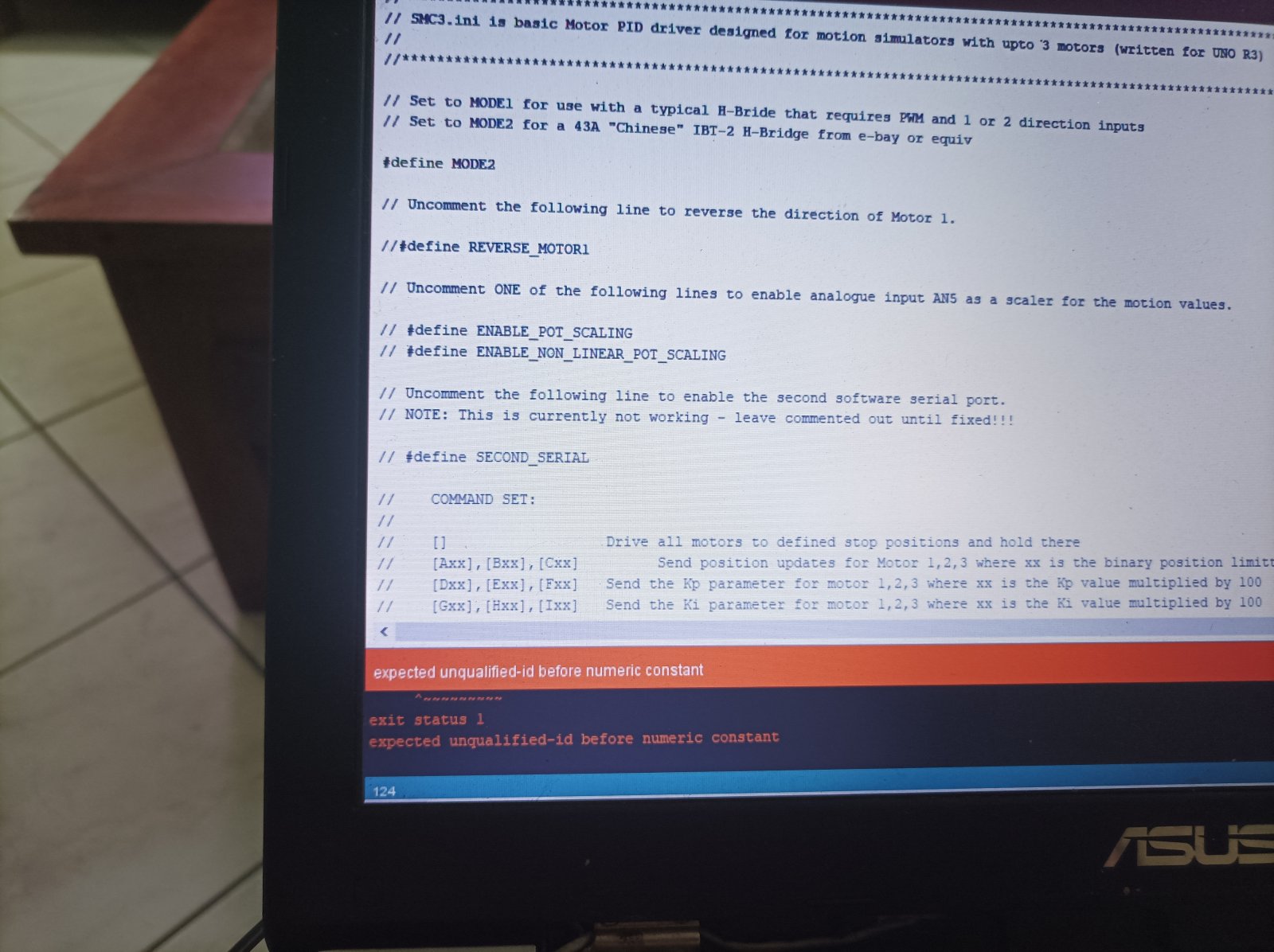

    my project is progressing slowly and i thought it was time to install smc3 on the arduino while waiting to receive the ibt-2 power cards. i can't install despite having followed this video tutorial
    The only difference is that I wrote #define mode 2 instead of mode 1 as read here for ibt-2
    22,045
    153,866Coins
    +11,153 / 57 / -2
    Is the Arduino IDE configured in its settings for your Uno and correct port?
    Do you get any error messages and if so what are they?

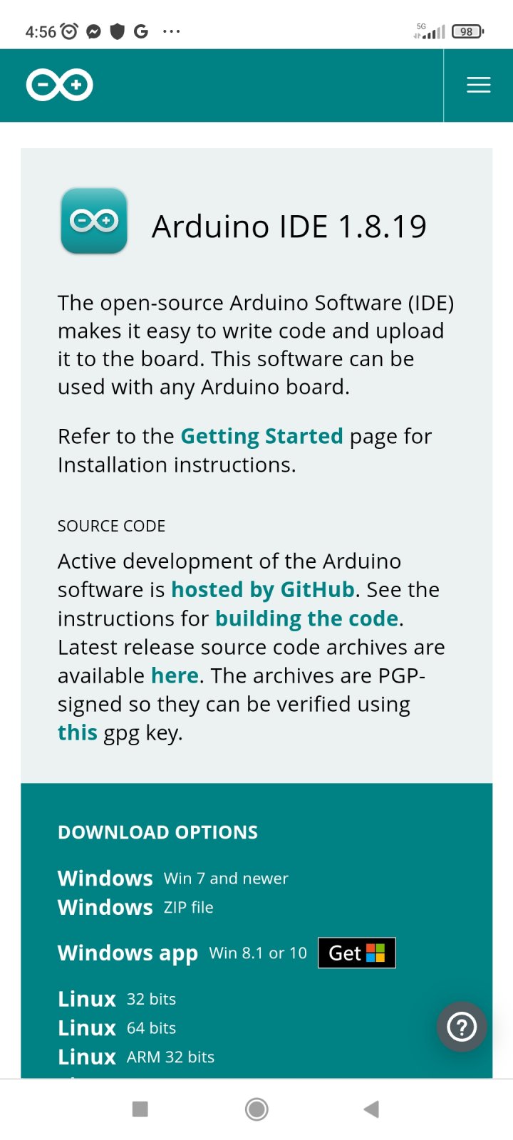

    Hi thank you for your help.
    I used the latest version (for all Arduino).
    I followed the port procedure (modified to 5 for me).
    I will try again...

    I used NEW VERSION SMCUtils v1.01.zip AVAILABLE 29 Sep 15 ...
    I'm at work right now,I'm starting again as soon as possible, in the video it goes very fast and downloads all the versions I certainly missed something...
    22,045
    153,866Coins
    +11,153 / 57 / -2
    There is the actual SMC3 guide: https://www.xsimulator.net/communit...3dof-motor-driver-and-windows-utilities.4957/
    And possible alternate video guides: https://www.xsimulator.net/community/threads/new-video-on-explaining-what-i-know-about-smc3.17092/
    Likely further context about what you have, or have not done, is needed to figure out what went wrong for you, given how many members successfully use SMC3.

    Hi
    after the 10th try I deleted everything and started again...
    And I think it's good (I did the exact same thing again but it worked this time)
    Thanks for your help

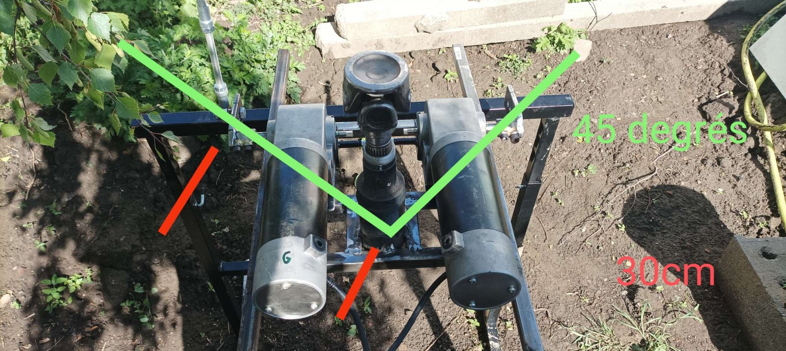

    hello here is the progress of the project.
    the gimbal is fixed in the center of a circle of 30cm radius, the middle of the crank arms is at 45 degrees at 30cm from the gimbal.
    the cranks are 6cm, the height of the gimbal and connecting rods IS adjustable for modeling.

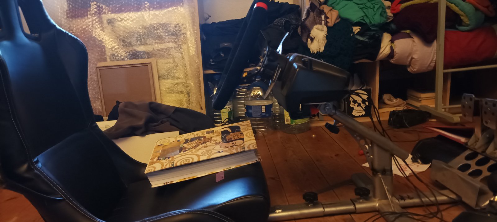

    I continue the chassis and as I already have the "playseat" I thought of using it.
    after some diagrams either put the seat in the same place and I modify the fixings of the pedals and the steering wheel..
    or I use it like that with the seat higher.
    I started in this direction but I don't know if I'm doing it right... your opinion interests me
    Like i have starting
    If the Seat down
    in this case should lower the pedal and the direction, I wonder if it is not preferable the gimbal already increasing the height..

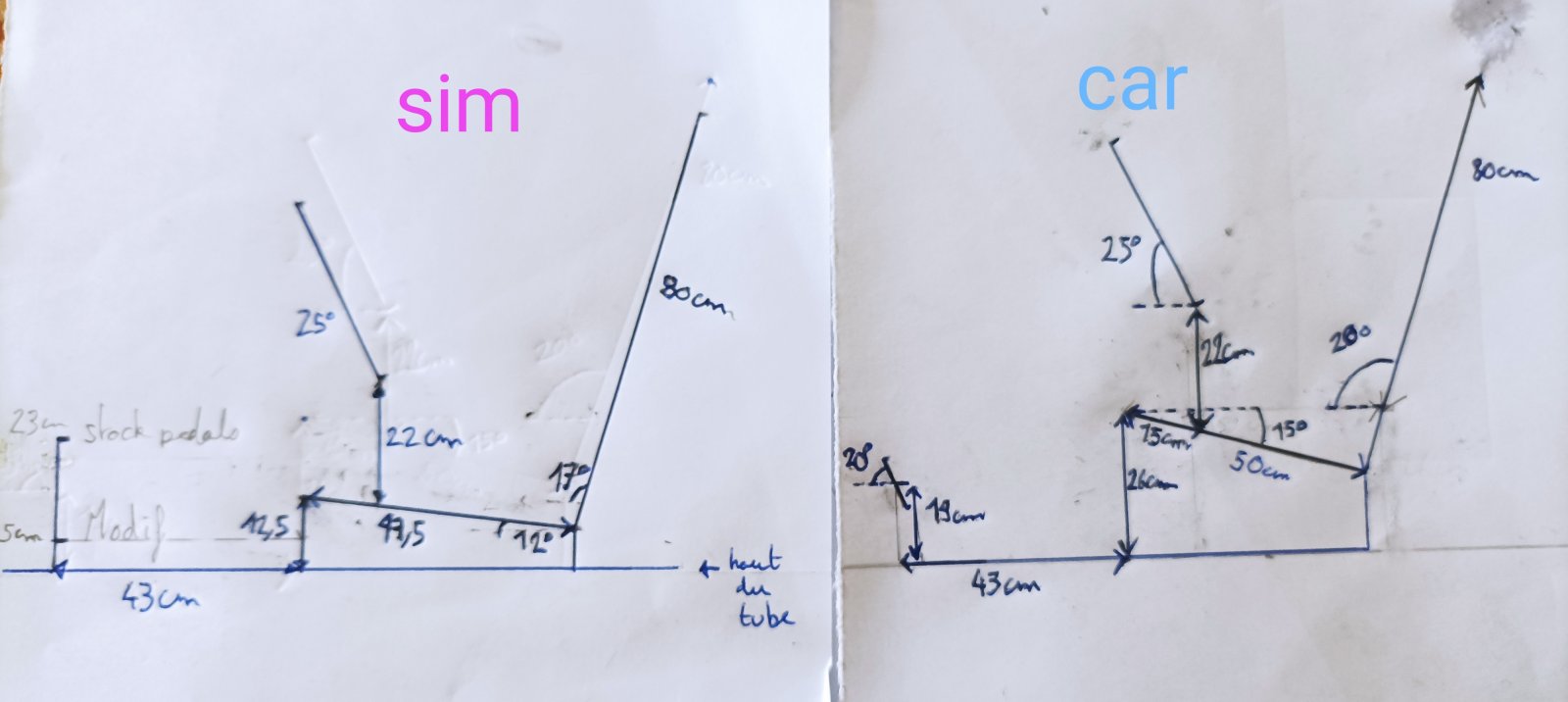

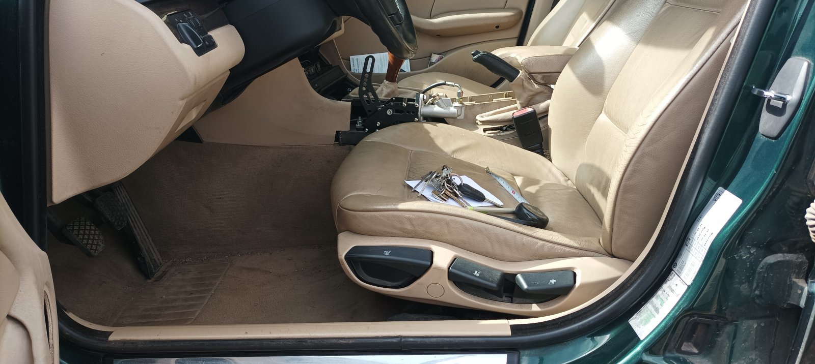

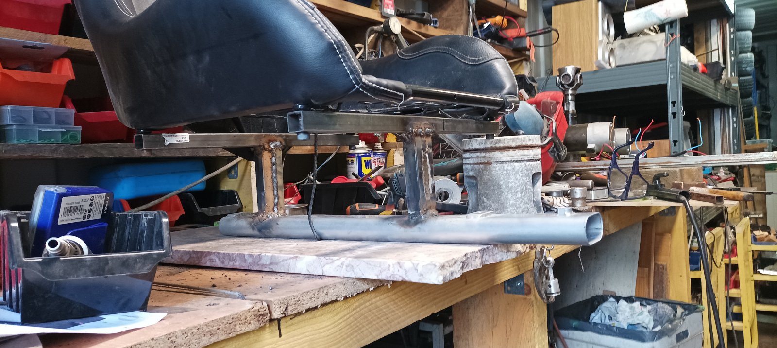

    +18 / 0 / -0

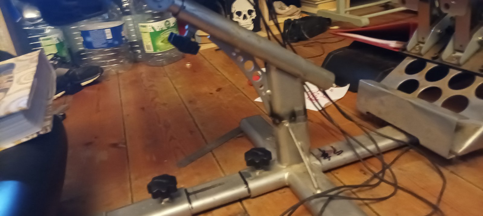

    hello
    I started to modify the playseat
    I took the opportunity to measure where everything is placed on my car...
    I would like to keep the seat fixed and be able to adjust only the pedal and the steering wheel

    the steering wheel has been lowered by cutting and resoldering the tube (-14cm)
    for the pedals the dimension is still original (too high must be lowered by -18cm).
    I will take this opportunity to increase the angle of inclination of the des pedals which is original by only 5 degrees.
