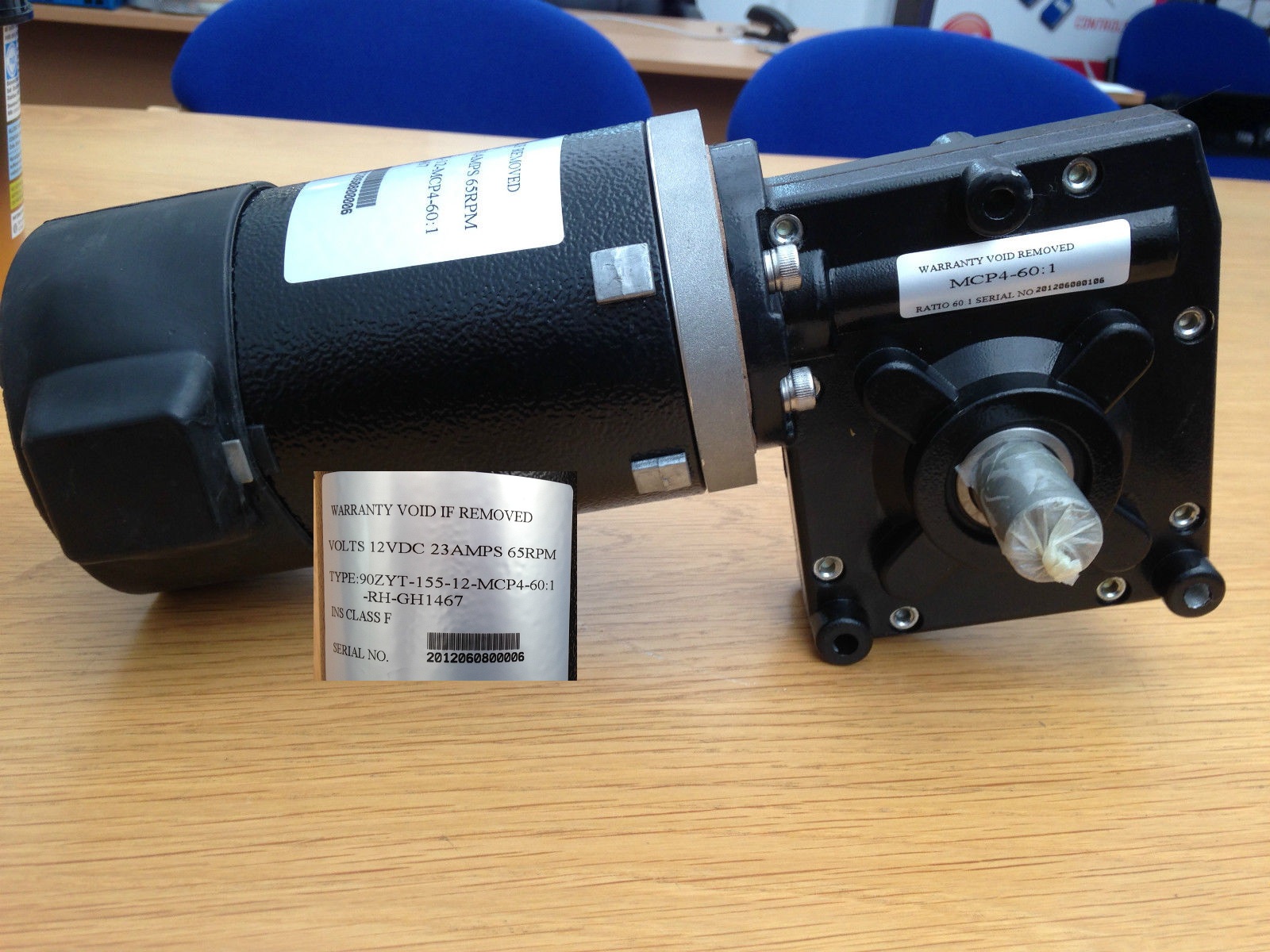

    The one thing i am wondering about is the motors, i have found the same motors as pit have to a reasonable cost.
    But at the same time im just wondering about the wormgear motors as they are a little more quiet.
    I also guess Winches will hold up due to stress and wear as they are more heavy duty, but im not sure of that as ive no real life experiense of them.
    The worms seems to have more or less industrial standards to get up to NM and specs. As so goes the price up.

    Well i finally might have goten a hold of some motors. After a lot of looking up on internet where to get the Wormgear 60:1 300w ish that Motion Control Products in England sell. Seems nobody else sells them, so i mailed them..........Took a while for them to respond but no price tag yet :(.

    Ive ordered the Motors from Motion control products in the UK. They are not the fastest people to respond on mails though.
    Theese are the ones ive ordered 3 of, with bronze gears inside the gearbox. $_507.JPG

    Im still awating if they did supply the gearbox with the straight through shaft!!!!!
    As i said they aint fast on replys.
