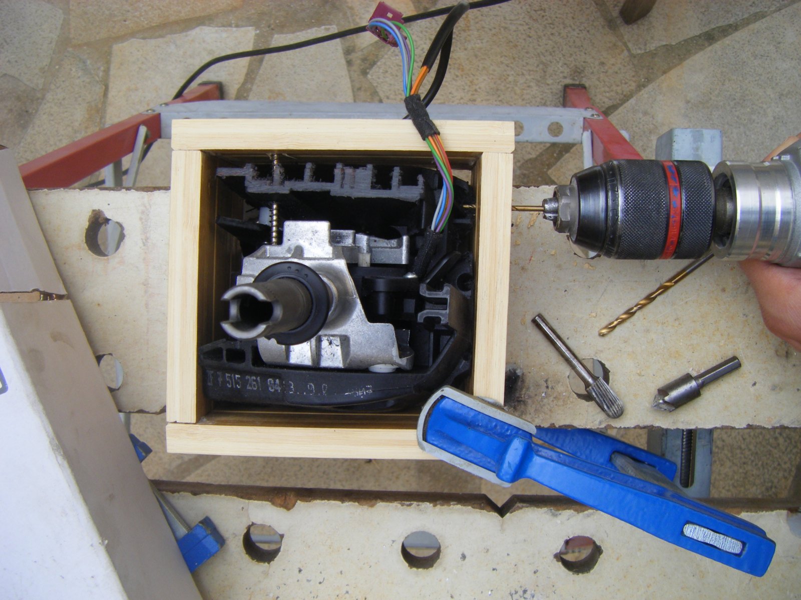

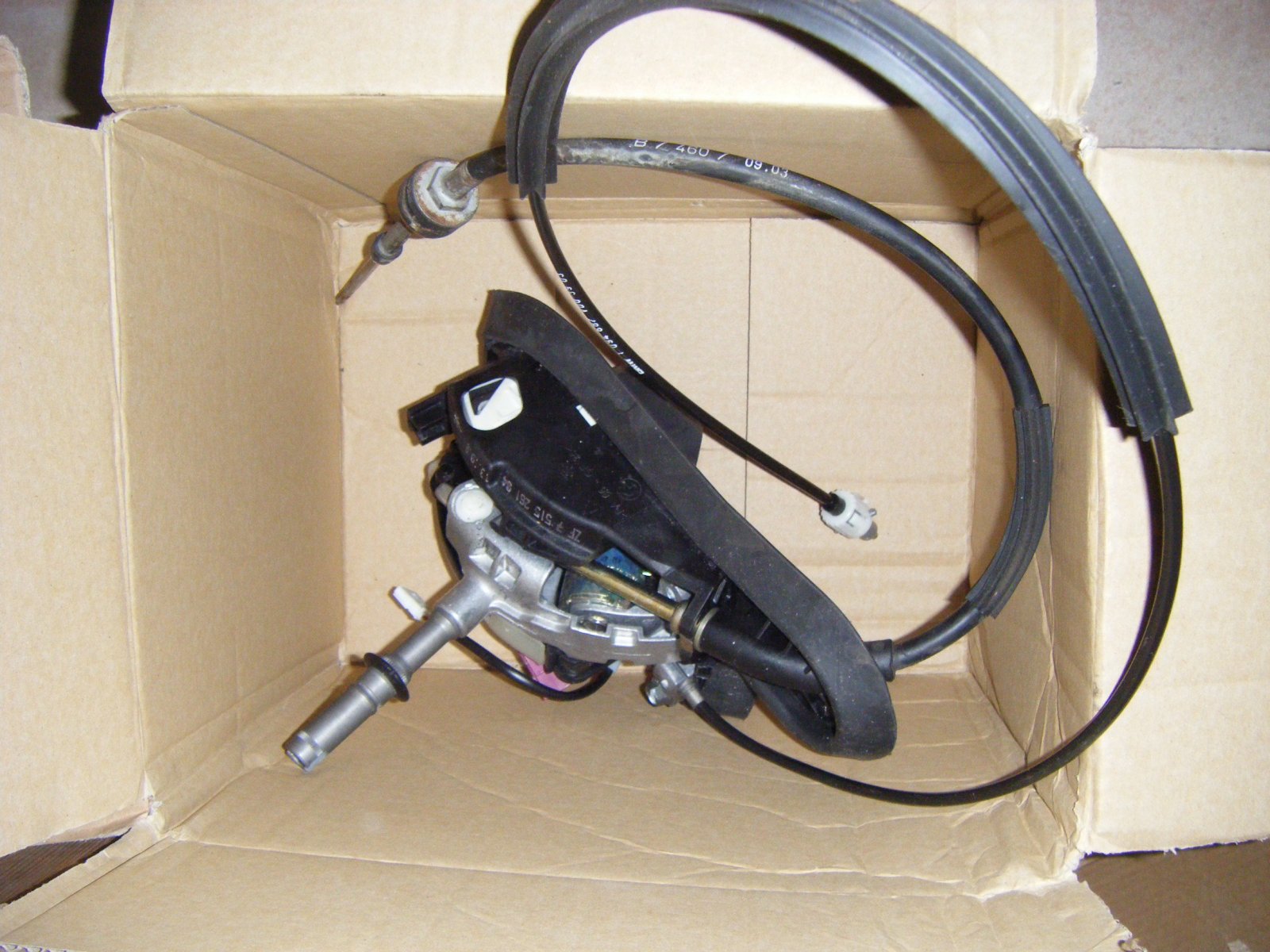

    You wish to have a really immersive shifter? and low cost?
    Why don't you use a real shifter? a steptronic!
    between 30 to 50€
    I followed Akai_fr tutorial as an example
    Here is a "full" steptronic device you can buy on eBay
    559397shifterRacingMatSteptronic12.jpg 639873shifterRacingMatSteptronic10.jpg

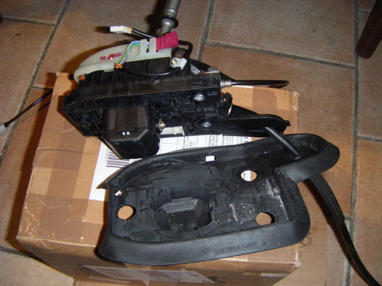

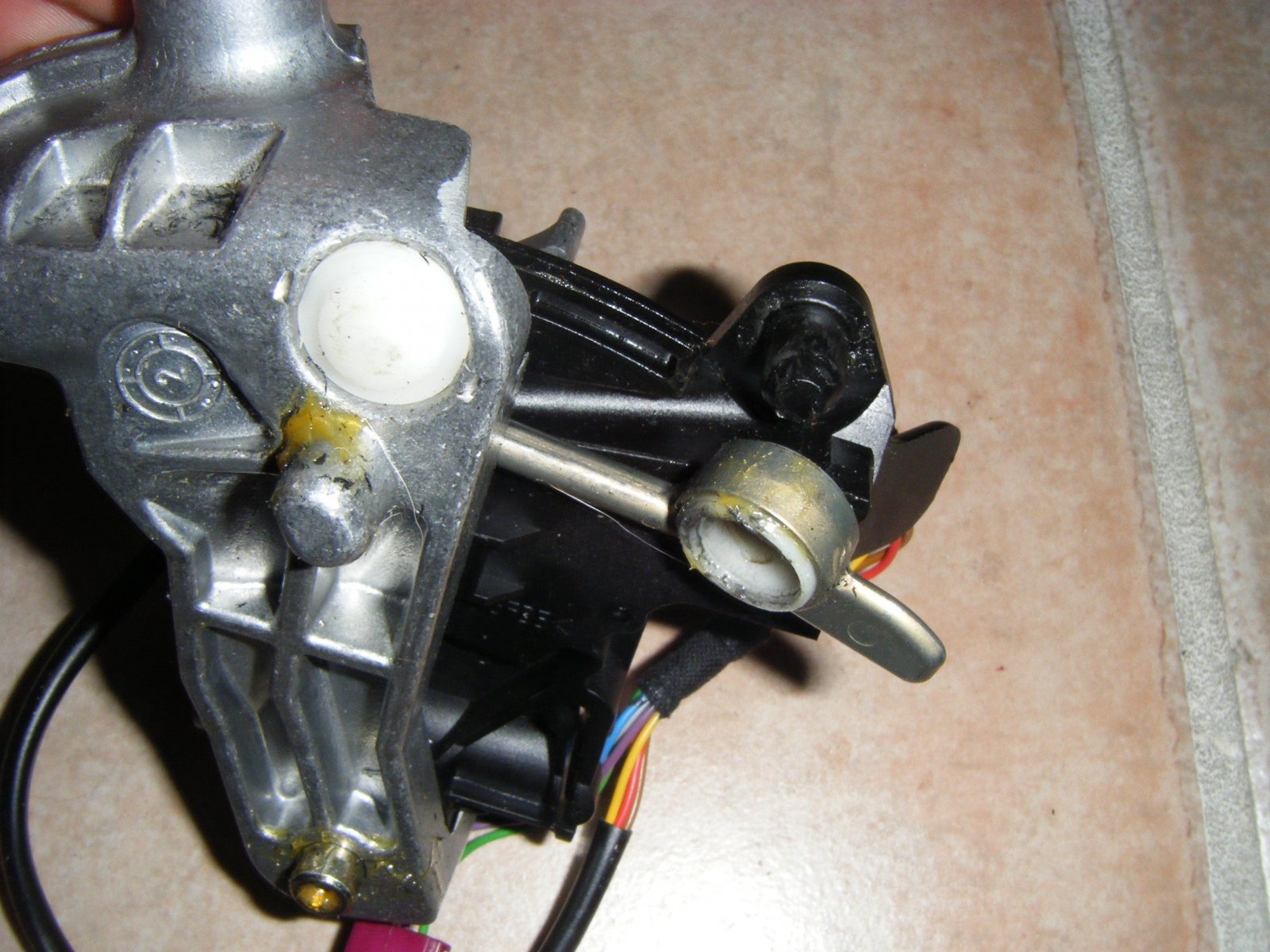

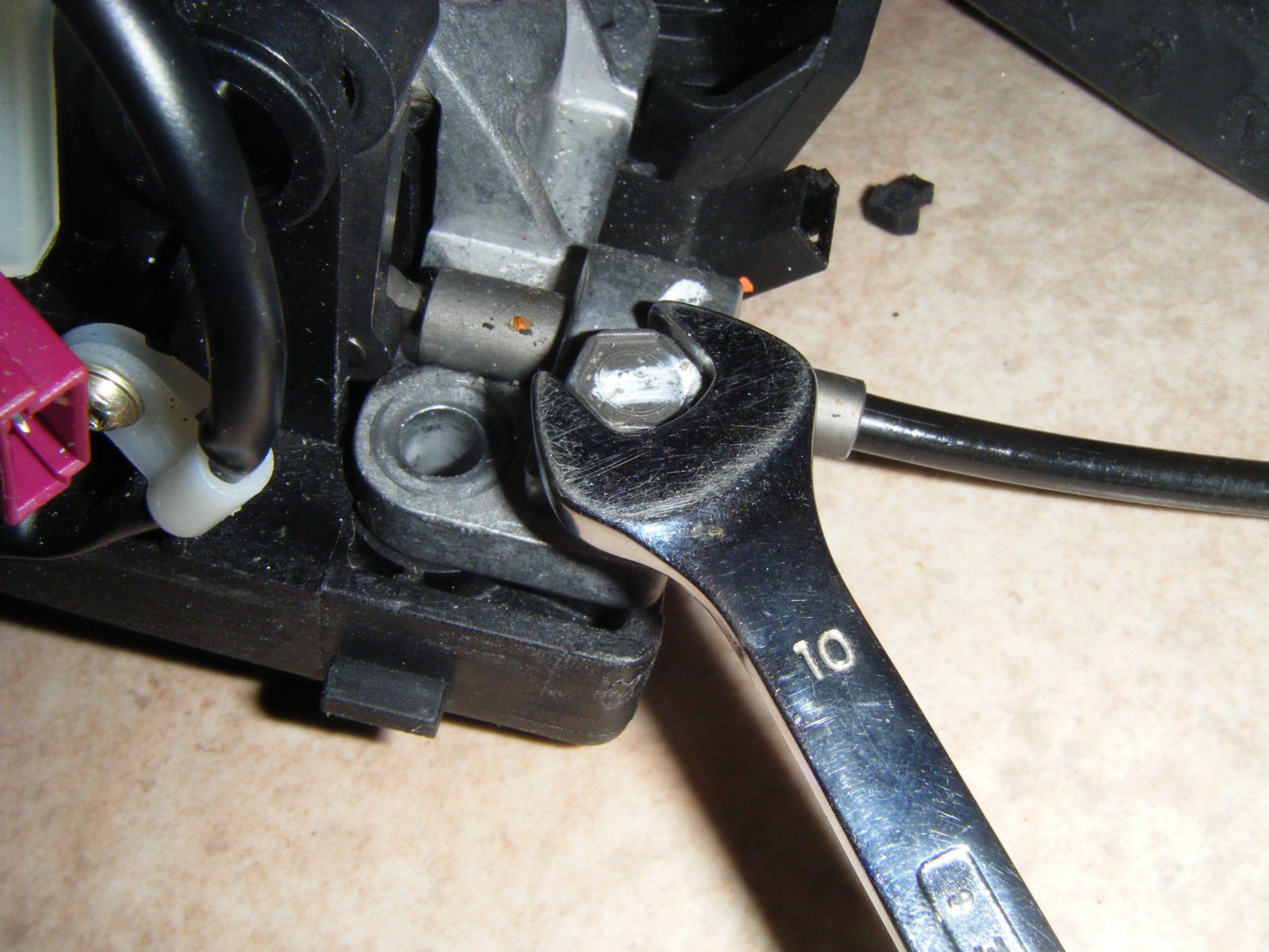

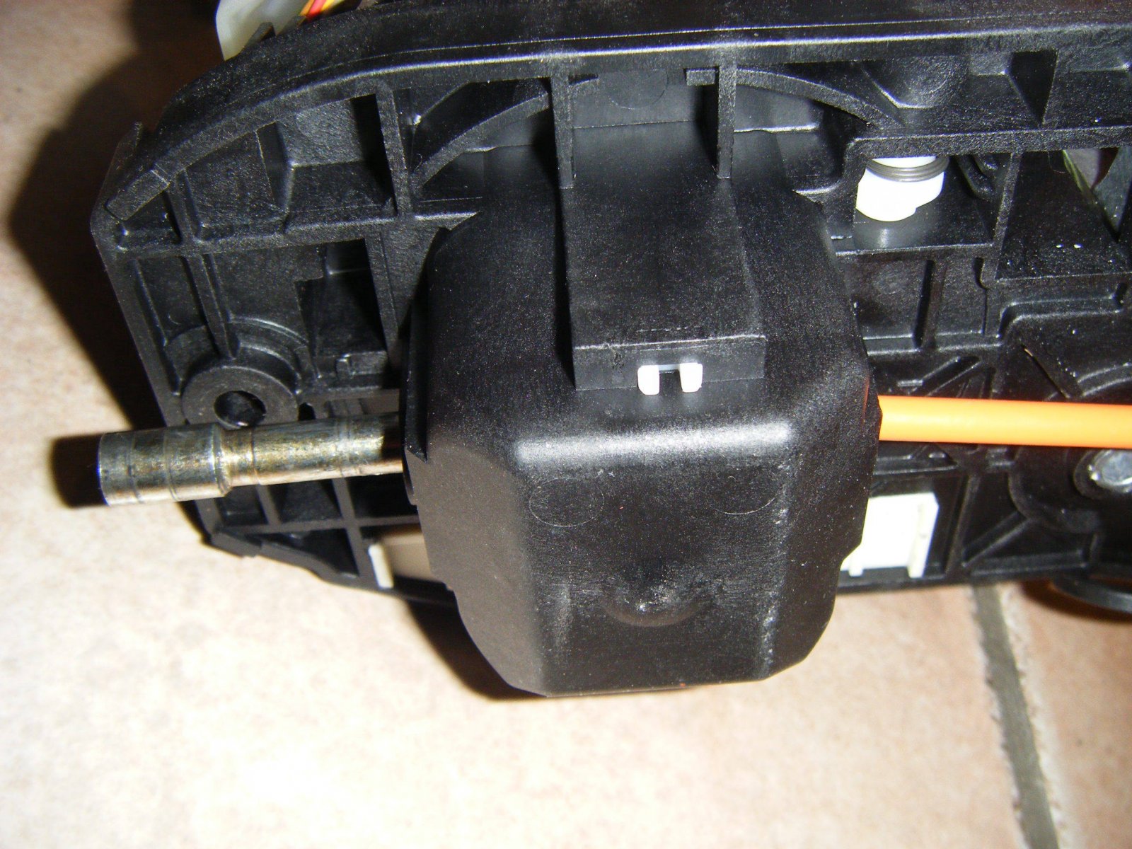

    First steps : removing the unecessary stuff
    remove the cables
    471608shifterRacingMatSteptronic1.jpg 502214shifterRacingMatSteptronic2.jpg 497306shifterRacingMatSteptronic23.jpg
    you can cut the cable to ease the removing (optionnal)

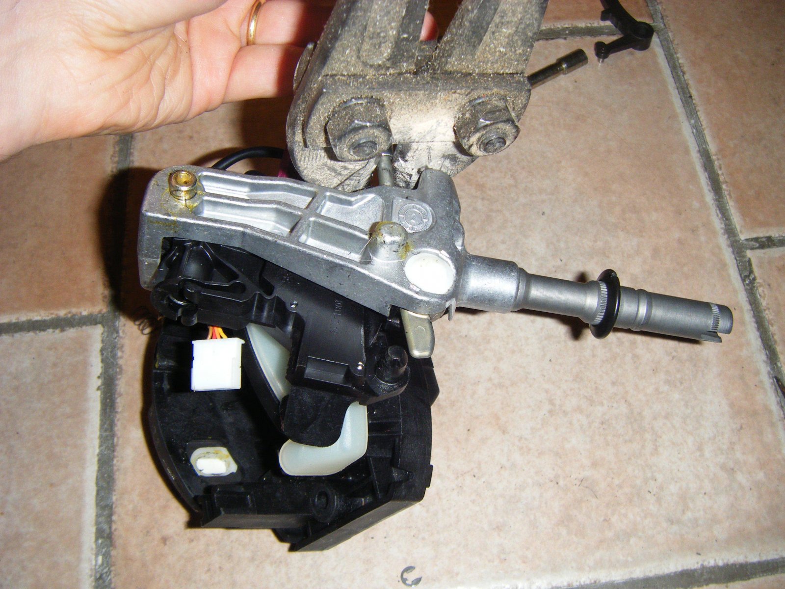

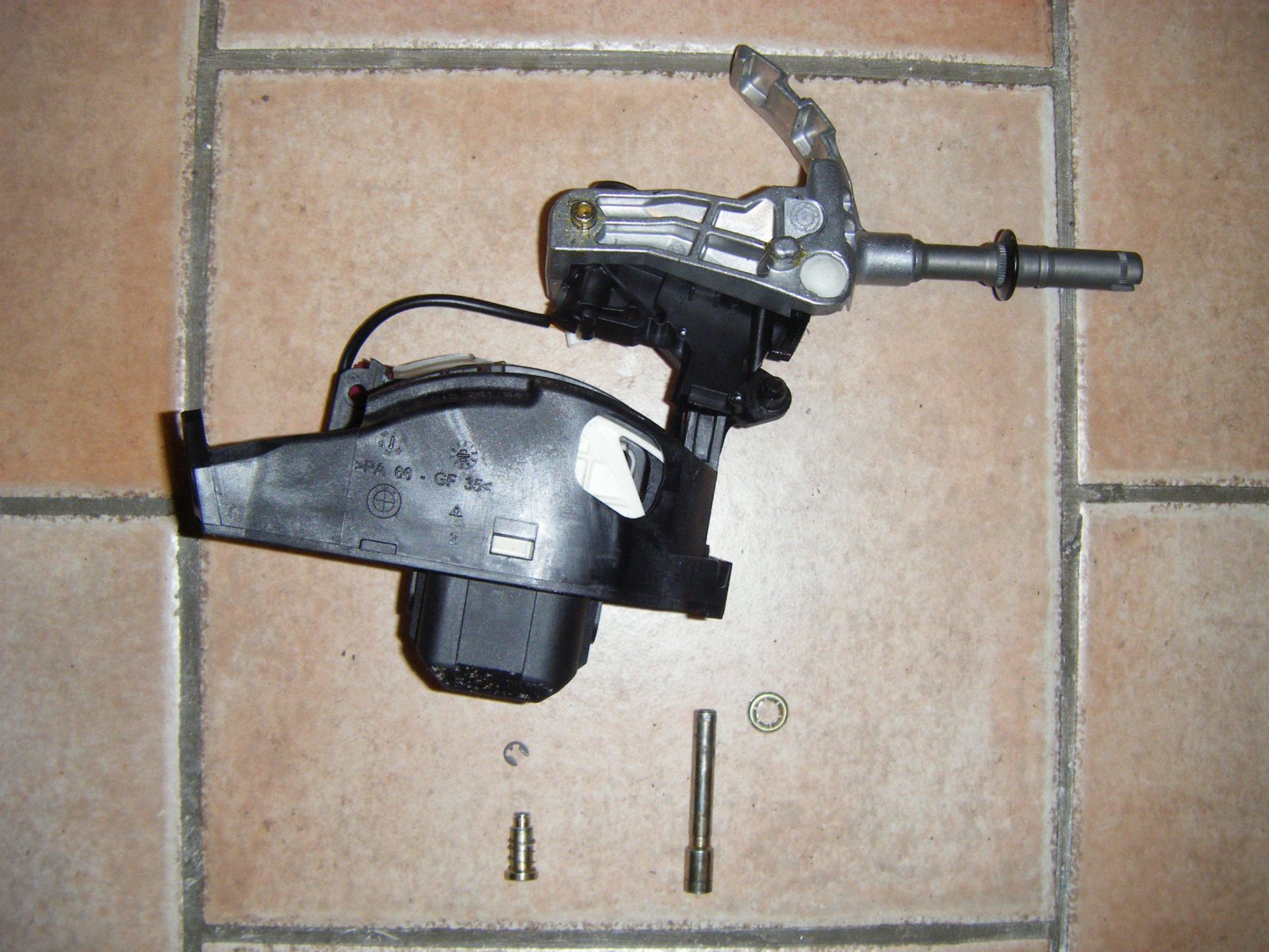

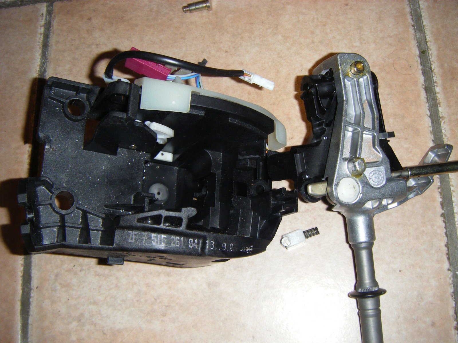

    remove the cover

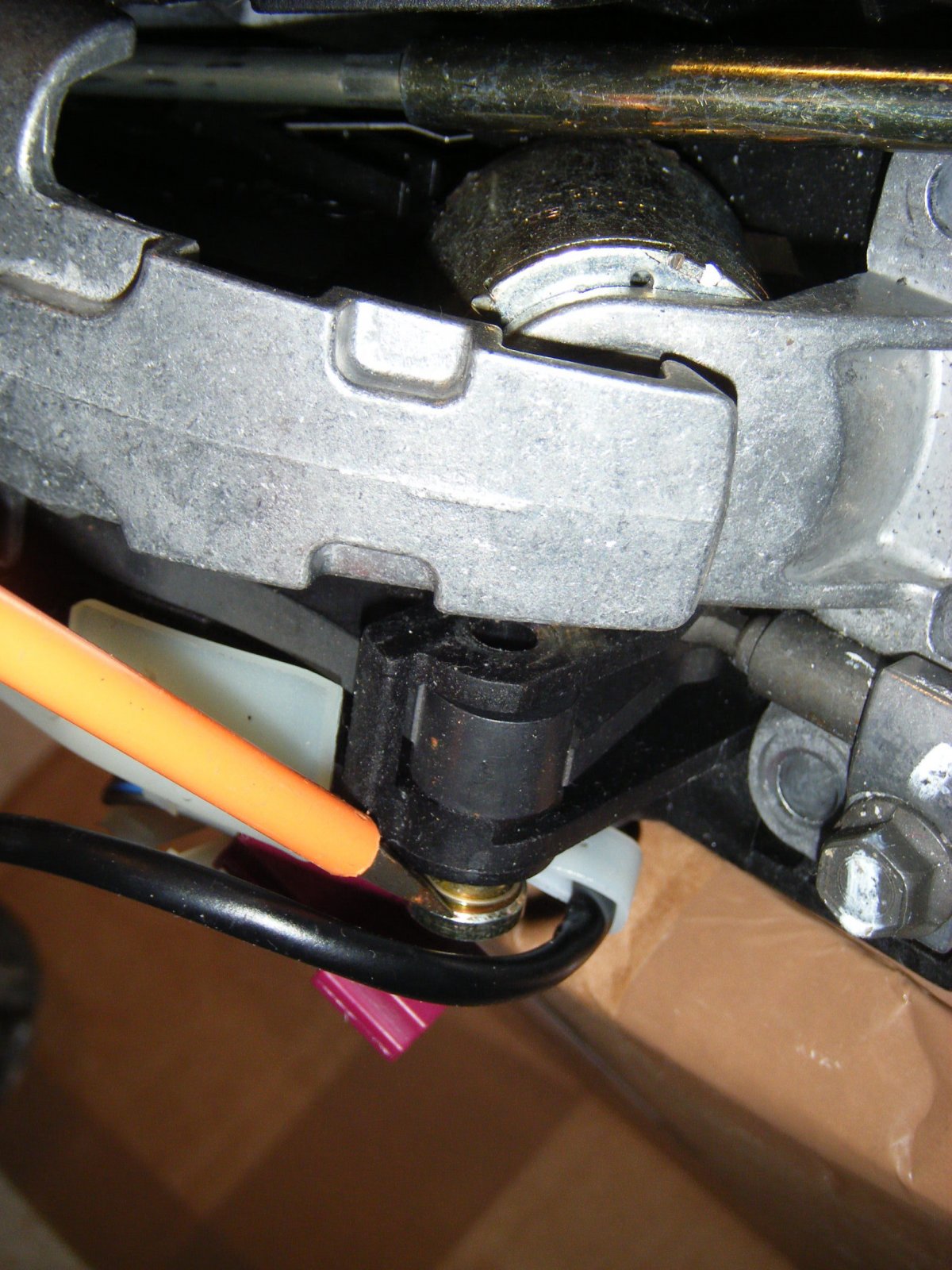

    If you want to clean the insides : remove the axle and be careful not loosing the smal "spring and ball"
    987116shifterRacingMatSteptronic4.jpg 824536shifterRacingMatSteptronic8.jpg 903408shifterRacingMatSteptronic9.jpg 798663shifterRacingMatSteptronic5.jpg

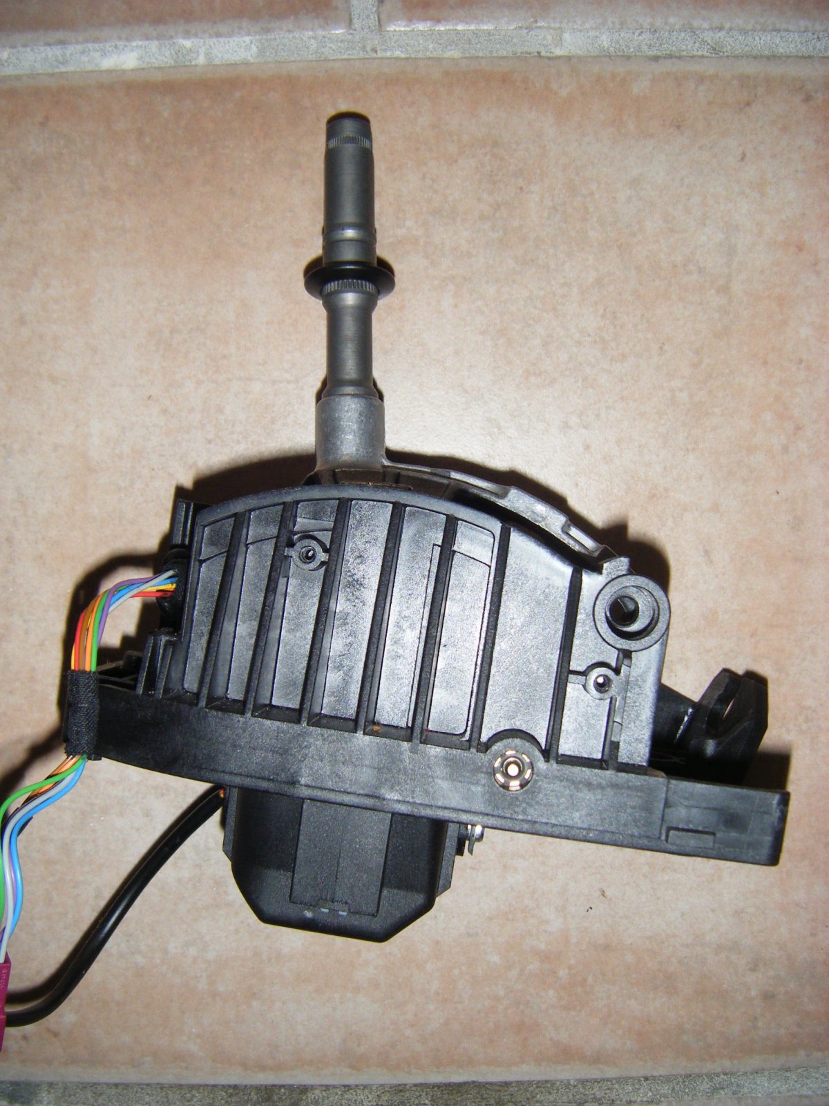

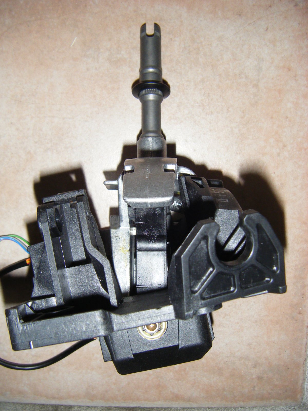

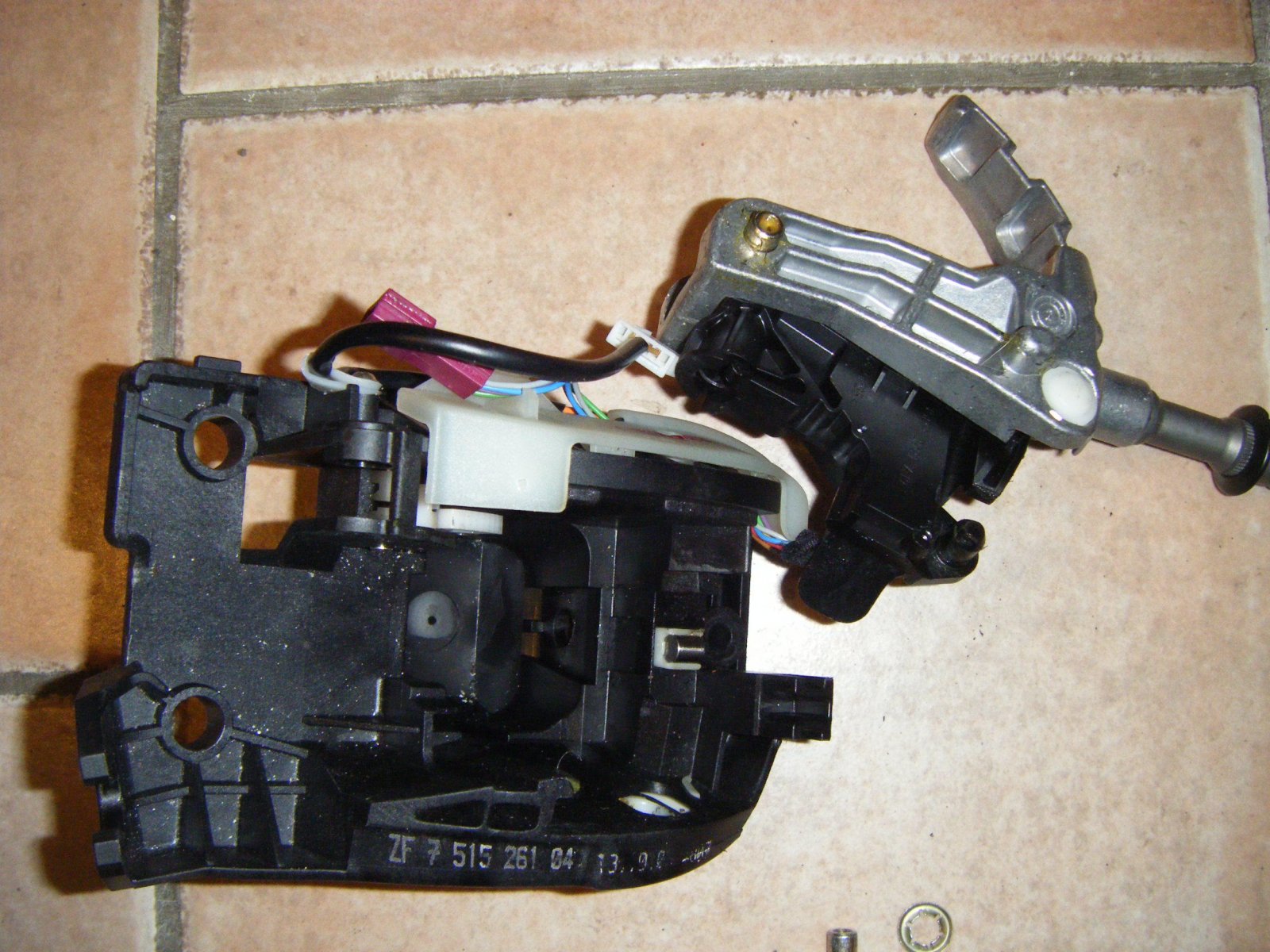

    Once done, you get a rather simple device:
    781201shifterRacingMatSteptronic18.jpg 199544shifterRacingMatSteptronic17.jpg

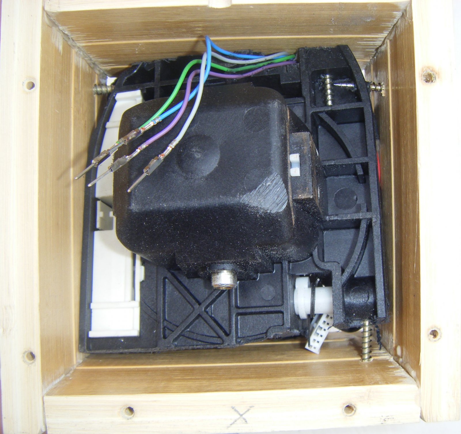

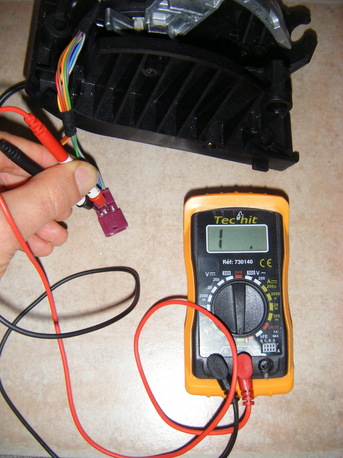

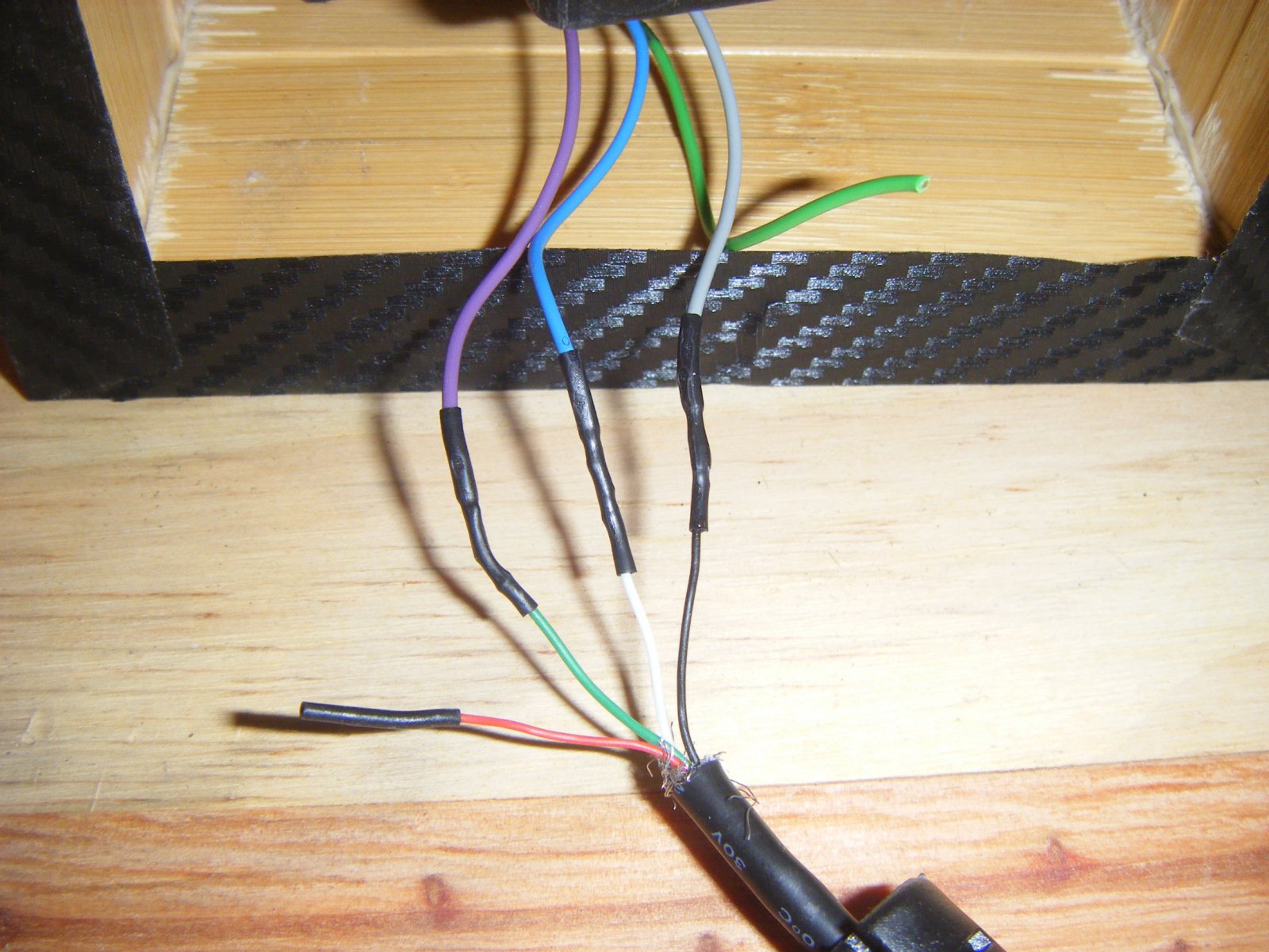

    Check which wires are connected to the micro-switches inside up and down shift
    (probably one common)
    I used a A-B USB cable and kept this end (in order to prevent any computer connexion) images.jpeg

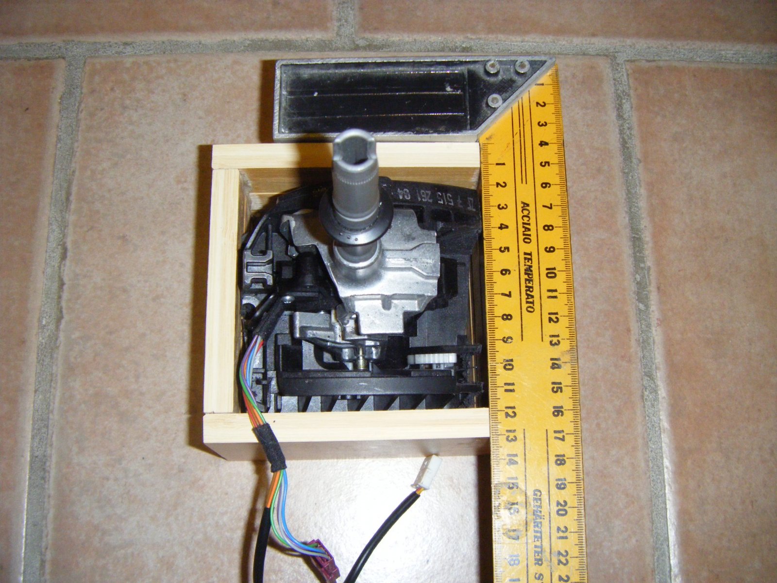

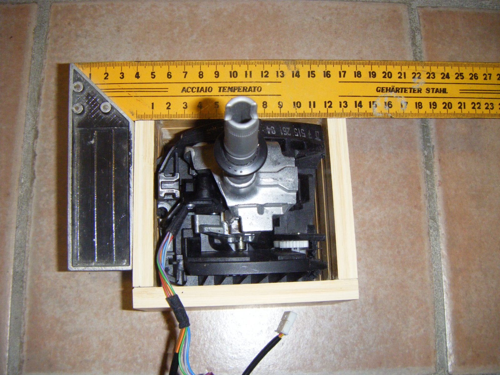

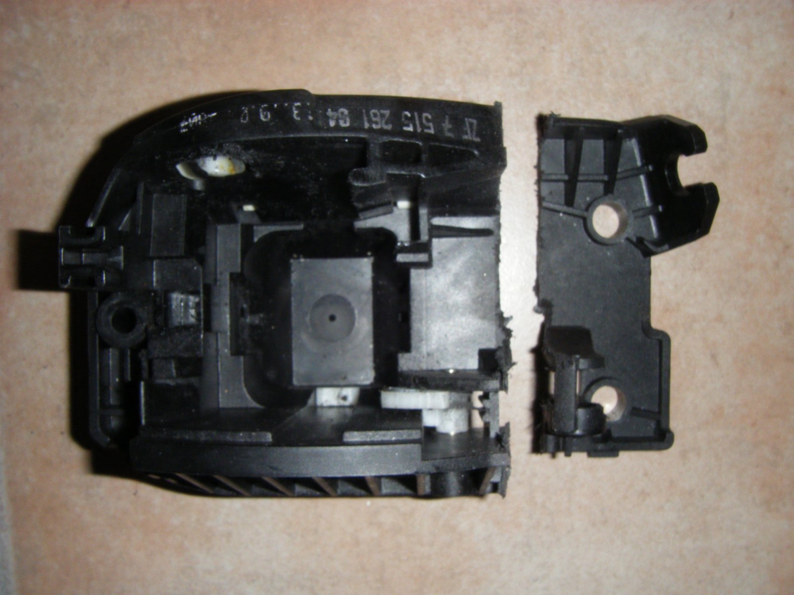

    You can shrink the overall size by cutting bits
    you can achieve a compact size:

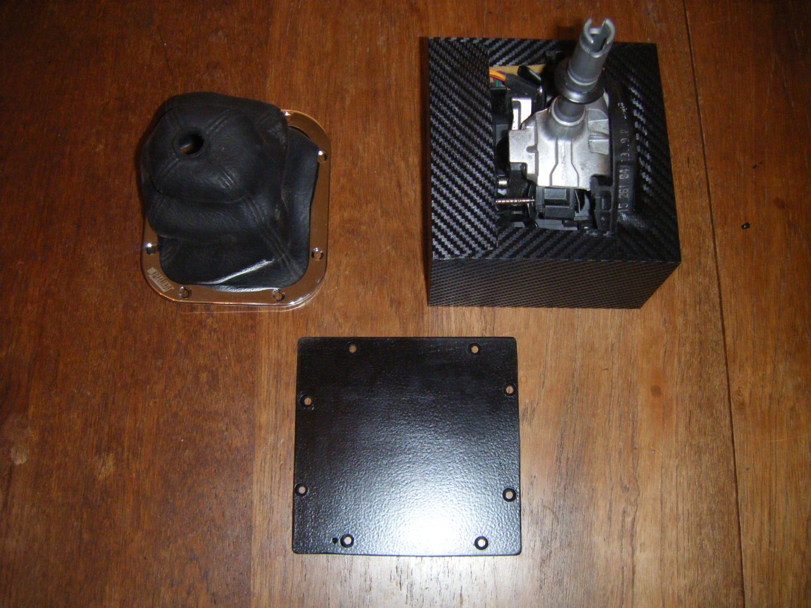

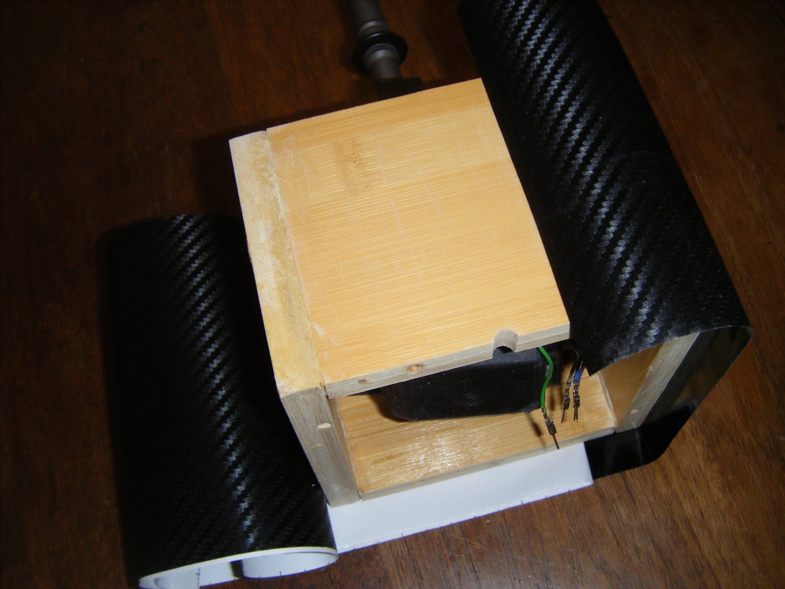

    I fixed the steptronic in the box with screws:
    I blocked the disengagement sequential/manual (tilt left) with a screw (some people don't)

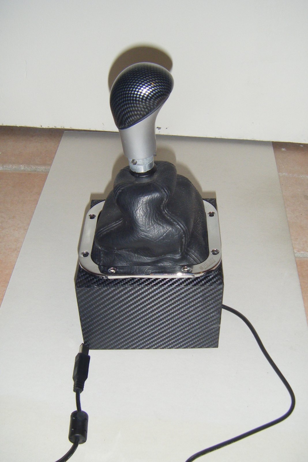

    I covered the box with Carbon look adhesive

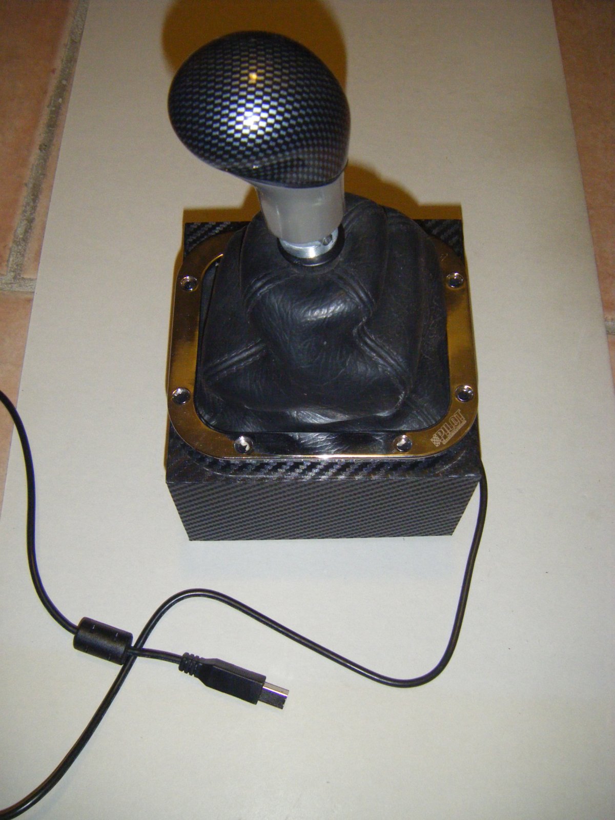

    Here is the final result:

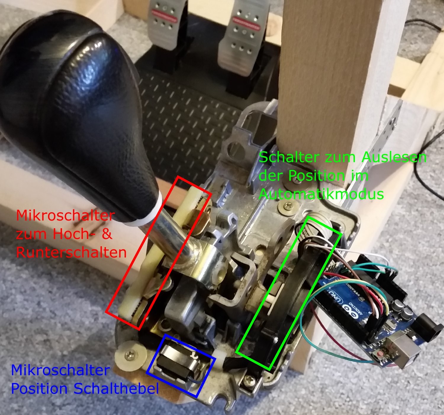

  8. Helium
    Helium New Member
    Jul 22, 2015
    7
    Earth
    380Coins
    Nice work. I built one myself using a slightly newer version of the shifter.
    Why did you block the path to the right?
    I use the right position as a 3rd button (most of the time I use it as reverse) and the right front position as some kind of parking position when the shifter is not in use.
  9. RacingMat
    2,234
    20,894Coins
    +2,084 / 21 / -2
    It's a good idea as well to keep the right position!
  10. Helium
    Helium New Member
    Jul 22, 2015
    7
    Earth
    380Coins
    The Shifter is awesome to use and I'm still impressed how sturdy it actually is. It really can take a beating. But to be honest I never used any "gaming" shifter so I have no idea how those would compare.
    But I am sure that it's impossible to get something comparable that cheap. With a bit of patience you can get the newer version of the shifter I used and an Arduino UNO (you need to flash a different bootloader and solder some pins to make it a USB host) for less than 15 €. The newer version looks a bit different though and might not be as well constructed (but still more than good enough).
    I even wrote a sketch to use all possible positions but then realized that it doesn't make any sense because all those buttons are dependant. I implemented it anyway because I didn't want to back down :D.
    You could map less important functions to it (switch headlights on e.g.) but activating the button takes a while (move the shifter to the right and then move it to the desired position. Since I got one with the original "lock-knob" you have four possible positions on the right side) and you cannot shift in the meantime. And you have to find a way to make sure that a button is not pressed if you just fly over the position.
    For some functions you can live with that but a buttonbox is much more comfortable and depending on the arduino you are using you got a lot of pins for buttons left.
    Mine has the part number 1 422 834.
