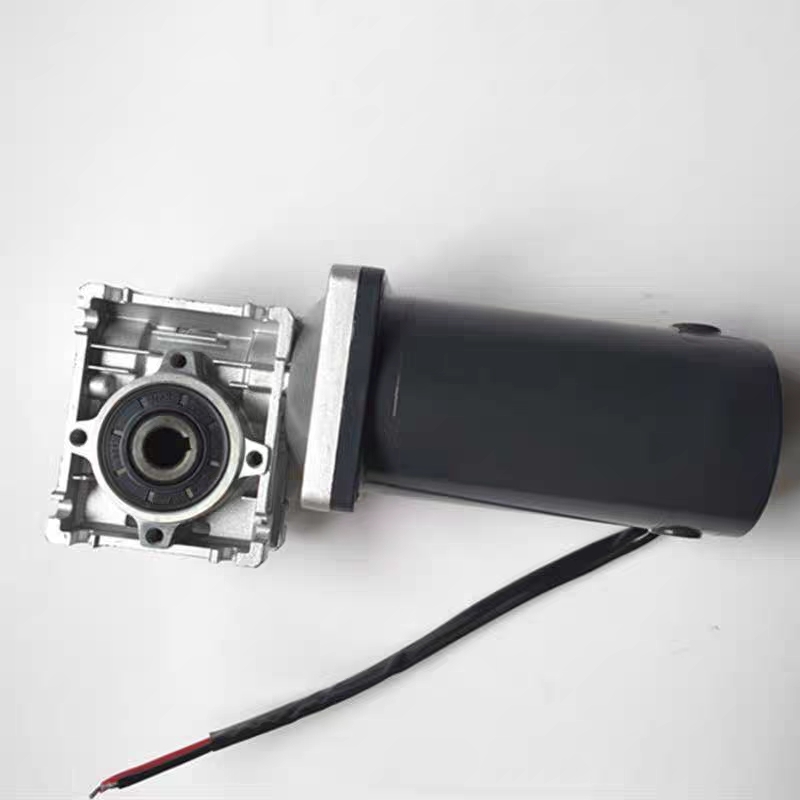

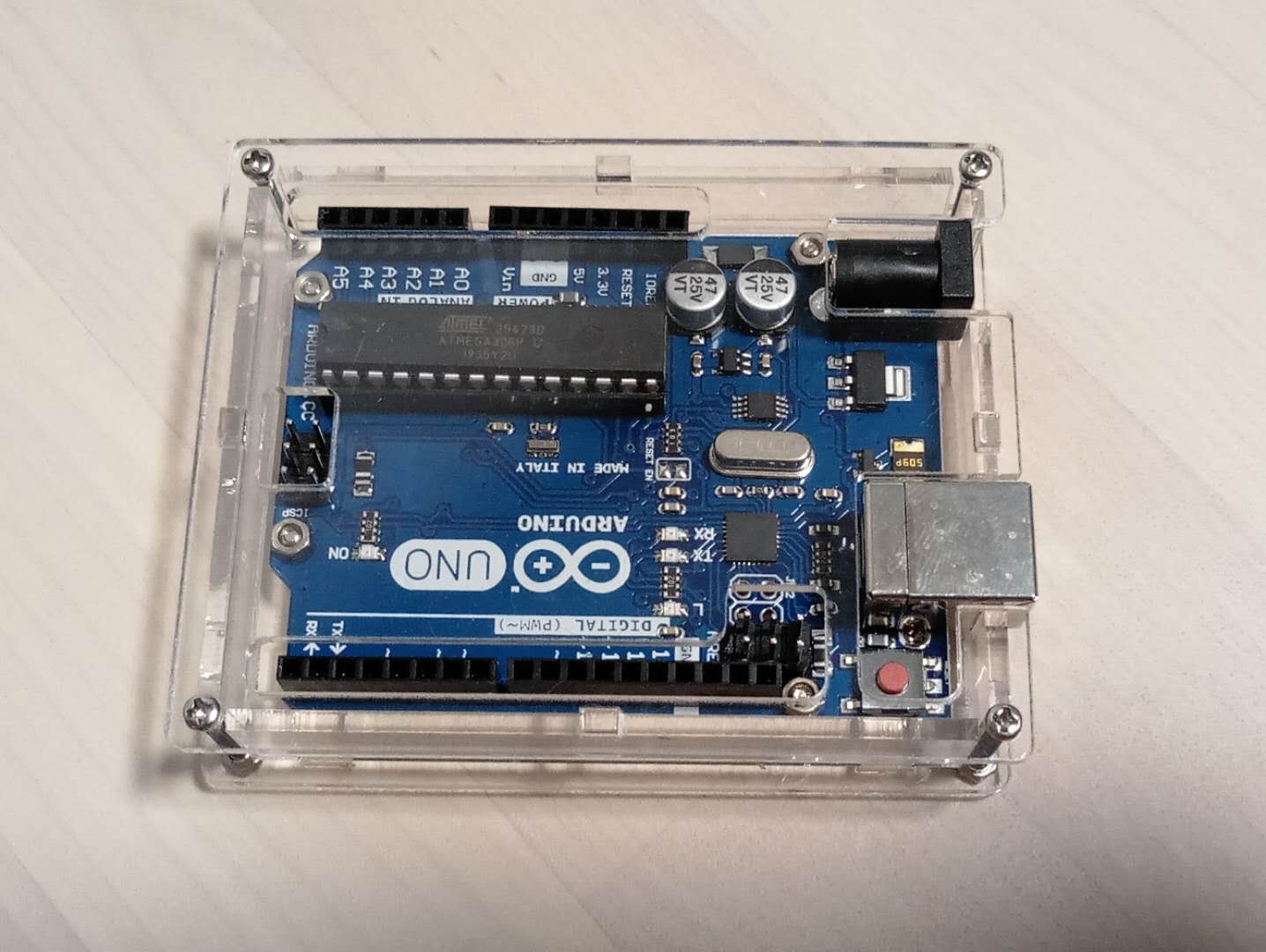

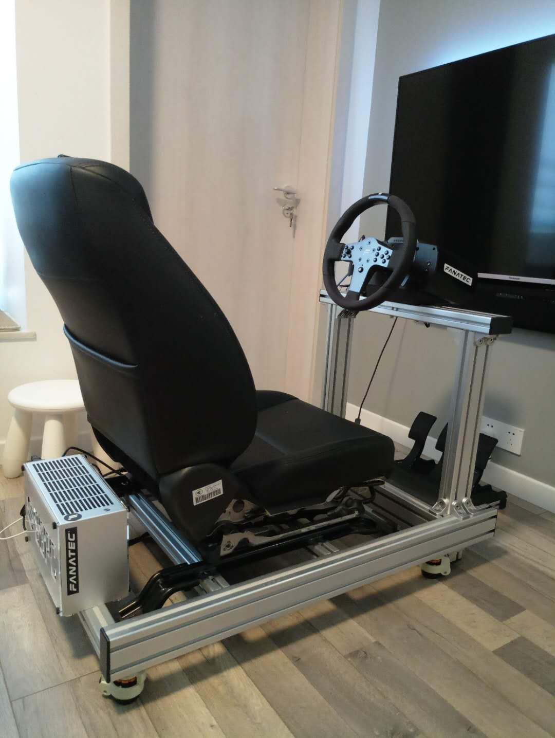

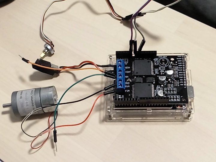

    I had built a cockpit a year ago, now I plan to tmod it into a 2DOF cockpit.
    Intended part:
    1. arduino uno
    2. ST dual VNH5019 motor driver
    3. DC motor 350w with 1:60 gearbox
    Construction is in progress, and currently there are several issues that need to be resolved. If anyone can give some suggestions, it will be greatly appreciated.
    1. My idea is to place the motor under the seat to save space. But this will make the design more difficult, and the connecting rod will be short and the angle will be vertical. I don't know if it will affect the final effect.

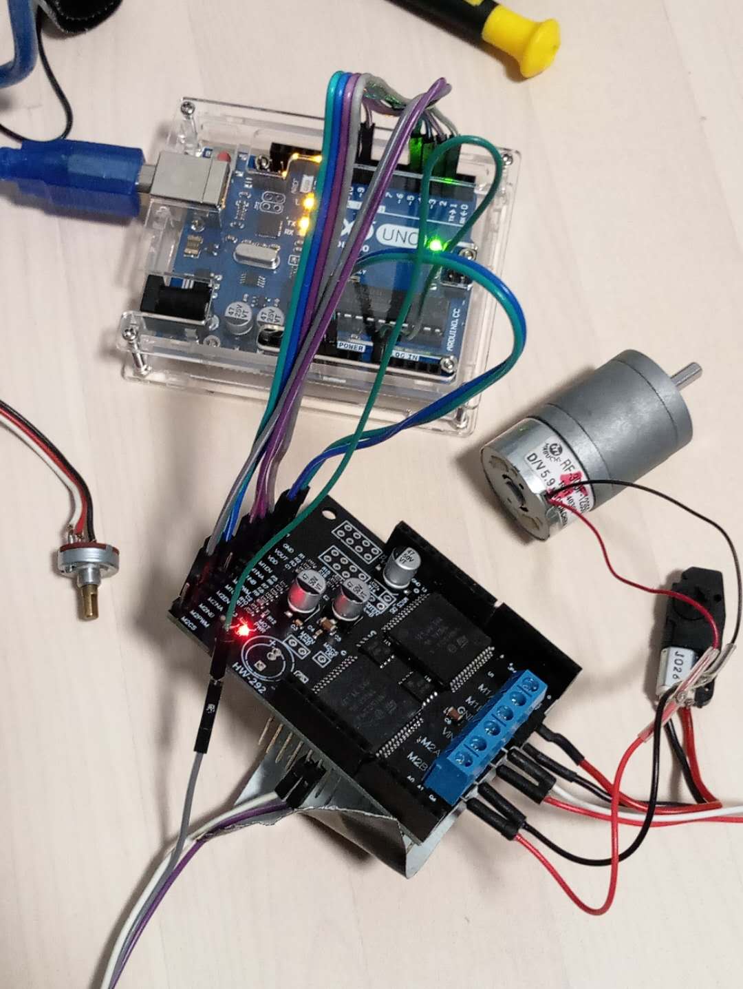

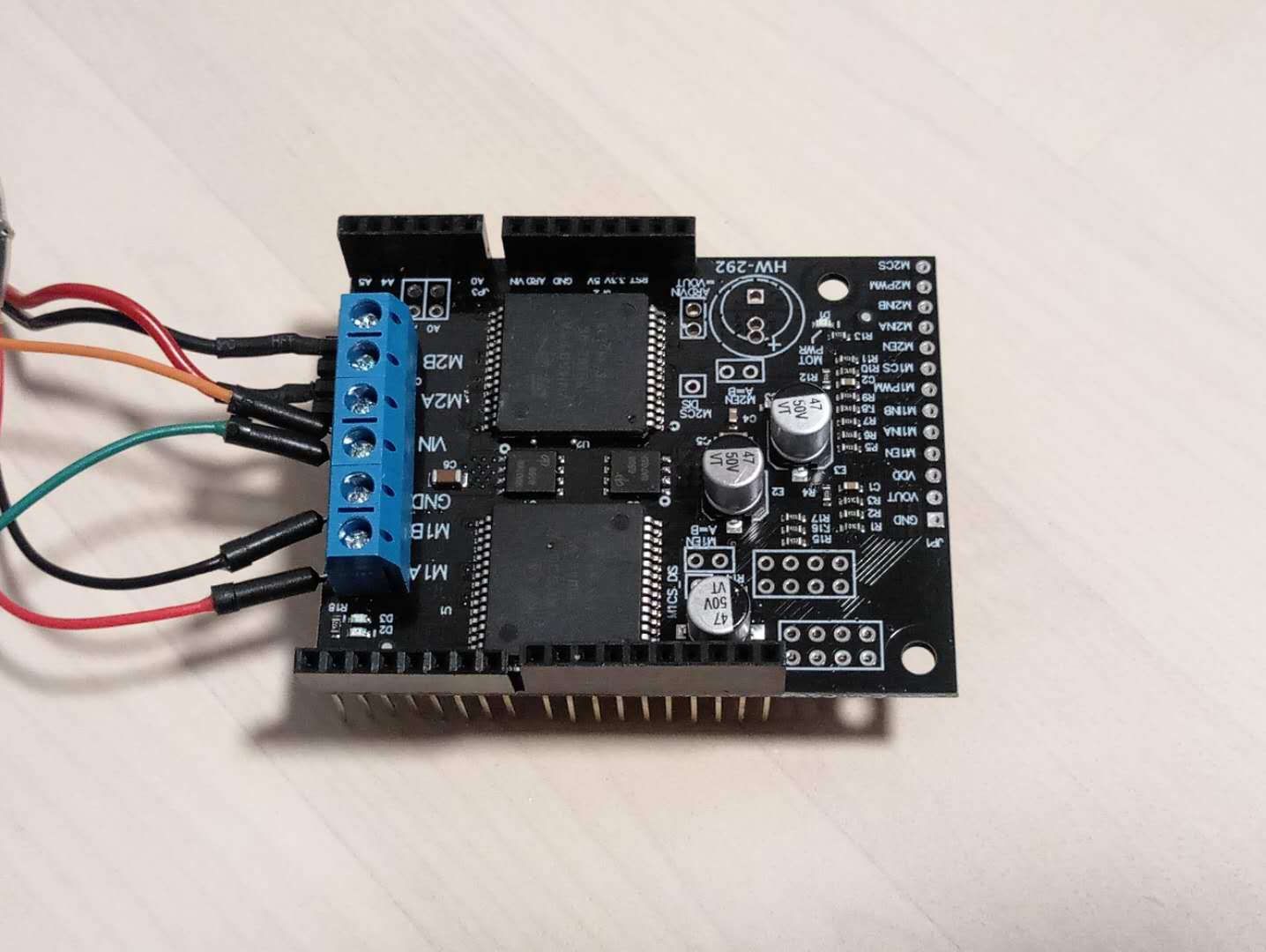

    2. I'm not sure if VNH5019 can drive a 350w 24v motor, although it can provide a maximum current of 30A, but the continuous current is 12A. However, a 350w motor may require 20A.
    3. I have experimented with two small motors, using the SMC3 program (https://www.xsimulator.net/communit...3dof-motor-driver-and-windows-utilities.4957/), but it does not work, I am currently trying to find the problem...

    Update. . .

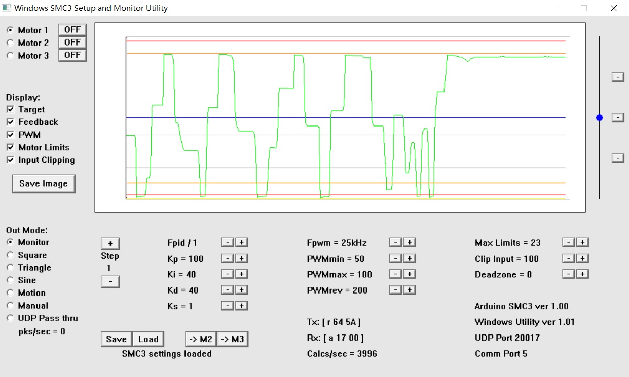

    According to the instructions of SMC3, the connection line error was found. After correct wiring, the motor still does not respond in the output testing of simtools. I have a little doubt that the VNH5019 driver board is bad.
    The signal appears normal in SMC3Monitor Utils.

  4. Gadget999
    1,959
    11,983Coins
    +484 / 10 / -0
    i think you need a more powerful motor driver
  5. yangsqr
    yangsqr Member
    Feb 2, 2019
    43
    - 21Coins
    +8 / 0 / -0

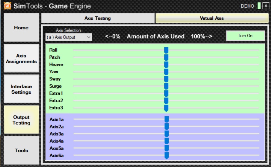

    Thanks to Gadget999. I have replaced two 43A drives, they work well with SMC3, I've tested it with simtools Axis Testing. Now there's only one problem, which is that LFS can't trans information to simtools (Virtul Axis interface in simtools does not show any movement:(

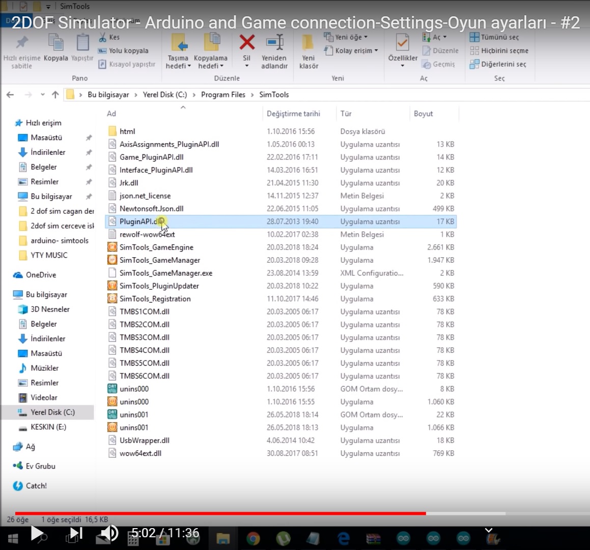

    Thanks Jean. Yes, I ran LFS before pacth. follow those steps:https://www.xsimulator.net/simtools-quickstart/#Patching-the-game
    I saw a youtube video that mentioned copying the "PluginAPI.dll" file from the Simtools installation directory to the LSF installation directory. But unfortunately I did not find this file in the 2.4 version of simtools.

    in my experience, you don't need to copy any file my set up is the same as yours, arduino with SMC3. another question, when you turn on your output testing in the GAME ENGINE. do you get any movement in the motors!?

    @yangsqr can you please post some pics of your axxis assignments and your interface settings?

    Yes Game Engine can control motor movement (although a little jerking)

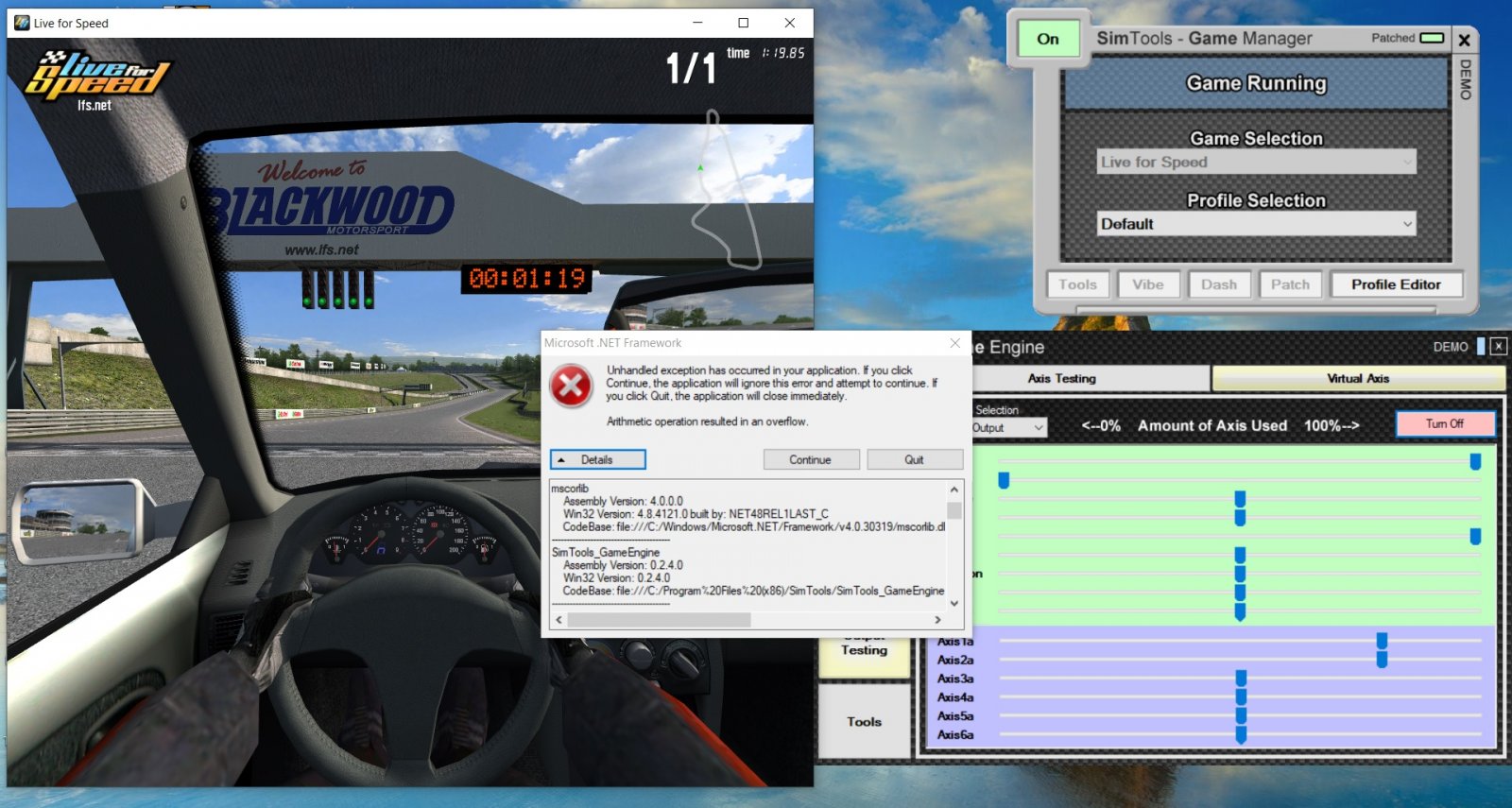

    Thank you noorbeast, it works according to your instructions. But there seems to be a problem: the transmitted data is jerky. Do you know what to do? Thanks again
    21,581
    151,100Coins
    You really need to copy and paste the full error message, so we can read it properly.
    There are a couple of possibilities, .NET could be corrupted, so try the repair: https://www.microsoft.com/en-us/download/details.aspx?id=30135
    Or you may need to again temporarily turning off your anti-virus and firewall, Un-patch LFS and then un-install, then re-install SimTools from scratch.
    Run a LFS race: https://www.xsimulator.net/communit...run-in-first-person-mode-before-patching.345/
    Restart SimTools and re-patch LFS
    Test LFS.

    Error report attachment has been uploaded:

    Maybe I'm mistaken but, do you have the game engine and the game manager installed in the same computer? have you tried to run LFS in full screen mode? I read that some users experience the program crash when run LFS in windowed mode. In my case the error you are experiencing only ocurrs when I run LFS patched without completing the race, also, if your IP adreess change and you update it you have to do the patching process all over again.

    Before seeing your message, I reinstalled on another computer, but still the same problem. Thanks Jean pointed out the problem:run LFS in windowed mode!
    When I run LFS in full screen mode, the data does not shake anymore. But the attitude is not correct at present, there may be some problems with the setting, I will continue to adjust the parameters.

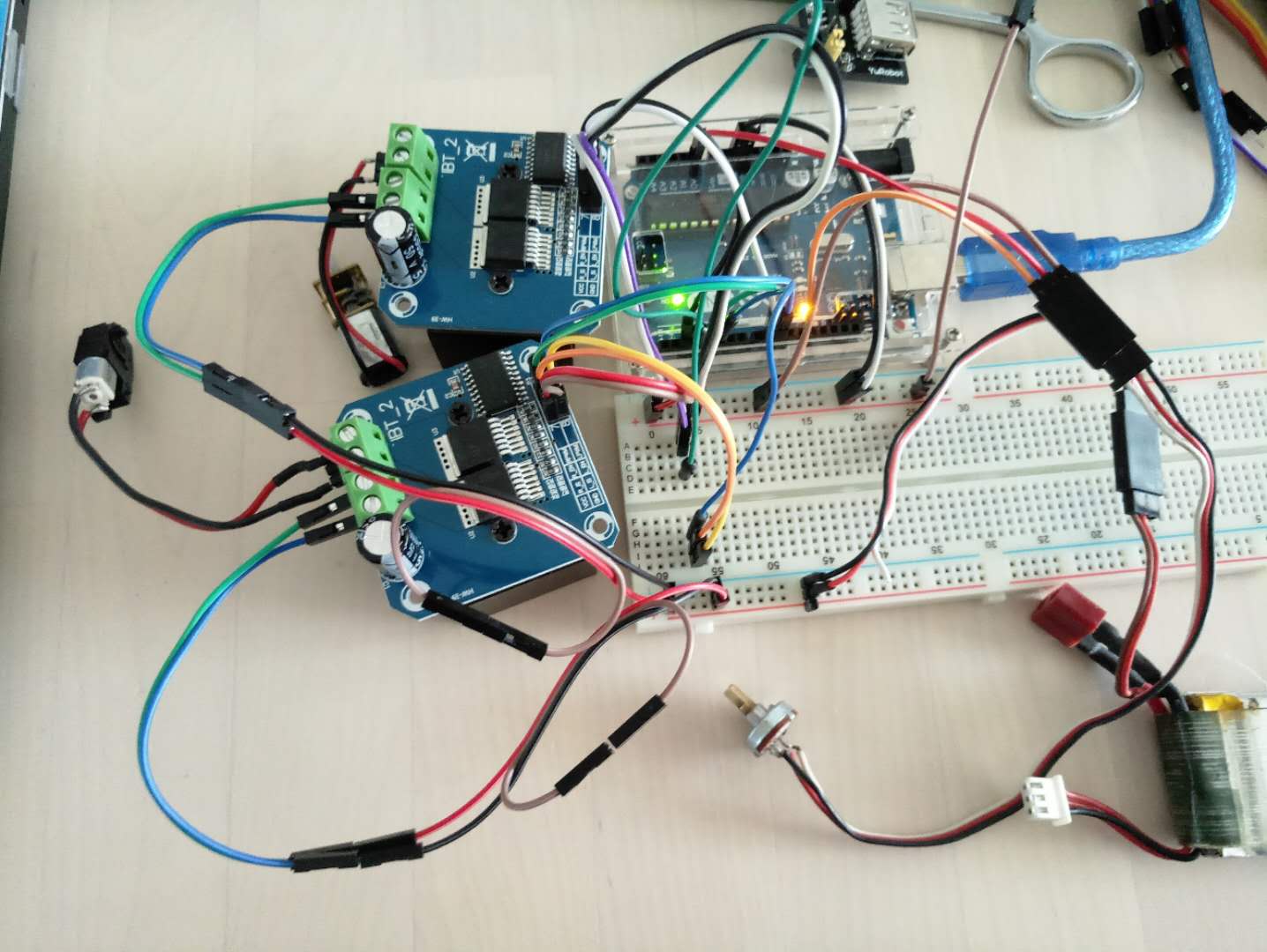

    hey!
    im struggling with the exact same setup in SMC3 at the moment...
    no motor movement.
    maybe i did wiring mistakes...
    do you have a wiring diagram that shows how you connected everything (drivers, breadboard, arduino)?
    are you experiencing any failures with the ibt2 drivers?
    thanks for helping me out!
    and good luck with your build.

    Ibt2 wiring is simple, I follow this diagram:
    Did you change to “MODE 2” while programming arduino? (Default is MODE 1)
    At present, I have only performed no-load test, IBT2 works fine.

    thanks for your help.
    i rewired everything, i followed the same wiring as you did an running in mode 2.
    i don‘t know exactly what the problem was, but it works now!
    any news at your project?
