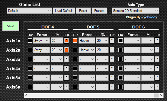

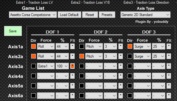

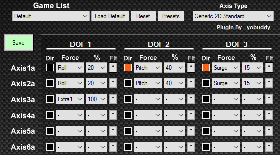

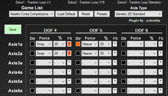

    i finally have my rig moving! :)
    Just have a couple of queries with regards to simtools setup. I am setup as per below:
    Output Testing results:
    Roll +100% - Rig Tilts to left
    Pitch +100% - Rig Tilts Upwards
    Heave +100% - Rig Tilts Upwards
    Sway +100% - Rig Tilts Left
    Surge +100% - Rig Tilts Upwards
    Extra1 +100% - Rig slides Left
    I have real all ofthe documentation several times and it states that:
    " Both boxes will be either checked or unchecked for surge and pitch, while only one will be checked for sway and the opposite one will be checked for roll."
    However if i do as suggested, it seems to mess up the output testing. Should I assume that its fine as is or is there something i should look into?
    Thanks :)
  15. noorbeast
    21,644
    151,522Coins
    +11,041 / 56 / -2
    My guess is one of your motors is wired backwards, but it won't really matter, as long as the movement for the axis goes the right way: https://www.xsimulator.net/community/faq/which-way-to-set-simtool-axis-movements.230/
  16. Ian Pace
    Ian Pace Member
    Dec 17, 2017
    72
    Gharghur - Malta
    39Coins
    +28 / 0 / -0
    they are all wired in the same way for sure.....
    so can you confirm that the above output testing is fine?
  17. noorbeast
    21,644
    151,522Coins
    +11,041 / 56 / -2
    They need to be as per the link provided, for example pitch 100% should be tilt down, so you seem to have reversed assignments.
  18. Ian Pace
    Ian Pace Member
    Dec 17, 2017
    72
    Gharghur - Malta
    39Coins
    +28 / 0 / -0
    Thanks its now sorted and seems to be going in the right direction (i think):)
    Roll +100% - Rig Tilts to right
    Pitch +100% - Rig Tilts downwards
    Heave +100% - Rig Tilts downwards
    Anyone of them seems off to you?
  19. noorbeast
    21,644
    151,522Coins
    +11,041 / 56 / -2
    That looks more like it.

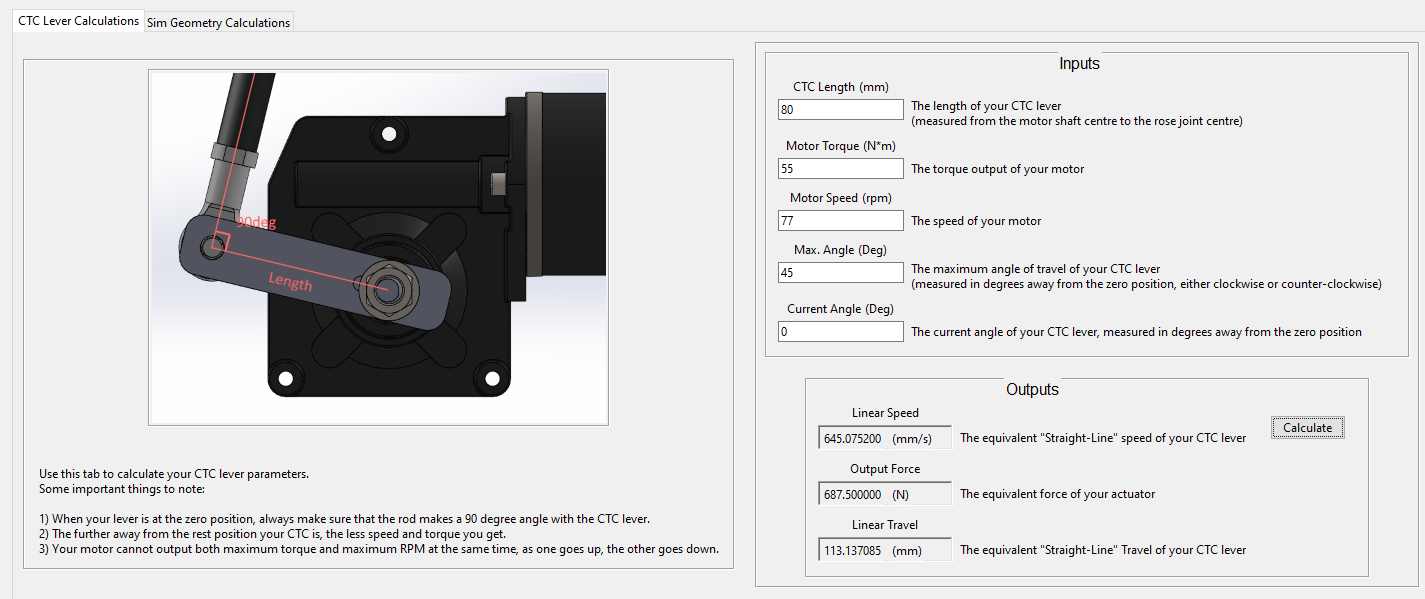

  20. absyfadhel1
    absyfadhel1 Member
    Oct 19, 2017
    329
    bahrain
    442Coins
    +33 / 0 / -0

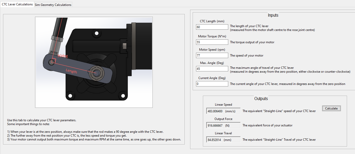

    output force : number (N) ... what N mean ? newtons? or what?
