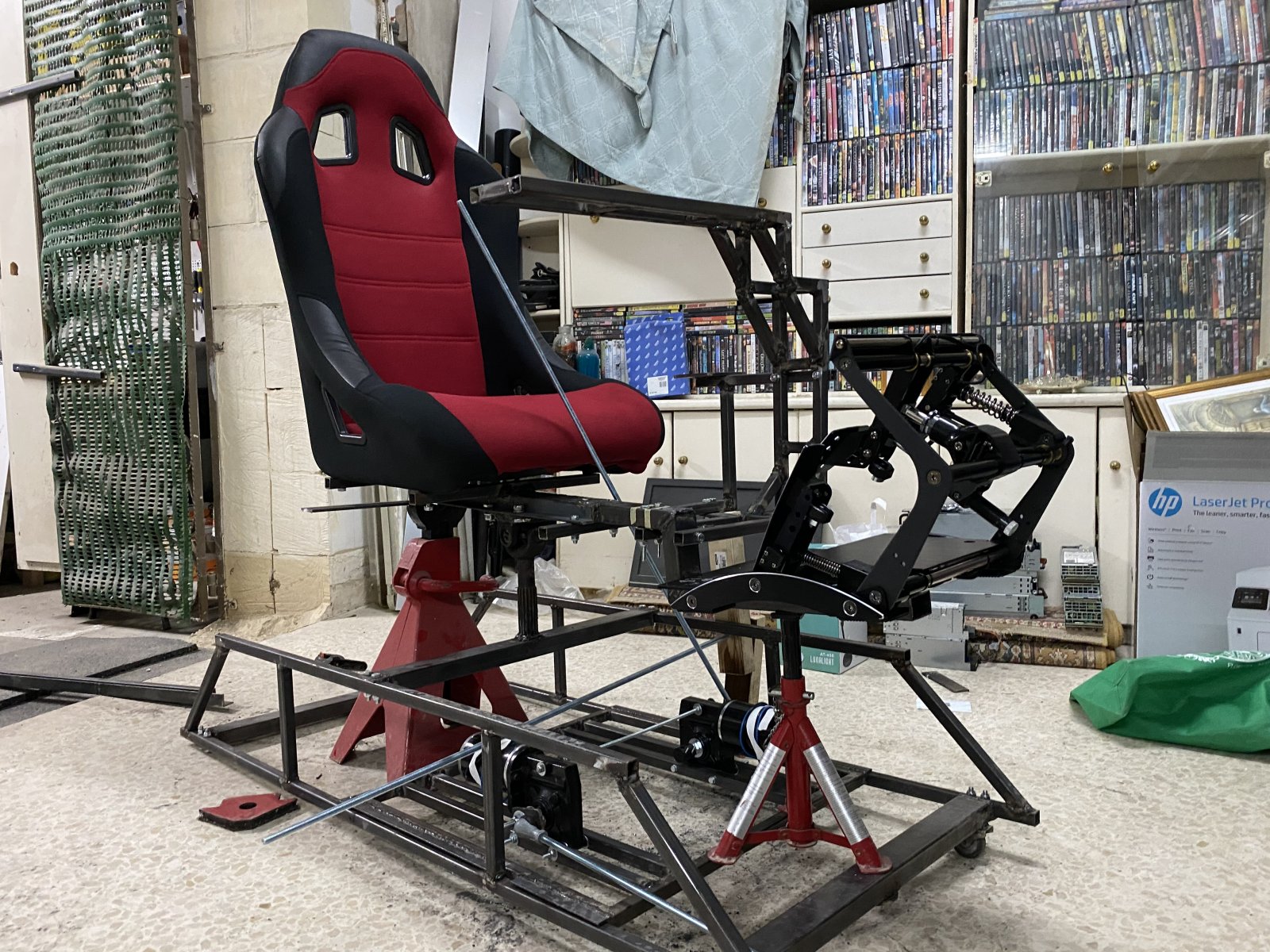

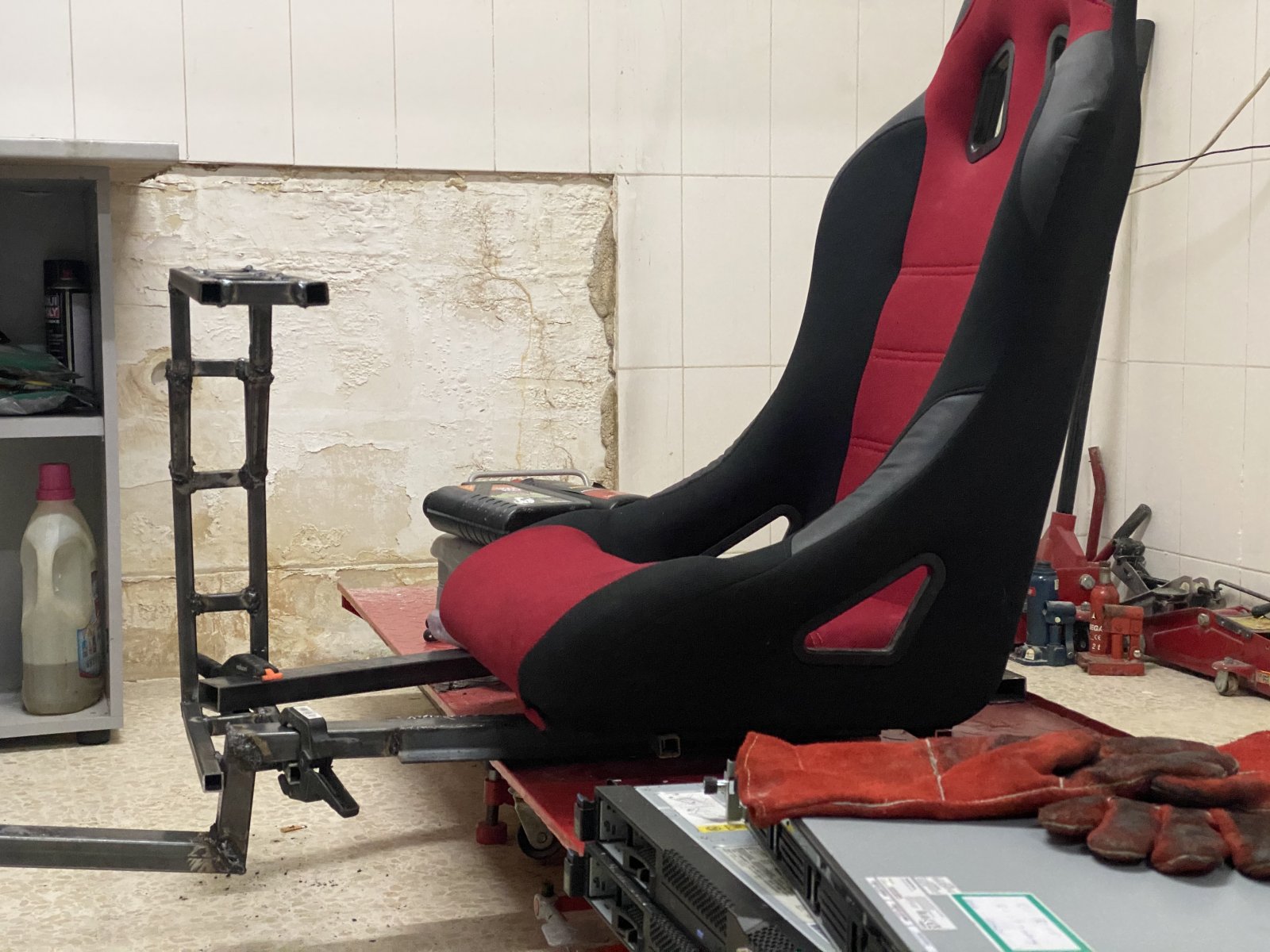

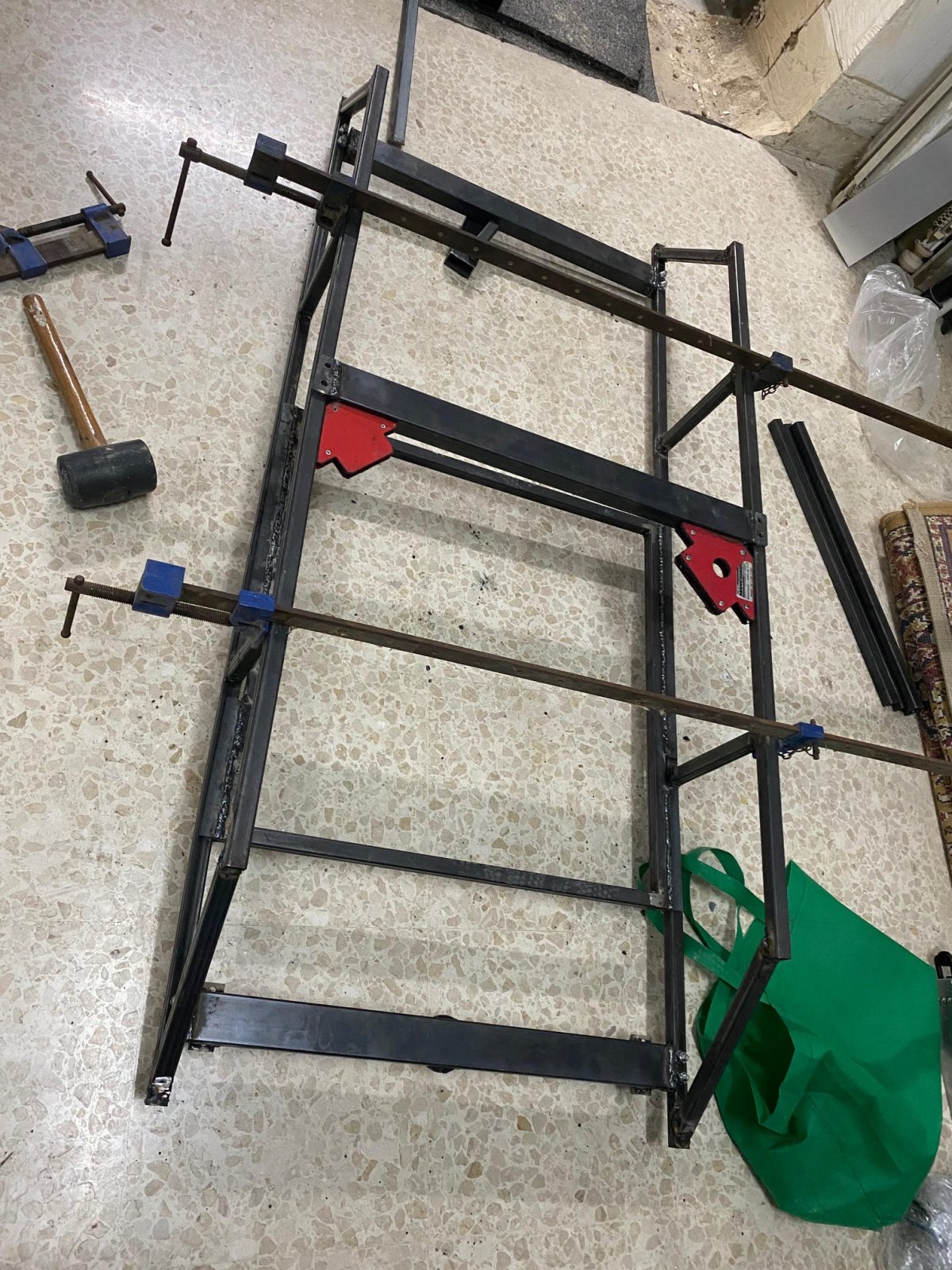

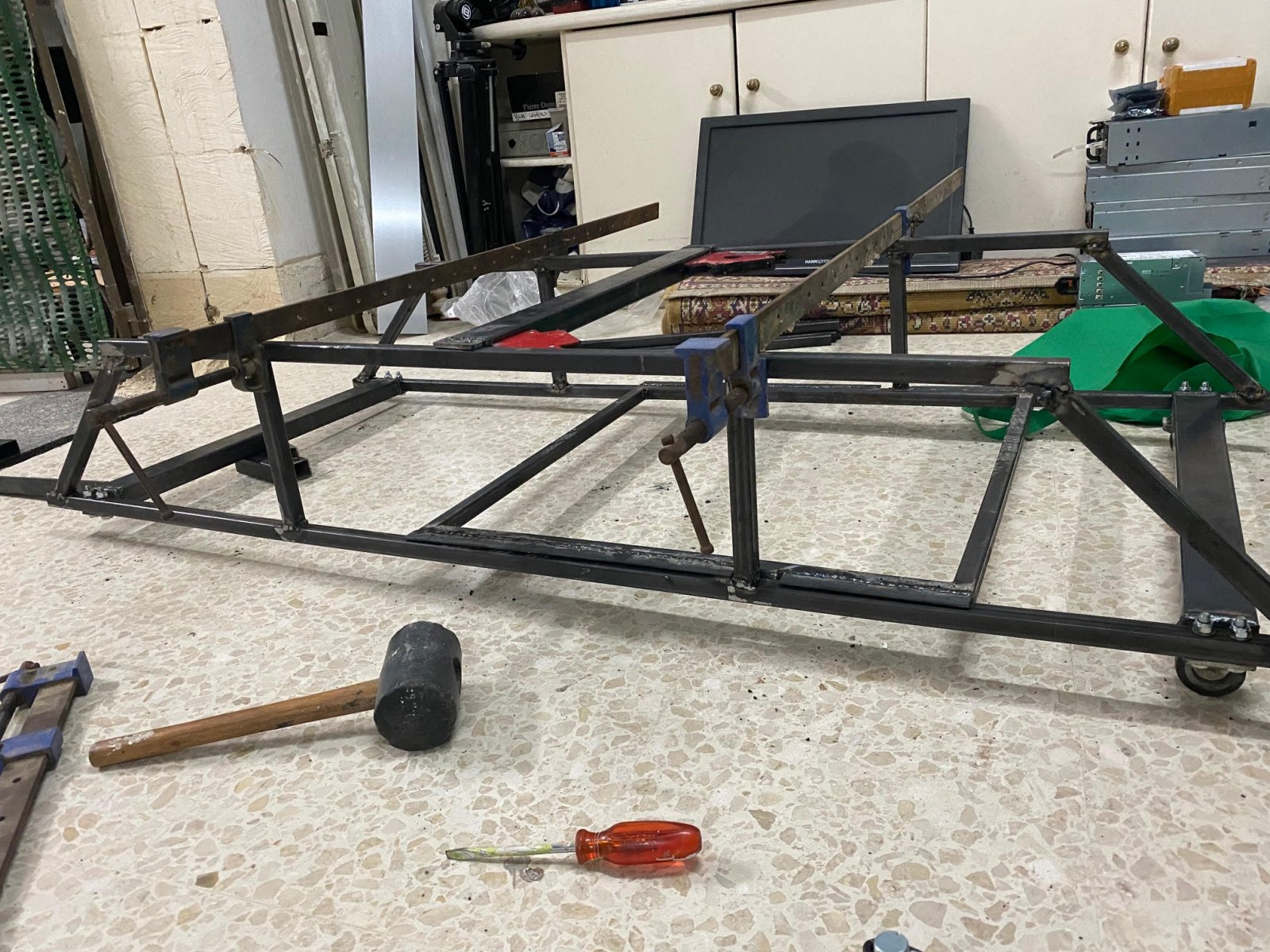

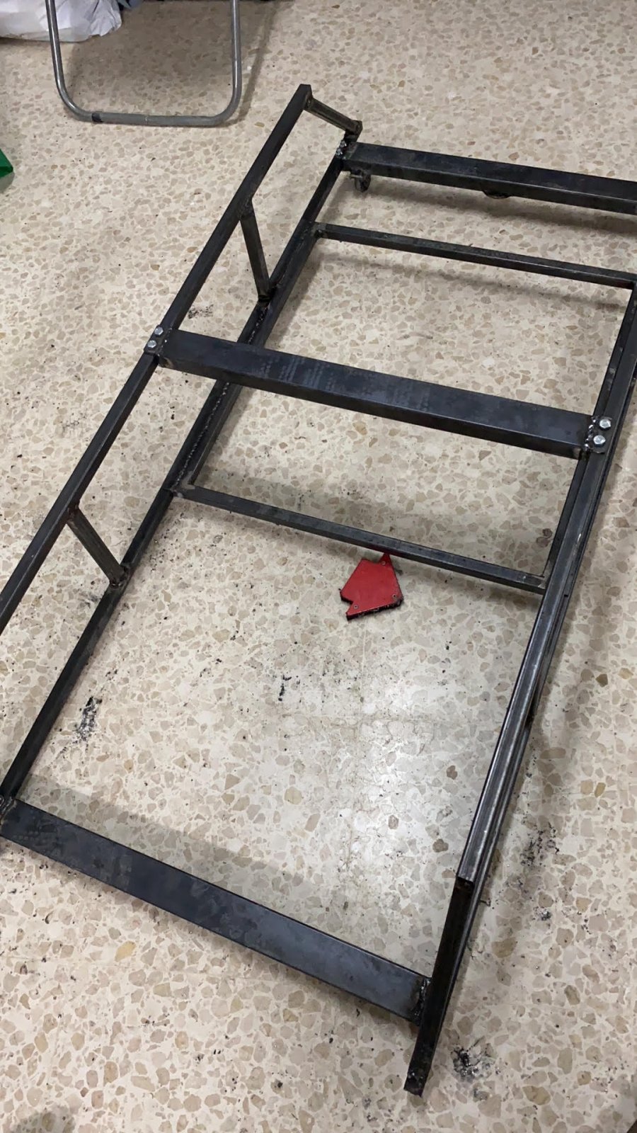

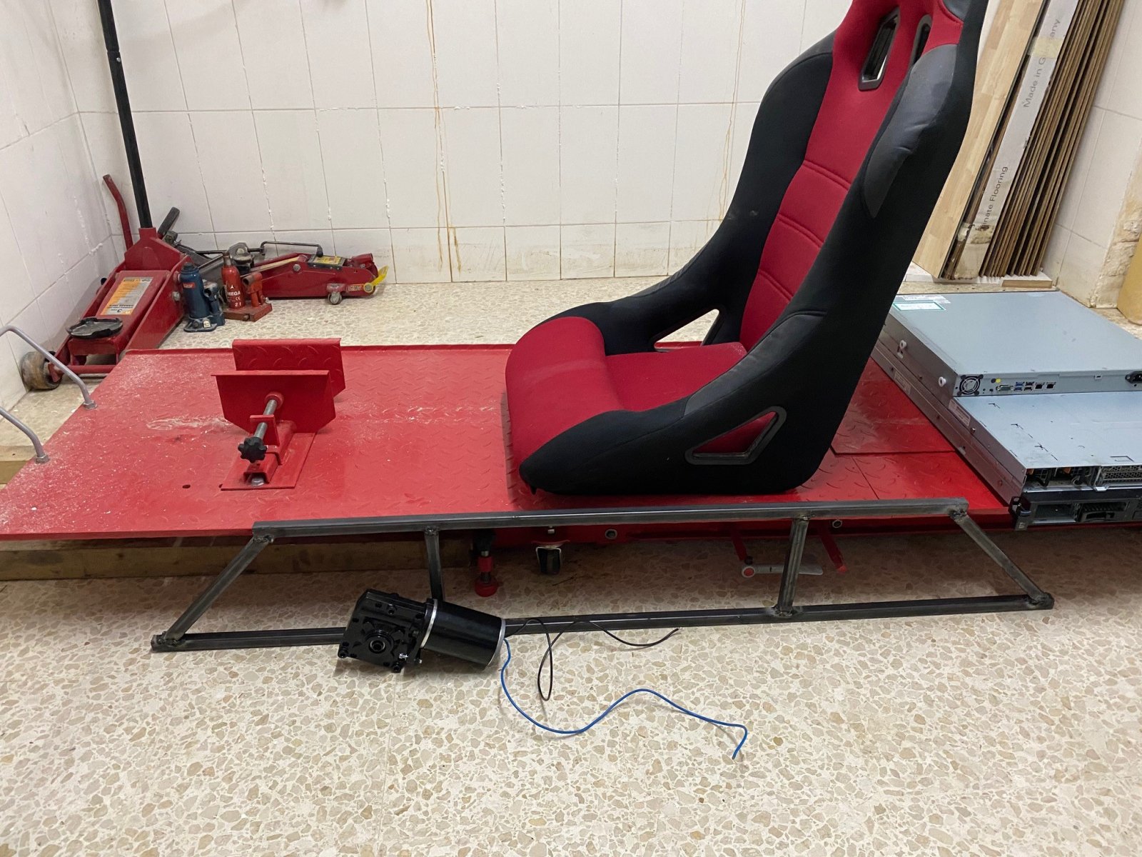

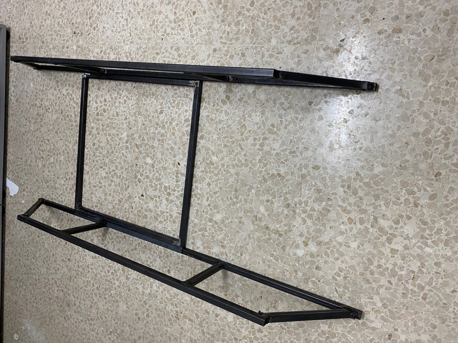

    Today managed to dedicate a few hours and this is the current state.

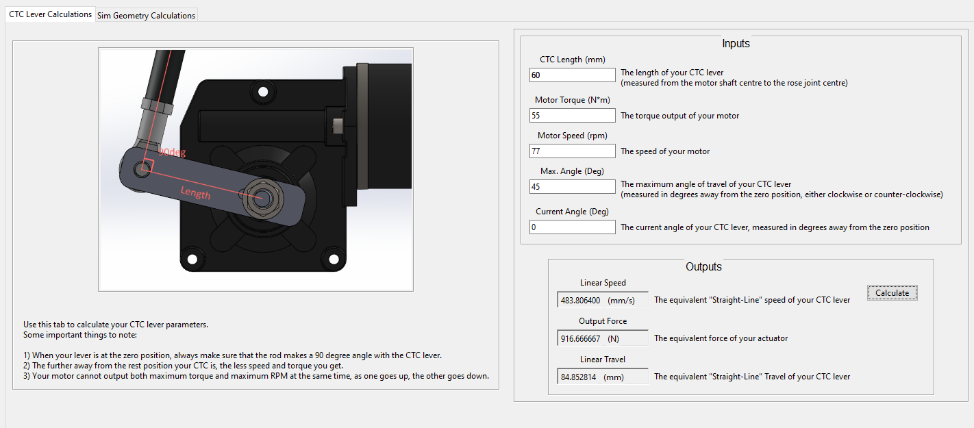

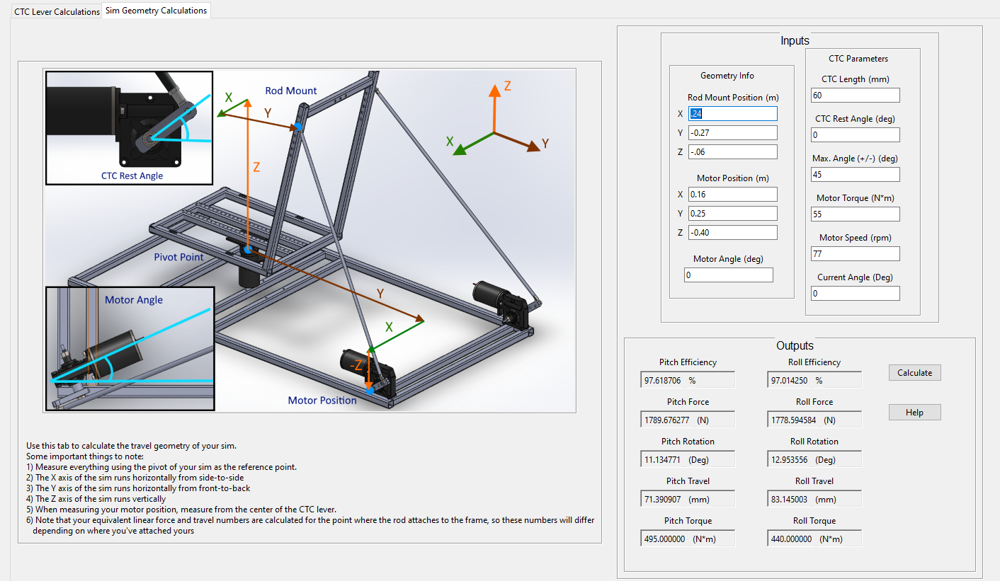

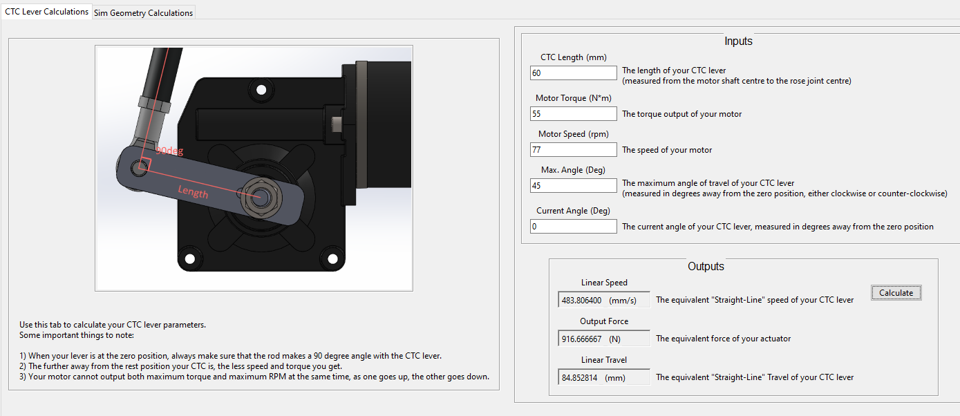

    Im sure im missing something....... does the below make sense for a PGSAW 50:1 motor?
    21,582
    151,106Coins
    The CTC is way too big, 40-60mm is more likely about right, depending on the intended design.

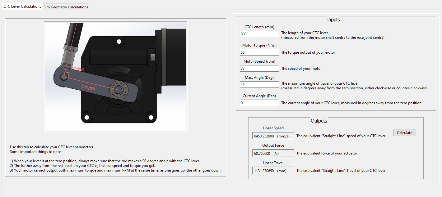

  5. Ian Pace
    Ian Pace Member
    Dec 17, 2017
    72
    Gharghur - Malta
    39Coins
    +28 / 0 / -0
    intended design is based on dof reality p3.
  6. Ian Pace
    Ian Pace Member
    Dec 17, 2017
    72
    Gharghur - Malta
    39Coins
    +28 / 0 / -0
    Hahah now I realized that it’s 800!!!! Should have typed in 80! That’s what happens when you are in a rush!

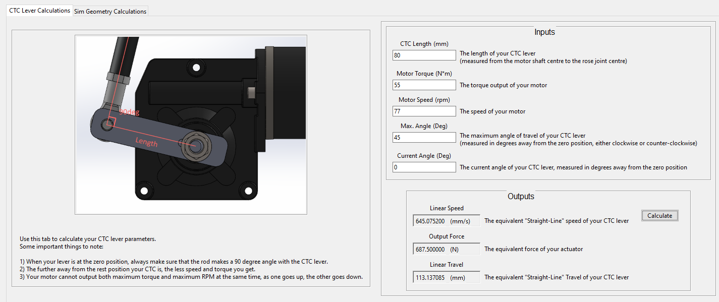

  7. Ian Pace
    Ian Pace Member
    Dec 17, 2017
    72
    Gharghur - Malta
    39Coins
    +28 / 0 / -0
    That's more like it :)
    seems i have a bit of lee way where to play around at least. I will obviously try and shorten the ctc as much as possible.

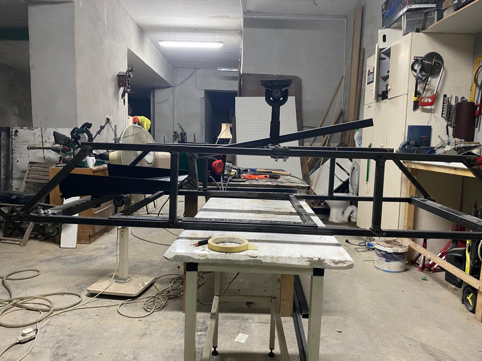

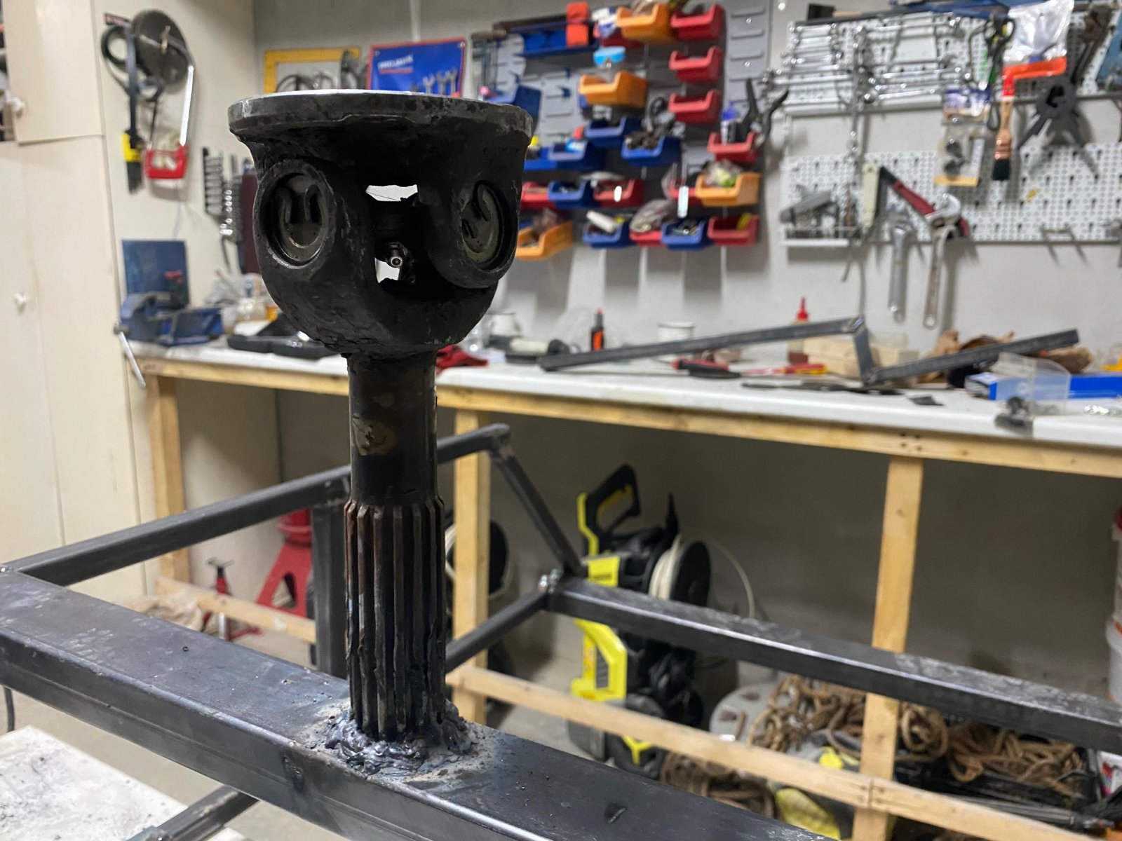

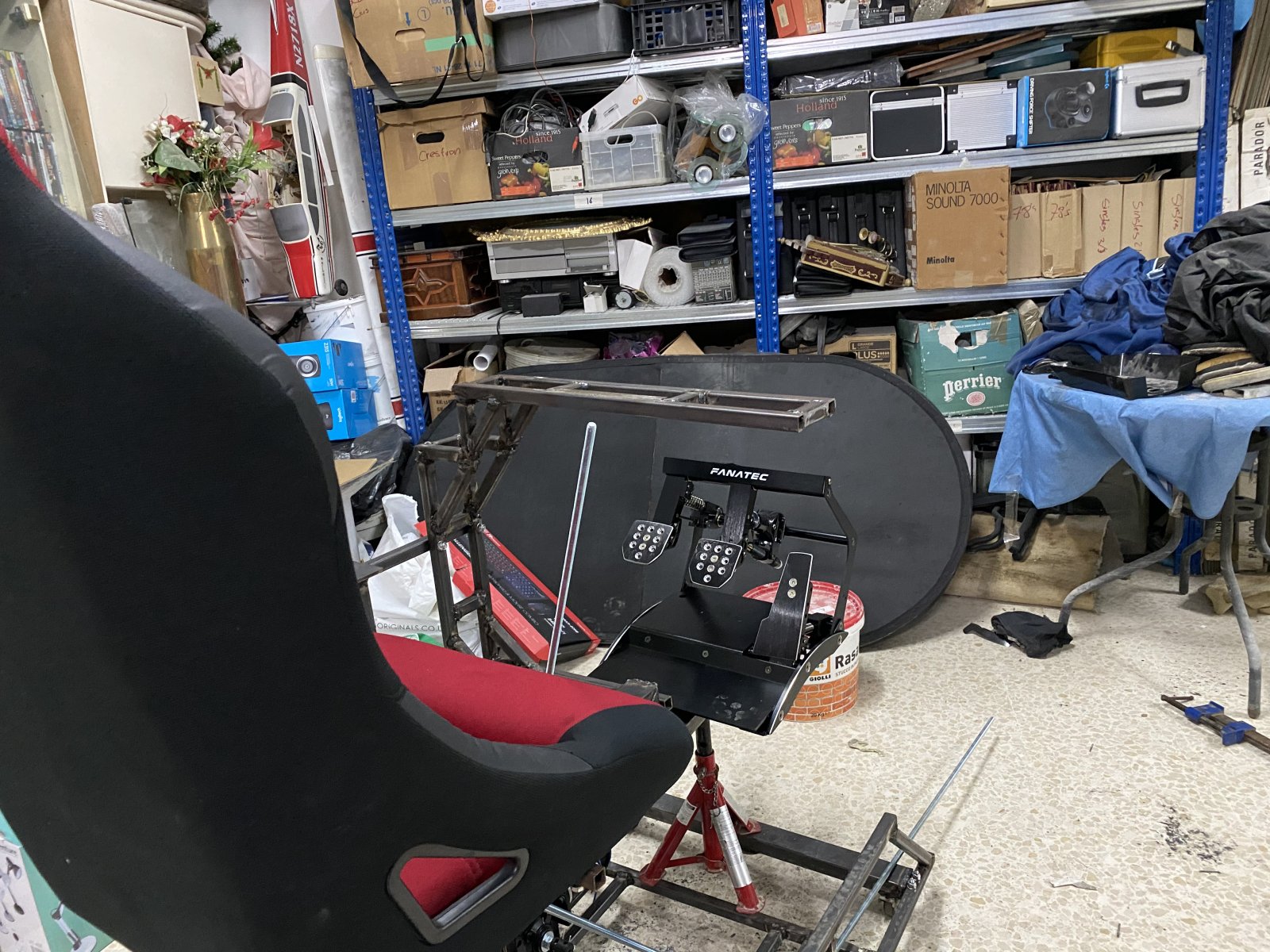

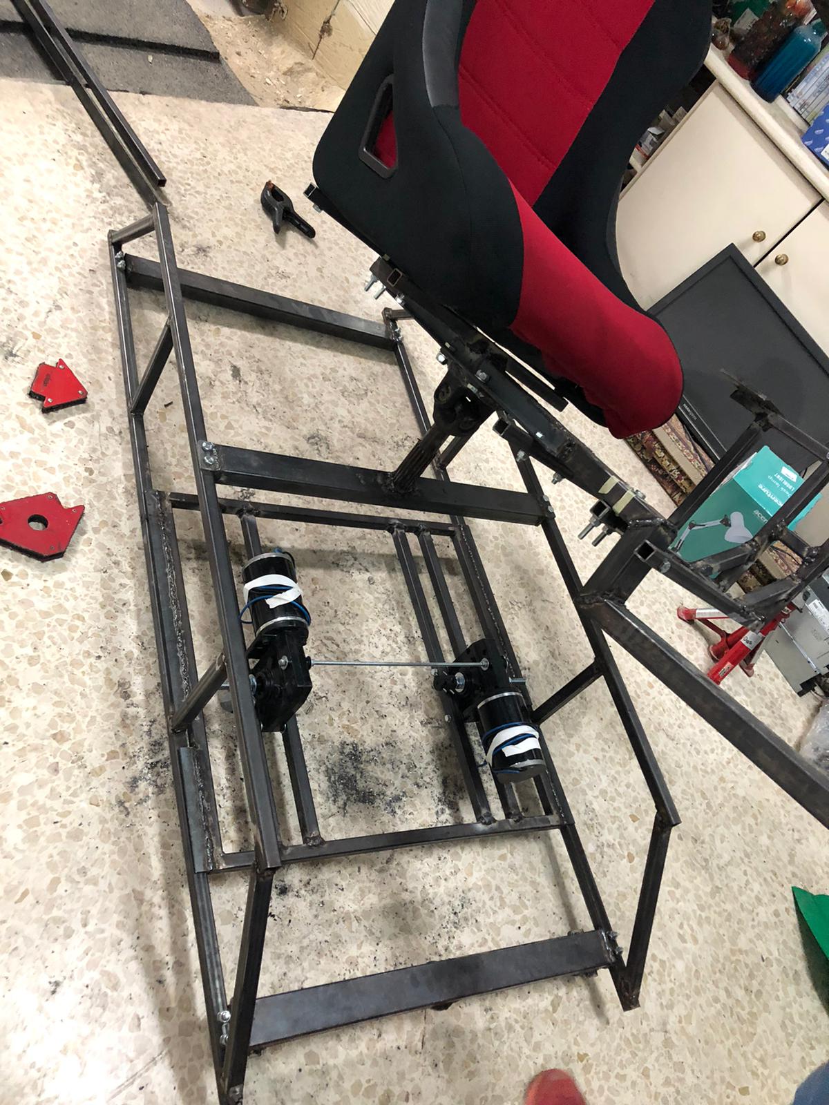

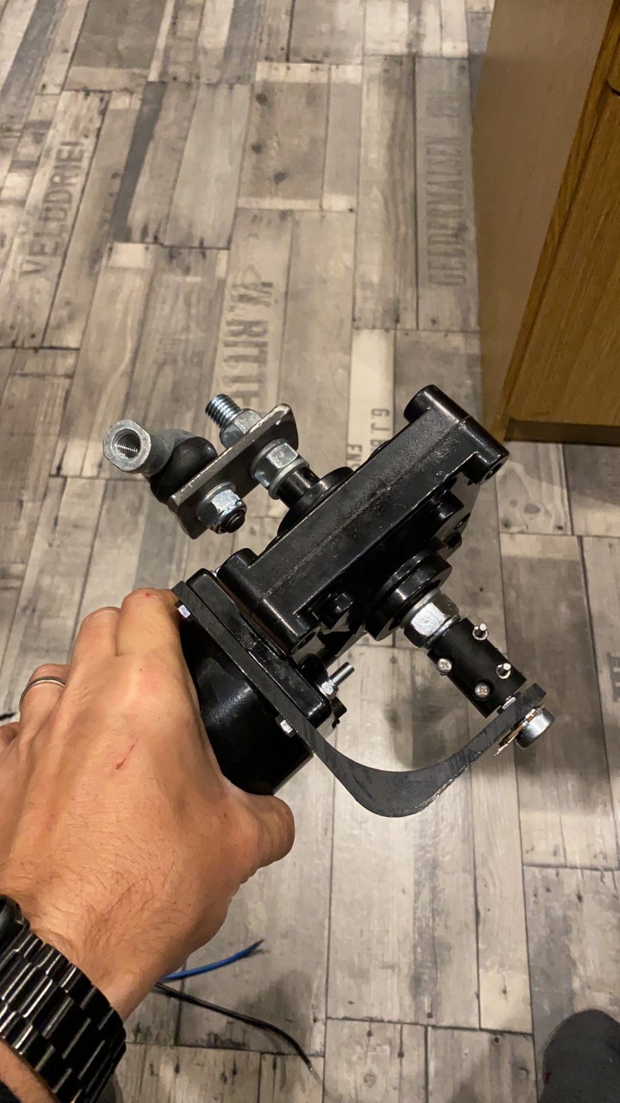

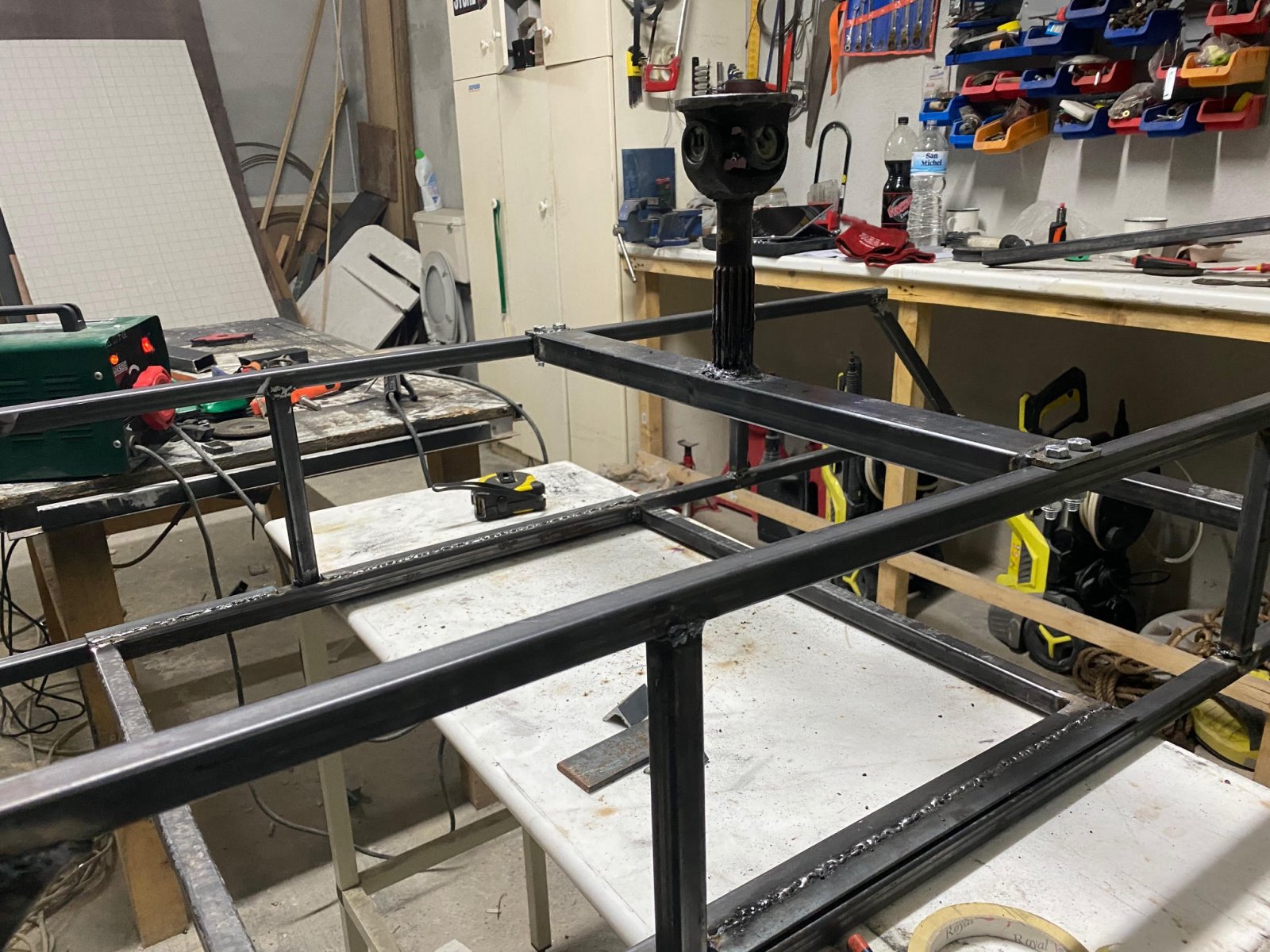

    another small update
    The Universal joint is from a Land Rover defender and i replaced the bearings with new ones, for peace of mind. I guess its an over kill :)
    Just need to support it a bit more as its with diagonal supports just to be safe.

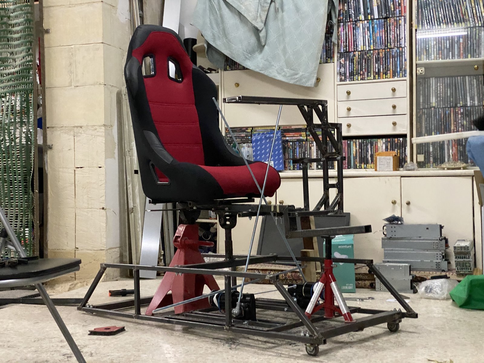

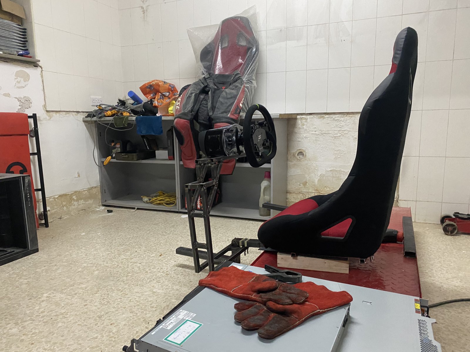

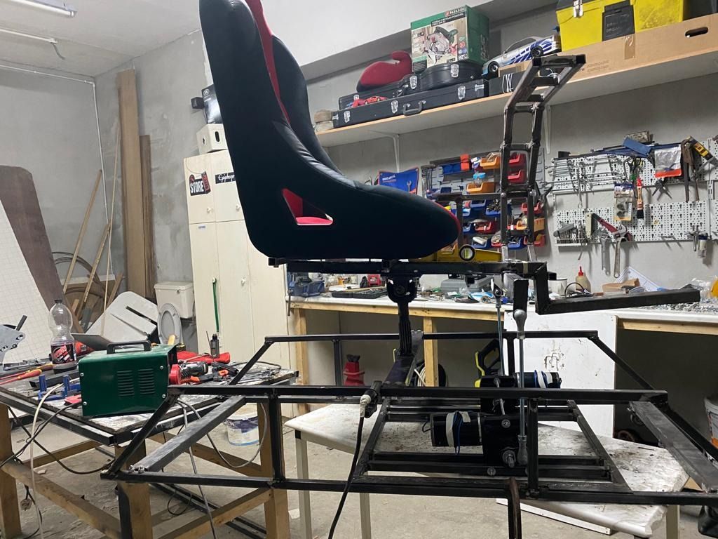

    Some more progress :) :) 2E0A23DA-96A9-4269-805F-437BFCEEBEB3.jpeg C4753DFF-05C0-4675-B3C3-12DBA765C8A2.jpeg 99DF42A6-D0C0-4712-872E-E215EE910ED0.jpeg 9B88EE27-2388-48F0-B697-F57C77577D05.jpeg C4753DFF-05C0-4675-B3C3-12DBA765C8A2.jpeg 9B88EE27-2388-48F0-B697-F57C77577D05.jpeg

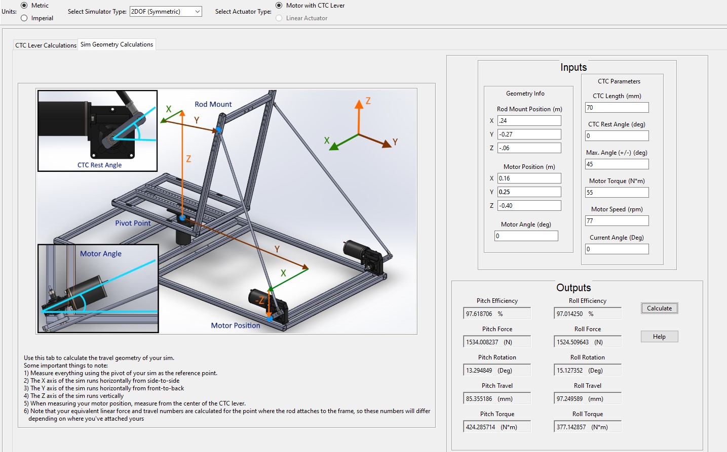

    Hi All,
    I dont know if its because i am tired or if its really the case that i made a humongous mistake with my calculations.
    Do the below values in simcalc make sense for my design?
    are the negative values correct (based on the fact that the rod mount is below the uni joint)
    CTC Value is not the current one installed as its currently at 30mm but considering changing it to 70mm for more rotation.
    Currently its as below
    your help would be greatly appreciated as i am clueless.
  13. noorbeast
    21,582
    151,106Coins
    I suspect your CTC of 70 is a bit optimistic, likely is will be more like 40 - 50 to have the required torque to drive a fully loaded compact full frame rig.
    Disregarding mechanical loss, to know what Newtons it will take to move something it will be Mass (kg) x Acceleration (m/s) = F (N). So to move 100kg at 0.7 m/s needs 70 N. It takes 9.8N per kg to counteract gravity. Keep in mind there is significant mechanical loss in things like the gearbox, depending on the ratio you may want to allow between 10% to 50% loss for worm gears and the greater the gear ratio the higher the % loss is: http://www.meadinfo.org/2008/11/gear-efficiency-spur-helical-bevel-worm.html

    hi noorbeast,
    thanks for your reply. Can you please confirm if the numbers make sense with the negative value? As I am not sure how it can achieve that much efficiency in pitch and roll.
    what is the general consensus of the ideal degree of roll and pitch. This will be used mainly for racing with the very occasional flight sim. I can’t seem to get it greater than it is. Is there anything I can change to get the degrees up a bit?

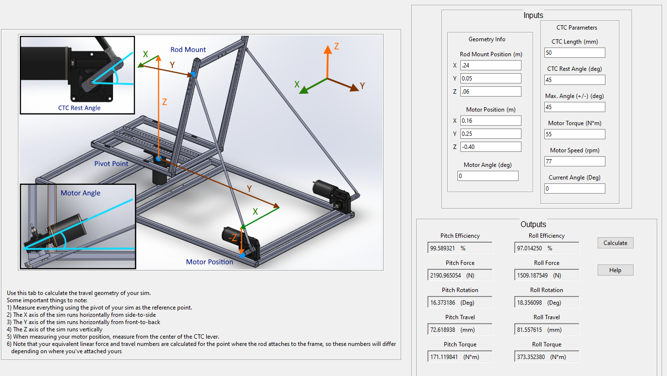

    I am trying to calculate based on the above figures - 9.8N per kg, however this rig is balanced on the UJ, which means that not all the weight is on the motors.
    Lets assume that the total weight it has to move is me plus the frame and accessories, lets also assume that that would add up to approx 150/160kg. Do you think the below is sufficient?
    According to the CTC lever calculations i have approx 916N of output force (without calculating worm gears losses) that would amount to 93kg of dead weight with no losses and approx 69kg with a 35% loss.

    excuse me for another post but i really need to sort this out.........
    this is another option that increases drastically the degree of movement and also the pitch force at the cost of a bit of roll force. Would love your views on both options.
  19. noorbeast
    21,582
    151,106Coins
    My view is that you are unlikely to use the full range in race simulation, though you may in general aviation, which is much slower. If VR is used speed and precision are way more important than range of axis movement, with surprisingly little of the latter needed.
    In other words you are better off focusing on ensuring torque than wild axis rotation degrees.
    A pivot will balance a weight, but becomes a point of rotation for mass with momentum. In a sim rig that mass momentum has to be effectively arrested and precisely reversed all the time. Think of yourself as the pivot, holding a bar with bucket of water on the end while you spin it around one way, then try and reverse and go the other, the reversal is where you would really be straining, as you are arresting the mass momentum. On a sim rig that reversal also tends to happen when the levers on the motor are at the max number of degrees they can be from the rest state, which is where they are least effective in terms of torque utilisation.
