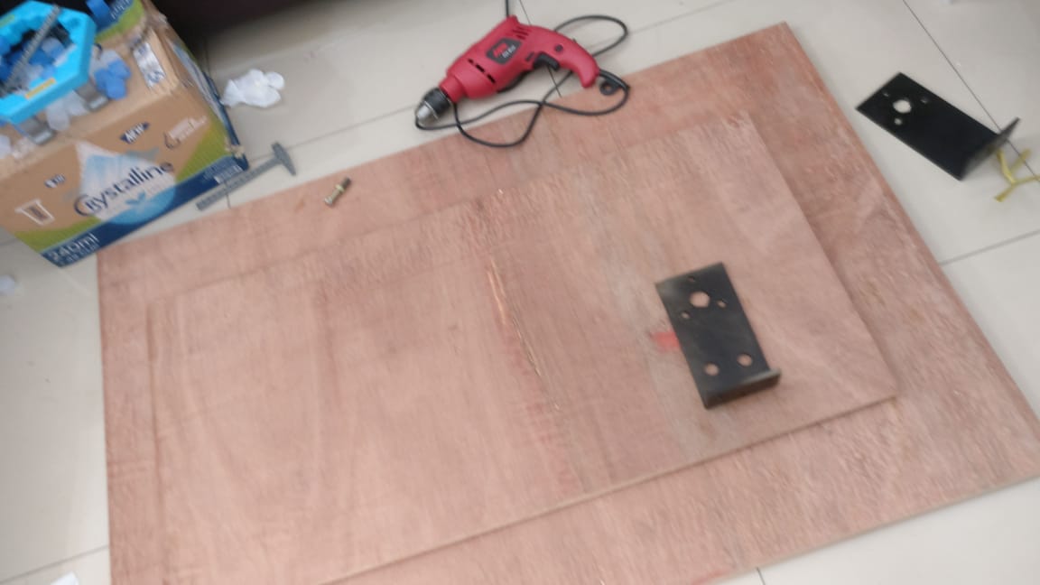

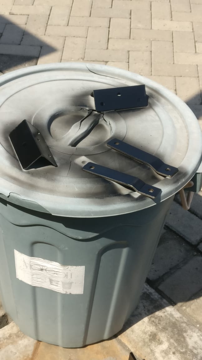

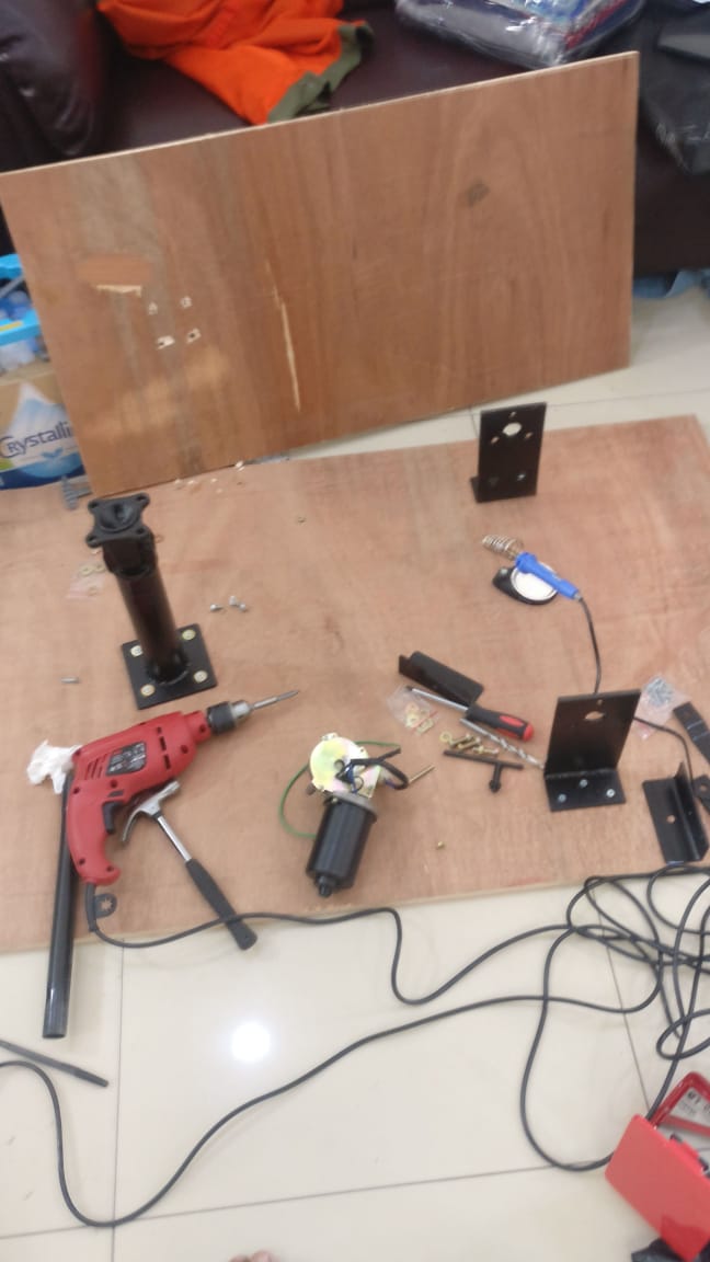

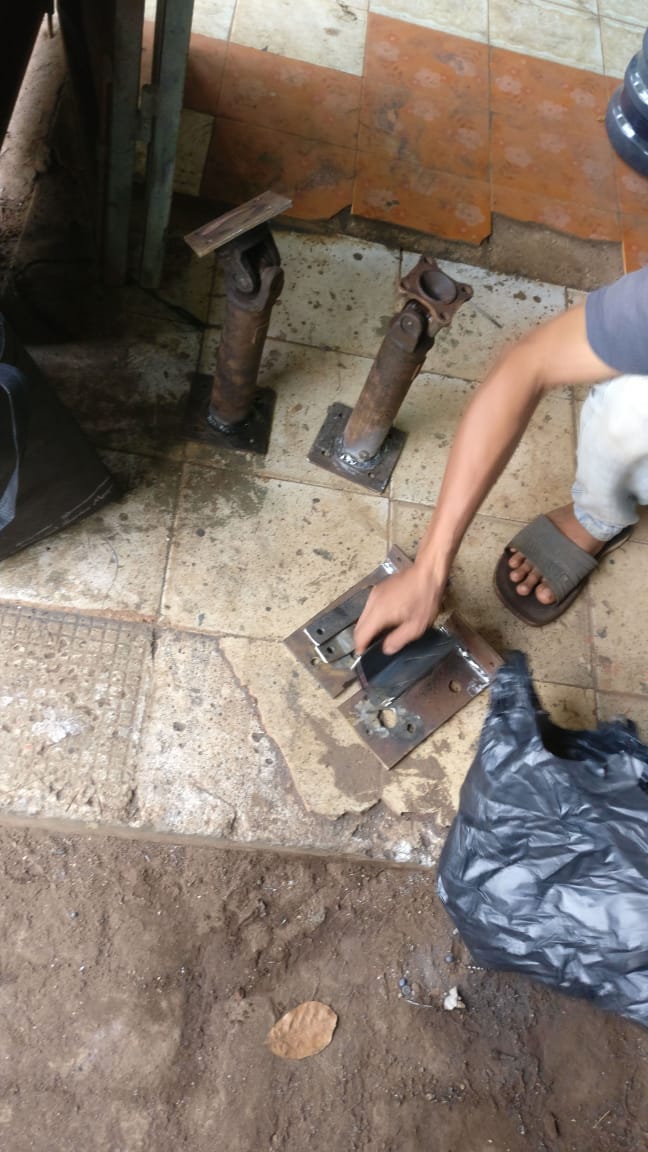

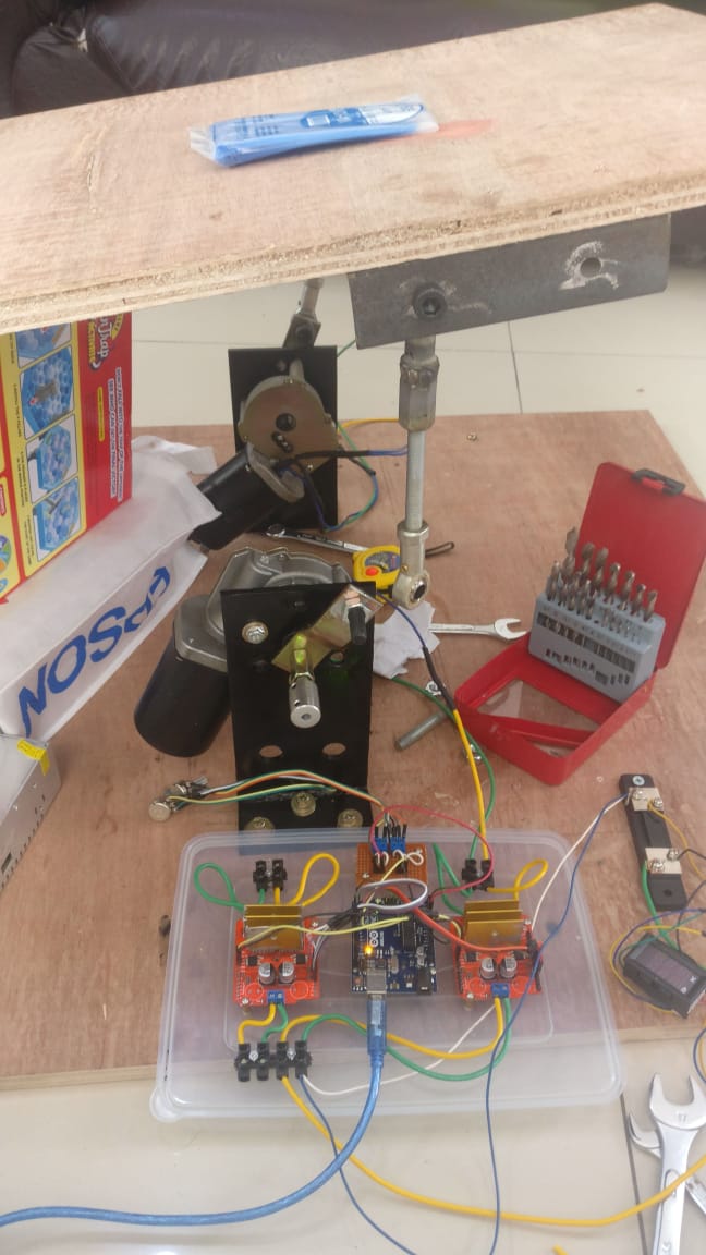

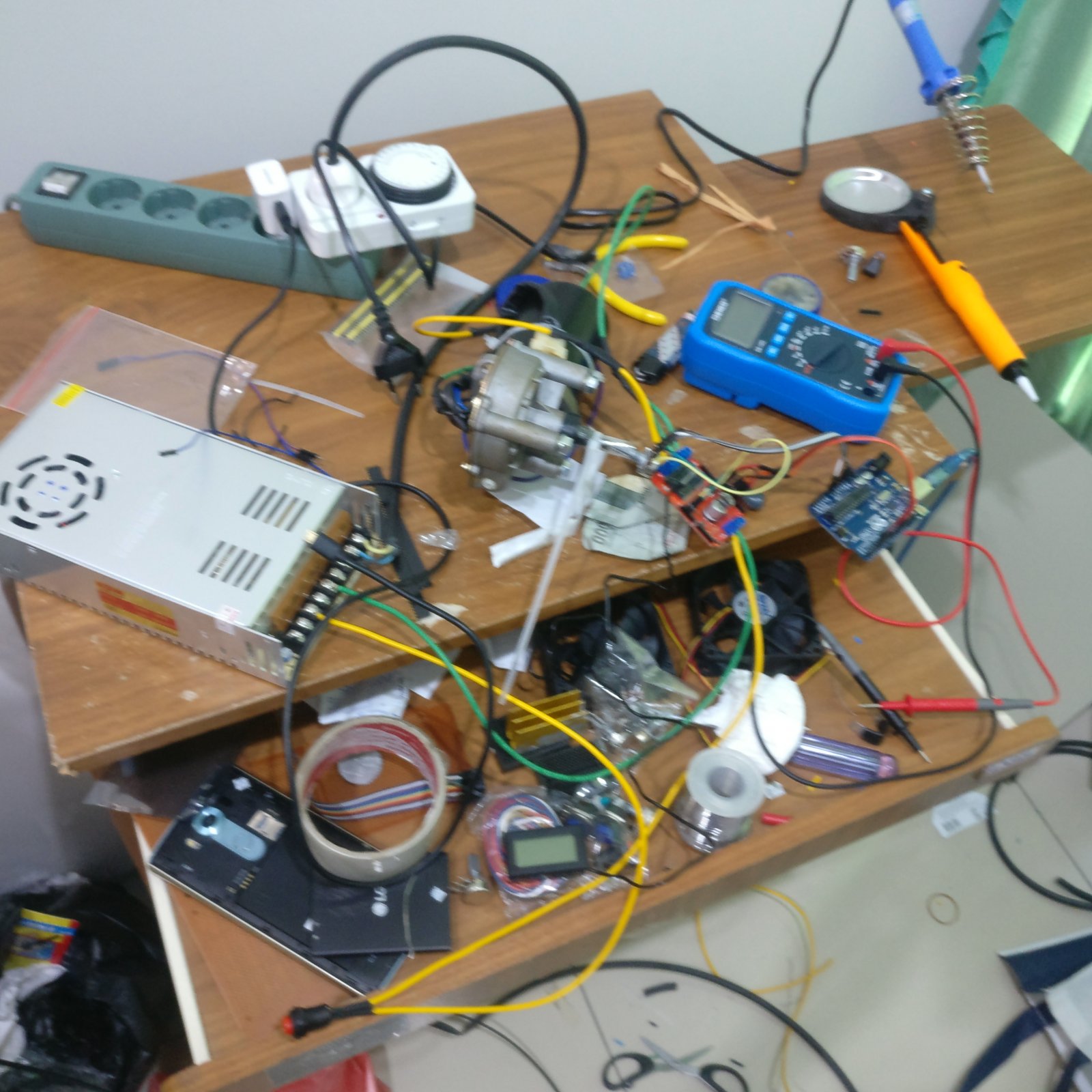

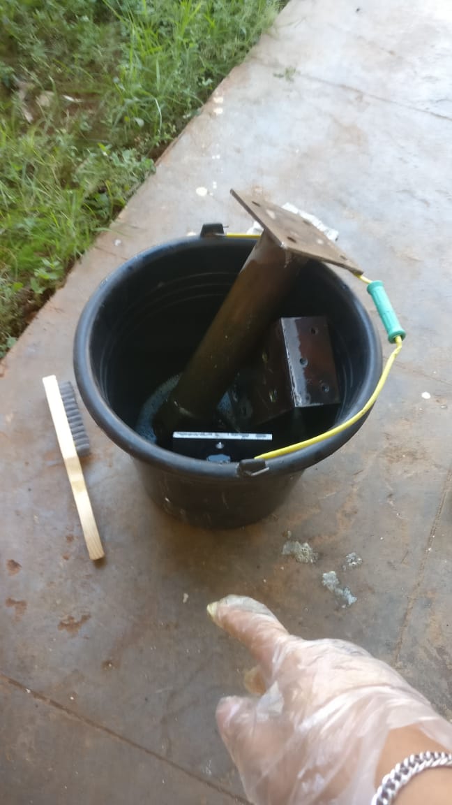

    Nice to meet you ,
    After one month ready this forum, i very interested to make my own 2dof simulator for my prototype.
    I start with following this link :
    Thanks to @RufusDufus , your tutorial very help me.
    here my preparation :
    1. one arduino
    2. two monster shield
    3. universal join from old car
    4. 4 pcs , 10mm ball join
    5. playwood 12mm
    6. 2 voltmeter with ampere meter for monitor the motor load
    7. some spring
    please look on the photo my progress
    WhatsApp Image 2018-07-05 at 5.03.33 PM.jpeg WhatsApp Image 2018-07-06 at 9.41.45 AM.jpeg WhatsApp Image 2018-07-06 at 12.20.29 PM.jpeg WhatsApp Image 2018-07-06 at 1.22.42 PM.jpeg WhatsApp Image 2018-07-06 at 2.48.26 PM.jpeg WhatsApp Image 2018-07-06 at 5.26.36 PM.jpeg IMG_20180706_135343.jpg WhatsApp Image 2018-07-09 at 12.06.20 PM.jpeg
    i will update again after connect with the software
    thanks

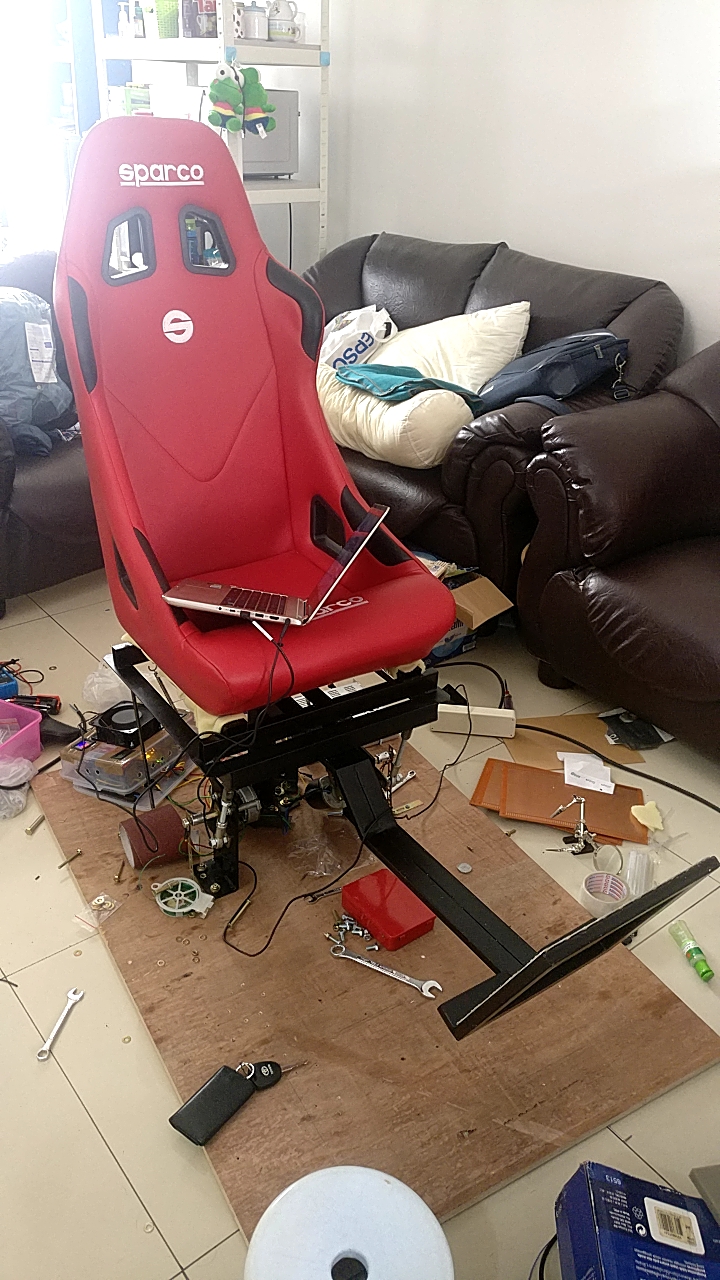

    Hi success connect with scm3 utility
    Now is that possible we connect with android VR for motion ?
    21,592
    151,215Coins
    Nice to see you have it moving.
    You will need a fan for the MM.
    SimTools supports PC games, so I am guessing you mean is it possible to steam to a mobile VR HMD. Yes it is possible but not recommended, and can make some people sick, particularly with fast moving game play and the very real possibility of lag.

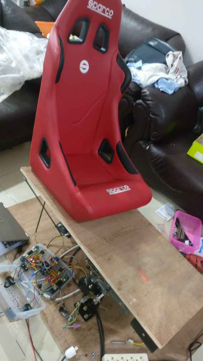

    Hi Good Afternoon,
    after one month i try my RIG. I redesign because some problem.
    here my new RIG
    now i facing the torque power , maybe because my weight.
    now i consider to change my motor ..
