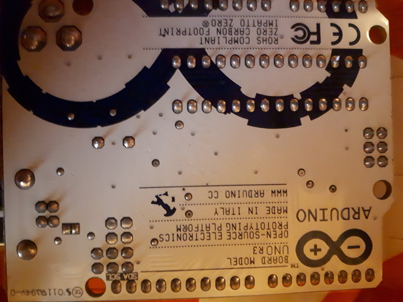

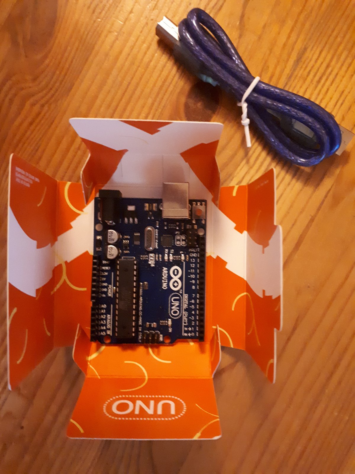

    I ordered Aurdion and Monster Moto Shield for Arduino and I wanted to connect it to the RC servo to test everything and learn how to work. Unfortunately, I have not come across a complete tutorial describing the 2DOF model with RC.
    1. I have no source yet, will it be with a PC source 400w?
    2. Does the RC servo have to connect with Monster Moto?
    3. Is there any help + connection?

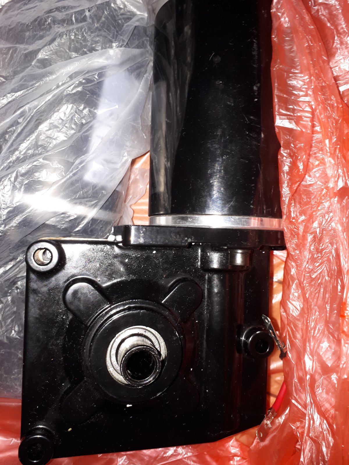

    1. Will these engines fit for my 95Kg weight? http://www.vdkelektronika.eu/Stejnosmerny-DC-elektromotor-12V-200W-s-vodvodovkou-d1420.htm
    2. What source should I choose from this eshop? https://www.czech-server.com/components/sources.html
    3, Does anyone have experience in buying ebay engines and transporting them to the Czech Republic or the EU?
    Proposal to buy 2DOF material:
    2x motor 12V / 200w http://www.vdkelektronika.eu/Stejnosmerny-DC-elektromotor-12V-200W-s-prevodovkou-d1420.htm

    For the RC model follow the instruction and use the code from here, the only change for SimTools 2 is that the Axis Interface should be like this R<Axis1a>~L<Axis2a>~F<Axis3a>~ : https://www.xsimulator.net/community/threads/2dof-simulator-servo-model.6851/#post-77270
    While I can't read it all the motors you linked look to be the same as others from various suppliers around the world.
    I can't open the czech-server.com link.
    Here is an alternate Canadian supplier many have used here and who can ship internationally:
    25:1 - https://www.ebay.com/itm/GEAR-MOTOR...384?pt=LH_DefaultDomain_0&hash=item51bd392f00
    50:1 - https://www.ebay.com/itm/GEAR-MOTOR...L-FEED-SIMULATOR-75-80RPM-50-1-/371596157992?

    Finally, Arduino module arrived for me to play. I have also arrived 12V 200W motors with worm gear. Below I'm sending a video from a RC simulator of motion, which needs to be tightened. Next week I should build a construction and order a PSU.
    I have questions:
    1. Do I need a 2x shield motor or is it sufficient for only 2DOF?
    2. How much do I need a PSU for 2x 12v 200w motor?
    Thanks for explaining
