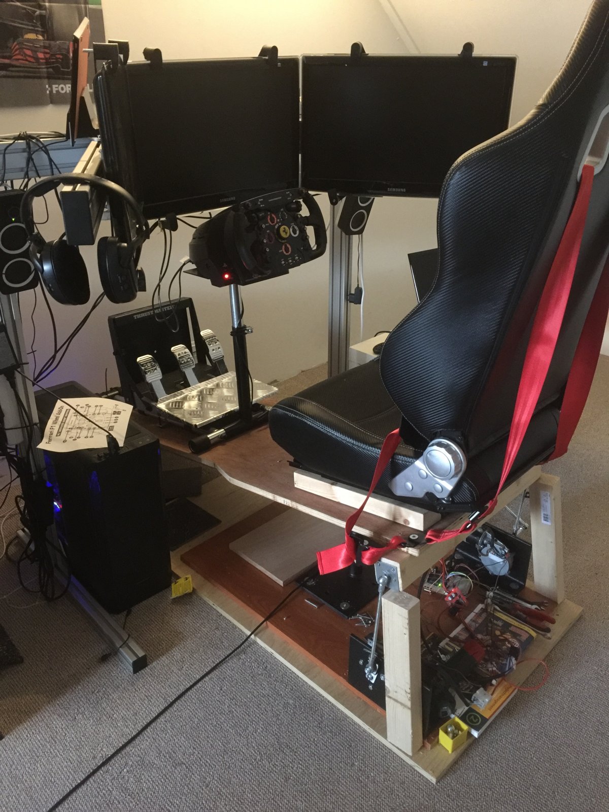

    Since last year last year we are building an own race sim. I'm working on the software part and Paul is doing the mechanical part. The base is made of wood and a rear axle of a Volkswagen Golf 3. The engines are Paul's windscreen wipers his work of a Ravo sweeper (machines cleaning the street streets). We also use an Arduino with a motor controller. We used to use x-sim until recently and got a lot of trouble, but if we turn on a game and run the simulator, a com-gate error (electrostatic disturbance on the comport?) Always appears. One of the solutions we now want to investigate if the comport error also appears when using sim tools using xsimulator.

    Here are some pictures of the sim so far. Just to let you know we are building for a year now (in our spare time)

    Yeah, I tried last weekend, and got no comport error anymore, so that looked great!! Now have to adjust the zero of the potentiometers and mount the potentiometers on the axe of the wipermotors

    What do you mean with: There looks to be limited inherent design leverage.
    We grounded the wiper motors, but in x-sim this did not prevent the com port error from occurring. In Xsimulator there is no com port error so far...
    21,511
    150,686Coins
    +11,018 / 55 / -2
    I also have a compact design rig, but it has more powerful motors, so what I mean is there is a limited distance from the pivot point to the motor connections, which is like a short lever, compared to say a shoulder mount design, which is like having a much longer leverage length.
    Have a play with SimCal to get an idea of the physiscs involved: https://www.xsimulator.net/communit...e-linear-speed-and-forces-of-your-design.270/
    A compact design needs a fair amount of torque to move the mass and wiper motors are not usually that powerful.

    We have calculated it and the most ideal situatie is the pivot point 40 x 40 cm from the arms, in this version the distance is 34 cm x 34 cm. I will take look. These wiper motors are from a Ravo sweeper (machines cleaning the street streets), little trucks. So they should be powerful enough (maybe we decide later to build in more powerful motors, and now get some experience with this setup)
