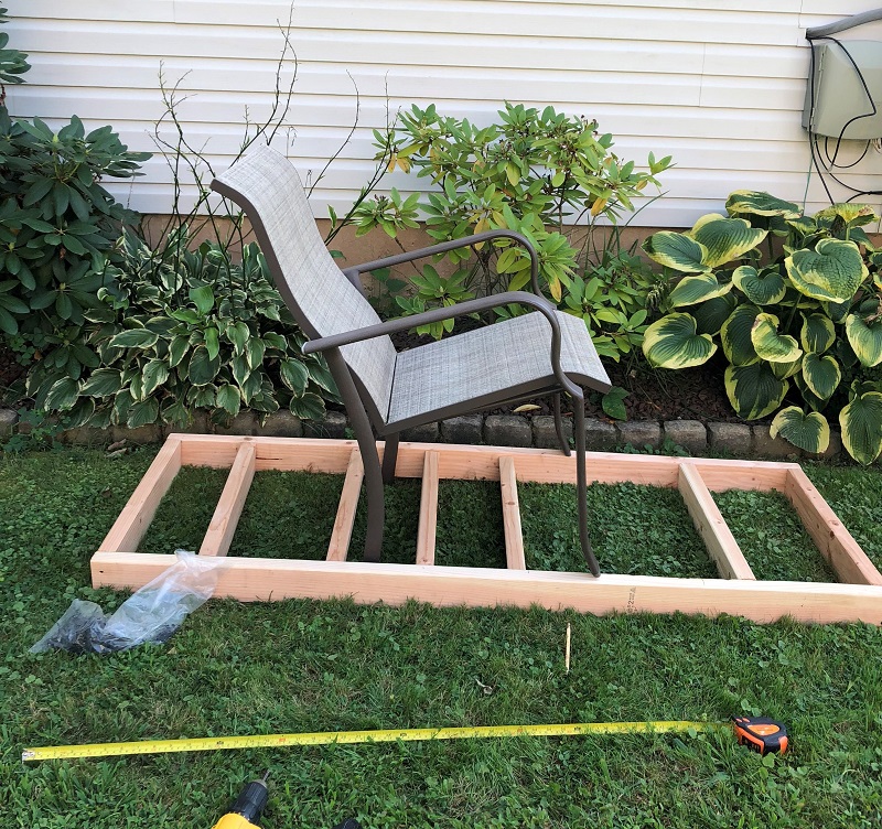

    For this first phase, I tried to keep welding to a minimum and used 2x4s for most of the construction. The plan is to keep things flexible for future experimentation, expansion, and keep initial R&D costs down )

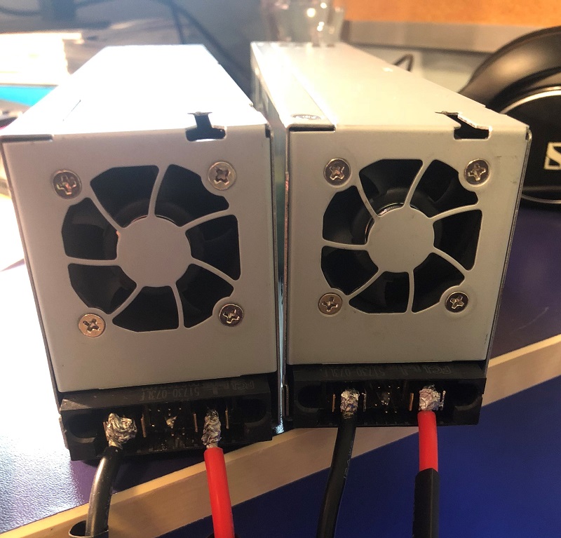

    Transducer setup:
    2 x Auras 50W
    MEAN WELL LRS-200-24 powersupply
    Sure Electronics AA-AB32971 2x100W Amplifier
    2 x USB sound cards
    Product of all the sufferings)

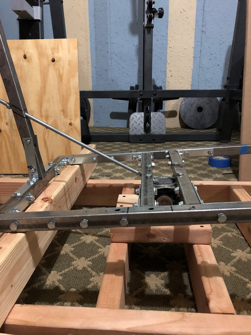

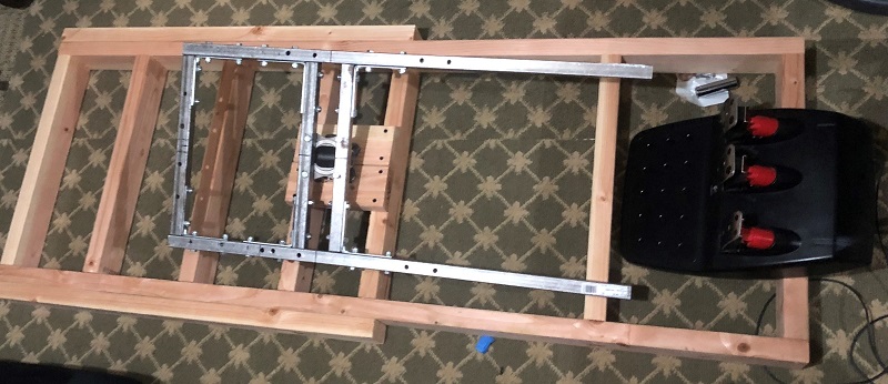

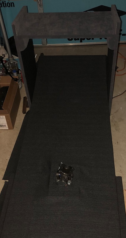

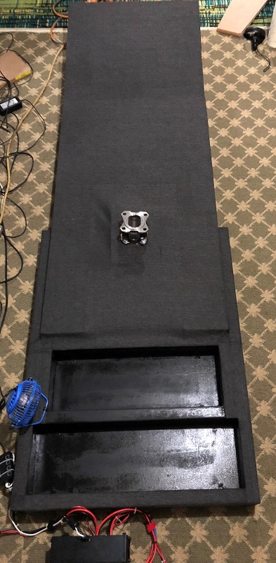

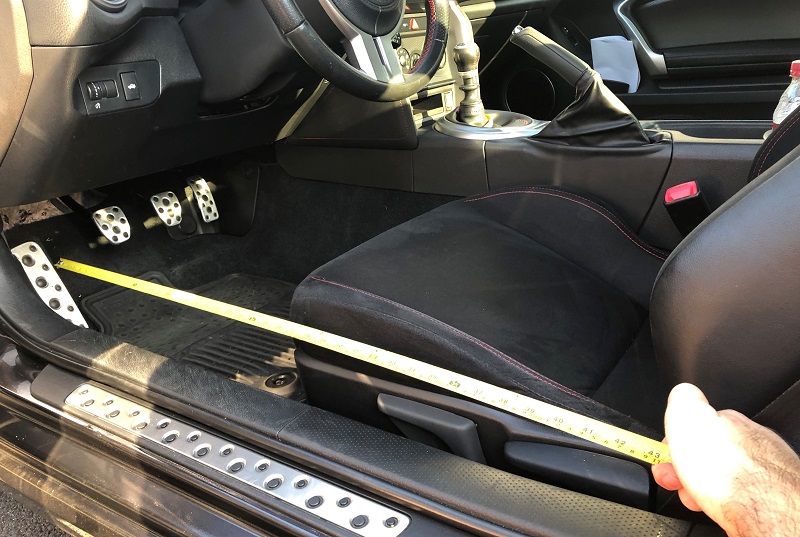

    I really like my driving potion, so I tried my best to recreate all of the measurements, pedal, seat, steering wheel height.
    I went with a 2 x of Flange Yoke as suggested by someone on this forum. Putting U joint together was not as easy I thought it would be, using proper tools would have made this part of the project much easier. I don't own a welder but have access to one, so for the initial version of this project I decided to bolt things together and get it working first. The threaded rod helped a lot with front to back flex in the brackets.

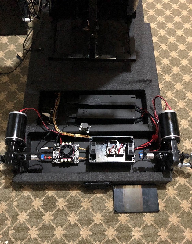

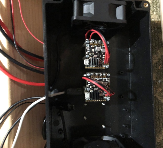

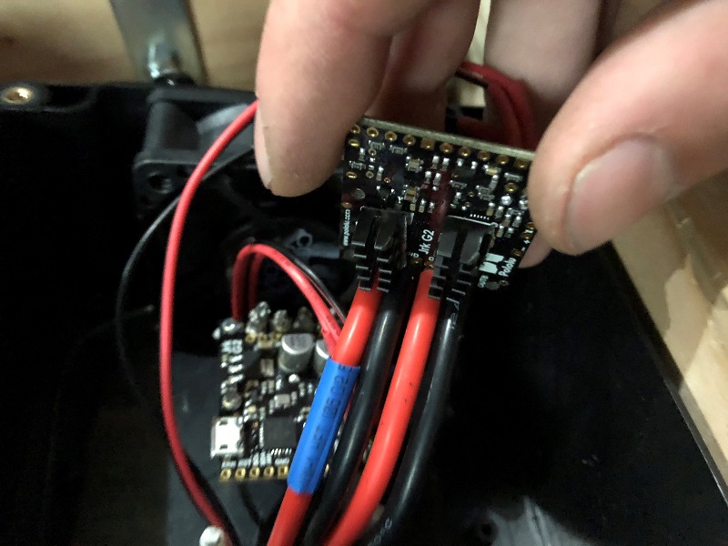

    I used a project box to house the JRKs mounted on Nylon spacers, and ran dual 60mm fans to move the air over the JRKs. I also soldered the wires directly to the boards as terminal blocks are only rated for 16 A.
    I soldered all the necessary pins together rather then running multiple connectors

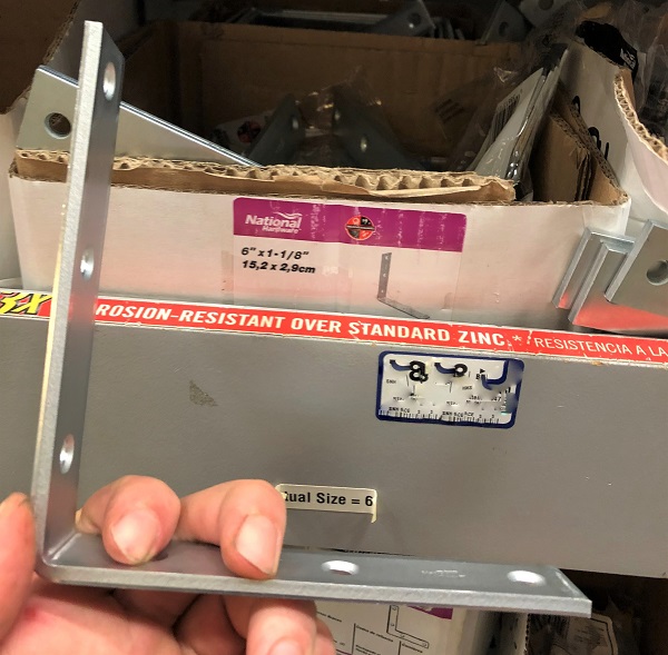

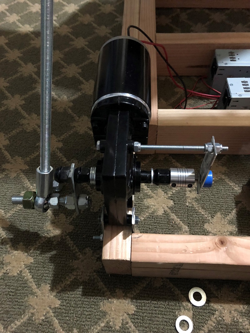

    This bracket was perfect thickness and spacing was a hair over ~55mm, exactly what I was looking for
    I was able to pinch the gearboxes on this 2x4 on both sides, this setup seems to hold up to the abuse so far. I went with QA1 Precision Products NFR8 rod ends, and used wheel nuts instead of conical spacers.

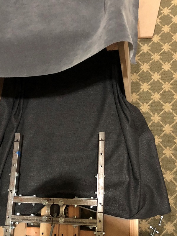

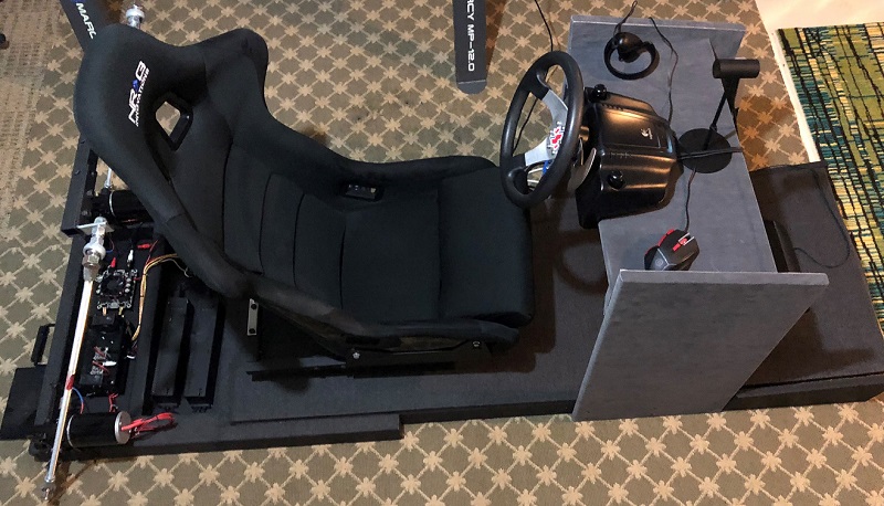

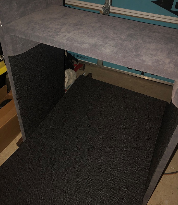

    I decided to go down the wrap route.
    Was lucky to find this suede like material for the "dash") Came out really nice.
    Built a little enclosure for all of the electronics in the back

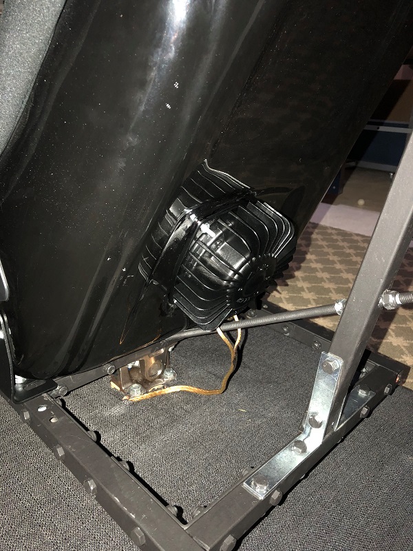

    I spent a few hours on the simulator before tucking all the wires away, and decided to expend this first part of the build and go for the bass shakers setup. I felt like I was close to what I wanted out of the setup, but something was missing, and for me it ended up being the missing bit.
    I mounted one in the lower back area, and the second one right underneath the pedals
    All of the business in the back ) I already have the 3rd JRK motor, TL is somewhere in the future, but at the moment this will do!

    Hi, Great build by the way. I am looking at adding more transducers to my RIG. I have a single buttkicker gamer mounted to the back of my motion platform now, but wanted an opinion on the 2 x Auras 50W
    and your Sure Electronics AA-AB32971 2x100W Amplifier. My question is - if you mounted those Auras in the front of your rig (that's what I am planning to do btw) would they have enough power to simulate curbs etc..
