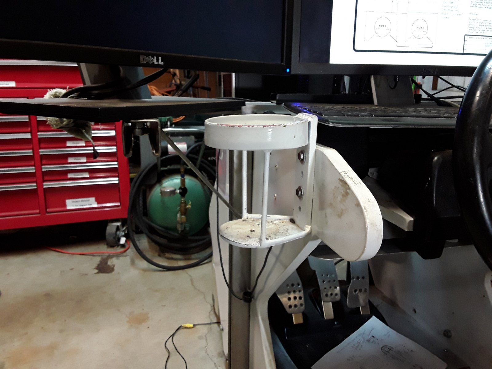

    Hello friends,

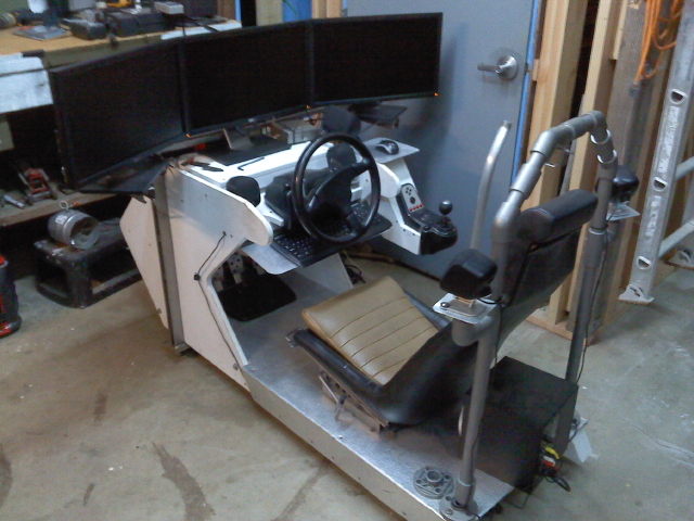

    I have been reading posts here for many years and I'm now undertaking a move to motion with my static rig.
    Starting with Grand Prix Legends on a laptop; with a new baby on the way; I bought a G27 and had a chuckle with my wife about pretending to race...
    Well I didn't realize how much I would enjoy sims and building to make it more immersive. I like to work in metal and wood because of the fabrication and carpentry work I've done. The last ~10 years have placed me in municipal wastewater operations/maintenance where I've acquired some knowledge of industrial motors and controls.
    My "racer" (kids name) for my rig? Began from photos of the RS1 cockpit on isrtv and my best guess of measurements to suit me with several iterations of seating; porsche 914, welded office chair, vintage bucket.

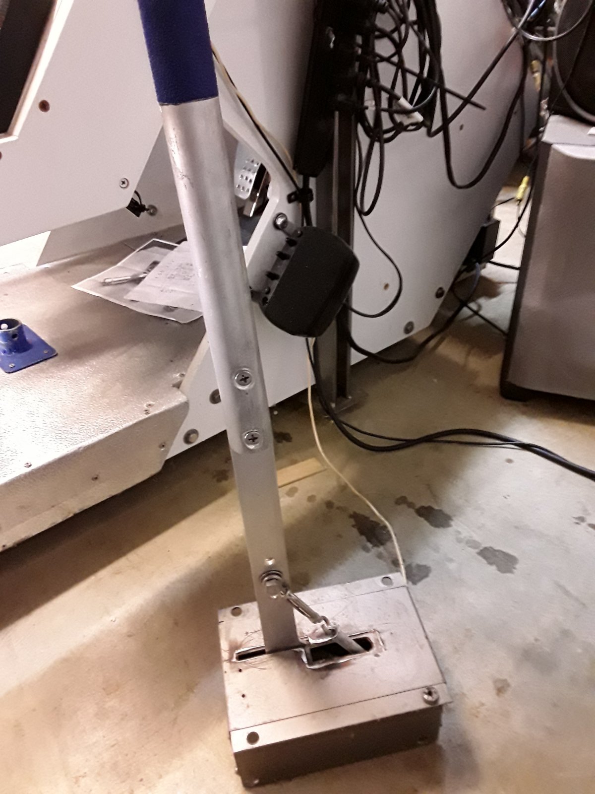

    A few things have turned out well: a bournes pot handbrake from alu pipe/scrap,

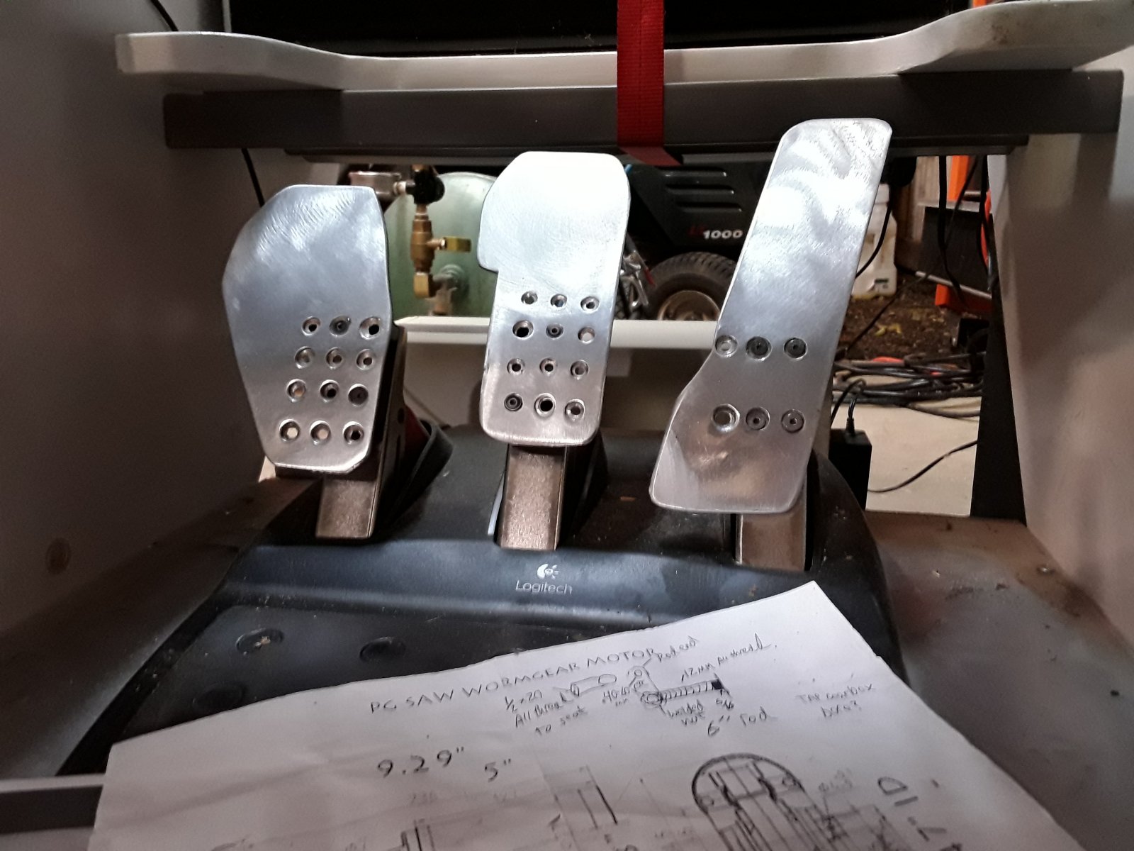

    custom alu pedals from a clip I'd seen of Magnus Walker discussing his race pedals.
    20181125_210038.jpg Craigslist, scrap and thrift shops have helped along the way.
    A heady mixture of MDF, cut aluminum signs, ss unistrut and bad lawnmower gas smell in my shop have fueled my passion (helps the immersion LOL).
    Running dell workstations (t3500, and t5400 with gtx 750tis), I'm constrained to but enjoy GPL,GTR2 (P&G!), Rfactor, RBR, Rally Trophy, Dirt Rally, ETS2, MSFX, IL2 Sturmovic = older sims.
    Obviously I'm very low budget and prefer used or rebuilt by myself.
    I really badly wanted to do a argon ffb build and began to assemble many parts but time has moved quickly these few years and much has changed.
    So I've begun to build some bang for the buck by stretching my frame, mocking up the pgsaw motors and today a test w/ new ard uno (first time) with sabertooth on some 9v 16:1 motors sourced from a dead peristaltic sampler pump.

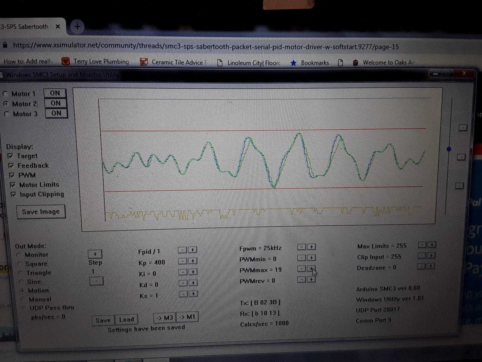

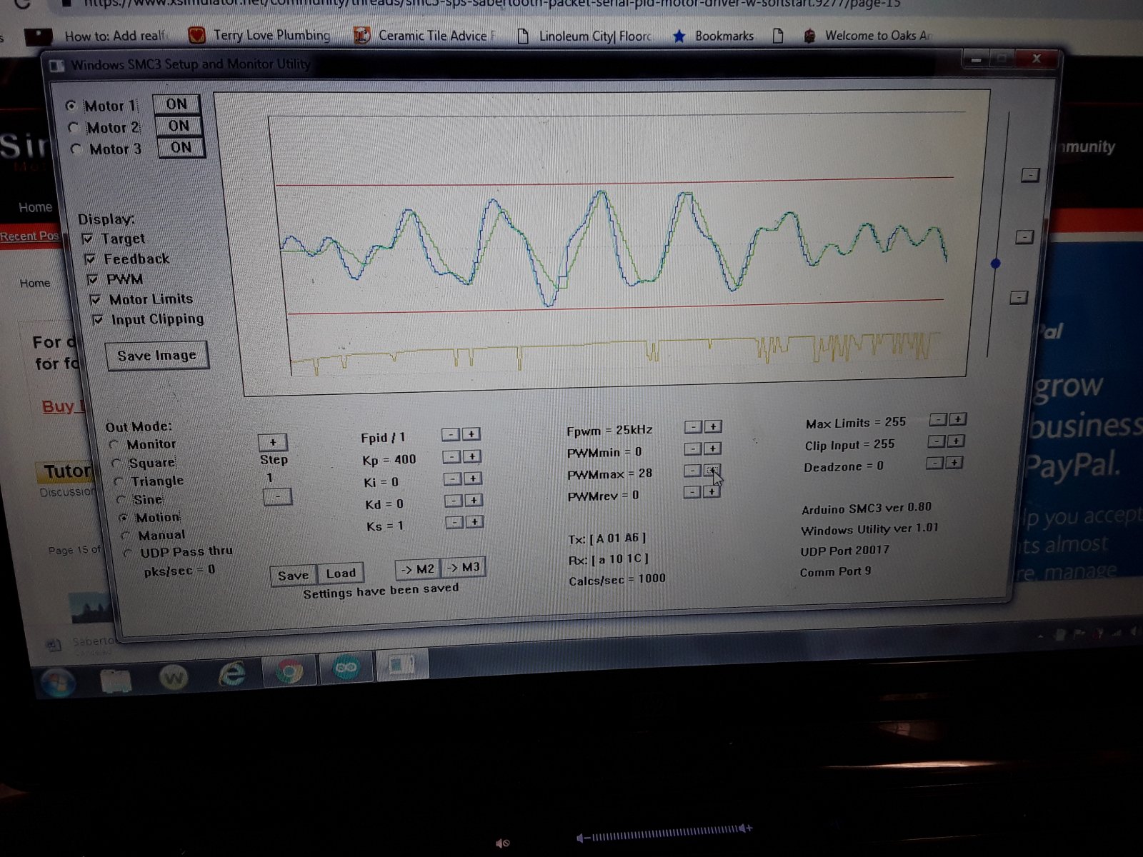

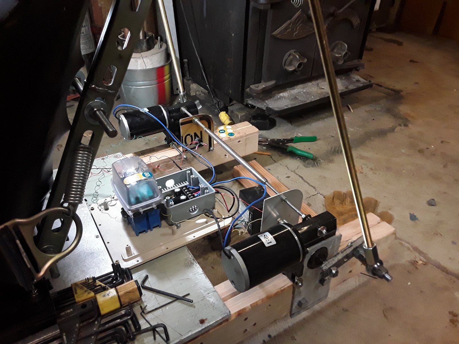

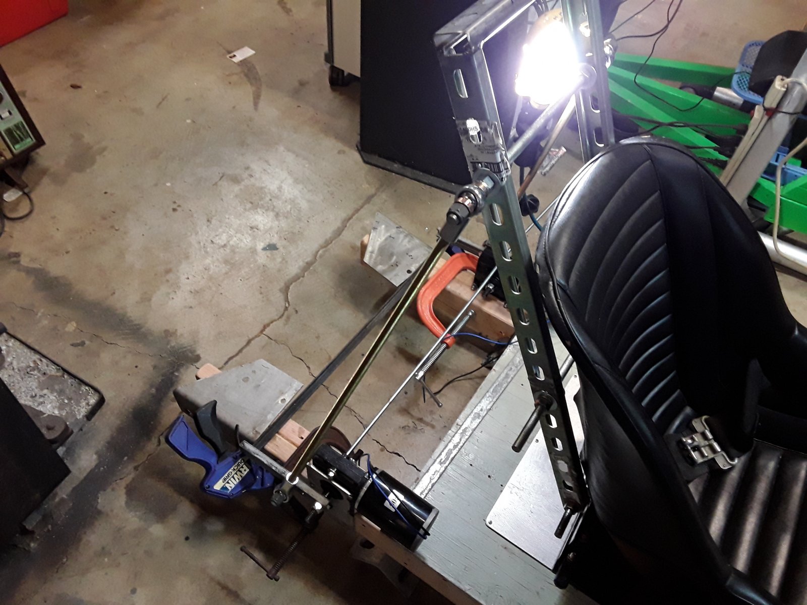

    I've added approx. 18in to my static frame with the same in overlap or sistered to prevent flex from the motor mount.

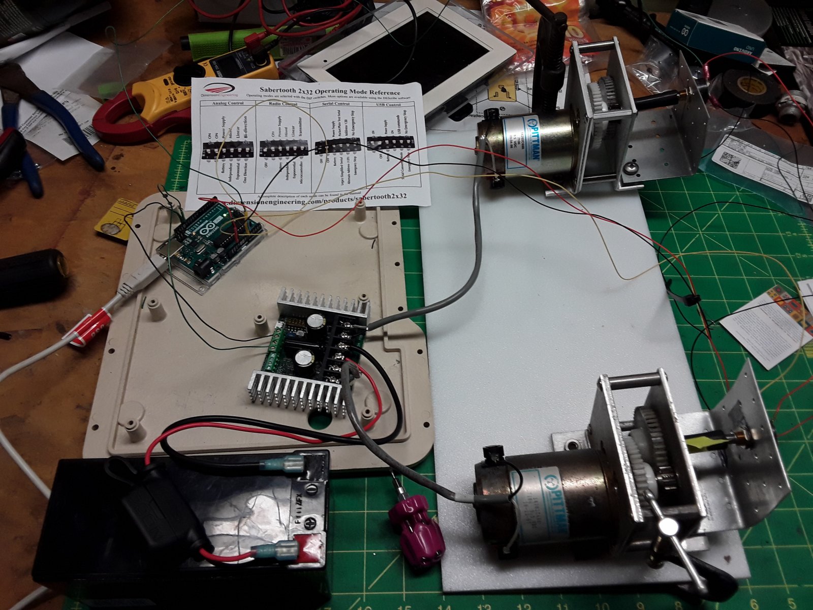

    After several evenings of wiring and installing programs etc. I attempted to drive the little 9v motors on my bench test from the ard through the sabertooth using @BlazinH ,@RufusDufus excellent SMC3 utility and walkthrough. No motor output last night and the night before!*&%&$. I thought I couldn't get my dip switches correct well I slept on it and damn I'd wired the 5v from sabertooth to pin 13 not s1 to pin 13. This afternoon
    I ran PWMmax up to ~20 and got motor movement out of both motors!
    I'm using the 180 hall effect pots recommended by folks here. I have motors following feedback with some varience in speed at equal PWM values between motors (these likely have thousands of hours).

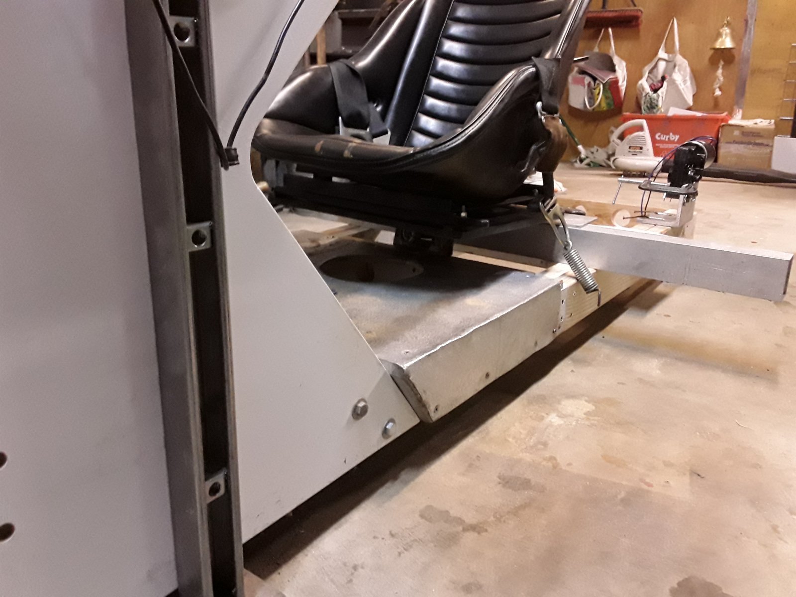

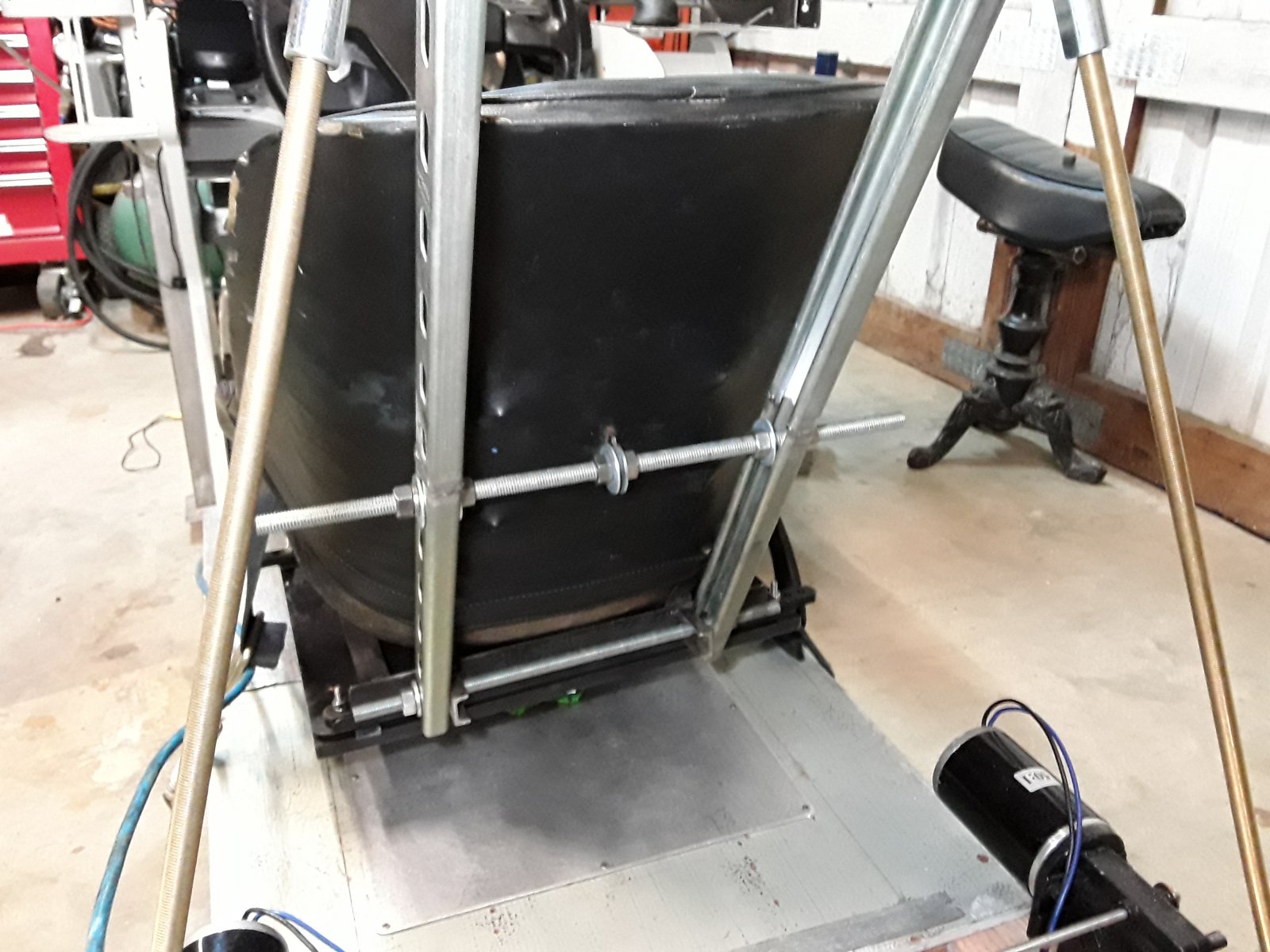

    Update: I've got all the parts in to continue the build. I had a long wait on the M7 rod. As the well known industrial supplier (G) sent two M12 rods and an M16 rod, with multiple calls/emails (bad customer service), they basically told me I could keep the wrong parts. They would send out a M7 ASAP-never happened. I went to Ebay and received it promptly.
    I've got a lower backed bucket seat whereby I'm trying to make it possible to still have shoulder mount rod mounting. Welded up a unistrut brace with multiple attachment points for testing. Room for a pad maybe.
    Bolted down the seat through a 1/2" UHMW sheet as a seat base/ w light steel frame.
    Aluminum sheet on the rig should spread the load and torque to the platform.

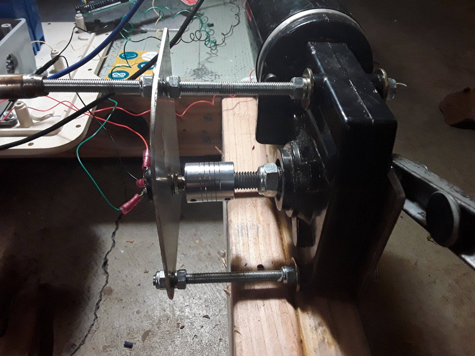

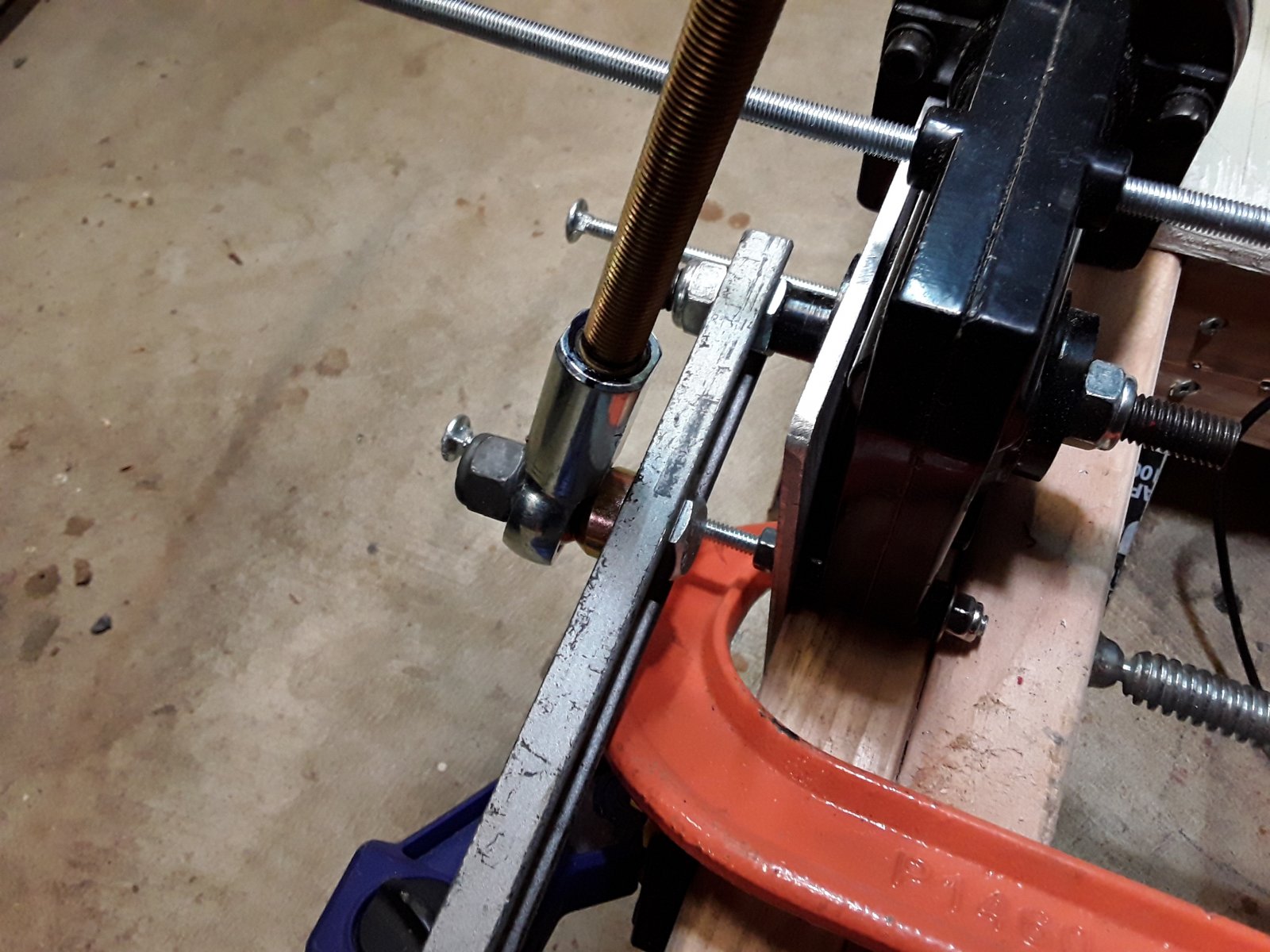

    M12 rod through the motor with nyloc nuts either side and levers of 1" channel that effectively retains the nut pinched by a 3rd nyloc on the flat. I think this will work guys.
    I've got ctc of 1.5 and 2.5" to play with and a 2" bolt
    The head retained in channel using the high misalignment spacer, rod and nyloc.

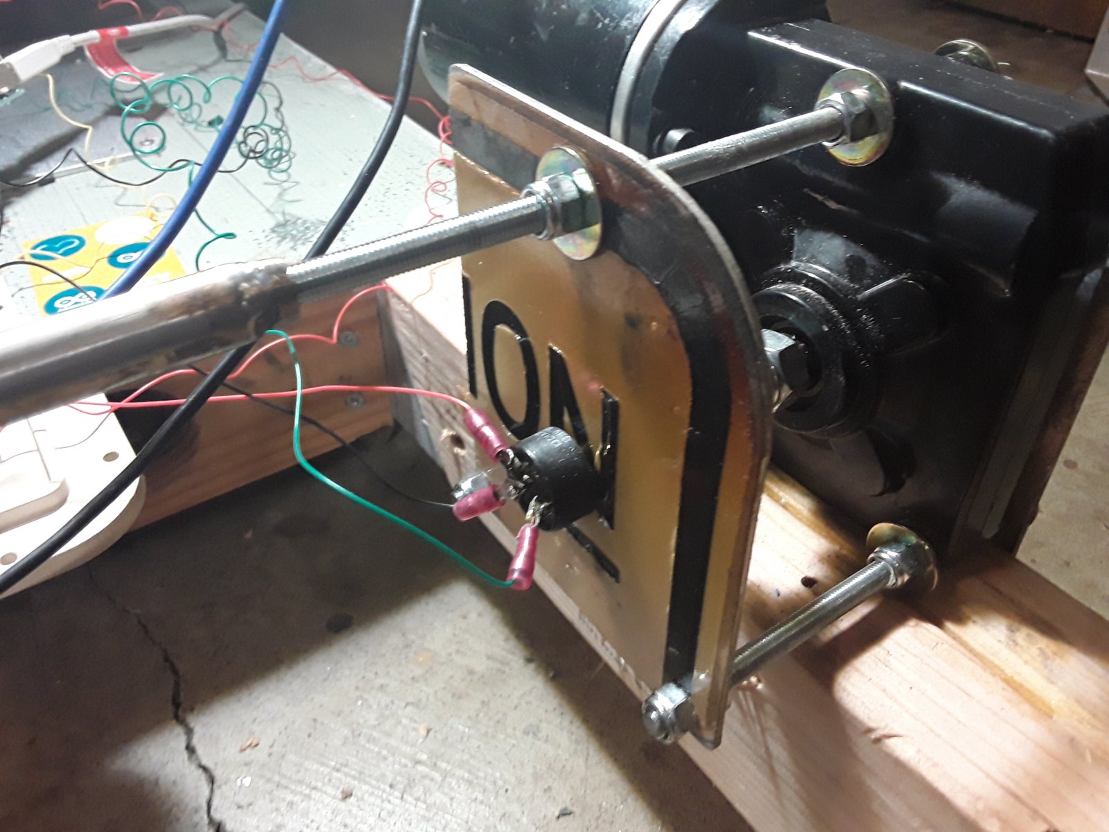

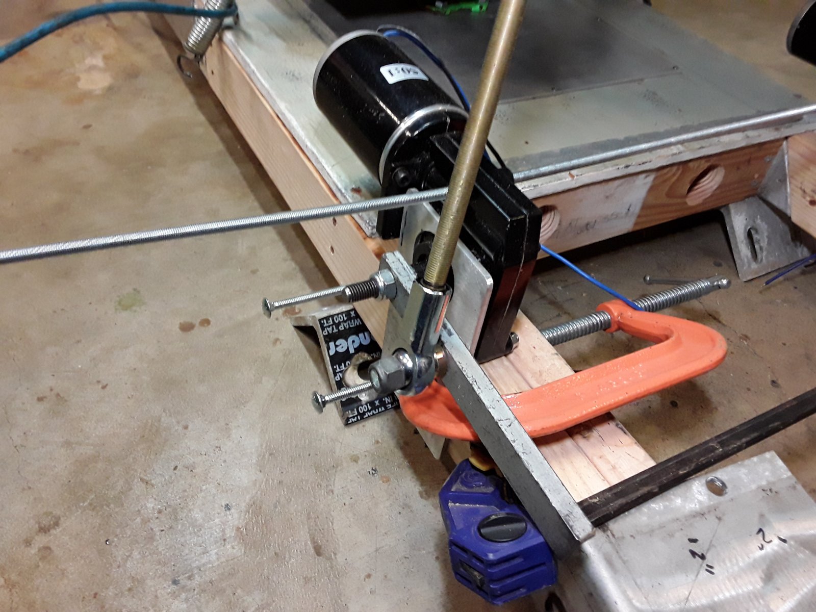

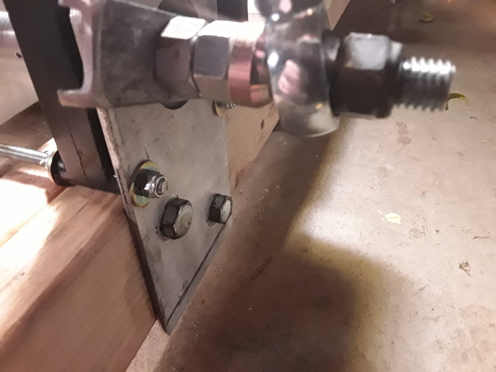

    I've made aluminum plates for brackets to attach the motor to the outside of the 2x4 wood structure with three possible positions behind the seat. With offset holes in the brackets I used 1/2 lag bolts and pre-drilled through the frame. At the furthest point away from the seat motor mounting appeared to not allow enough pitch without longer rods and thus the angle seemed too flat. Testing with a battery, I realized my geometries would have to change and be more like some of the other seat movers on Xsimulator.
    After mounting motors, I wanted to allow my levers to make a full rotation around the motor if something went wrong while testing. Seeing some binding, I've run longer bolts through the lever and shimmed out where the rod ends attach. The carriage bolts were a little fat to clear the motors so the heads have been sanded down. Levers have been shortened to just past the 2.5" length.
    Due to the levers farther out from the frame, at the motor, the rod attachment at the seat frame was widened as well this using the high misalignment spacers and multiple locknuts. Motor shafts have been shortened outside and moved in toward the pots.
    7MM threaded rod through the motor/bracket at 3 points using cutoffs from an aluminum sign retain the pots (attached to motor shaft with flex couplings). At the top rod I've welded a section of ss pipe with nuts either side to cross brace the motors a very dramatic improvement in flexing at this testing phase.

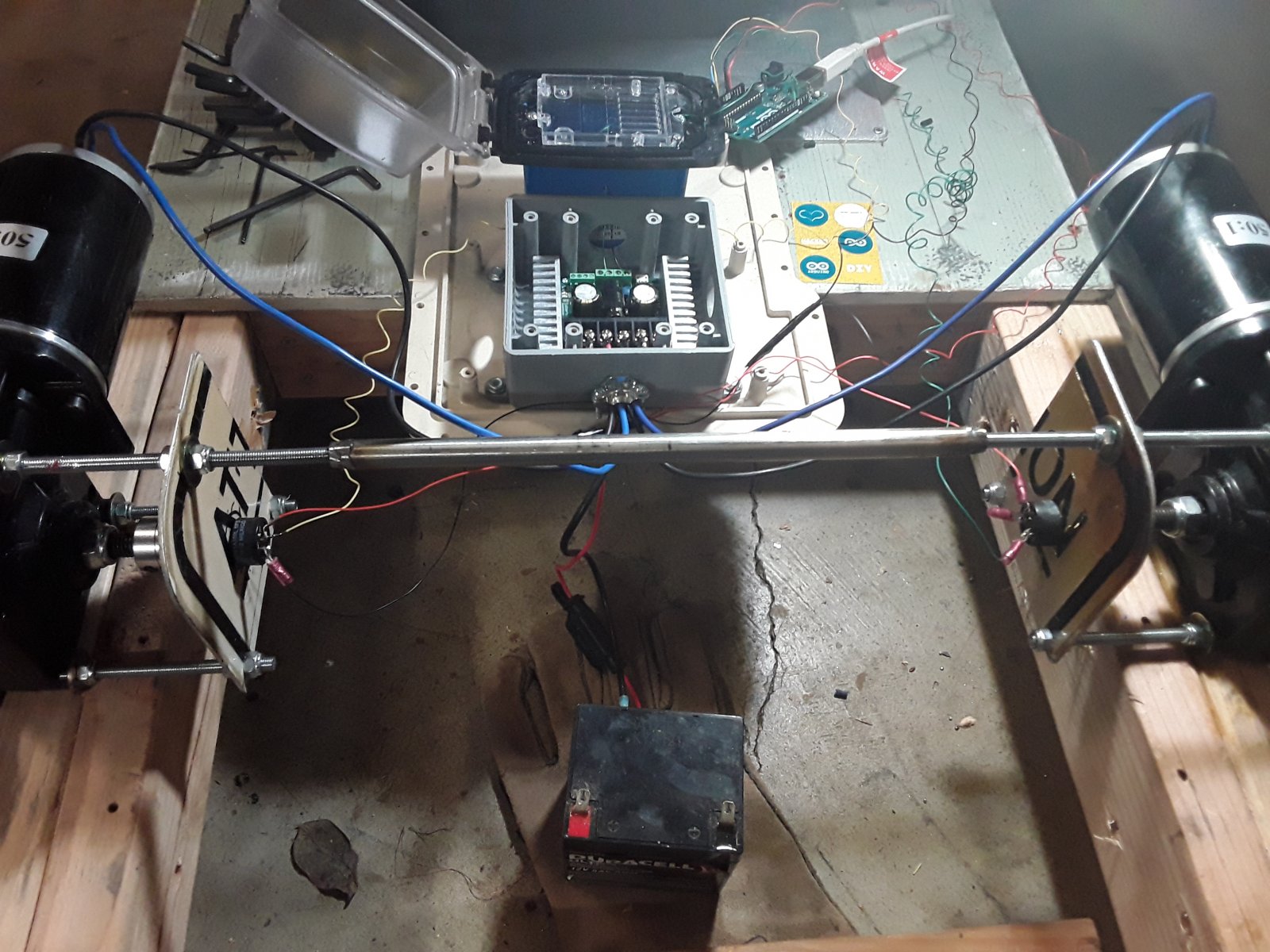

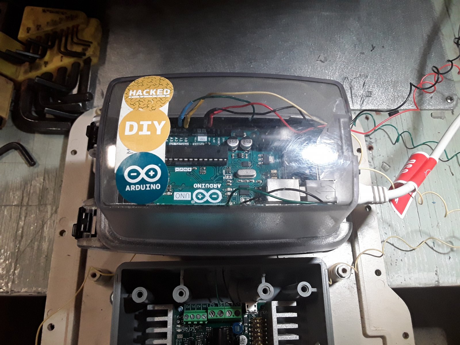

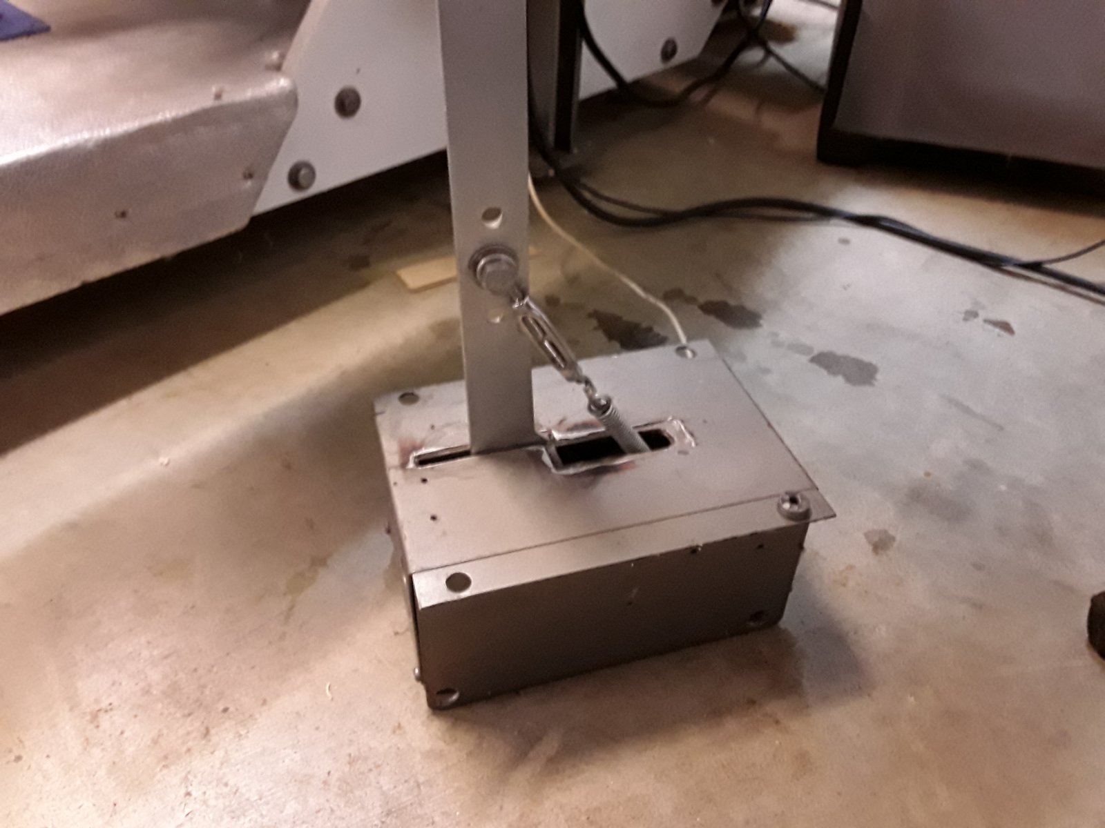

    I moved further with my structural work mostly complete. Have to box the end of the frame eventually (leaving myself room to work). It was time to run the sabertooth/ard on my actual wormgear motors.
    Using some utility wiring boxes to house the controls: a double outlet box provides a nice enclosure for the sabertooth with holes for ventilation and a strain relief, for the arduino an "old work" single outlet box with strain relief topped with an outdoor see through hinged lid. The ard fit snug with some trimming of the plastic. Mounted on a plastic panel with built in stand offs (so future use or cover). I have used a a lot of common plumbing and electrical parts for sim building!

    I was anxious to run the smc3-sps-sabertooth on my build and was not disappointed with the range of motion running the utility. I picked up fairly quickly how to adjust the pots/couplings where I could turn on the motors. With my previous testing, I was able to have somewhat close feedback tracking to different waves. From the beginning my pot wiring was made with telephone wire unshielded so I knew this would need to be replaced. Getting a lot of small waves on the green line that should quiet down with shielded wire. A bit daunting all the settings, options for a noob.
    I thought things were working well enough and maybe a little excited, I'll dip my toes into the simtools and lfs demos available. Thanks, guys!
    I followed the setup to establish communication to the arduino in game engine almost to the tee only to have one item under parity left blank assuming it was the same as none and thus no motion from simtools. After reading a thousand pages of various threads :roll someone had made the same mistake.
    At this point I dropped in some variables for axis assignment and started lfs and holy moly we have motion in game.:thumbs An incredible feeling of surge at acceleration/ braking to curbs to rumble on - very much worth the trouble.:grin
    I have cleaned up my pot wiring, have no idea what I'm doing, I have a motor that makes noise, but I understand
