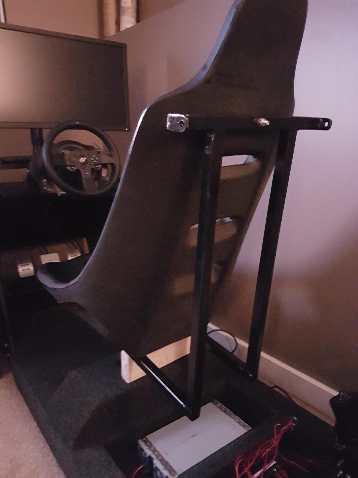

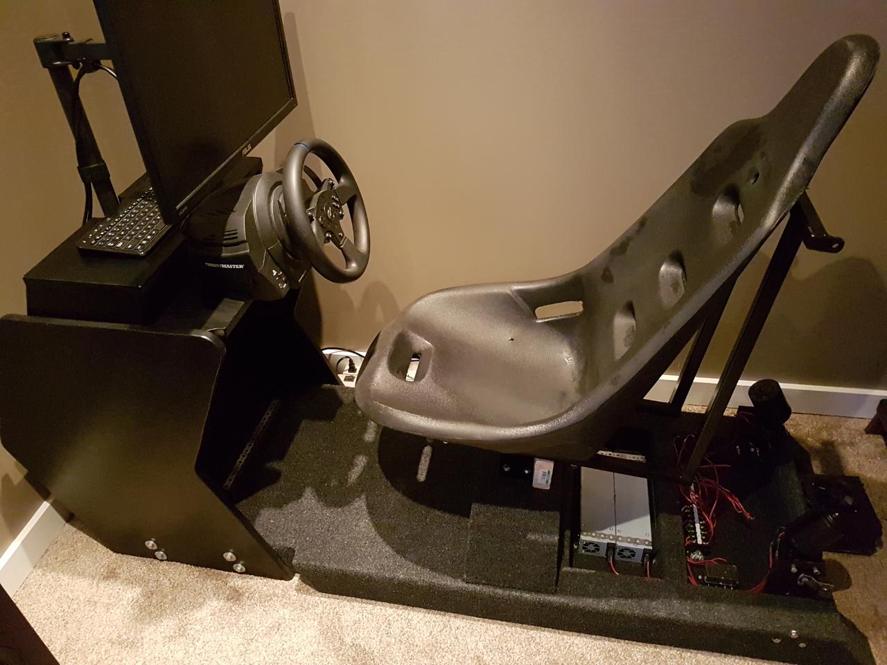

    Managed to fab a base under my seat and carpet it. Seat frame is painted and seat is mounted in place. Wood under the seat is temp to level the seat. Next is to fab up the arms from the seat to the motor.

    Beautiful and clean project. Congratulations!!!

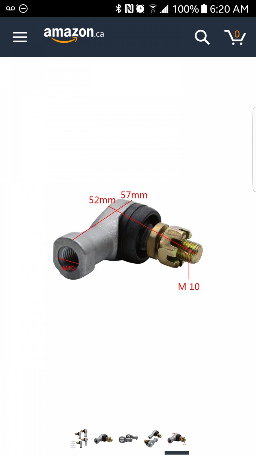

    Ordered up these. Was going to use heim joints but thought these would be quieter and more reliable in the end. I believe they are for a Honda quad. They were $30 dollars Canadian for 4.

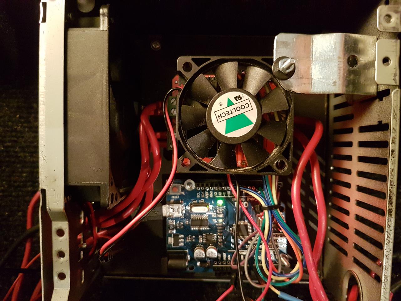

    As I'm still waiting for some parts I decided to improve my cooling situation. I ended up having an old cpu cooler that works perfectly. I fabbed up a bracket as a mount. Cools the whole board nicely.

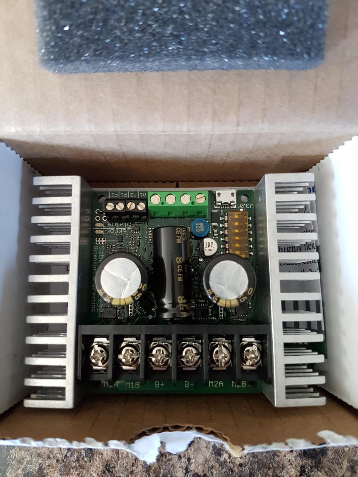

    I'm also on the fence with the monster moto boards. Seems that only one of the four stays at a decent temp without a load. Kinda scared of it starting a fire. May pull the trigger on a 32x2 sabertooth motor controller. Its pricey but I hear good things. Also may end up with better motors but time will tell.

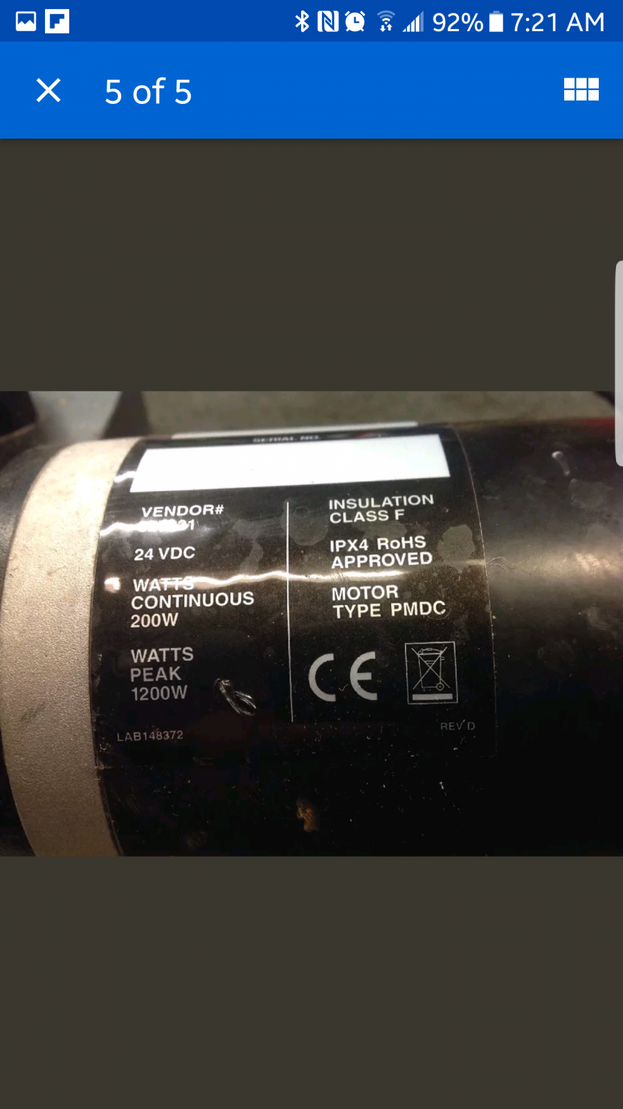

    Looking at these wheelchair motors. Wondering if anyone could chime in and let me know if it's a good choice? I have two power supplies I can run in series to get 24v which is fine. Just not sure on the specs.
    As a side question. If the total volts out of my power supplies are a bit over 24v let's say 26v. Would it damage the sabertooth which is rated up to 24v.

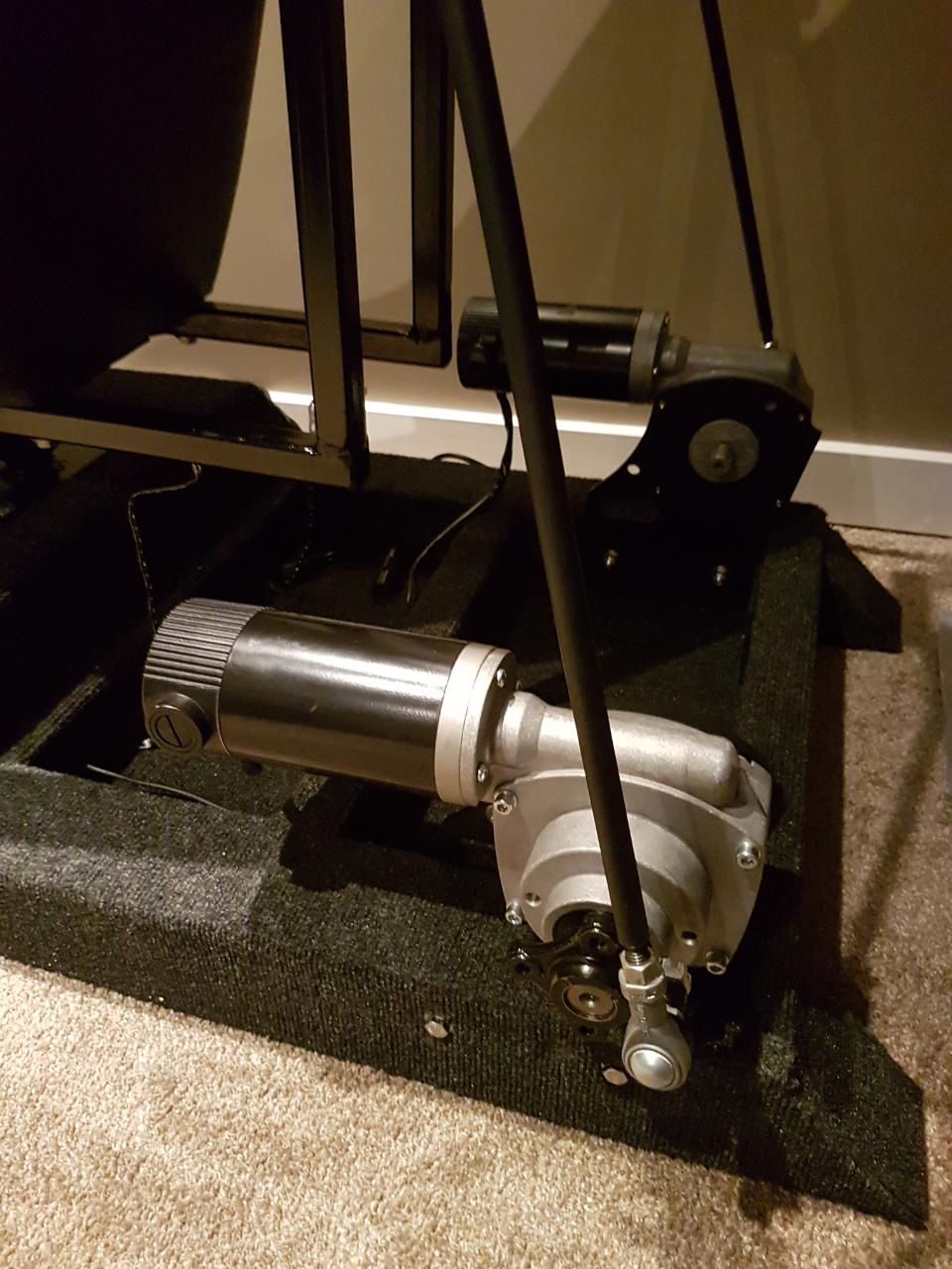

    Made a little headway. Ended up getting some really nice wheelchair motors that were lightly used and never been in the elements. Also made some custom rods .1/2 inch cold rolled steel. Spun them on the lathe and cut some threads on the end. Turned out better then I thought. I also pulled the trigger on a sabertooth 2x32 .Next project is to mod my power supplies in series for 24v output. And start wiring the new electronics .
