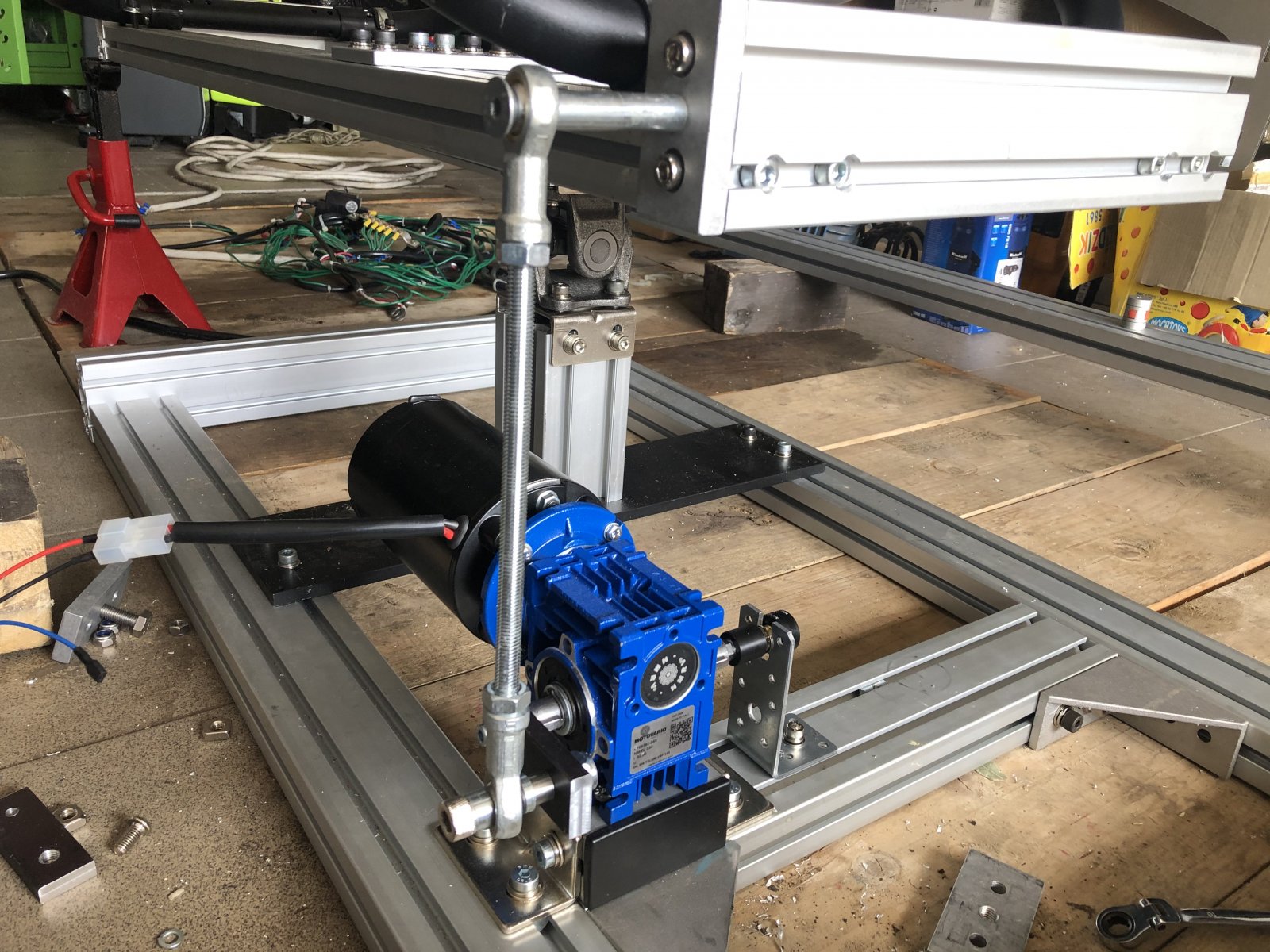

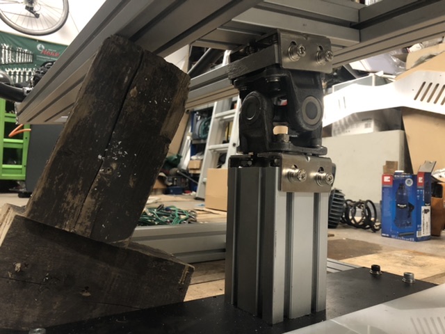

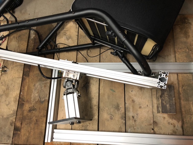

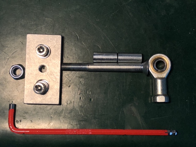

    Today I just prepare rest of mechanical parts.

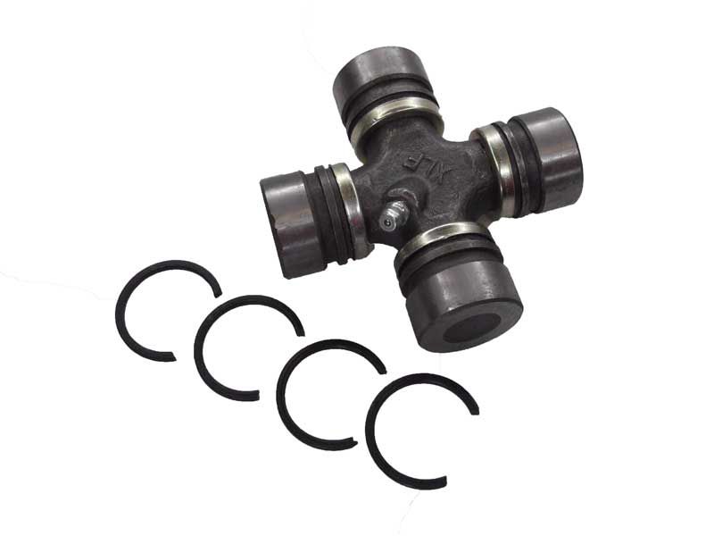

    1. Kardan joint from MTZ tractor:
    and two brackets will are really easy to mount to flat surface:
    I had to prepare adapter to mount on 80x80 alu-profile
    [​IMG] [​IMG]

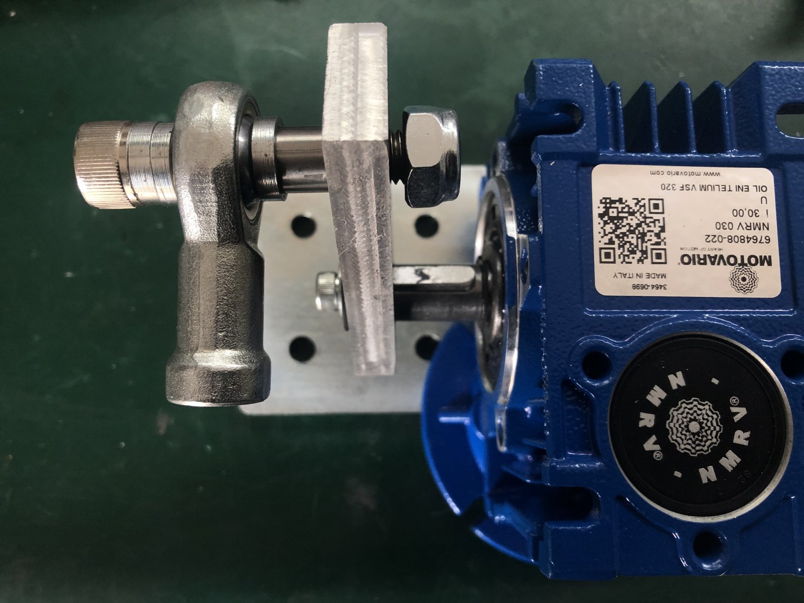

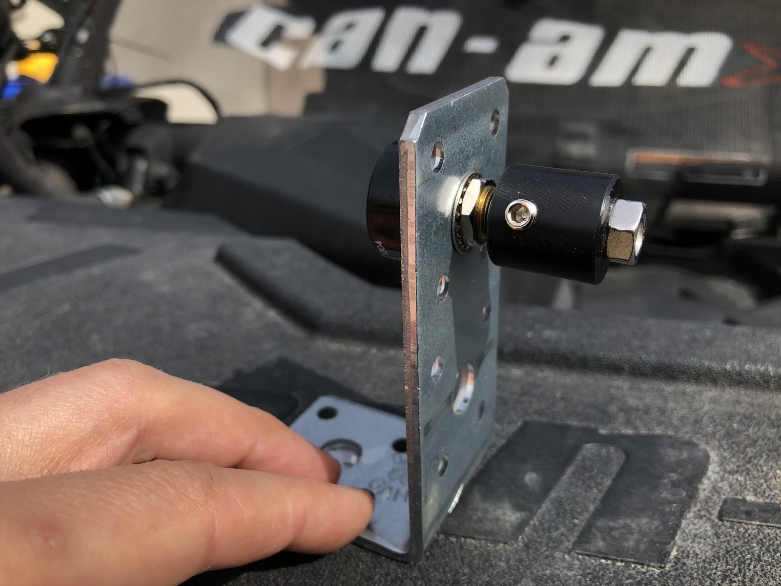

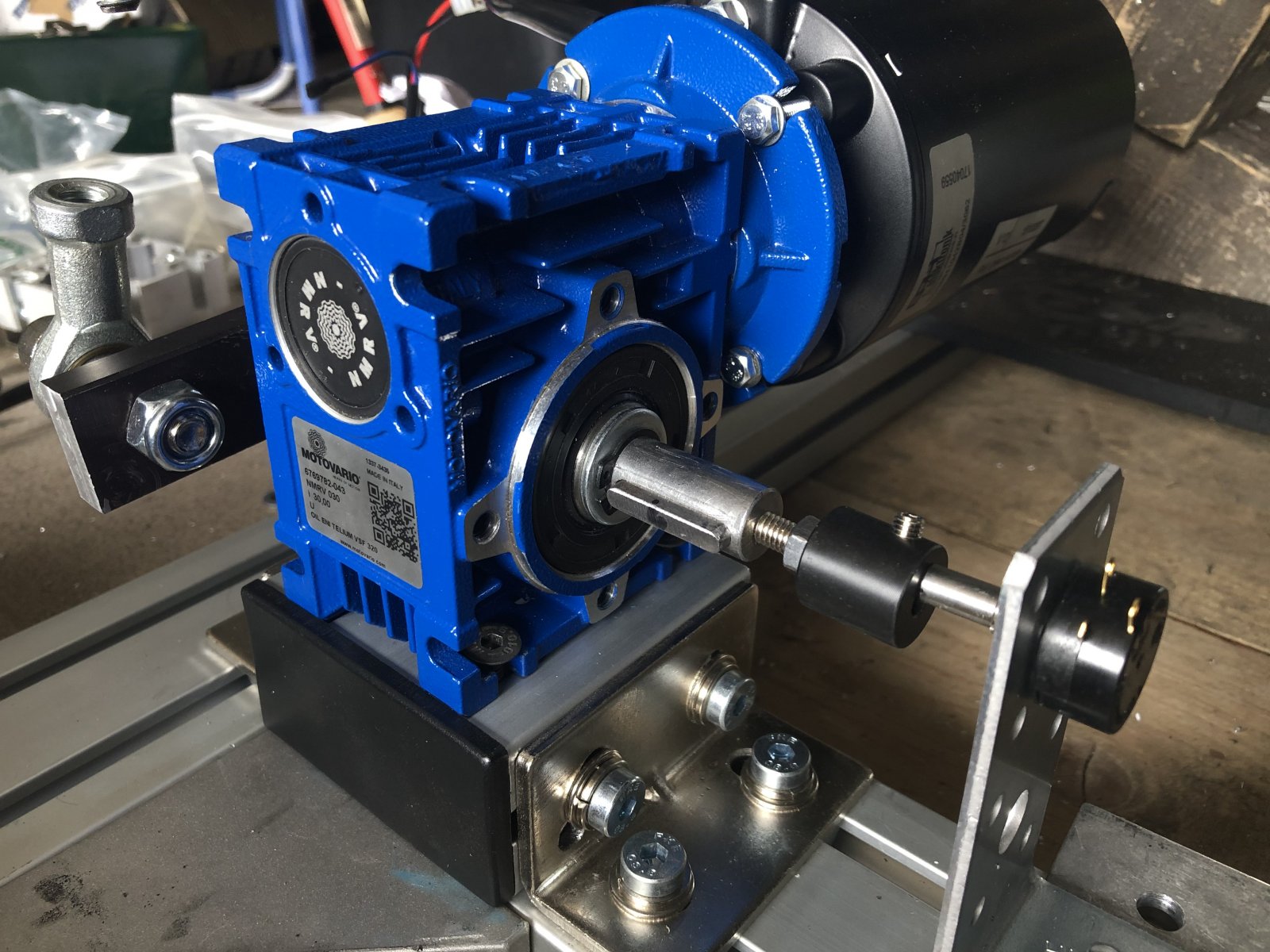

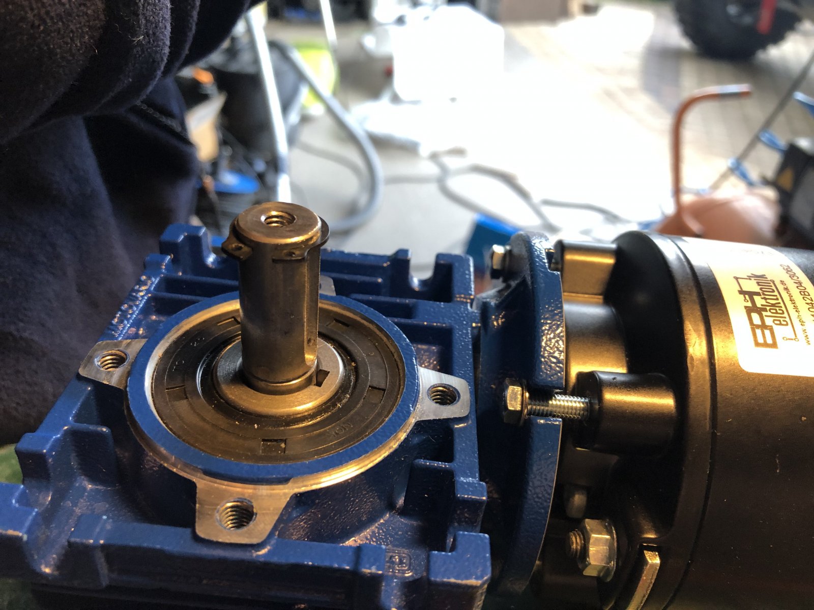

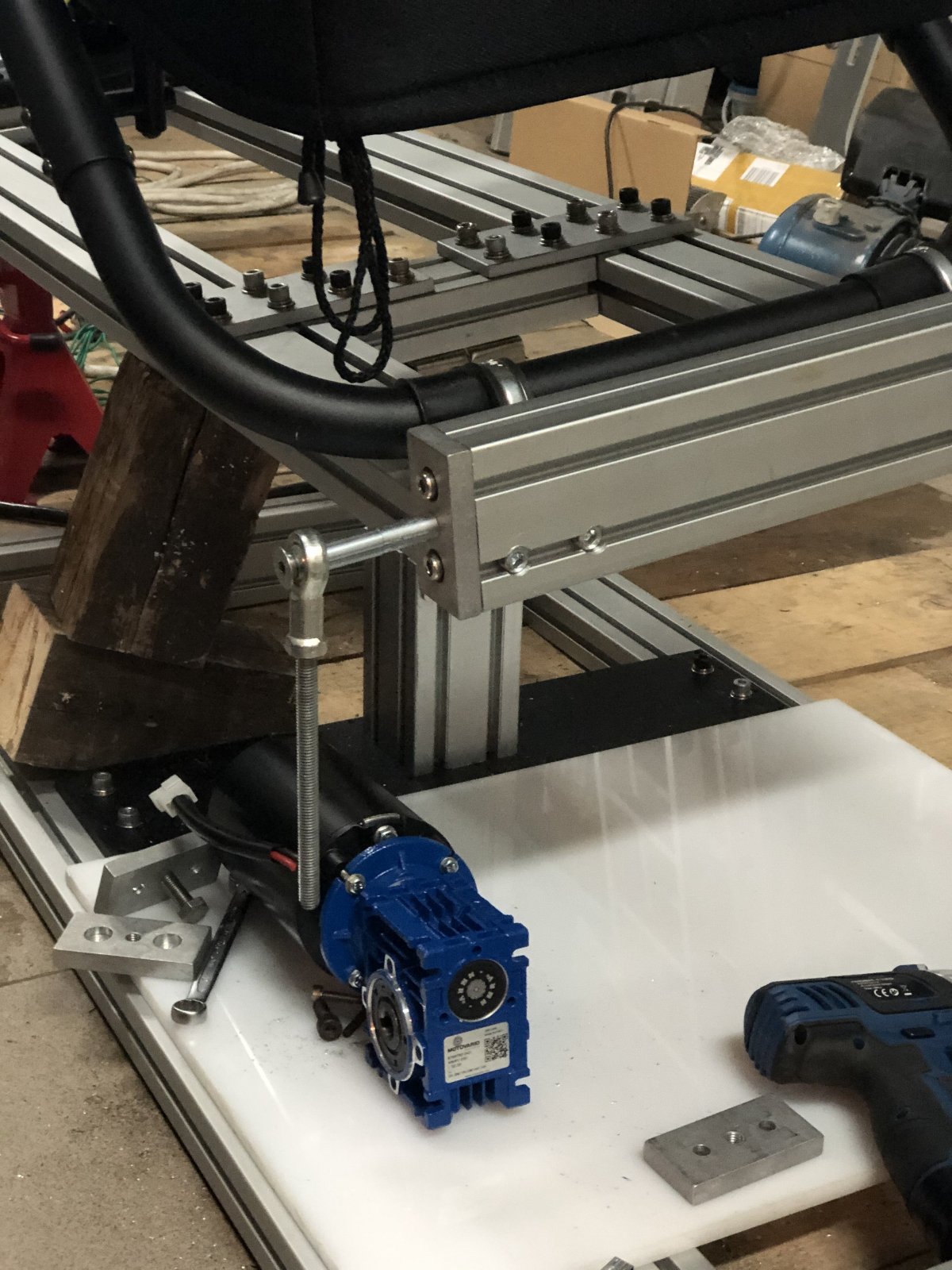

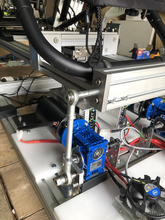

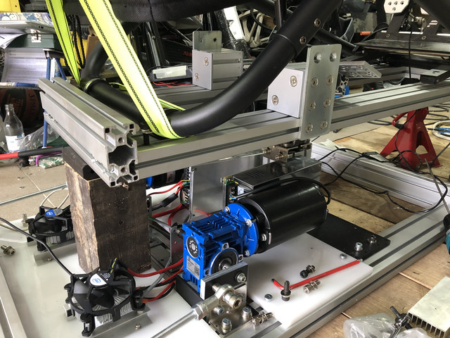

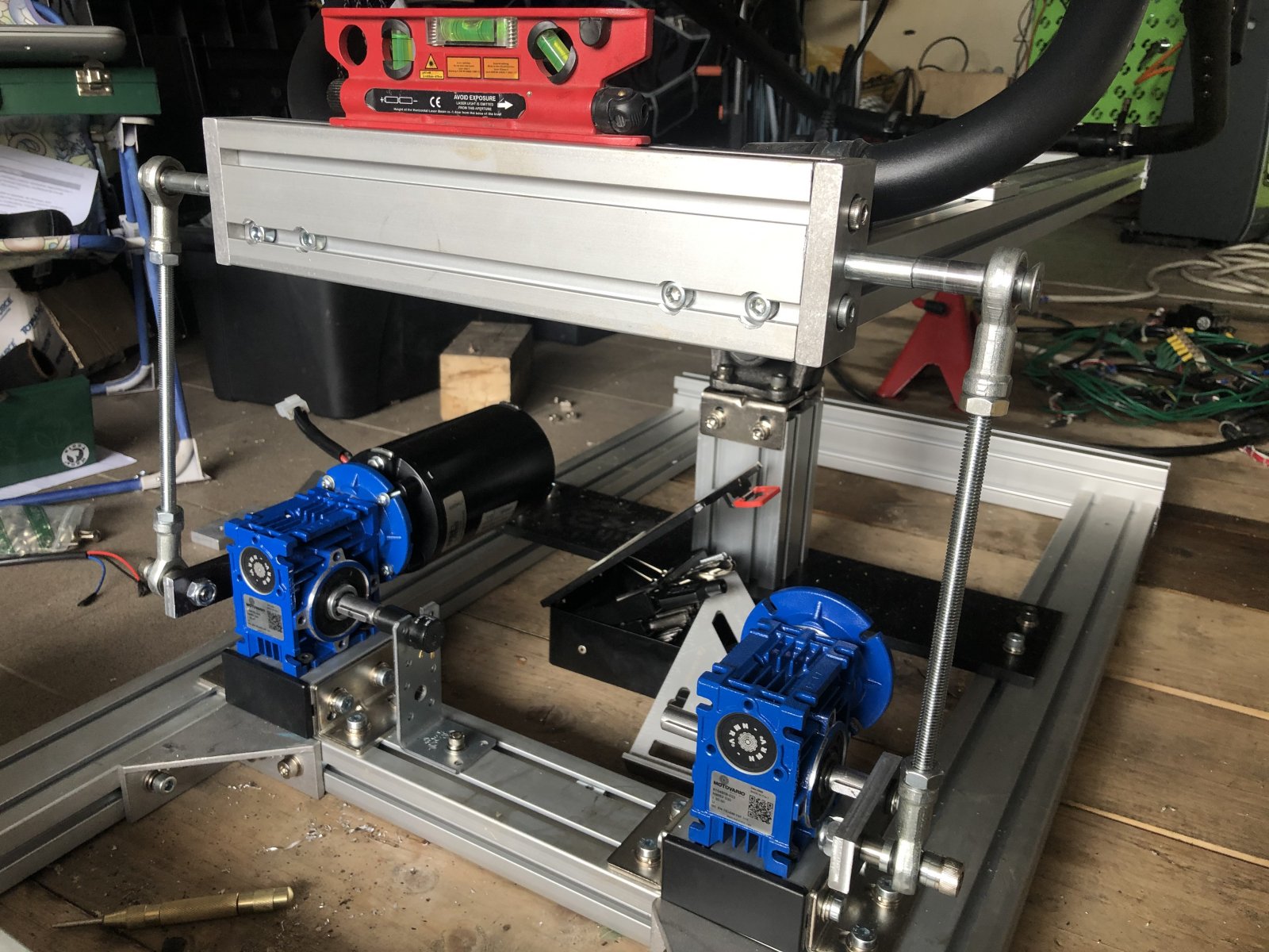

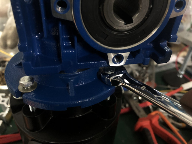

    Some small progress of my job.
    Gear mounting
    Shaft insertion
    Motor positioning...

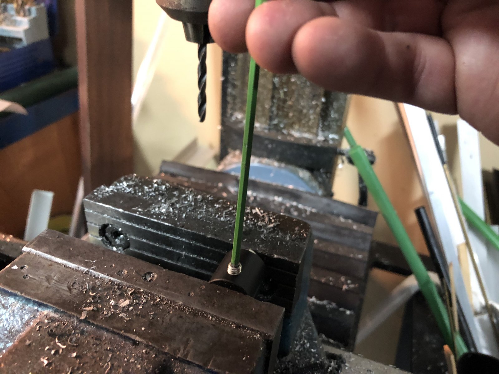

    Potentiometer coupling preparation. I use ABS tube. On the motor side I glued below type of nut.
    Prepare steel bracket for potentiometer
    Bracket final concept
    Short break and relax with blend
    Motor joint preparation and final installation

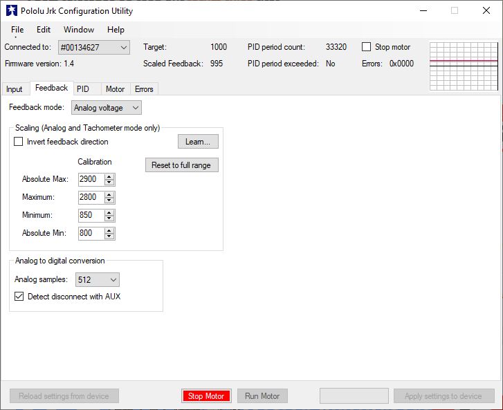

    First parametrization of JRK 12V12
    1. Feedback settings
    2. Motor settings
    3. PID tuning result
    Small overshoot is not so critical in this control plant.
    In Errors page I can see fast increasing "Feedback disconnect" error. Is it normal? I have the same behavior on both JRK.

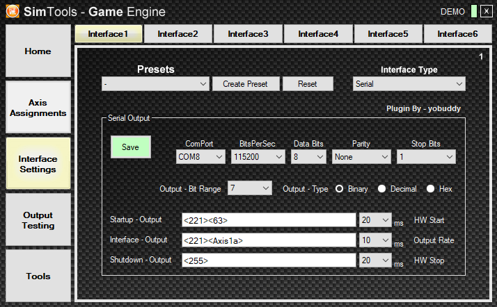

    Dear Guys, I just stop my project on first test in SimTools. I just try to find similar problem & solution and I finally give up.
    Please support me with below problem.
    JRK utility is working fine but in the SimTools I've notice Protocol Communication Errors. On the real plots You can see that motor moves but not according to the Variable Roll which I change in the Simtools Axis.
    Please check it in below movie. You can see my settings. Please support me.
  9. Peter24
    Peter24 New Member
    Apr 3, 2020
    23
    24Coins
    +15 / 0 / -0
    2DOF, DC motor, Arduino, JRK
    I just find the reason by myself. I have to change Output Bit Range parameter. Every post which I read, there was 12bits. I have change to 7 and errors dissapear!

    Hi Peter ,,,you only have one axis assigned in simtools interface settings,,,,, on the interface output use
    [A<Axis1a>][B<Axis2a>]

    Thanks for answer. This interface output commands are for Arduino method of control. As You can see my project use Pololu.
    thx.

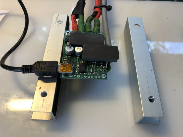

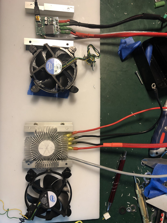

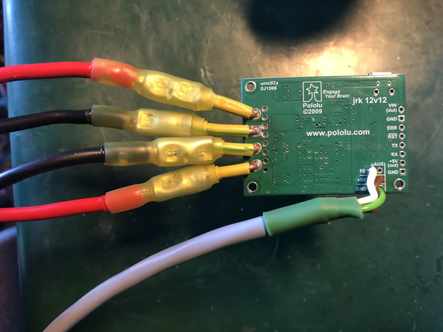

    Today I focused on electronics part. I was really supprised that Pololu made so small terminals for such big amperage. I did some adapter for main power cables (3.5mm2).
    For this purpose I have use 2.5mm2 hard wire and aluminium wires connection tube. After proper clamping and fill the gaps with solder.

    If you are using JRKs then the Interface Type in Interface Settings should be set to JRK. You then configure the device number, Assigned Axis and Output Rate (10ms). Do that for Interface 1 and 2 in the tabs.

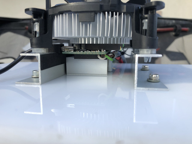

    I've read a lot that JRK heat dissipation is really big and they need propel cooling. I decided to use PC coolers. Problem is that on PCB we have capacitors close to ST motor driver.
    In this case I've use thermal pads.
    Final result:

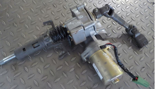

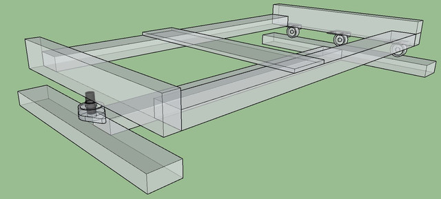

    Today I decided to add one more feature = Traction loss axis ;-)
    I chose motor from Oper Corsa power steering:
    Simple sketch:

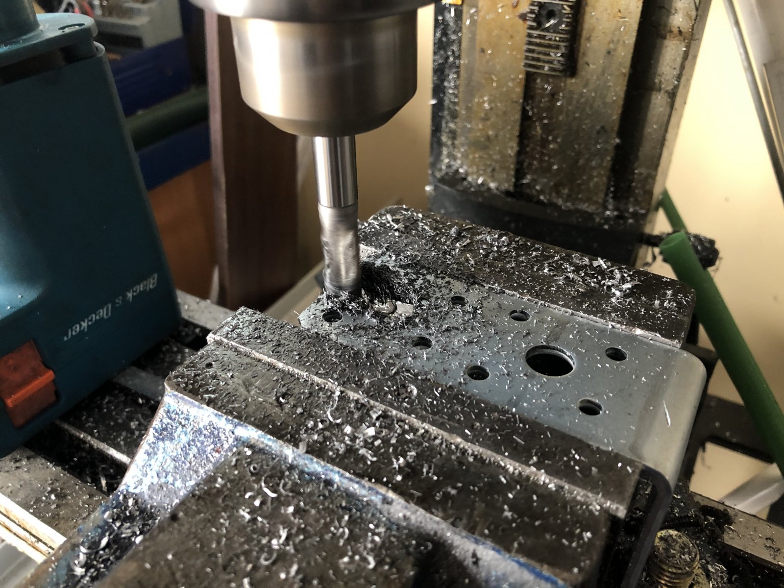

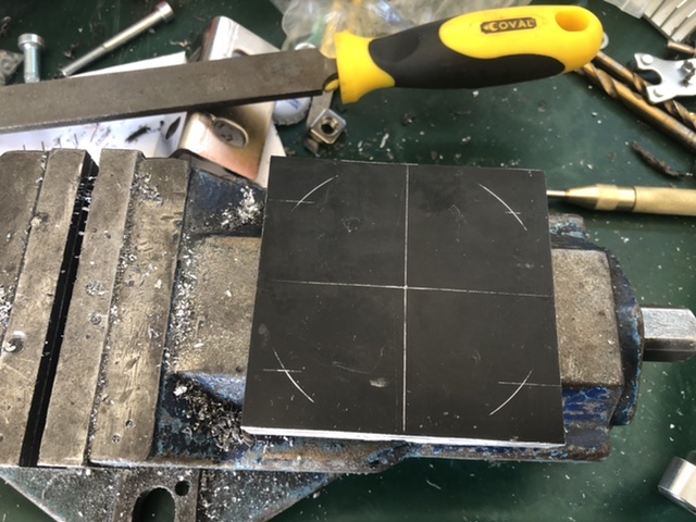

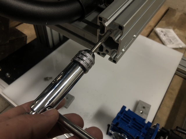

    I just finished mechanical part for Traction Loss axis.
    JIG for holes making in the profiles:
    Two steps drill:
    Traction Loss rotation point (self-aligning bearing and shaft):
    Main "H-shape" frame with wheels:
    Frames connection:
    Supporting steel wheels:
