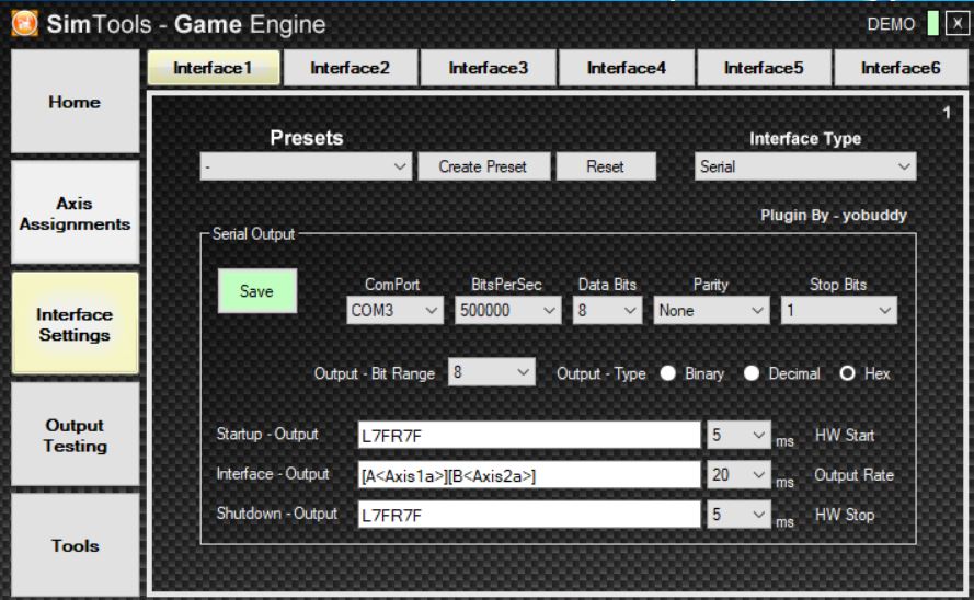

    I did some kind of progress today, if they can be called as progress: TODAY A MOTOR MOVED.
    Let me show a couple of pictures:

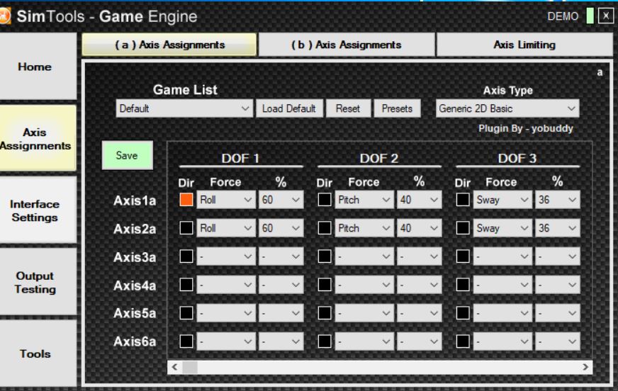

    Probablt the most interesting is the second one: I´ll tell about how my settings were:
    At the begginning, it used to be in COM4, 115200 BitsPerSec and everything else as it´s shown. Nothing happened.
    Lost, I decided to change: COM3 In MyPc, but couldn´t change the bauds rate, so I kept in 115200. I didn´t change in the arduino code either, but I did in the serial monitor. I also changed both COM3 and bauds to 500000 in the simtools as the image shows.
    Well.... Output testing/ Output Type (DOF Output)/ move the Roll to about -30 and suddenly one motor starts moving.
    It moved always in the same way. moving the slice, no changes were replied. I mean, it started moving, or stopped as it wanted. Absolutely anarchy!!!!!.
    After some different tryes, the motor moved on the other position, but te same motor, and never controlled. Towards one side, towards the other side, but allways the same way and never in the same ratings, moments or whatever it´s said. And always the same motor.
    I´ve tried returning to 115200 bits, but never moves. Only in 500000, and always the same motor (sometimes on one side, sometimes on the other side), and, obviousbly, never controlled and never inthe same numbers.
    Trying to discover what motor was moving, I found a moment where a motor moved, kept there and I disconected A0 pot from arduino. Well, the motor then moved more relaxed and in the same position. We can say it moved free.
    I switched again in the A0 pin and came back to the poor initial movement. I disconected from the arduino the other motor (A1 pin) and it started to move "freely". Connected again, it stopped.
    By the way, it happened with two different arduino boards (Arduino uno Rev3).
    It looks to me like maths were crazy, or maybe pots stop somehow. I don´t know.
    My pots are B10K.
    Ah. Pots are not connected with the motors. actually both are free (in the morning, one motor, the one that moved, was free, and the other one was paired with its pot, but as it never moved...)
    please, ask me whatever yo want. I think I´m closer.... or maybe not. I don´t know where I am!!!!
    Ah, the axis limiting are in 50% fot both Axis1a an Axis2a.
    Thanks in advance!!!!

    That sounds like some fundamental hardware issues, that you really should get sorted first, irrespective of what code you use.

    You will need to cover the actual build details of your rig to be eligible for a DIY license:
    To qualify for a free license:
    • You must be building a true DIY motion simulator. (Not built from a kit or purchased from a simulator seller, a model simulator does not qualify.)
    • Have a unique build thread or Showcase in DIY Simulator Projects. (The thread should show some effort, which means it should show progress to the testing phase.)
    • Have been a member of the community for at least 30 days.
    MMs require cooling, here is one option: https://www.xsimulator.net/community/faq/xilence-cooler-for-moto-monster-sparkfun.211/
