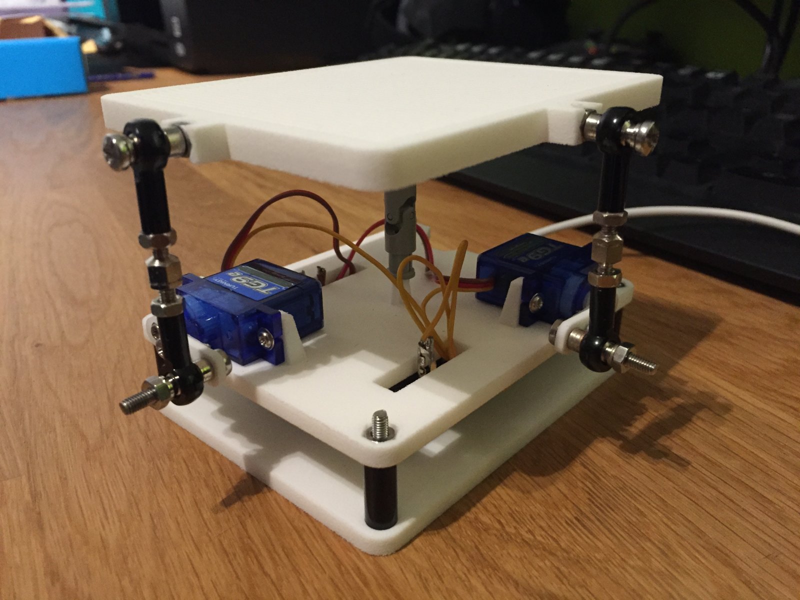

    this is @eaorobbie 's code i'm using

    I have not done so on SimTools 2 but download and try the code and its preset, but be aware that SimTools 2 needs the Axis Interface defined with an a, like this: Axis1a

    Yep I have the interface output as R<Axis1a>~ L<Axis2a>~ and matched the servo pins with the code (4&5). Still no joy. And in @eaorobbie 's rc ard code this works great, but the servos dont function the way i require for a gseat.
    What needs to be changed so that one servo only deals with positive data and one servo with negative data? the gseat paddles need to be pushed outwards and not pulled inwards by the servo. Really scratching me head. Appreciate your help @noorbeast

    If the servos are now working with telemetry you just need to configure SimTools to suit, @SeatTime recently did this for his G-seat project.
    Checking or unchecking the DIR box in the Axis Settings determines which way the axis moves.

    The servos work under @eaorobbie 's rc code, but not the code he posted in @Schluzu 's gseat post (the twitch as per the video). Am I OK using the rc code for this application? If so I will stick with that, it works. What I'm not achieving is the servo behaviour. I'm probably not explaining it very well so I have made the animation below to show the result I am after

    my prototype is all ready to go, just waiting on my 3d prints. although its looking likely that the parts will be harvested for a new project

    I didn't think I would ever finish this project after moving onto a full size g-seat concept. But as the final version of the g-seat has begun and the concept had to be dismantled I couldn't resist harvesting some parts and assembling it. Gave it a quick run in LFS. Was a fun little project and a great intro into all aspect of designing a sim.
