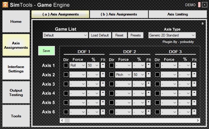

    thanks @noorbeast, I have LFS, but to be honest I'm just trying to get my servos responding by using the Output Testing, but I'm left scratching my head.
    I've uploaded the RCModelSimToolsMode.ino to the arduino and setup simtools as per the screen shots. I think the axis assignment is correct for my design. One Axis 1 for Pitch and Axis 2 for Roll. But in output settings I get no response from the servos when I move the sliders. Ideas? Anything to do with Simtools being in Demo mode? I applied for a free licence key but nothing yet - not sure how long it takes to come through.

    cant see from the pic well but you need a space between axis if you don't have one like this

    i didn't have a space - thought that might have been the culprit.... but still noting

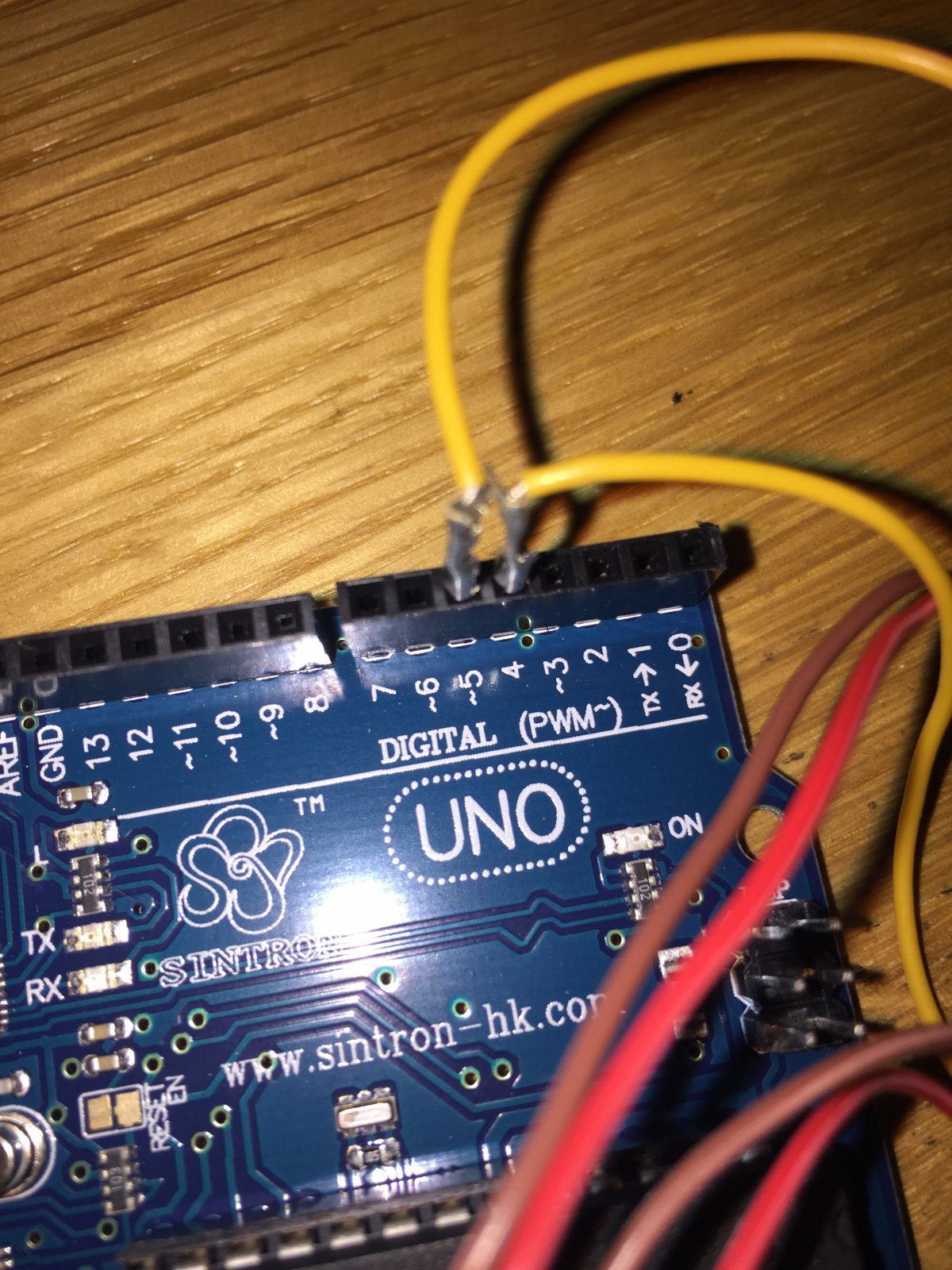

    Can confirm the servos are connected to pins 4 & 5. When I plug the usb in the servos align to 90 degrees so I know the ard code is working. Seems to be simtools communicating with the ard?

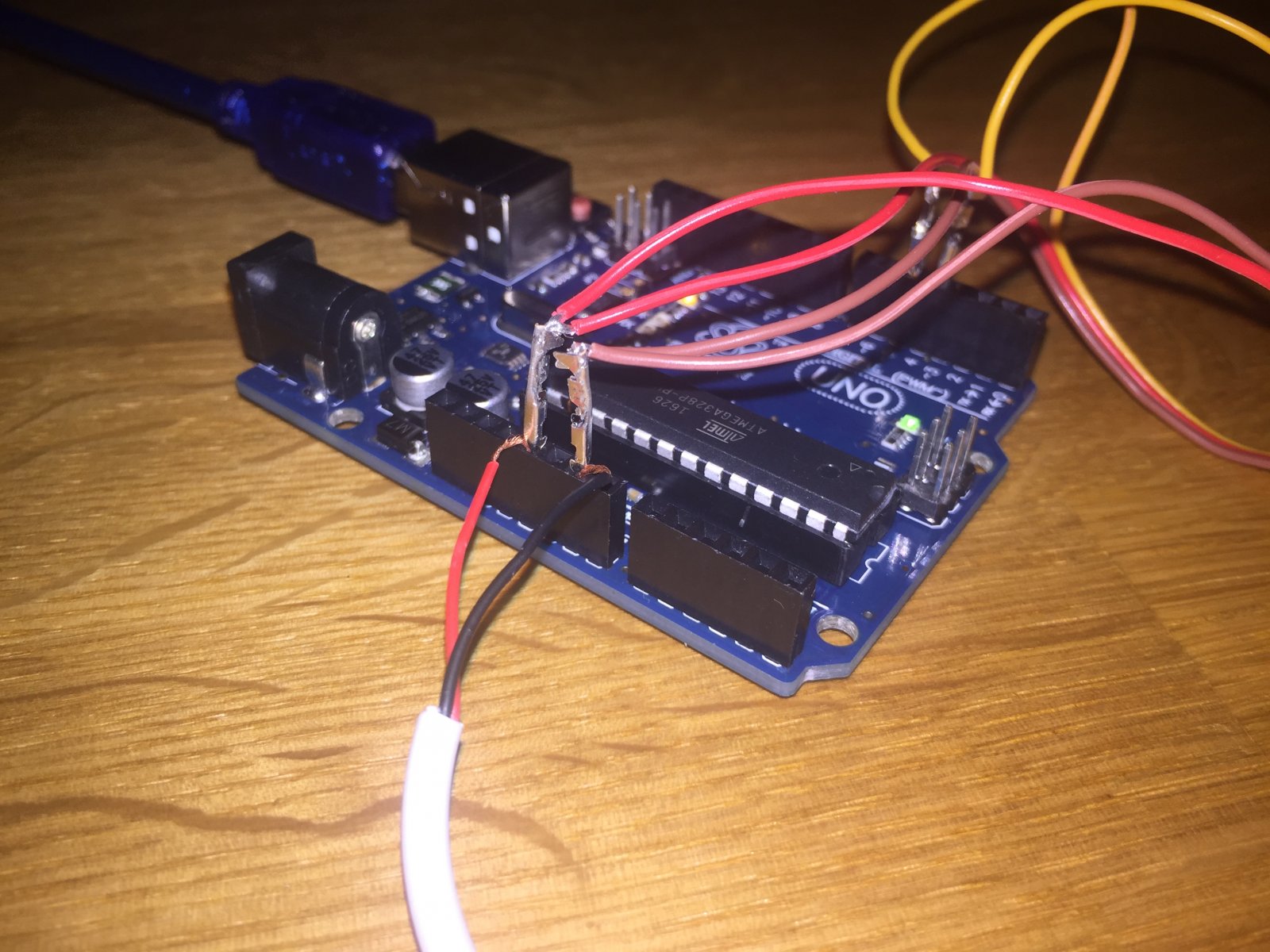

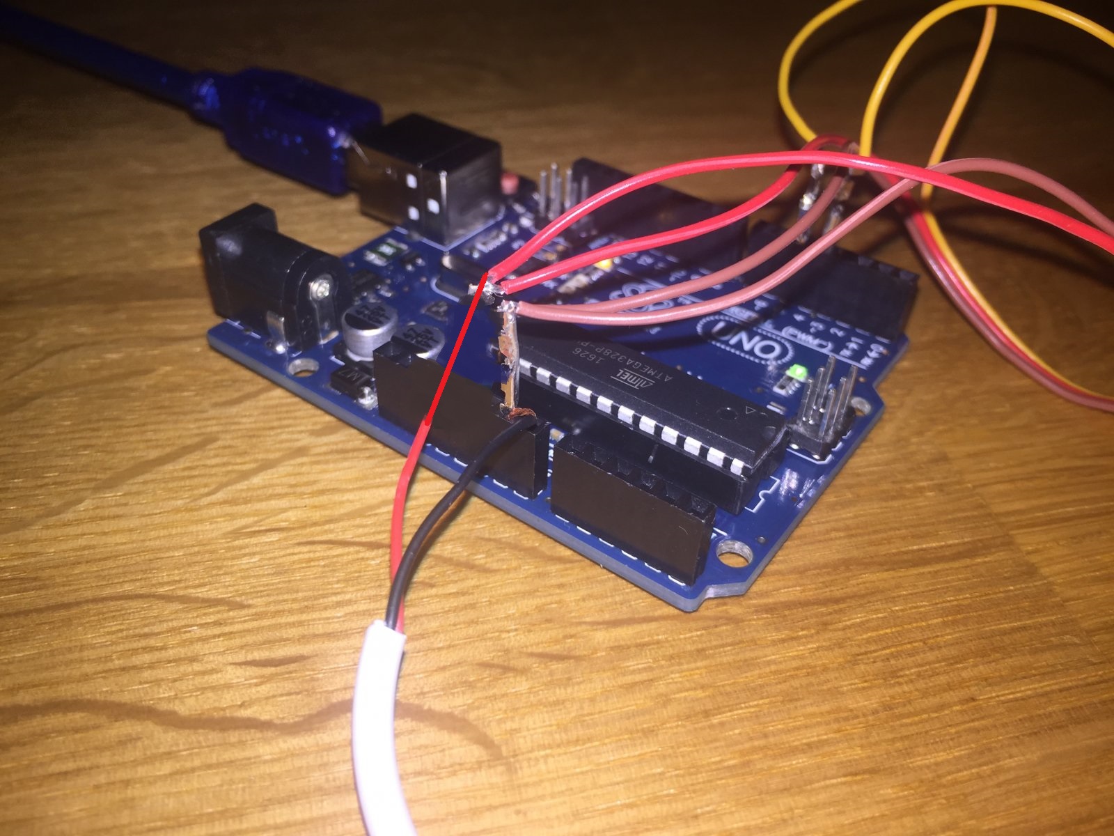

    I have also discovered the reason for the game engine crashing. it would appear the servos were drawing more power than the ard could supply. So I fashioned a usb power supply out of an old ithings cable and connected to the ard 5V and GND ports to give the servos a boost (pic for anyone who is unsure how to do this as the wiring diagram I found didn't show this).
    have now tested multiple times with output testing and LFS - hasn't crashed once.
    i know you said you didn't add additional power, did you use a genuine ard? mines a clone so that might be the reason. anyway, so happy it's working, has been a massive learning curve.
    now to perfect the settings and will post some pics/vids of the final assembly once the 3d parts have arrived.

    when i first tested it ,it was with a genuine arduino but i swapped it with a clone arduino mini v3 with no problems. i didn't use a external power supply for them.the proper way to wire your servos with a power supply is to connect the +5v to the +wire for the servo only and the negative to the servos and the arduino like this

    wiring the way i am showing above, the amperage wont go through the ard.
    if you want to connect a power supply to a ard you will have to connect it to its jack or at the Vin pin not at the 5Vpin and if you go this way the regulator on the ard isn't for a lot of amps and its for 3.3V and 5V but for your needs should be ok.

    ok thanks, like you say, for my needs and 2 small servos I have gone the Vin route. Seems to be working great.
