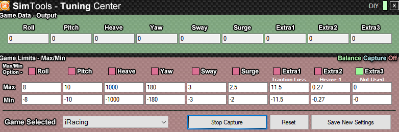

    2DOF, JRK
    Hello, Now I did what you said. The forced individual are good but mixed up it still leans a little bit to the right/left on a straight road. Also the heave don't work. The tuning center registrates heave between 1.1 and 0.9 now i like to set the min max to a number below 1 but it cant... When i put in the number 0.5 and save the settings it make it 5... I hope you can help me out :)
  3. bsft
    back space the numbers till they are gone and type in 0.5

  5. bsft
    Thats all I do, I delete the number by highlighting it and backspace thats in there and I type in what I want. It works for me and others.
    With gear shift feeling, I get that from surge force, hence a smaller number in max and a larger number in min.
    Did you read the document? is there something i havent made clear?

  7. bsft
    did you click after pausing the game "capture max min" box? Then try to change the numbers? the click "save settings".
    I have moments of stupidity and forget that step myself.
  8. Roel
    Roel New Member
    Oct 10, 2014
    15
    454Coins
    +0 / 1 / -1
    2DOF, JRK
    I start the tuning center, then click capture min max, drive around, pauze or shut down the game, fill in the numbers, and click save settings, then stop capture capture and start the game again...

    Ok, iracing does not really have a pauze function because its online. So stopping the car is also good?
  11. bsft
    iracing, sorry, havent played it, that might be a problem.
    You can dig into the files directly in simtools folders and change it manually.
  12. Roel
    Roel New Member
    Oct 10, 2014
    15
    454Coins
    +0 / 1 / -1
    2DOF, JRK
    Really? So the file where the numbers are stored is editable? Where can i find this file? :)
    Here: C:\Users\Your Name\AppData\Local\SimTools\GameEngine\MaxMinProfiles map ?
  13. bsft
    C:\Users\yourname\AppData\Local\SimTools\GameEngine\MaxMinProfiles , yep, thats the spot, open the file with notepad, adjust, save, rinse repeat!
  14. Roel
    Roel New Member
    Oct 10, 2014
    15
    454Coins
    +0 / 1 / -1
    2DOF, JRK
    Hello, changed in the file it to 0.05 and no reaction at all... i am hopeless now... :(

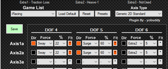

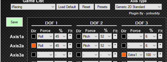

  20. Sebj
    Sebj Active Member
    Nov 13, 2014
    287
    Canada
    492Coins
    +165 / 1 / -0
    iRacing
