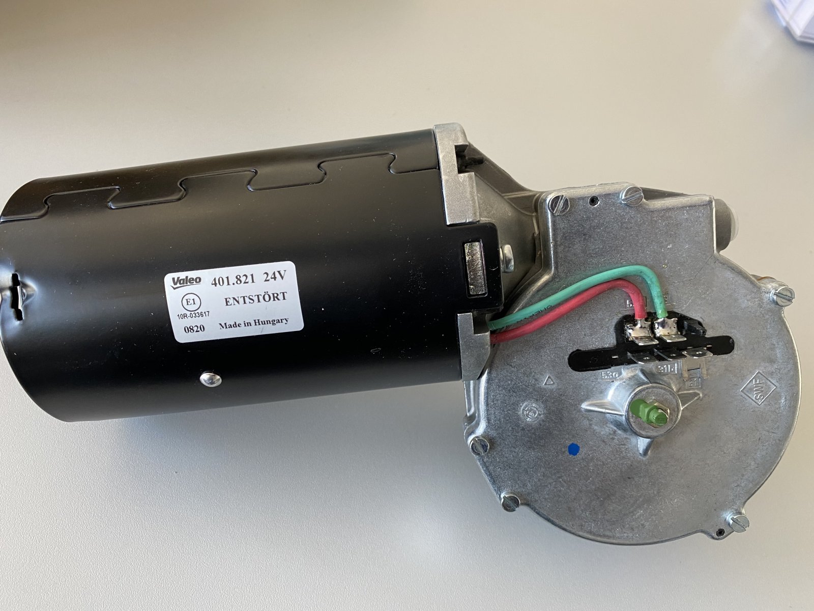

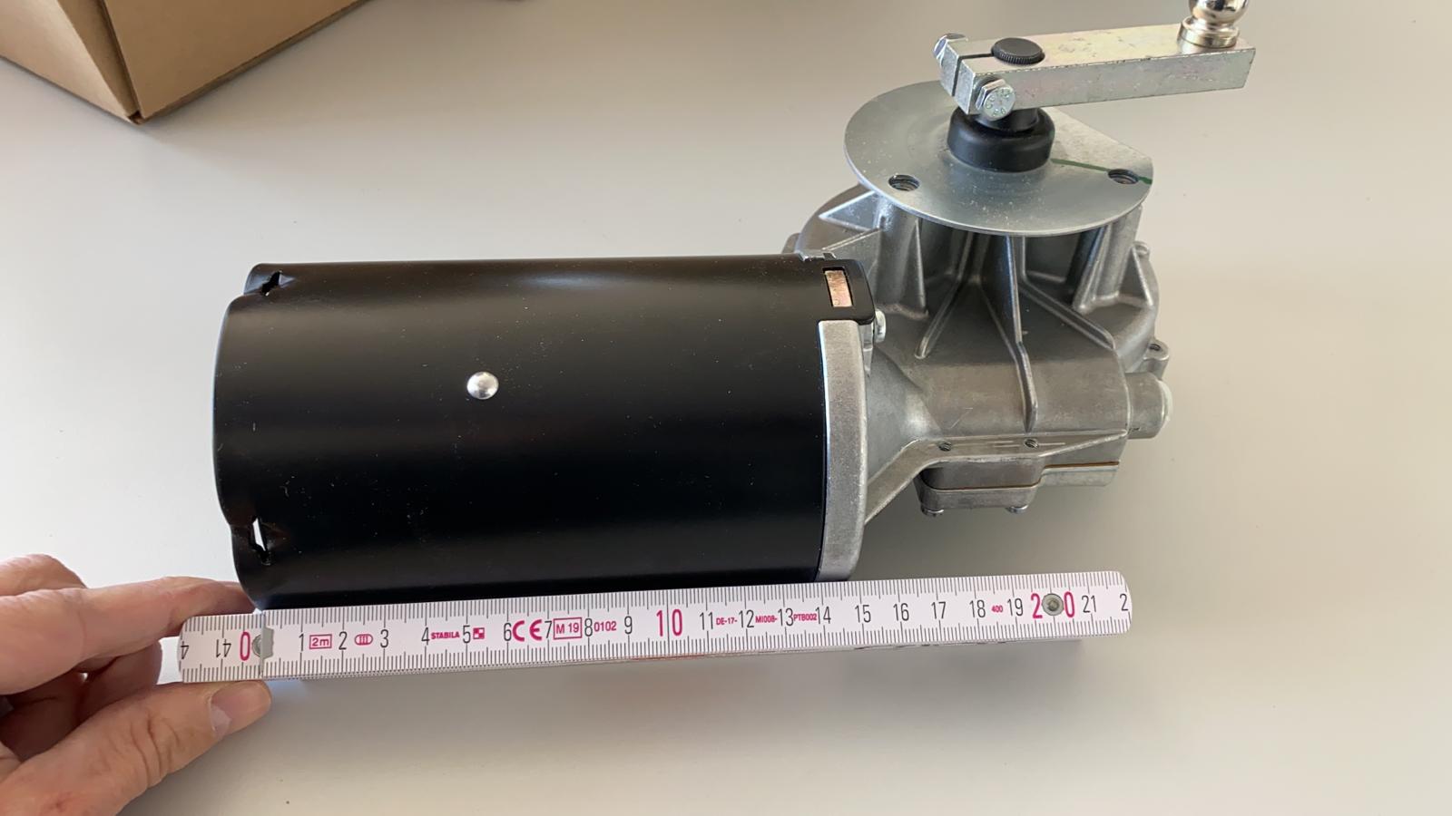

    here I will document my project to my 2DOF platform piece by piece.
    The platform should be strong enough to move the whole frame.
    Therefore my choice was a 24V wiper motor for big buses.
    I found it at the company VALEO. (ca. 160€ each)

    Hi, thanks for sharing.
    Do you have the characteristics and the reference of your electric motors?

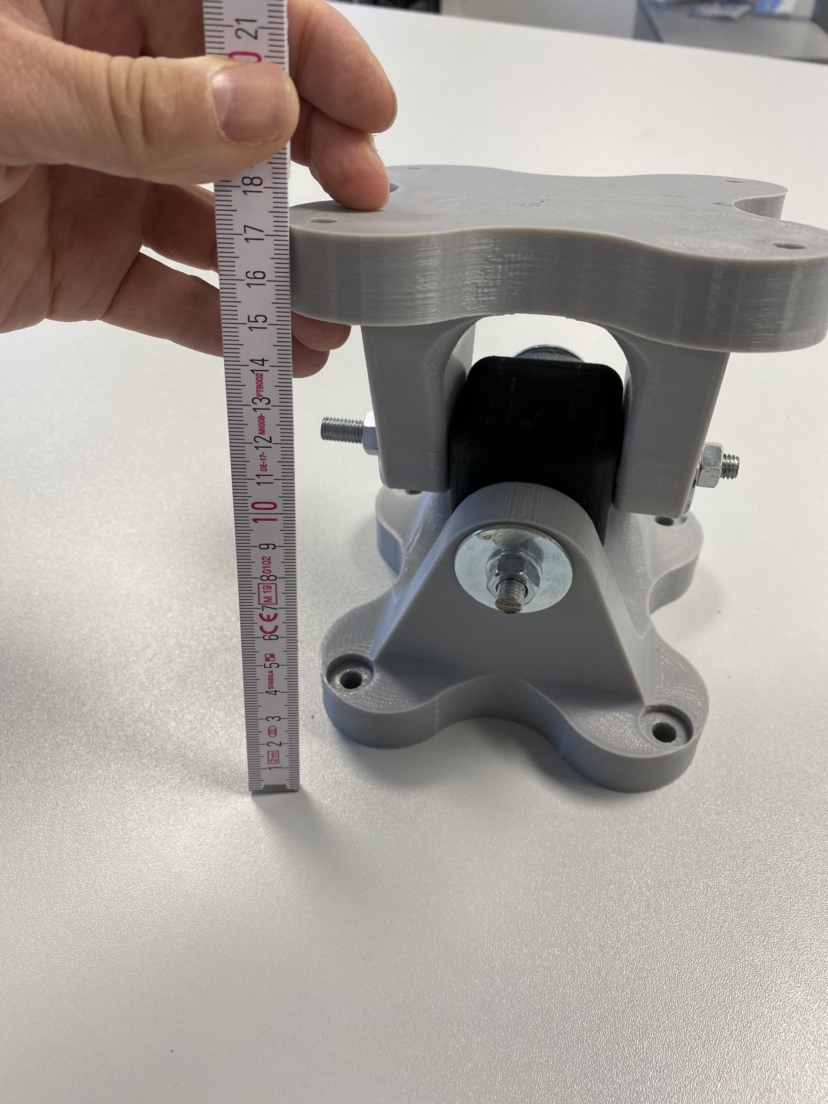

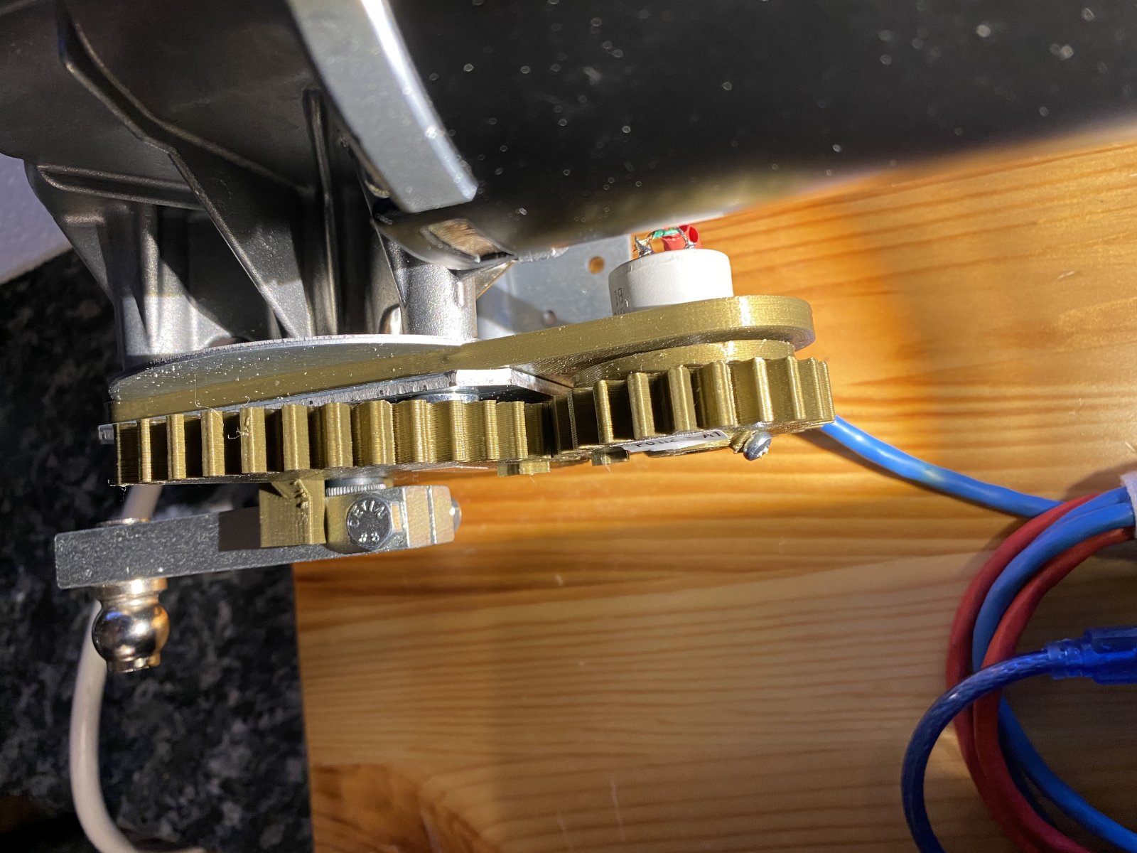

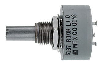

    ... and here's the first test setup.
    The gears are 3D printed.
    Since the potentiometers need nearly 360°, but the levers only 180°, I translated the movement 1:2.
    The potentiometer gear wheel can be fine-adjusted via the shaft to determine the exact zero point.
    IMG-9734.jpg 13_28_58-BI 6187R10KL_ Drehpotentiometer, 10 kOhm, linear, 6,35 mm.png

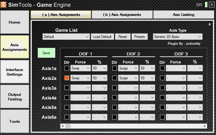

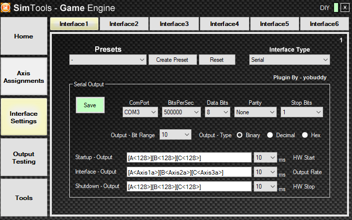

    These are my settings for the SimTools:
    To start: [A<128>][B<128>][C<128>]
    Interface Output: [A<Axis1a>][B<Axis2a>][C<Axis3a>]
    On exit: [A<128>][B<128>][C<128>]
    When starting and stopping, the motors move to the zero position.

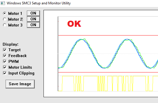

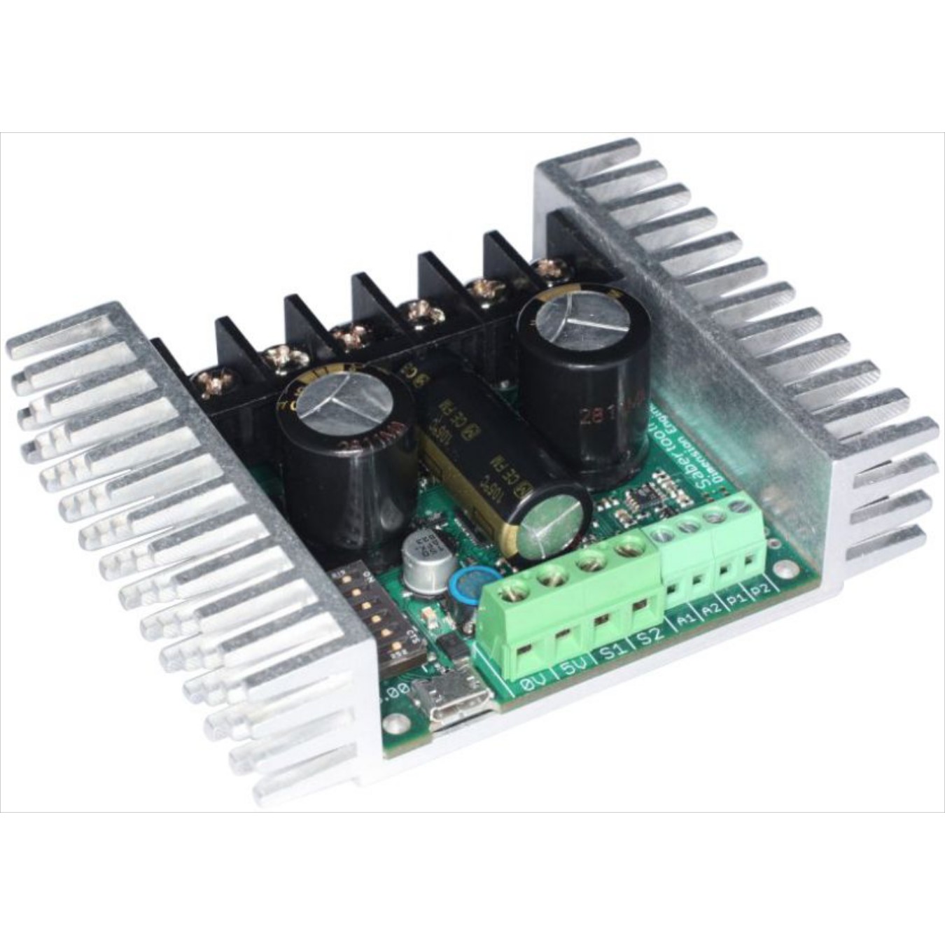

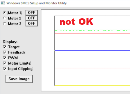

    If you suddenly have problems with the Sabertooth or the motors not working, it may be that the feedback potentiometers are running outside the MaxLimits.
    You can easily check this with the SMC3.
    The green line must be between the two red lines.
    NOTOK Windows SMC3 Setup and Monitor Utility.png OK Windows SMC3 Setup and Monitor Utility.png
