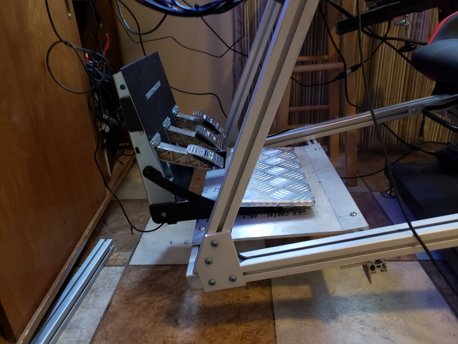

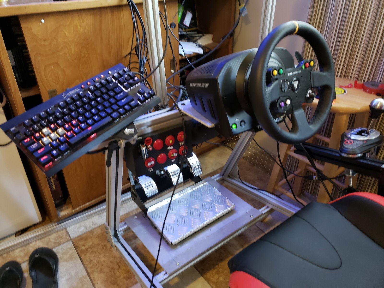

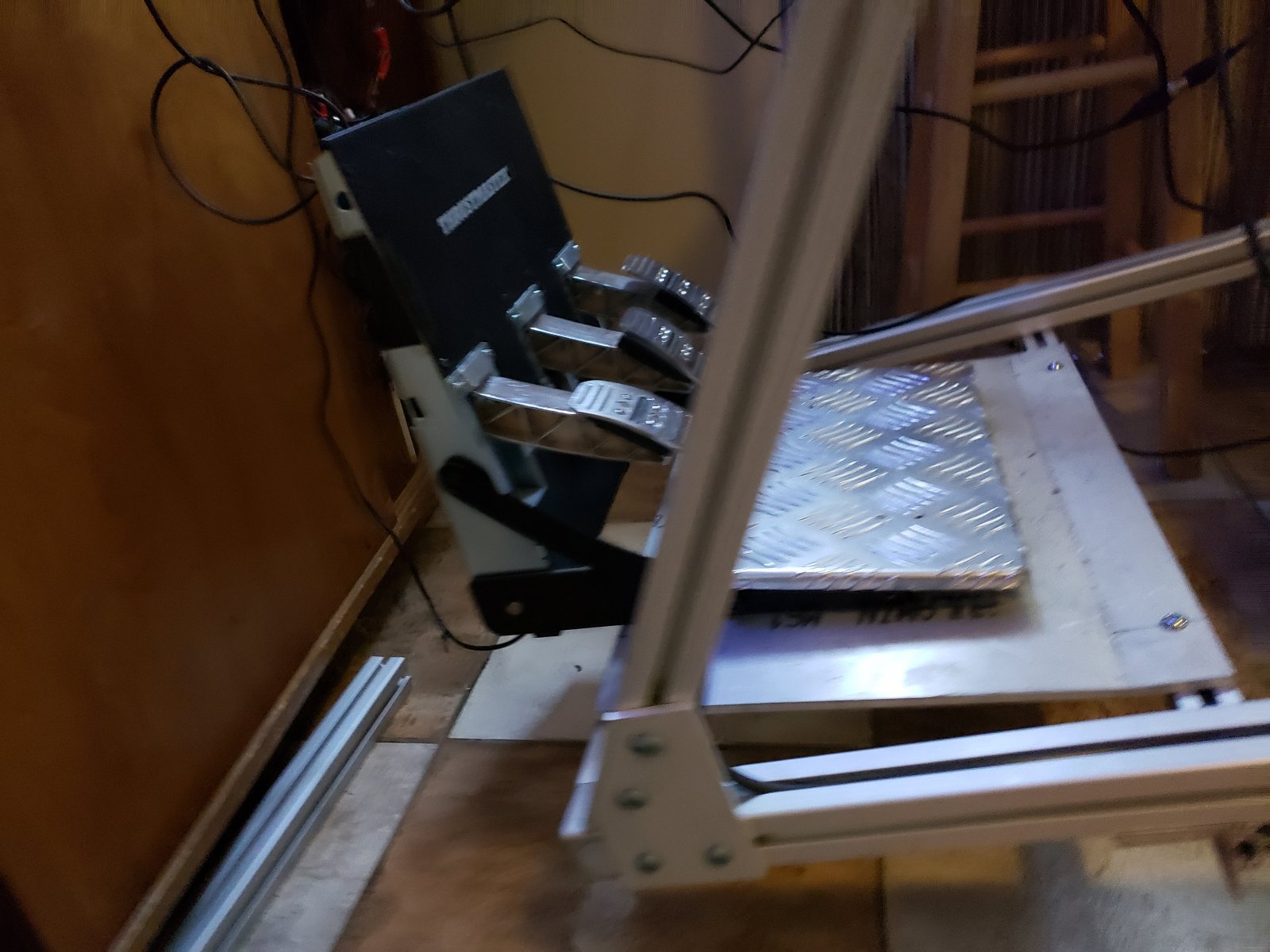

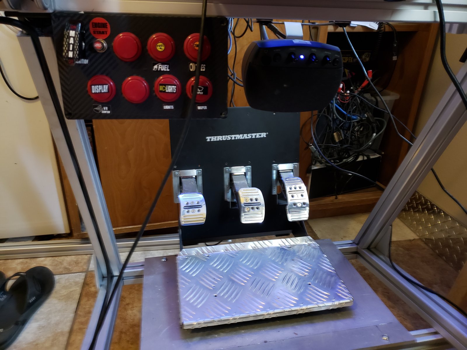

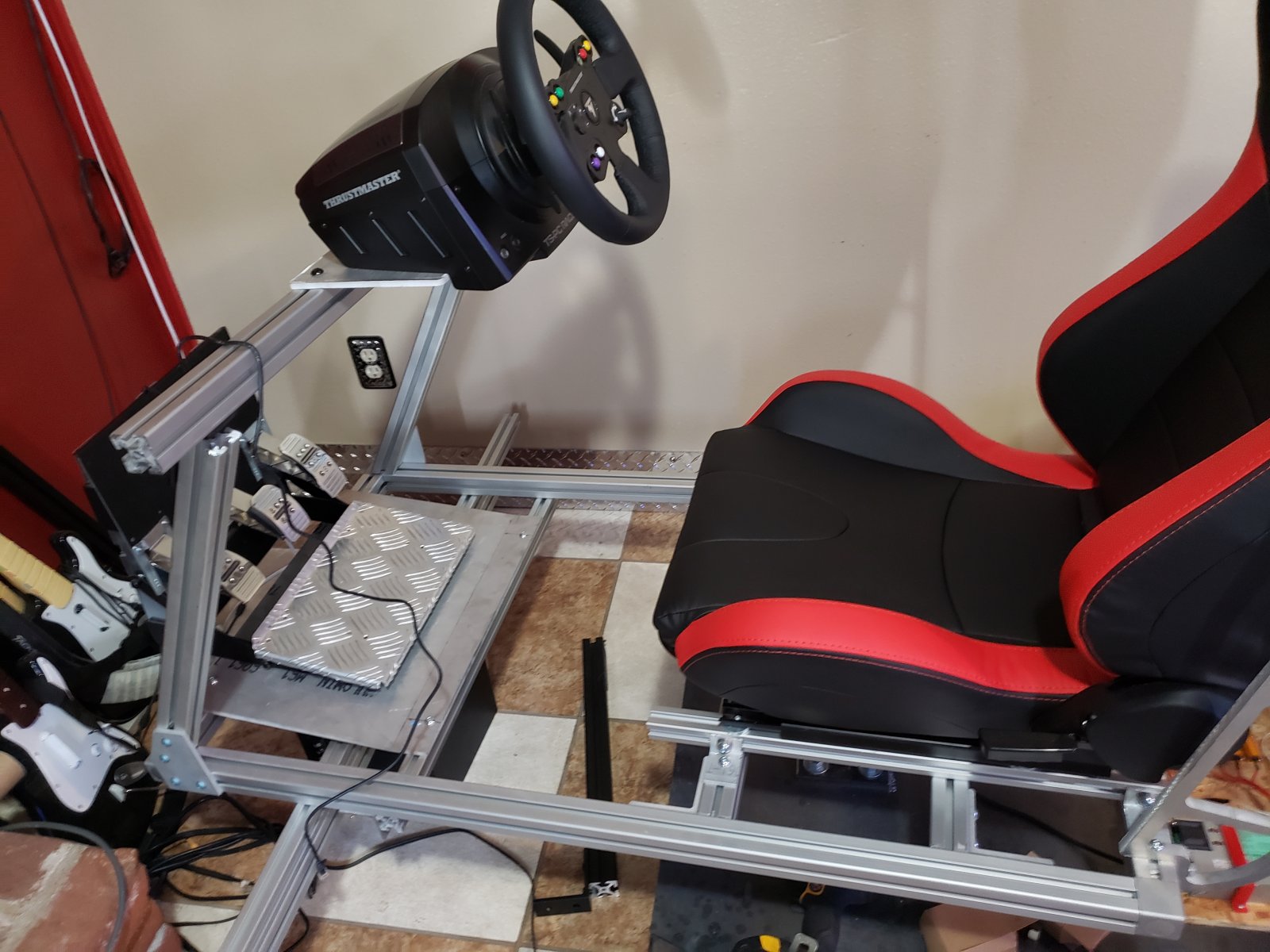

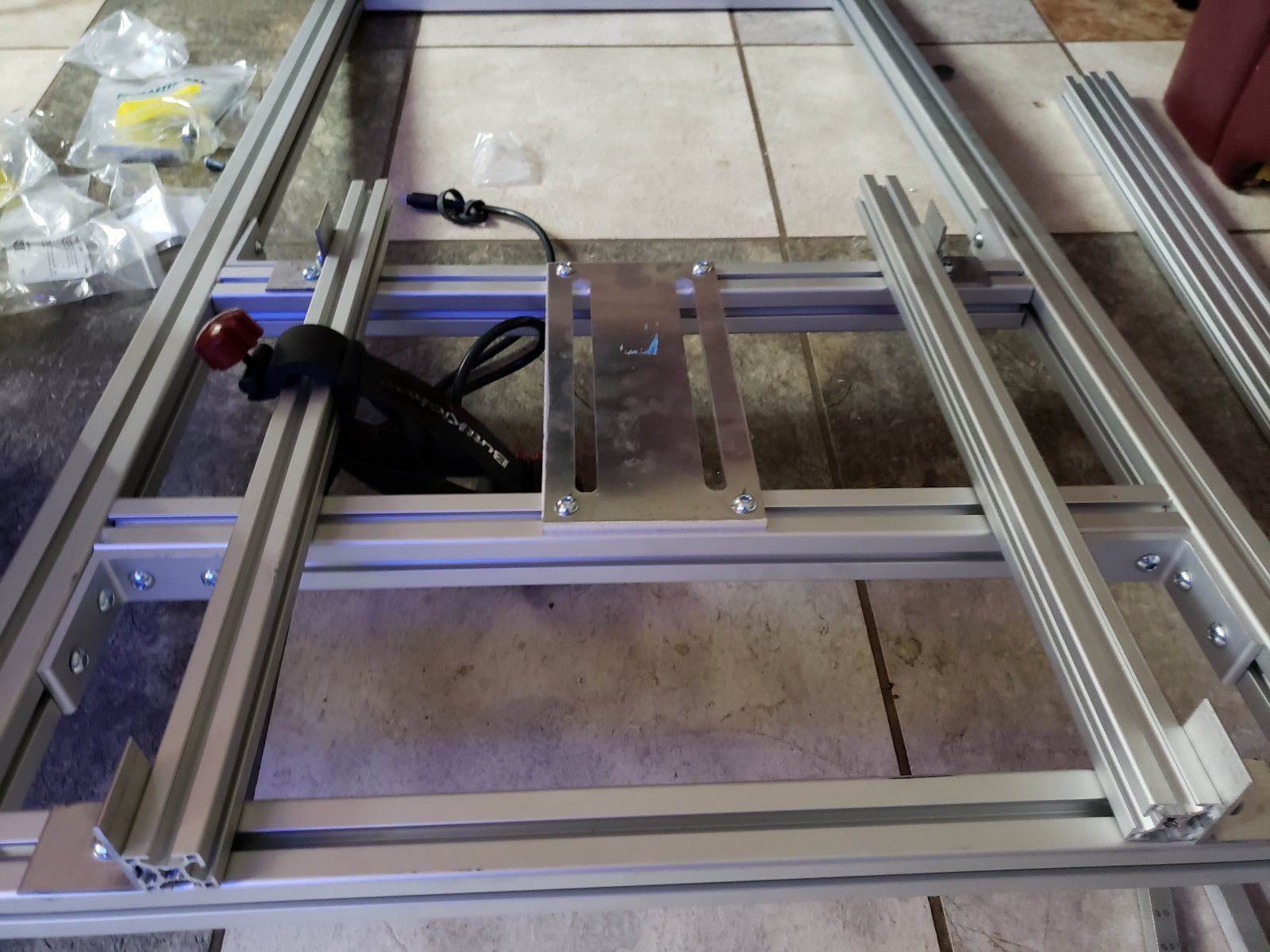

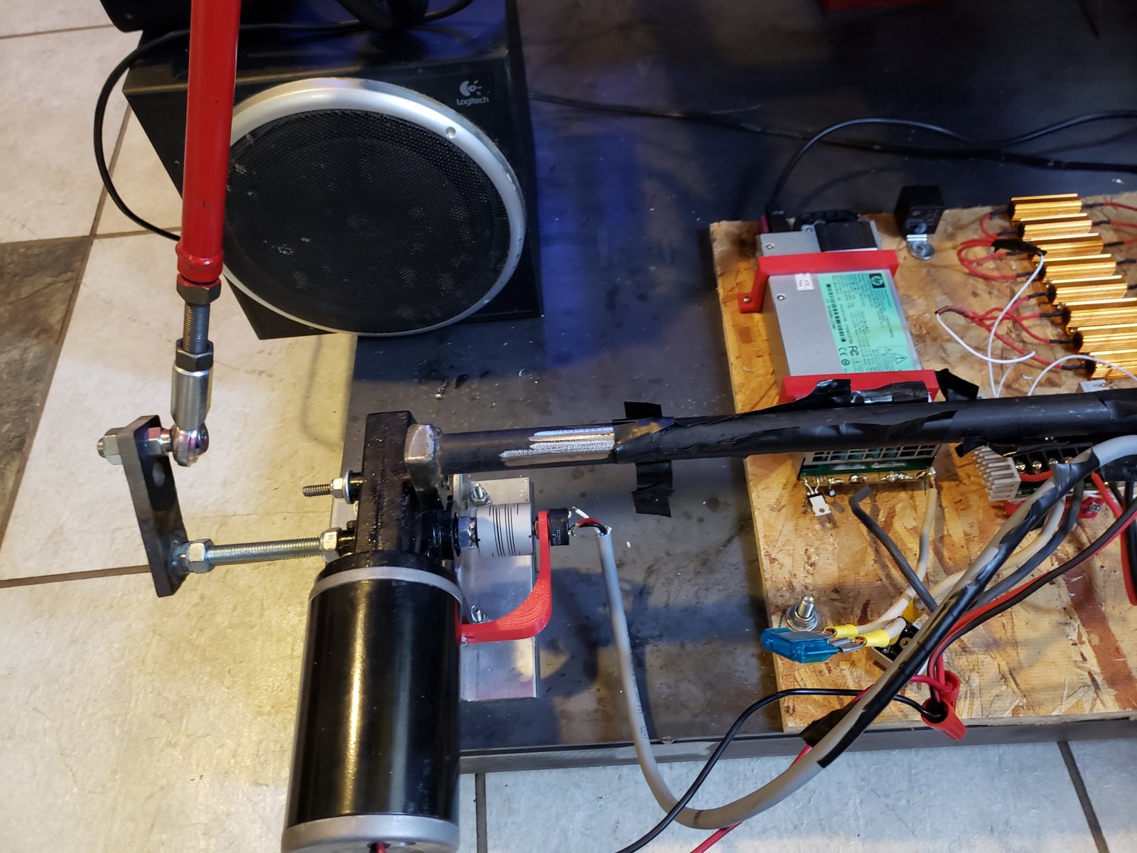

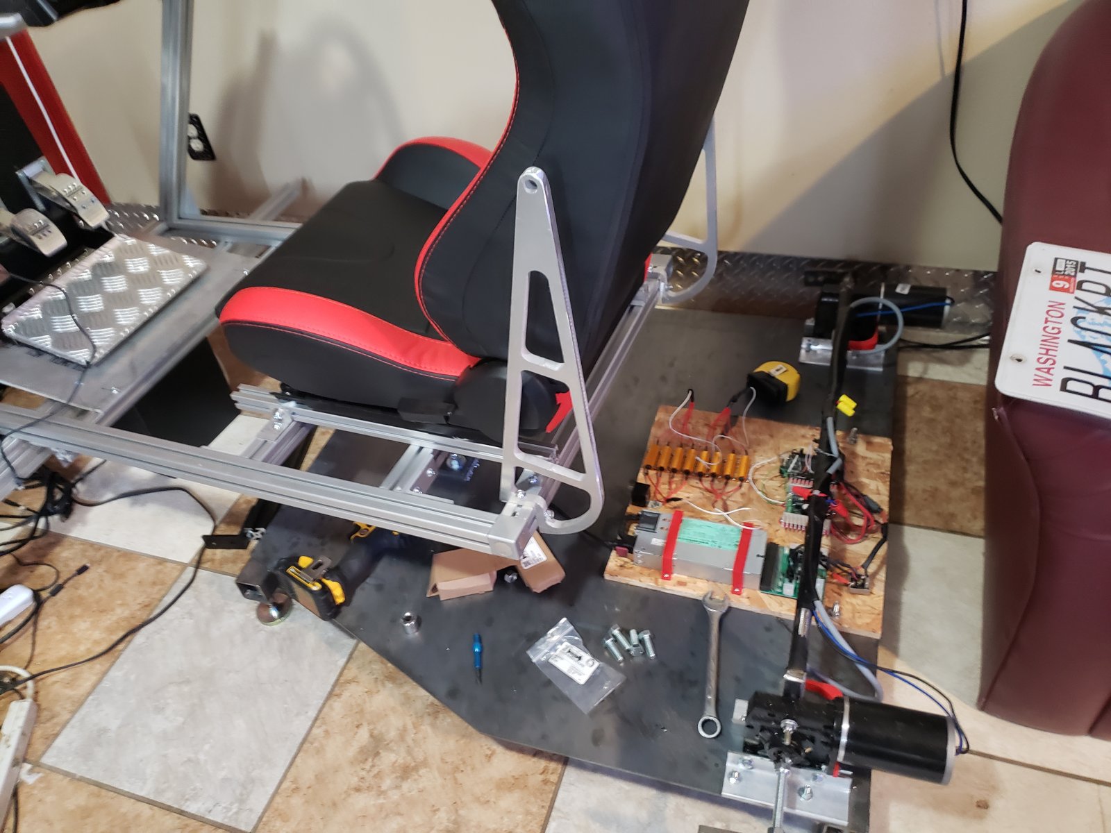

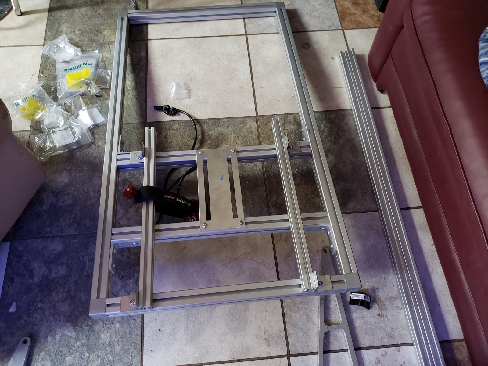

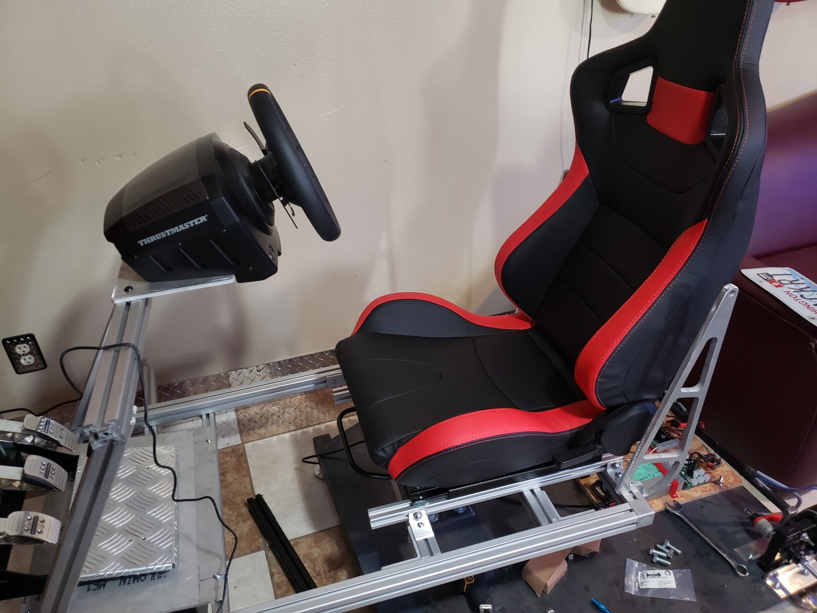

    Feeling pretty exited. After a lot of trial and error, and waiting on the correct 8020 because the vendor shipped the wrong size, here we are with an update. 8020 frame (mostly complete.) the wheel mount needs to have a small angle tweak, and needs to be cut down about 1-1/2". Also need to have the balance shifted rearward. Hopefully the way I designed the 8020 this wont be a problem, just loosen some screws and slide the 2 main cross supports forward. Actuator rods are complete and welded, I will mount those today when i get home. So this weekend will be transferring all of the software (Simtools, SMC, Arduino, etc) to the gaming computer for testing and tuning. Then cleanup the electrical, add an emergency stop, mount the gearshift and button boxes, and maybe build a monitor stand. I have not decided to make the computer a desktop rig at this point or to mount it to the side of the base somewhere. If i did it again i would shrink and lighten up the base, as it is probably 60 lbs, the seat frame is nice and light, the main weight is in the pedals, ans wheel. Please excuse the mess, I always seem to take pictures before I clean up, or mid process. Anyone have any good ideas for a butt kicker mount on 8020 framing? It doesn't want to fit properly. 20190417_102950.jpg 20190417_102955.jpg 20190418_175818.jpg 20190418_175822.jpg 20190418_175829.jpg

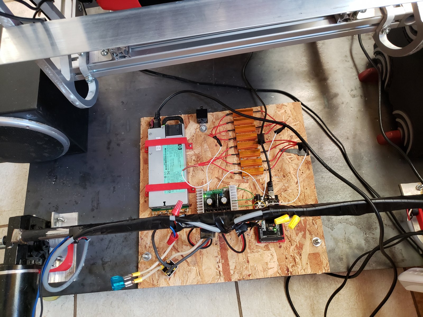

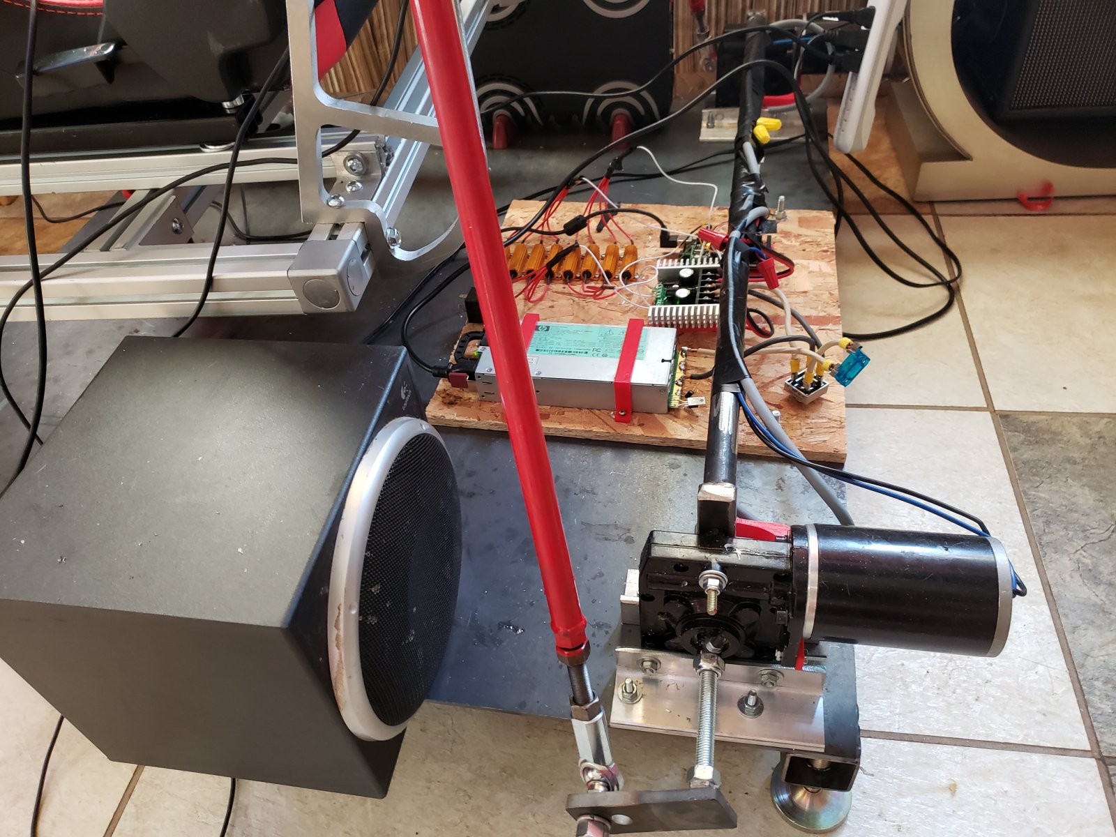

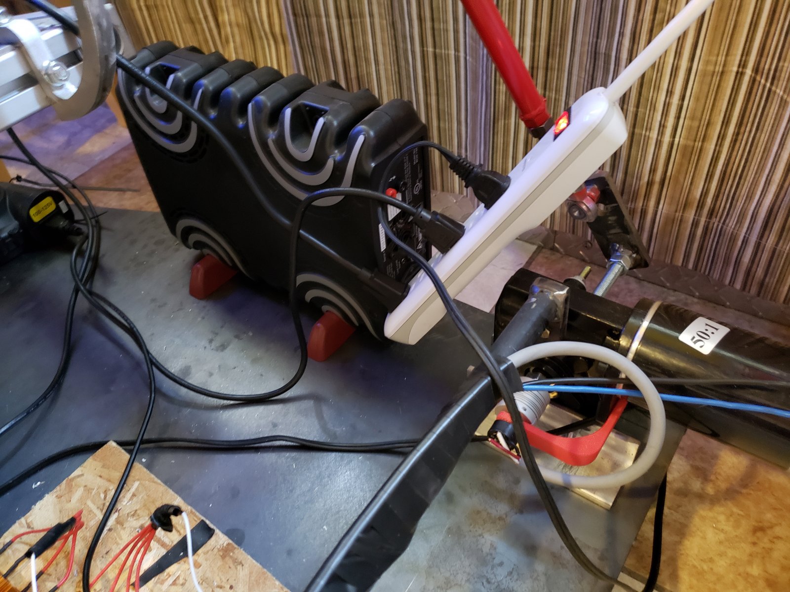

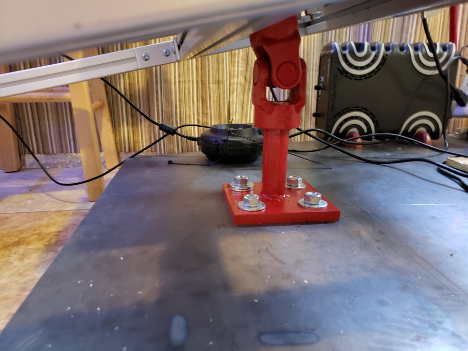

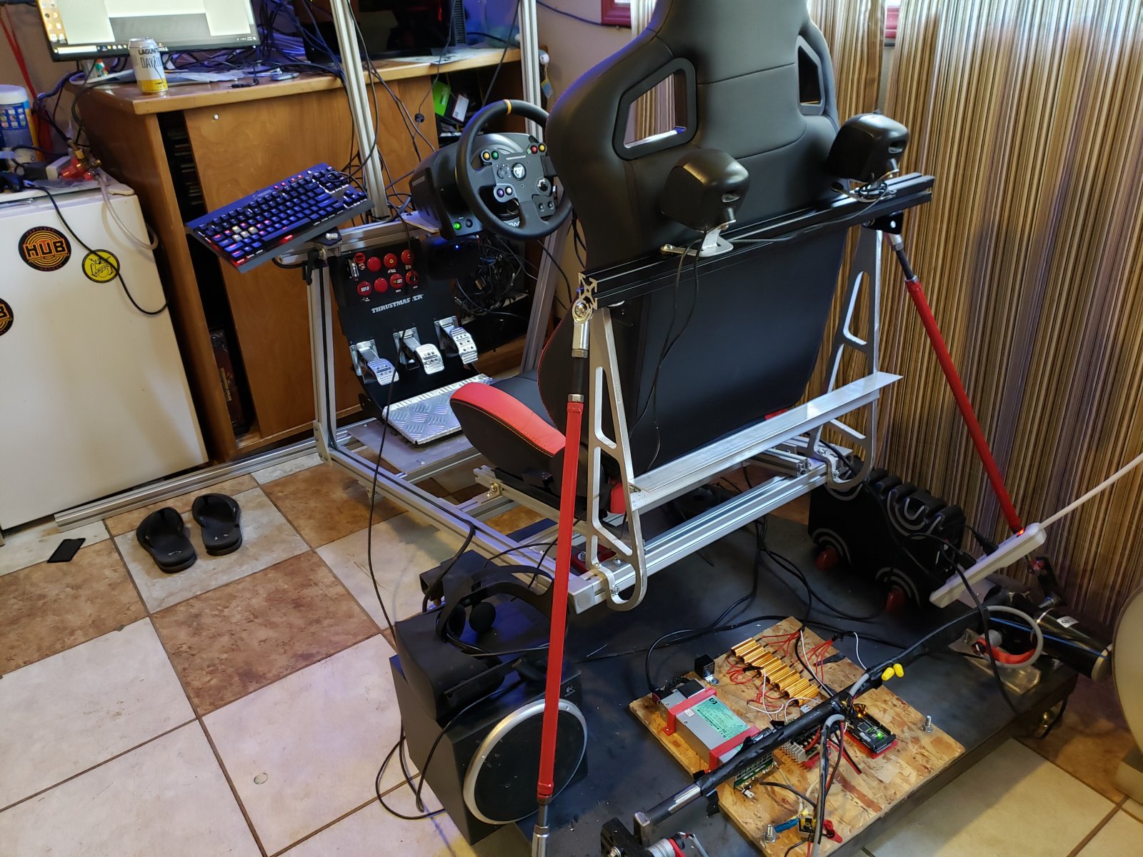

    Havent posted in a while. Its all up and running, now to just tidy up the wiring. A couple notes for anyone following this: I had to reinforce the arms that attach the actuator rods as I was getting too much flex. I also will be adding reinforcement to the 8020 frame as it creaks a bit under motion. Other than that everything is working great, it almost it too powerful, i have had to dial the settings in the SMC3 back to 215 pwmax, and lower my percentages in simtools to tone it down a bit. Here are current photos.
