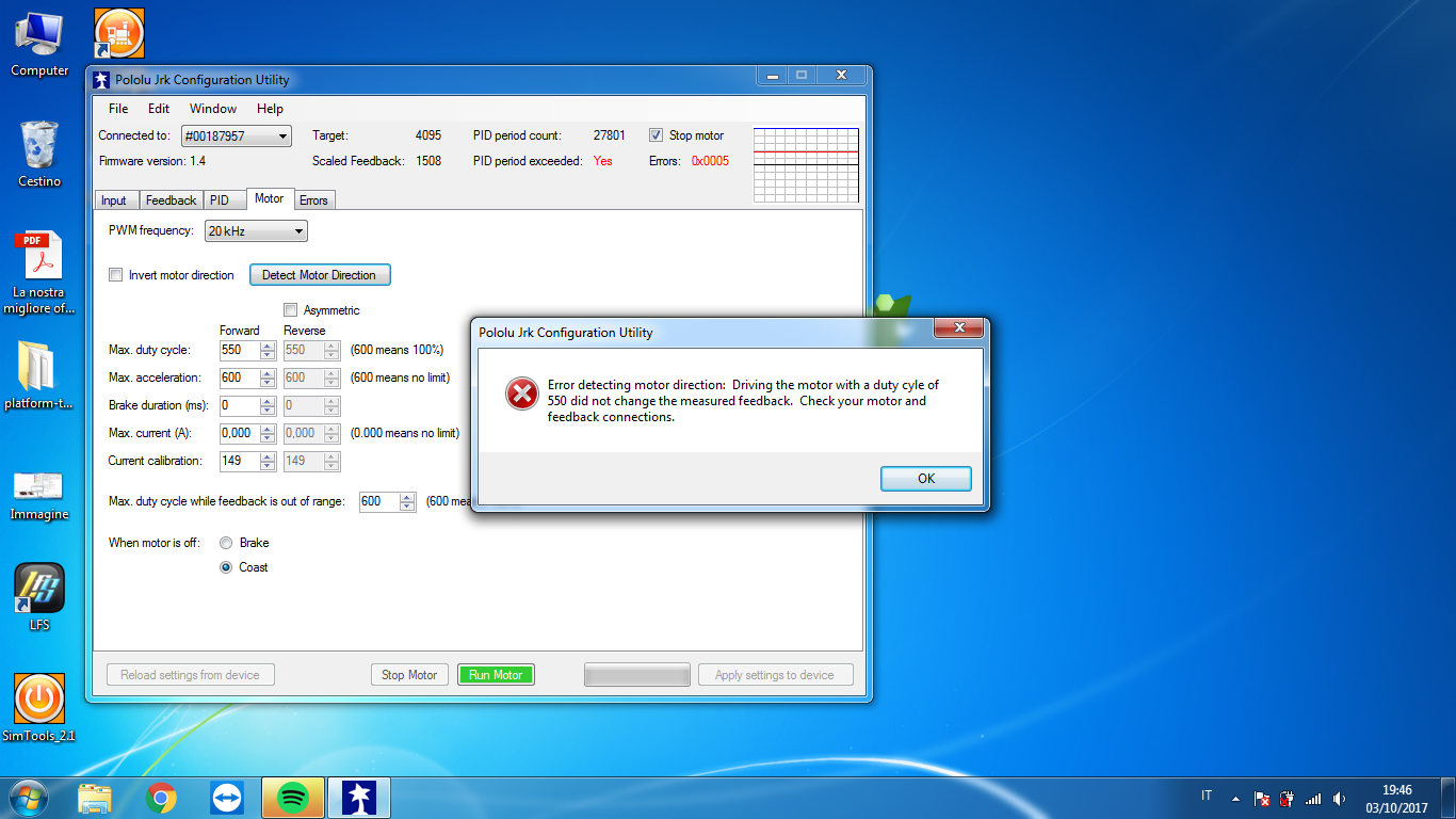

    I receive this error from my right motor..

    I've tried to change duty cycle to 400, and works perfectly! Anybody knows Why?
    Only sometimes I hear strange rumor like it's under load to change position, maybe it's too new...no?
    Maybe it's my old laptop that can't drive 2 JRK..Is this can be the problem? Tonight i'm very tired, so I can't try with my powerful pc :D

    Have you checked the motor and feedback connections, as that is what the error message indicates you need to do.
    The screenshot also shows the Pid Period is exceeded, so it would help if you post pictures of all of your settings.

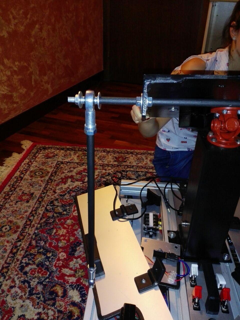

    I have investigated my problem with a little bit methodological approach:
    1) I have disconnected my rod and my lever from motor, and I have tested motor without nothing attached on it; It can spin at 360° without any problems. So from this test I can suppose that JRK, connection and motor itself are fine (right?).
    2) I have re-connected my hall sensor and I've verified that it works well with JRK. In fact, I can see it moving well, if I move motor by hand (like left hall sensor). So from this test I can suppose that Hall sensor is working correctly (right?).
    3) I have inserted my lever into motor and....ZAC! Even if I test with feedback option or without, sometimes motor can't move, like something blocks it. Maybe my words are not very clear, but in this video you can see well the problem. You can see motor should rotate but it's blocked, and if I touch it, can spin correctly.
    So I think it's a mechanical problem...because my right lever is not free to play..right? I have investigated inside it and I've found a little bit of rust. What can I do to resolve my problem? maybe a little bit of svitol like in this photo? Or It can damage my motor?
    https://images-na.ssl-images-amazon.com/images/I/41Mbi1w0kHL._SX355_.jpg
    The only thing I don't know if it's normal is a "tick" sound you can hear when motor spins, like a gear change position..I don't know if it's normal or it's a problem of PGSaw motor..
    22,039
    153,830Coins
    +11,151 / 57 / -2
    My first thought is that the lever interferes with the housing, or attaching it distorts something, but that seems unlikely as it would be pretty obvious. But to be sure do you have some close up photos of the lever and how it mounts?

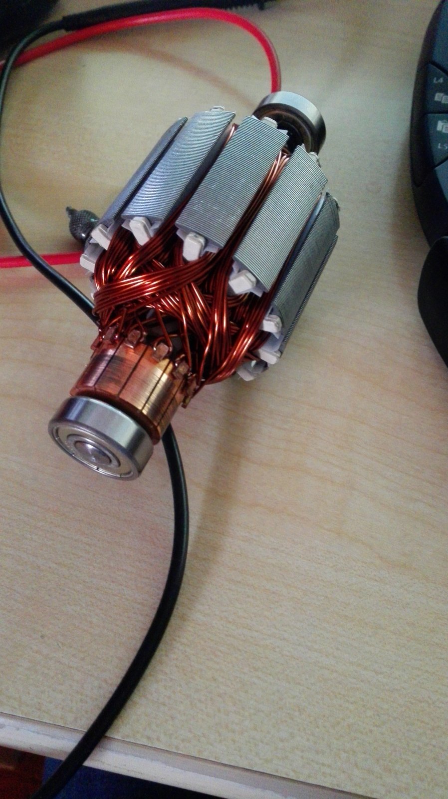

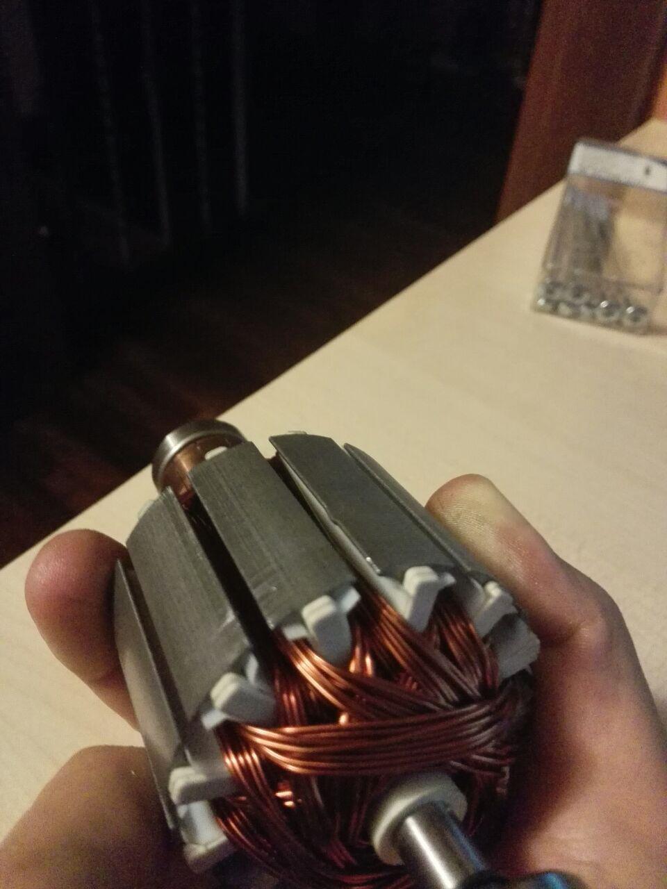

    Updates:
    first of all, many thanks to Zed and noorbeast, they help me a lot in PM to investigate my problem; finally I've found that the problem is inside pgsaw motor.
    I've tried to open it, and I've notice with tester that one spire is broken (it never goes to zero). Now pgsaw send me another motor, so i'm waiting..maybe two week.

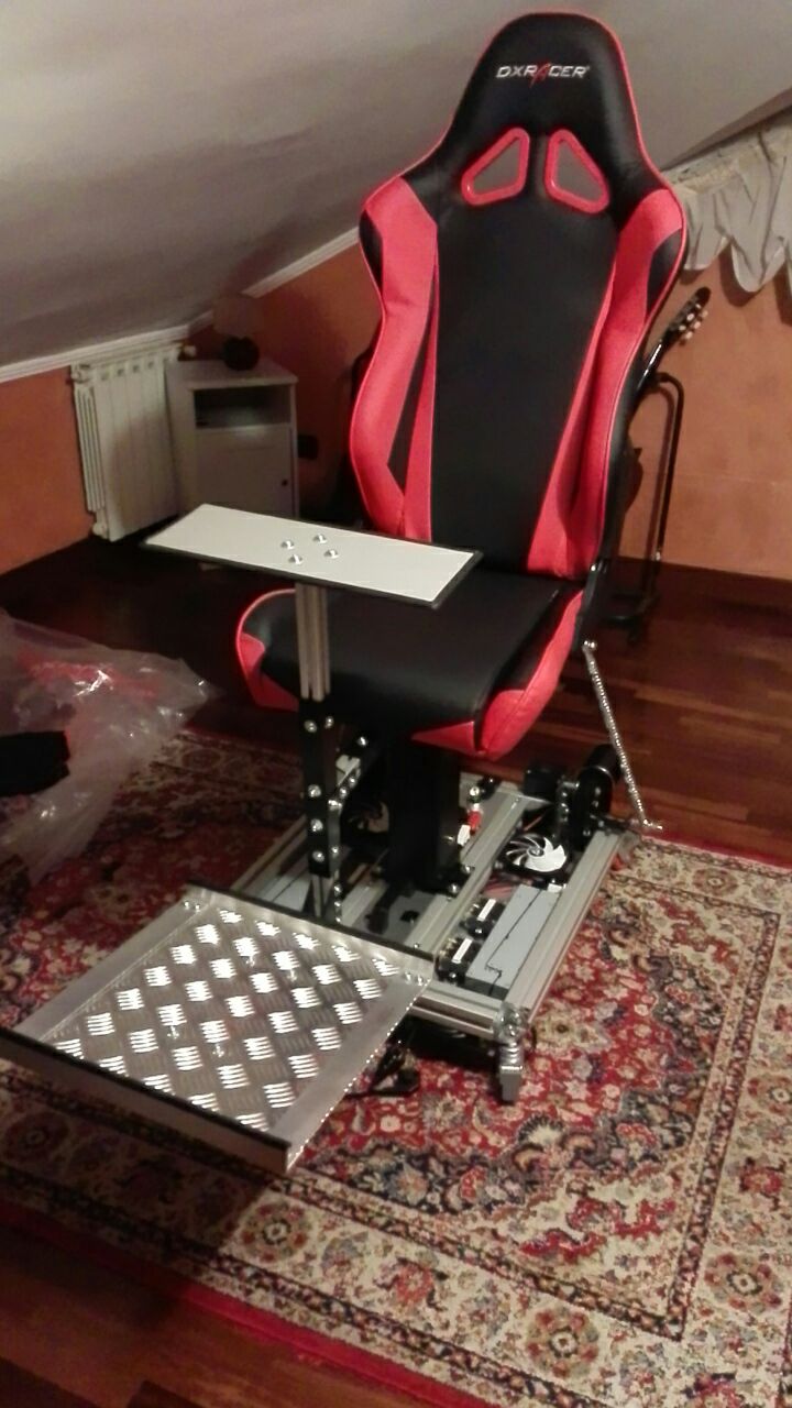

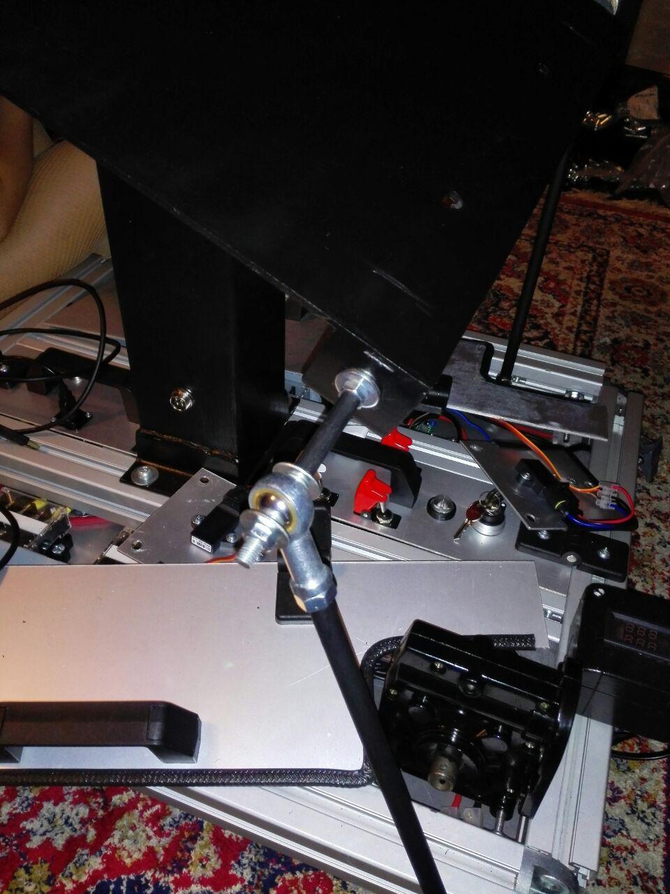

    While i'm waiting for a new motor, i'm working to reduce angle of my rods. What do you think about it?
  15. noorbeast
    22,039
    153,830Coins
    +11,151 / 57 / -2
    That looks much better for a compact design.

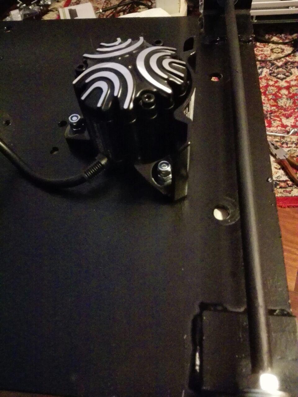

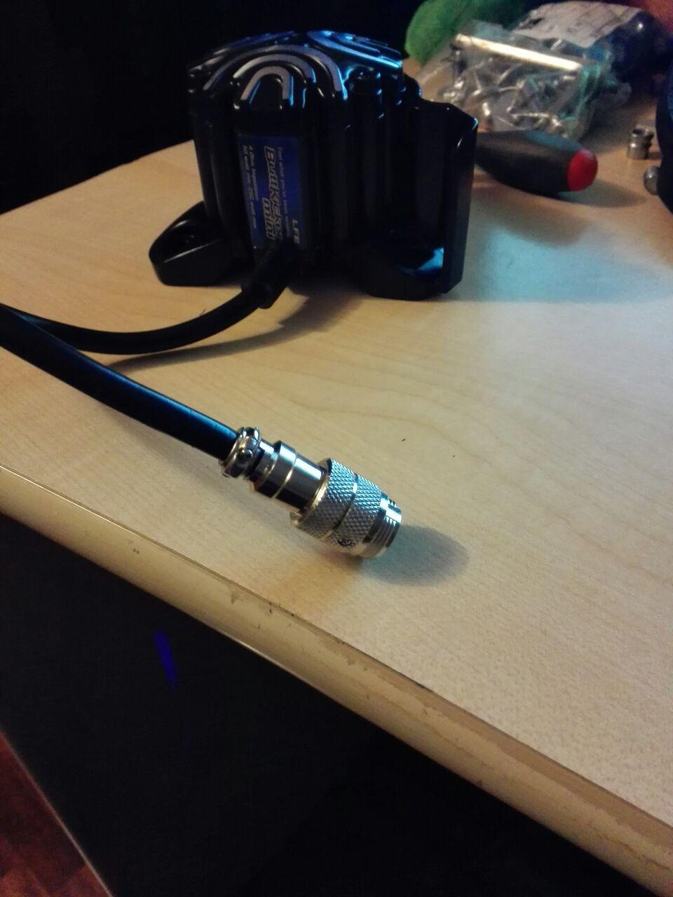

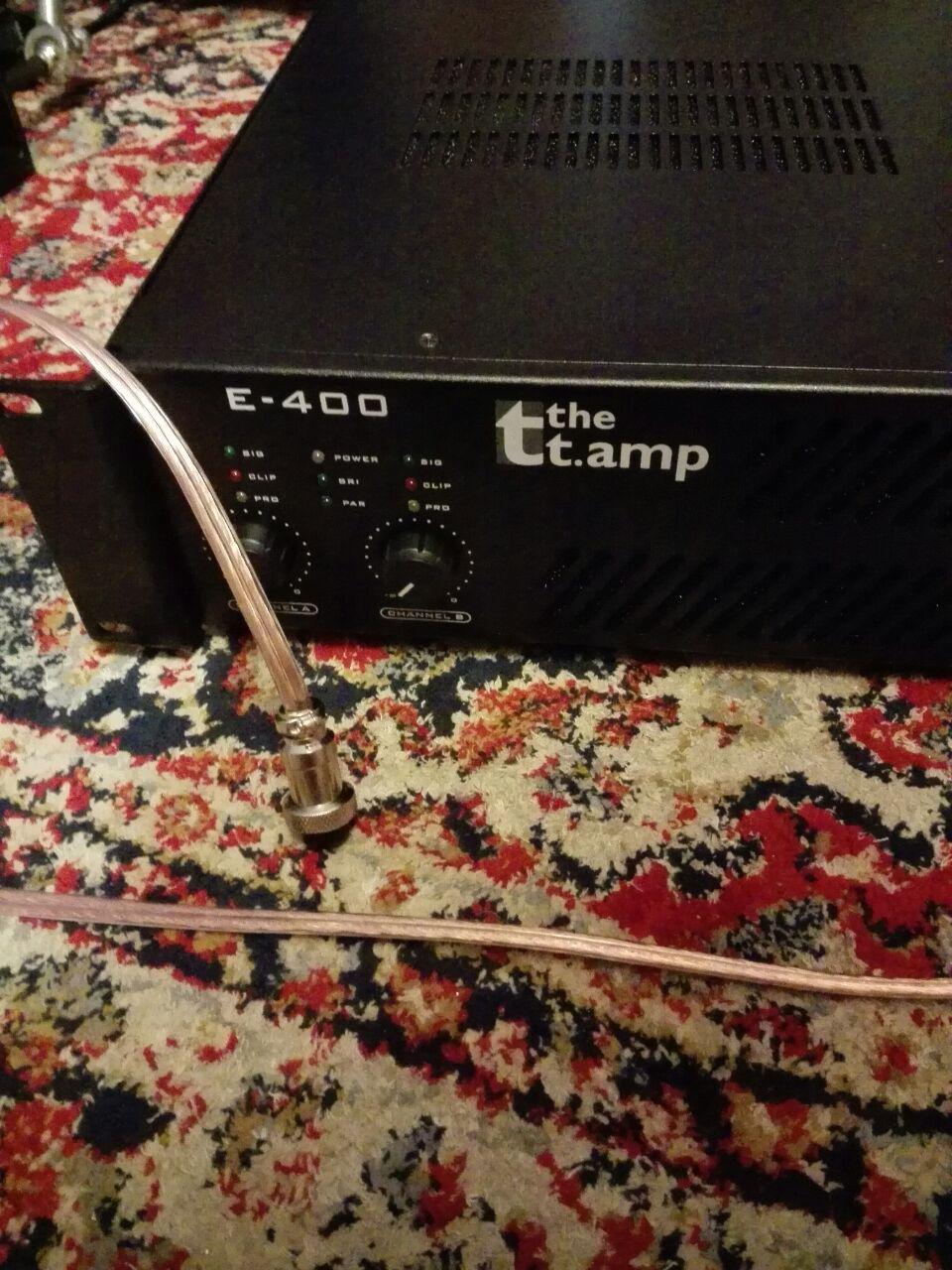

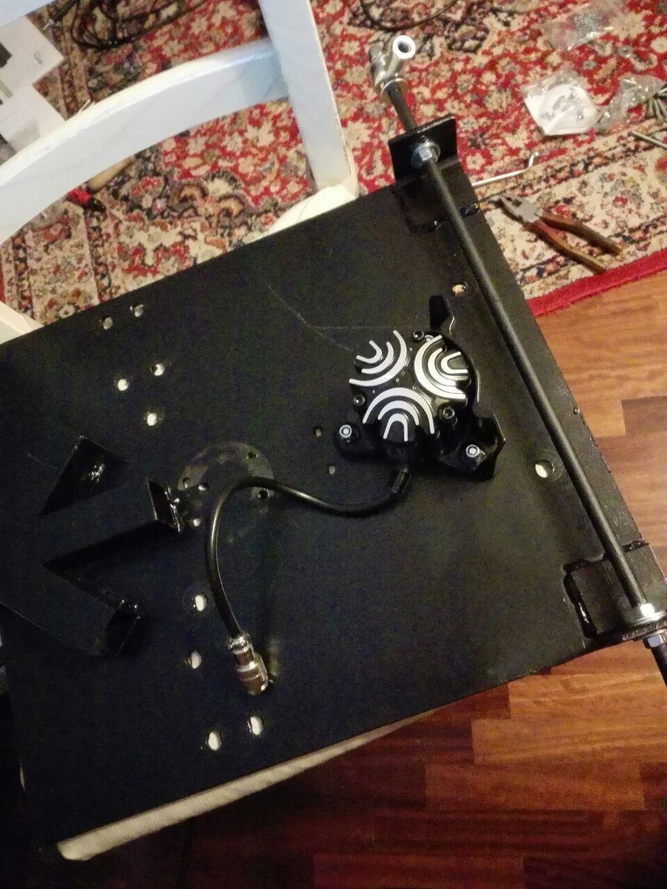

    Today i've received buttkicker and amplifier...so i've worked on it.
    photo_2017-10-17_20-15-40.jpg photo_2017-10-17_20-15-41.jpg photo_2017-10-17_21-12-19.jpg photo_2017-10-17_21-12-24.jpg
    I think I need a crossover between output of amplifier and buttkicker, because I can listen sound through bass shaker.

    No.
    I've bought that amplifier because has 200w per channel and it's not too much expensive. I've already bought a crossover from amazon, and i'm waiting for it

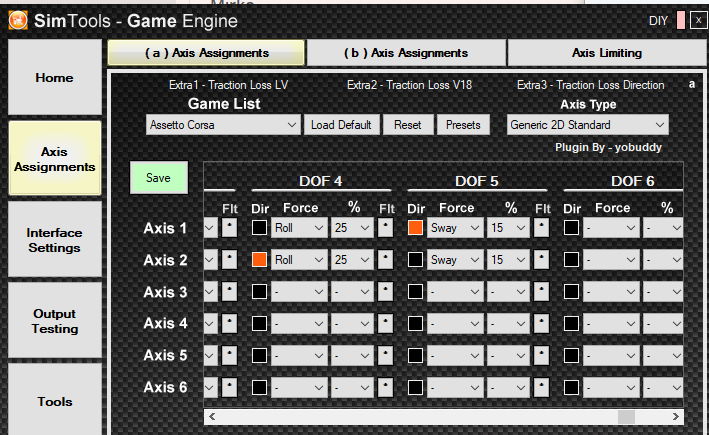

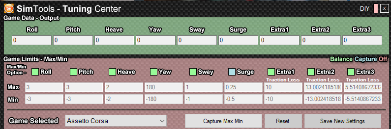

    Hi guys!
    I've received my new motor, so I'm starting to "simming" ! :)
    Nothing to much to say...let's talk using video. In this video I only explain (in Italian) for a friend and show my sim in little details, so if you are not interested you can skip it:
    I've configured JRK as eaorobbie explained (so with the same parameters), and this is my simtool setting:
    I'm not fully happy with this setup, I need to refine it, so any suggestion is VERY appreciated.
    Mirko
