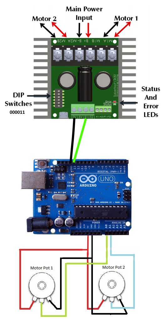

  20. Intruder
    Intruder Member
    Dec 16, 2015
    74
    435Coins
    +24 / 0 / -0
    Thanks for your reply!
    Oh boy, that is a huge PSU !
    So you mean I generally will need car batteries for the sabertooth ?
    And I didn't ordered the kangaroo, I saw this diagram in the Smc3-sabertooth thread:
    Would you recommend a kangaroo? And what does it do? ( not just jumping around I think;) )
