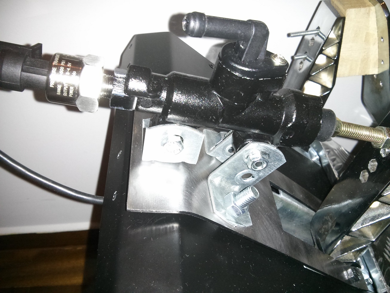

    I completed the mod without removing the internal dual springs of the t500 brake pedal.
    First impressions.
    I don't know how much trapped air is inside the cylinder(this can be changed to one's taste)... But the for the first 60-70% of the brake force the pedal has a small amount of travel and the next 30-40% (from 60-70% up to 100%) the braking force is applied by pressure on the pedal without pedal travel at all.

    So following @bruce stephen 's advice, I bought a gauge to measure and be sure of what sensor to use next.
    I will update once I get the gauge.
    For the time being its back to stock.
  8. pipis2015
    pipis2015 over-boost
    Feb 18, 2015
    221
    Athens, GREECE
    10,248Coins
    +272 / 1 / -0
    Another update on the sensor.
    I have been searching all weekend about how these press sensors work, their tolerance etc.
    Well, I found out that they have a mechanical tolerance that is in excess of 200% of their rating. In fact some sheets state 2x-4x the rated max value (1000 to 2000psi for a 500 psi sensor).
    Given the fact that the way my master cylinder is mounted, there is almost no leverage ( my foot presses straight on the pump...there is no leverage to multiply the force) I couldn't convince myself that I damaged the sensor.
    So I re-soldered the sensor cables and mounted the cylinder once more.
    And the damned thing worked flawlessly...
    I will be posting some pics tomorrow.

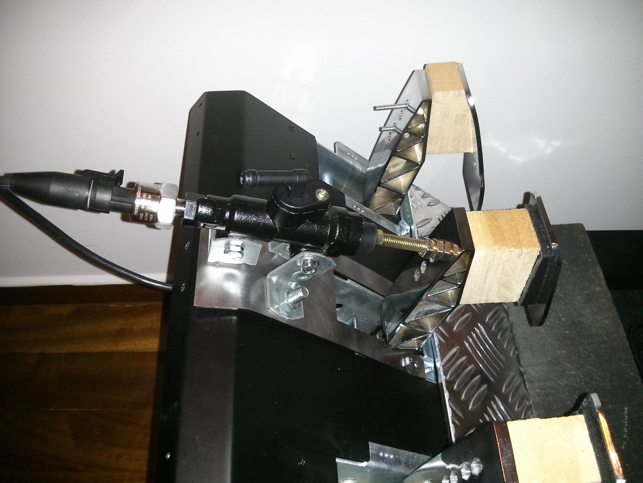

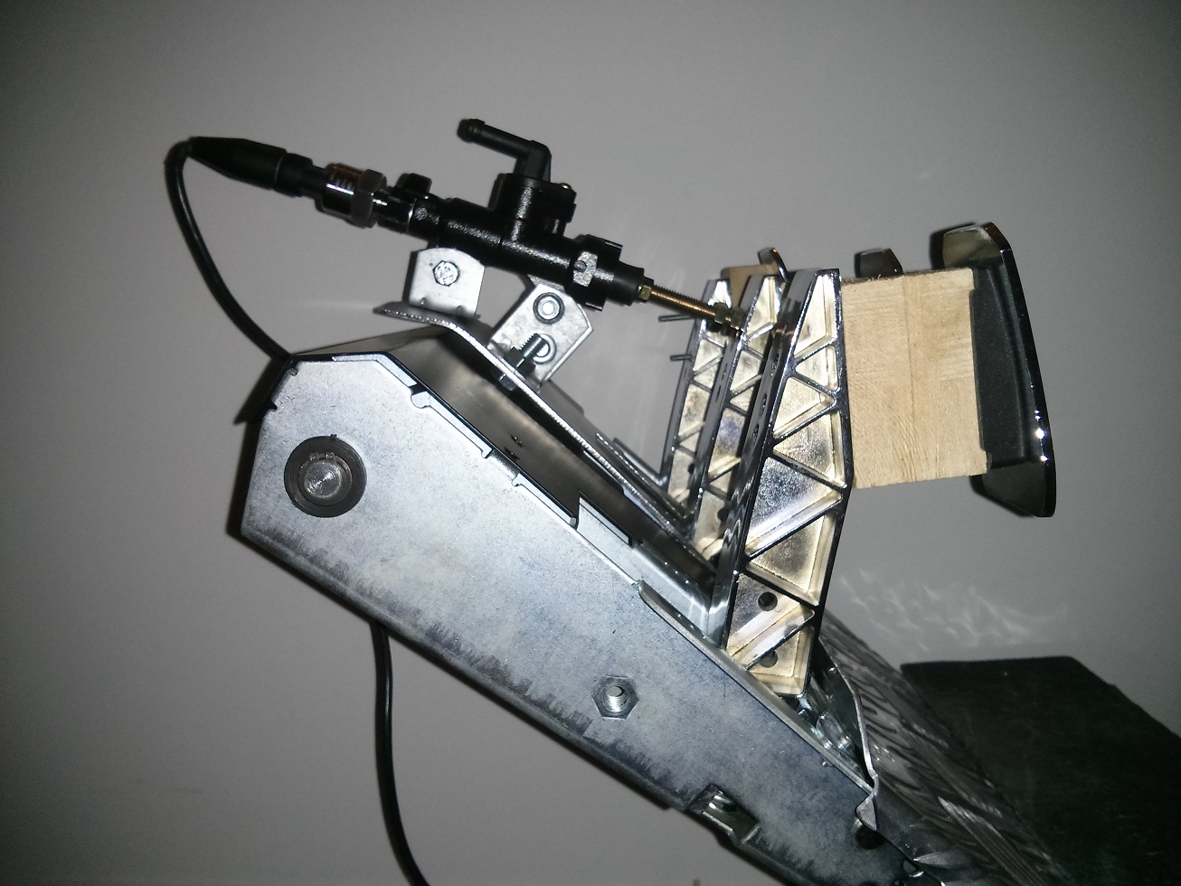

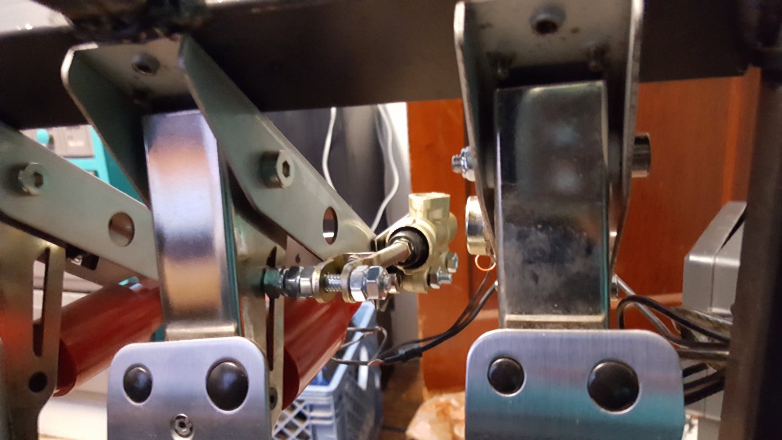

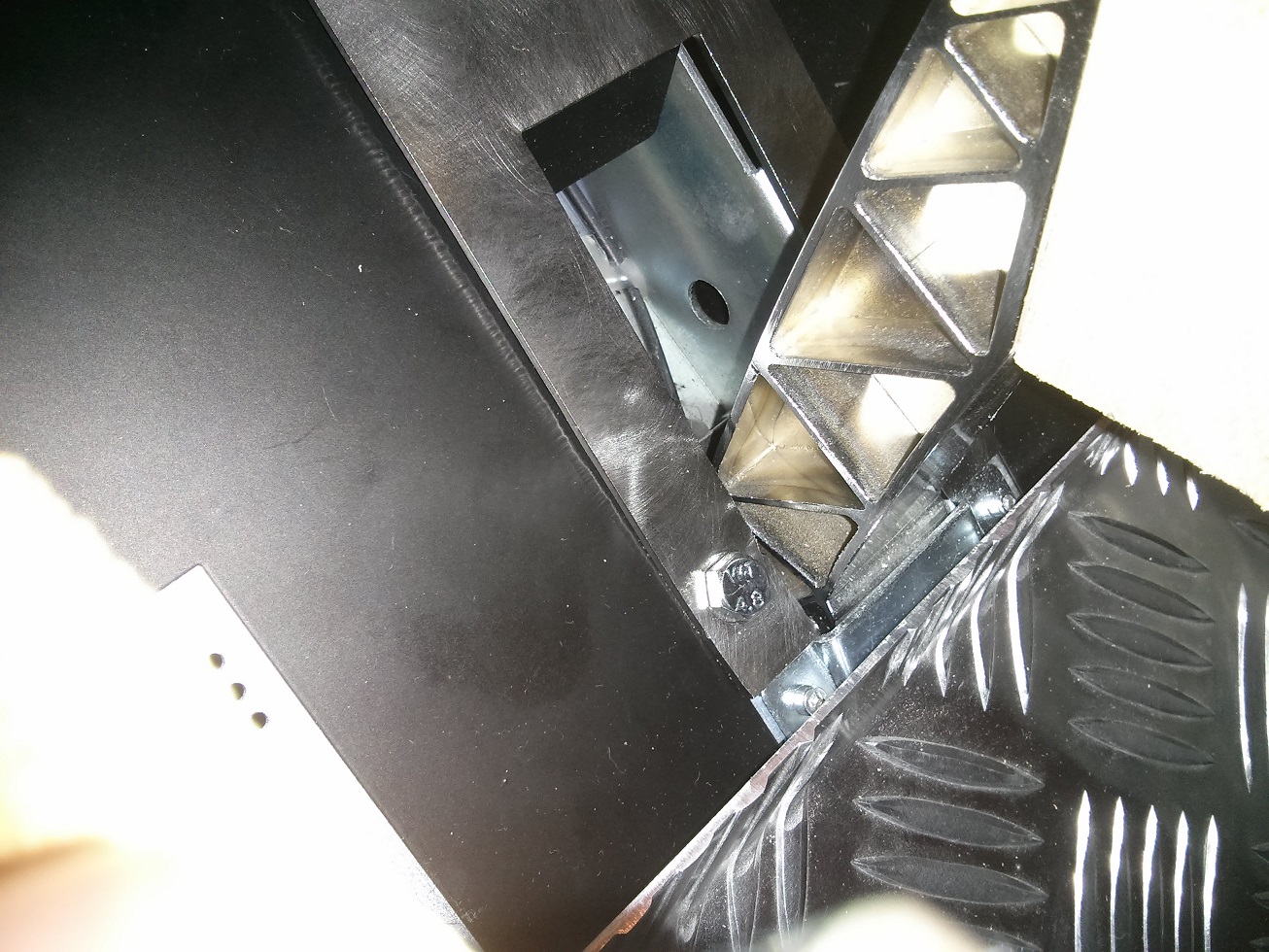

    Next thing i will try to measure the force needed for full braking.
    For the moment i estimate it somewhere between 25 to 40 kilos (roughly 250 to 400 newton) but i could be wrong.
    Once i have a confirmed reading from a reliable instrument i ll post the results.
    As a first impression the pedal feels harder to fully push than an everyday cars pedal (with servo assistance when engine is running) but also a lot softer than the feeling of the brake pedal when the engine is turned off (no servo assistance).
    • Winner Winner x 3

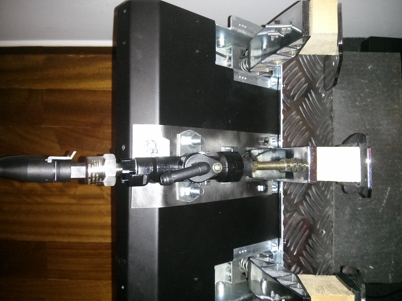

    Nice. How is it interfaced? Did you wire it directly to the existing controller? Or do you have something different. I use g25 pedals with bodnar cable, do you think it will be compatible?
  11. pipis2015
    Feb 18, 2015
    221
    Athens, GREECE
    10,248Coins
    +272 / 1 / -0
    I unsoldered the brake potentiometer (3 cables) and soldered directly the sensor terminals (3 cables: power/gnd/signal) on the pedal board (just a simple conection board with only traces on it...no electronics at all).
    30' job (25 mins for disassembly and assembly and 5 mins for the soldering part).

    Some extra info:
    The pedals are "fed" with 3.3volts (as are the buttons on the steering wheel).
    But the sensor works fine.

    Last update on the hydraulic brake pedal mod.
    Today i removed both the factory springs from under the brake pedal to "lighten" it.
    So its just the master cylinder now (the cylinder has an internal spring that brings the pump/pedal back to "zero" position when no foot pressure is applied).
    I am very happy with the result.
    The force needed to fully press the pedal is also more in proportion to the (motor) force of the steering wheel.
    Without the springs the brake pedal doesnt become fatiguing even after many laps.
    It still is a lot firmer compared to the stock pedal even with the use of the third spring the so called realistic mod.
    The pedal travel is also enough to be able to modulate the braking force (close to 70% of full stock travel).
    Of course the stock springs can be used to tune the feel to each ones taste.
    Would i recomend the mod?
    Absolutely yes.
    How would i rate it?
    A 10/10 would be a conservative rating especially considering the cost.
    DID I MENTION THAT THIS MOD IS ALSO CONSOLE FRIENDLY ???

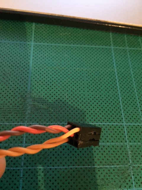

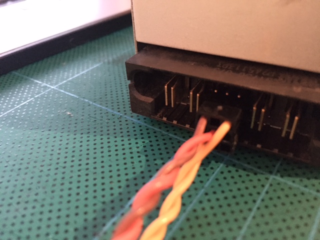

    Hi @pipis2015, first off: very nice work. Your simulator really catched me. I'm currently building a very similar thing, at least I'm trying to :)
    I've got a question according your instructions on the PSU. You write: "A “Y” cable to short pins 6-9-10". In another instruction, I read 6-8-10 and as I'm not really into electronics and need to believe everything I read, I'm a bit confused now. As far as I know pin 8 is ground so this made more sense to me in the first place and I followed the latter (http://www.ultimaterc.com/forums/showthread.php?t=174225). But unfortunately, when I power up the PSU neither the fan stops spinning, nor there is any power coming out. (4 and 8 are also shorted)
    Before I start the deconstruction, are you really using pins 6-9-10?
  19. Blame73
    Blame73 Well-Known Member
    Nov 6, 2014
    1,216
    8,315Coins
    +1,140 / 5 / -0
    Is it a DPS 600PB?
    if yes: pin 4-8 and 6-10
    take a look here:
    https://www.xsimulator.net/community/threads/how-to-modify-a-server-power-supply-for-12v.5774/

    Thanks @Blame73, yes indeed it is a DPS 600PB. That makes it two for 6-8-10 :).
    So most probably my PSU is just broken :(
