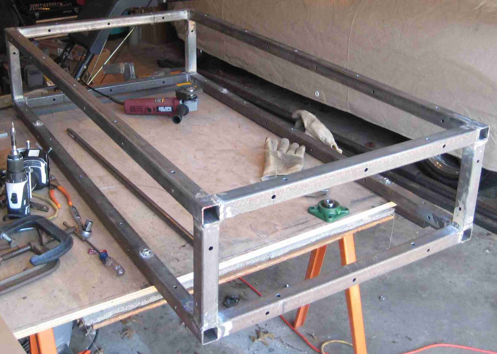

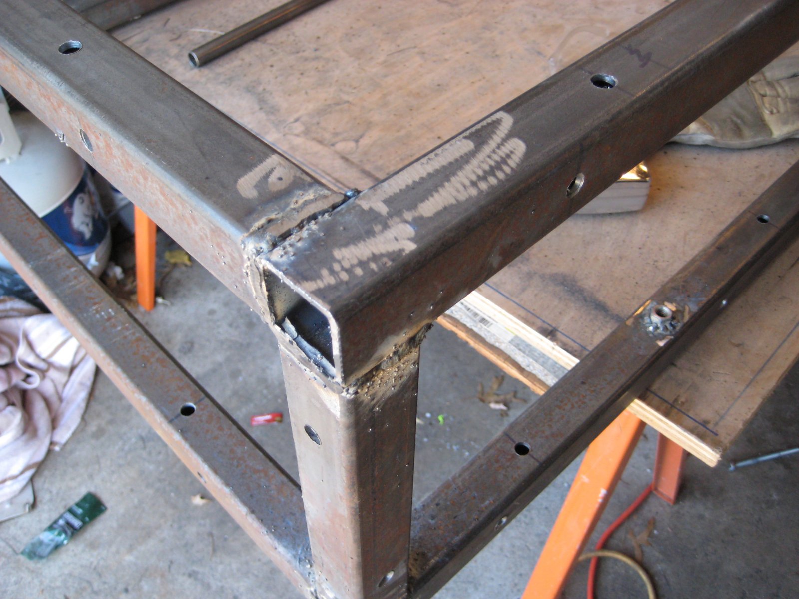

    Small update. Purchased all square tubing. Actually found a local steel shop that has all sorts of metals so will be using them during the build. Everything is cut and per-drilled. managed to put base together. Since I am limited on space planning to use it to install PC, power supplies, hardware. This way it is tucked under the sim and is not in the way. Hopefully welds are strong enough, this is my first time welding and I can't really tell the difference. It is certainly has a solid and sturdy fill to it.
  17. Nick Moxley
    17,057Coins
    +2,506 / 30 / -2
    Looking good Reko, Welds dont have to be pretty, That's what the grinder is for, and In time you will improve the quality on the first pass. Keep it up. :cheers
