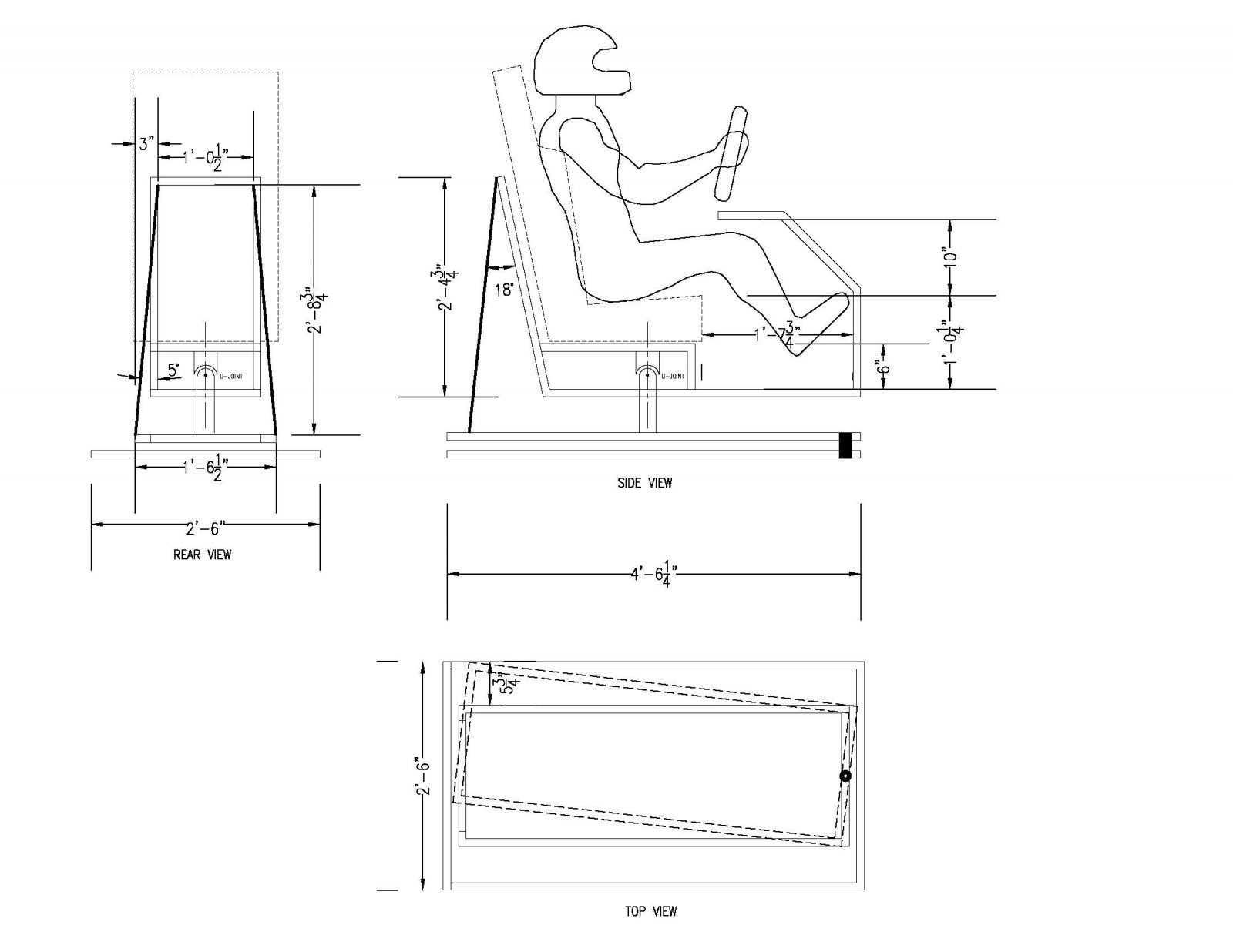

    Since I probably won't be building another one any time soon, decided to go with drift functionality. Please take a look at the attached drawing, comments are welcomed. Dashed line on the top view indicates upper frame position during drift.
  16. Nick Moxley
    17,057Coins
    +2,506 / 30 / -2
    Not that ive personally owned a CSR, But IMO the CSW is in a completely difference league as compared to the CSR.
