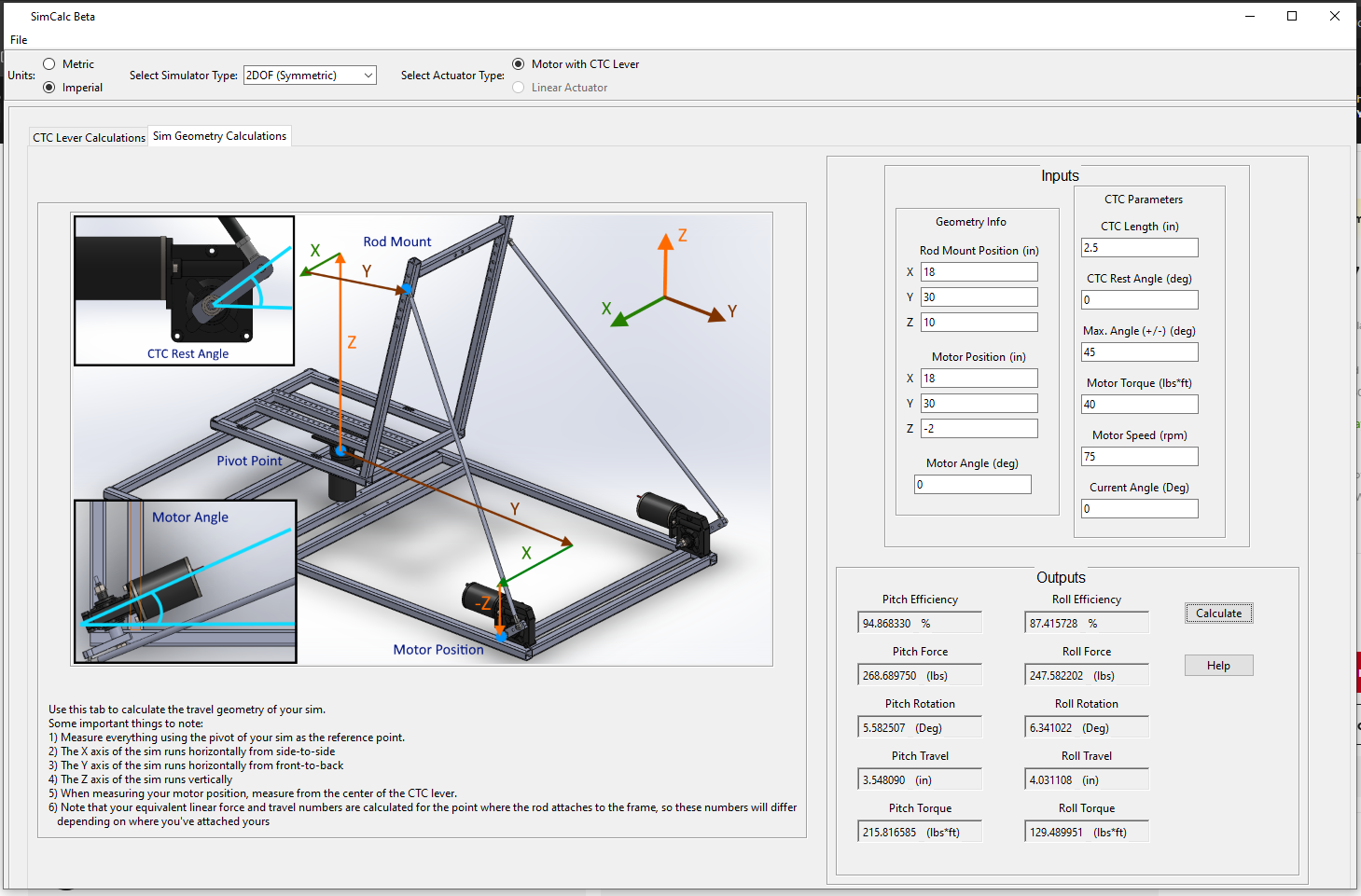

    So far my build is:
    These motors
    2 BTS7960 drivers
    Random Arduino mega I have lying around
    1 600 Watt power supply
    Random potentiometers I have lying around.
    Ujoint from an old drive shaft I have
    First question - Are those motors quick enough for a basic 2DOF?
    Second question - Any tips for a compact build? My general thought is a 2.5ftx3.5ft rectangle top and bottom. I have a welder but I'm in an apartment like area so grinders and such are a bit much.

    75rpm seems low but I'm not aming for a ton of movement.

    My motors are 36RPM and I don’t have any complaints. The lower RPM gives you more torque for the same power.

    Good to know the motors look like they'll work. Since I'm working in a compact space, more torque makes sense. Was a bit worried one power supply wouldn't be enough.

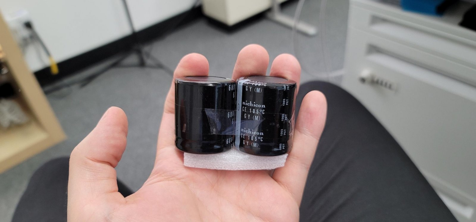

    I ordered the 100a driver that seems to be going around. Looks like people are having good luck with it. Also got a second PSU and 2 capacitors to try to keep it from dipping too hard. I like your idea of the LED to verify. The SMC tester thing doesn't seem to lose connection though but it's always nice to have a visual.

    Well I went down a chatGPT hole and it suggested these 63v capacitors. It says to wire them in parallel just before the driver for each power supply. But looking around, I don't see anyone else here that's done this. Is GPT hallucinating?
