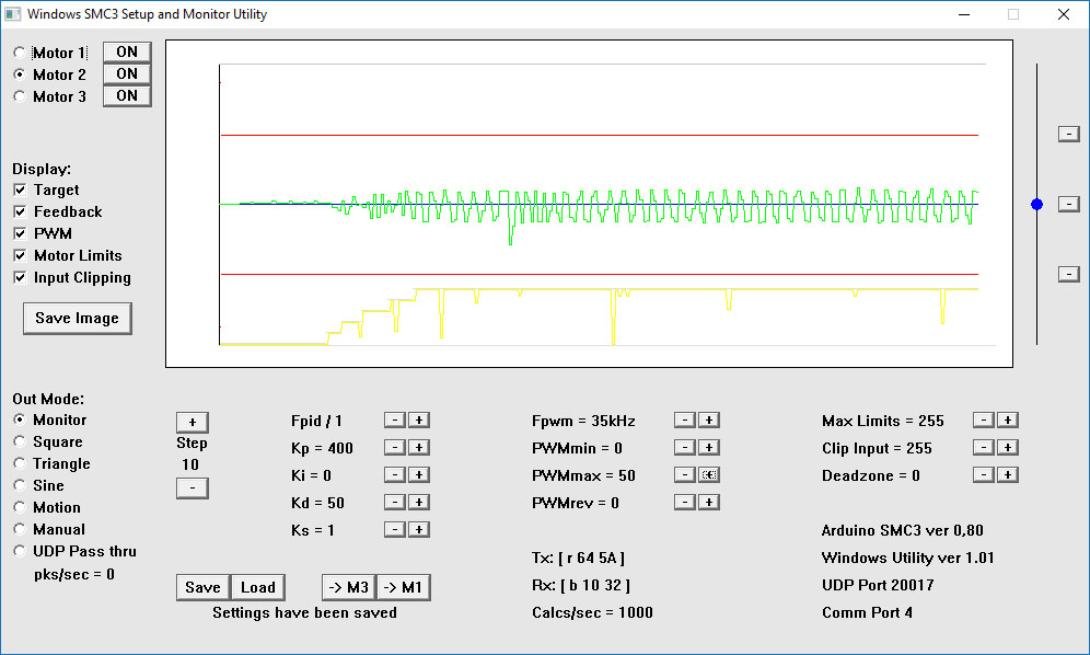

    Okay I'm back at testing both motors.
    Both "work" as far as hitting the feedback line as described in the tutorial.
    But Motor 2 behaves a bit funny as it is more like an wiggling in place instead of staying in position. See the pictures below:
    Maybe the potentiometer is causing this?
  7. BlazinH
    BlazinH Well-Known Member
    Oct 19, 2013
    2,145
    Oklahoma City, USA
    16,665Coins
    +1,839 / 32 / -1
    Motor 2 kd is 50 and motor 1 kd is 0. :confused:

    Yes I tried changing any additional values to see if it will do anything.

    Did you try increasing the dead zone for motor 2?

    Yes but at first it did nothing.
    After lowering the PWMmax from 50 to 30 a dead zone of 5 stops the wiggling.
    Is this acceptable?
  12. BlazinH
    Oct 19, 2013
    2,145
    Oklahoma City, USA
    16,665Coins
    +1,839 / 32 / -1
    No its not. It appears to be overshooting. If your not doing so do your testing on a weighted rig.

    perhaps your pot is slipping on the coupler - shaft - pot mount.

    Changing the potentiometer did the trick. (turned the deadzone back to zero)
