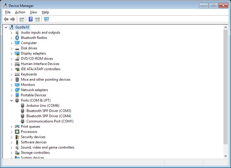

    I'm trying to get my 2dof working but already one of the first steps leaves me puzzled.
    I try to upload the SMC3-SPS sketch to my arduino r3 but I'm not quite sure it is recognized correctly.
    In my Device Manger there shows up no Arduino Uno COM Port. o_O
    The Arduino is connected via USB.
    Troubleshooting on the official website hasn't done anything for me yet.
    Hope anybody of you can help me out here. :confused:

    Is the Arduino Uno set as the intended device in the Arduino IDE?
  3. FoxHound.92
    FoxHound.92 2DOF seat mover Gold Contributor
    Jan 11, 2018
    69
    38Coins
    +30 / 0 / -0
    Yes, at least as far as I know.
    In the Device manager it seems to be recognized only as "com1".
    I checked this by connecting/disconnecting the R3 and using the "search for changed hardware" button.
    The Arduino's power led is green together with a yellow led blinking regularly.

    Okay, after spending several hours googleing for a solution I suppose my board is corrupt. I ordered a new one. :think

    Dumb question but you were looking under the Ports tab in Device Manager I presume.
    Have you tried un-installing the drivers and re doing the install.
    BTW there are genuine and fake Arduino Uno R3's and they use different drivers.
    I am also having issues with my Arduino (genuine) and my Sabertooth 2X25 v2 and like you I have ordered a cheap copy of Fleabay to experiment with and see if it fixes my problems.
    Good luck with you problems :thumbs

    Hi, thank you for your suggestions.
    No, I tried a "repair"-install but nothing had changed then either.
    I have another Arduino Micro for my handbrake which has been working flawless since 1 and a half years.
    Yesterday the replacement Arduino arrived. Fingers crossed I can make it all work tonight!
    Be sure, first thing I'll do is a driver reinstall if I encounter these troubles again. :grin

    So did the new Arduino make any difference ?
  11. FoxHound.92
    Jan 11, 2018
    69
    38Coins
    +30 / 0 / -0
    Yes, plug and play like it should be!

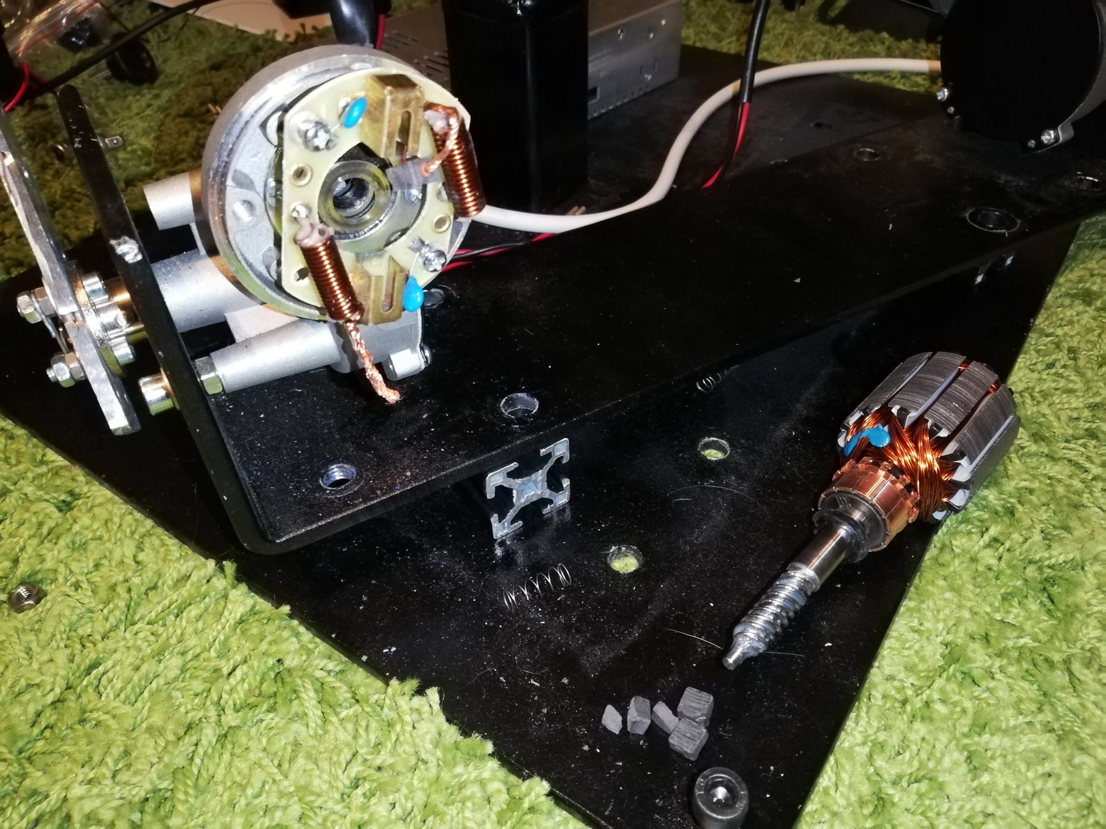

    Update: I went one step back and tested both motors directly with the psu.
    One is moving just fine but the other one only once moved about an inch and never again.
    Does that mean this one is now dead? :eek:

  16. noorbeast
    20,538
    145,046Coins
    +10,776 / 52 / -2
    That sounds like a motor has an issue, perhaps burned brushes, but you won't know for sure until you pull it apart and check inside.

    I pulled it apart as my last action for yesterday and some pieces came flying at me:
    These grey pieces are supposed to be on the wires and inside these golden guidings.
    Can I somehow fix this as a noob or should I replace this motor?
  19. noorbeast
    20,538
    145,046Coins
    +10,776 / 52 / -2
    The brushes are damaged.
    What model of motor is it? You can often buy replacement brushes.

    Honestly I have no idea. Got them from ebay. I ordered another motor as they are fairly cheap with 30€ per motor.
    But I found the correct the replacement brushes on the sellers site as well.
    Thanks for pointing that out. ;)
