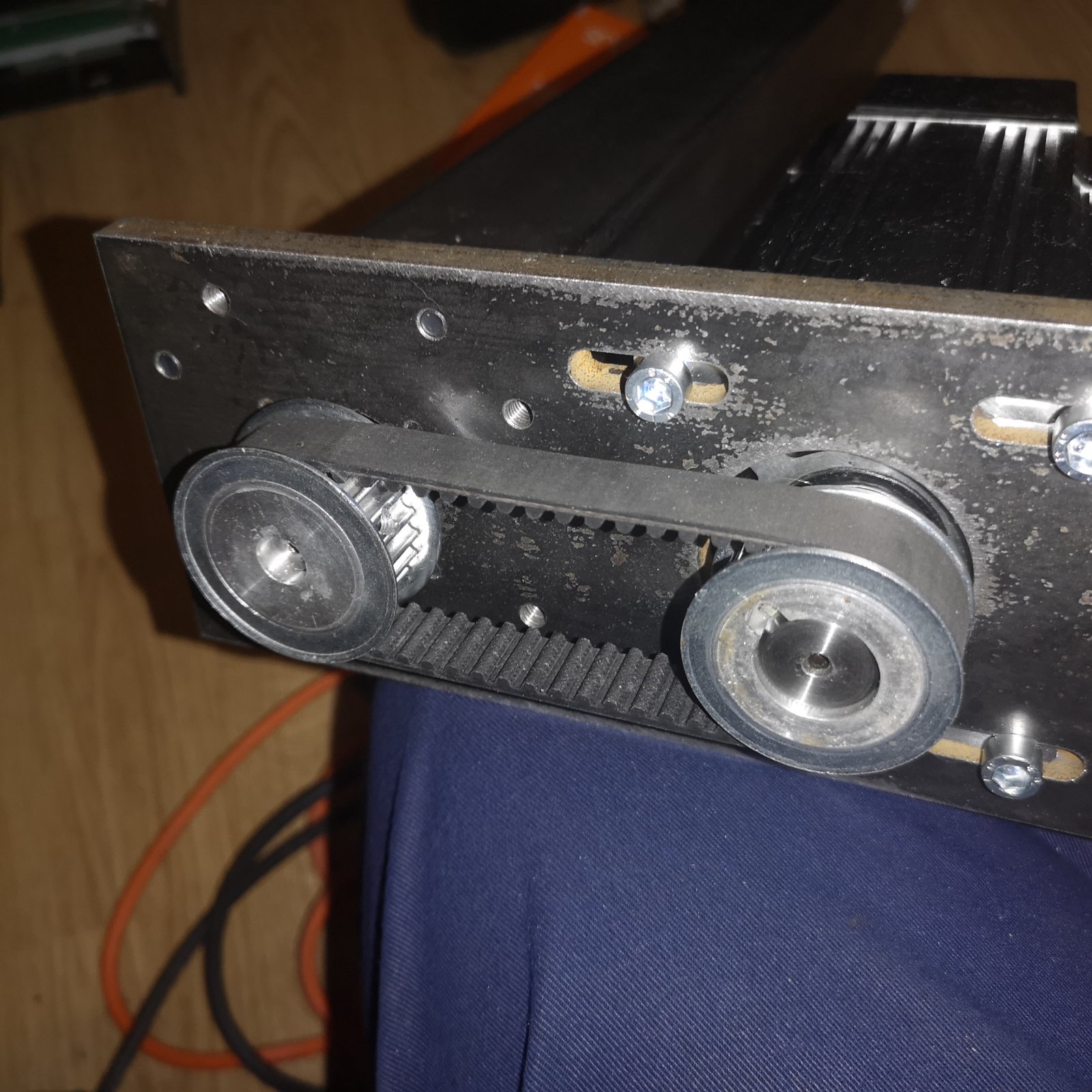

    2DOF, AC motor, Arduino, Motion platform, 6DOF
    The Chinese sent not good pulleys. I will try others. The microphone on the cellphone is very sensitive.

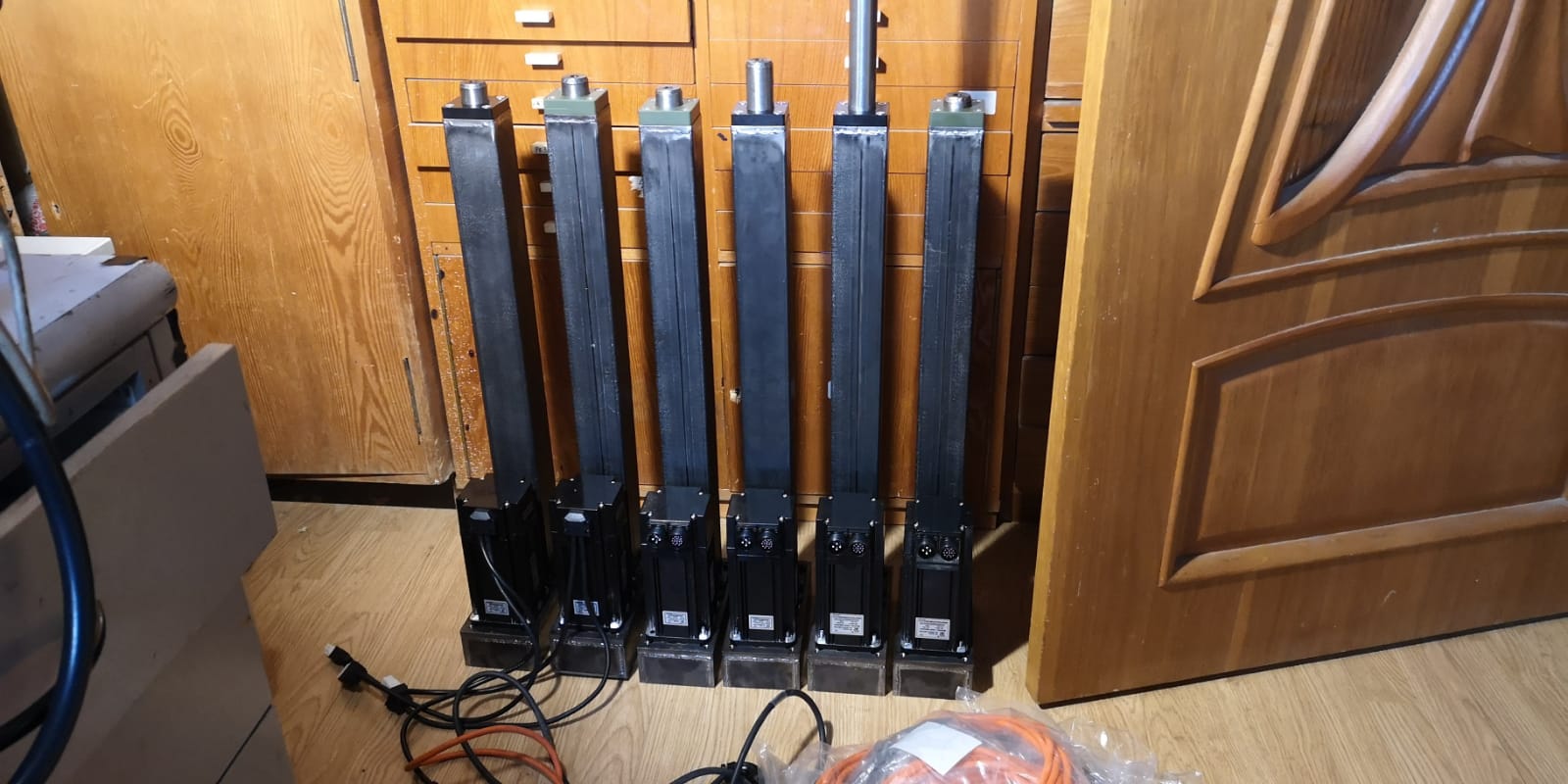

    Hello. I finished all the actuators. Now you can build the platform. I will describe the platform in a new topic.

    What type of servo motor did you use ?

    +1,072 / 10 / -0
    AASD-15A, but 80 flange I think...
    I used engines 80SY-M04025 4Nm encoder 5000 pulses per revolution.
    Hello .Cost approximately 1000 eur per 1 piece.

    2DOF, JRK, 4DOF
    hello Ivan. congratulations first of all for your project. I too am thinking of making an actuator similar to yours but with a stroke of 150mm. Also I would like to use 80ST-M02430 motors. I'd like to ask you a question. What type of toothed pulley do you suggest? HTD 3m, HTD 5m - GT, GT2?
