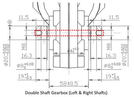

    21,592
    151,215Coins
    I am guessing MD may be short of stock at the moment, as they normally carry the 50:1 and 60:1 in stock.
    The 60:1 have a solid shaft with a keyway and this is how I attached the levers: https://www.xsimulator.net/community/faq/how-to-attach-levers-to-wormdrive-gearboxes.182/
    The 50:1s have a plain round solid shaft with an 8mm hole all the way through, so you can bolt a tube lever to it. I was a bit concerned about the strength with such a large existing bolt hole through the shaft so I had a custom machined tube made that is an interference fit, with a step down ridge to clear the gearbox housing and stepped up to provide more material and support for the securing bolt: https://www.xsimulator.net/communit...-are-people-mounting-levers.9109/#post-114528
    The 50:1s have a tapped bolt hole in the end but for the 60:1 I drilled and tapped an 8mm hole and used a cut off bolt and flexible coupling to mount the pots, the shafts are not hardened so you can drill them easily: https://www.xsimulator.net/communit...ountdown-to-2dof-build.6177/page-2#post-68381
    As they can't be back driven this is how you set up the pots: https://www.xsimulator.net/communit...-feedback-on-50-1-and-60-1-gearbox-motors.58/
    As is normal with wormdrive gearboxes it is normal to have a slight amount of free play: https://www.xsimulator.net/community/threads/setting-feedback-on-50-1-60-1-boxes.9116/#post-114703

    Just one more question about this gearbox, since it seems that I am not so good in reading technical drawings.
    Is the 8mm hole (see the red dotted line) going through the entire shaft?
