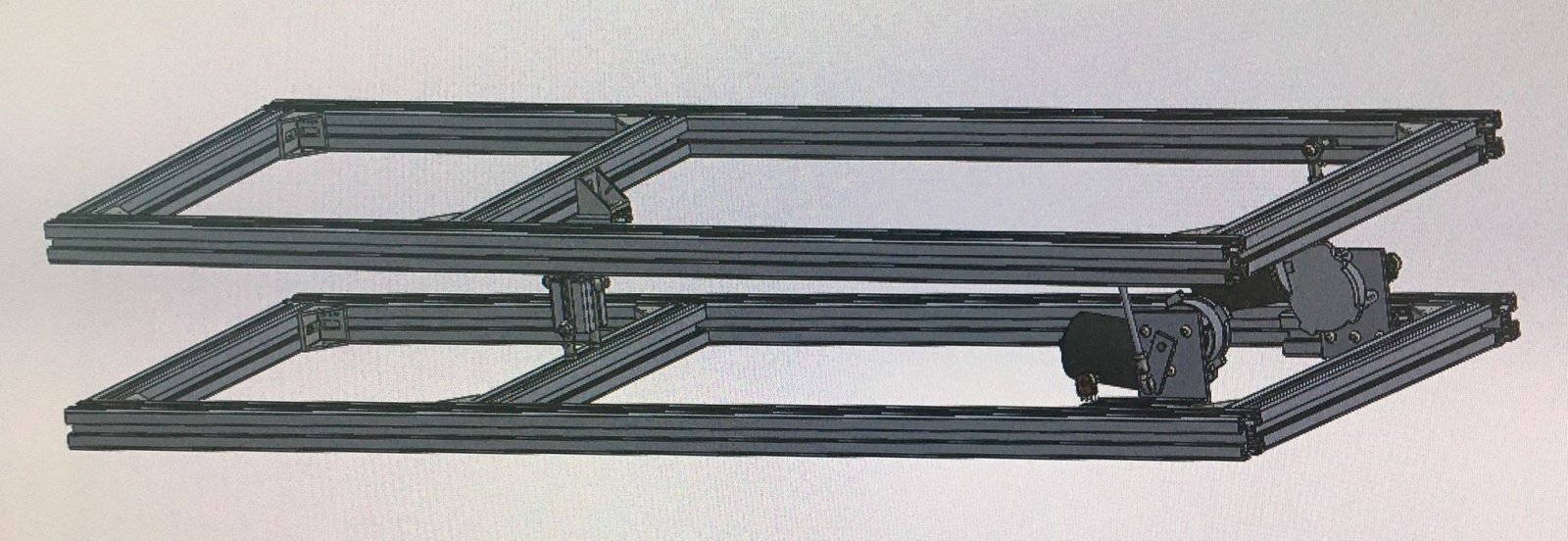

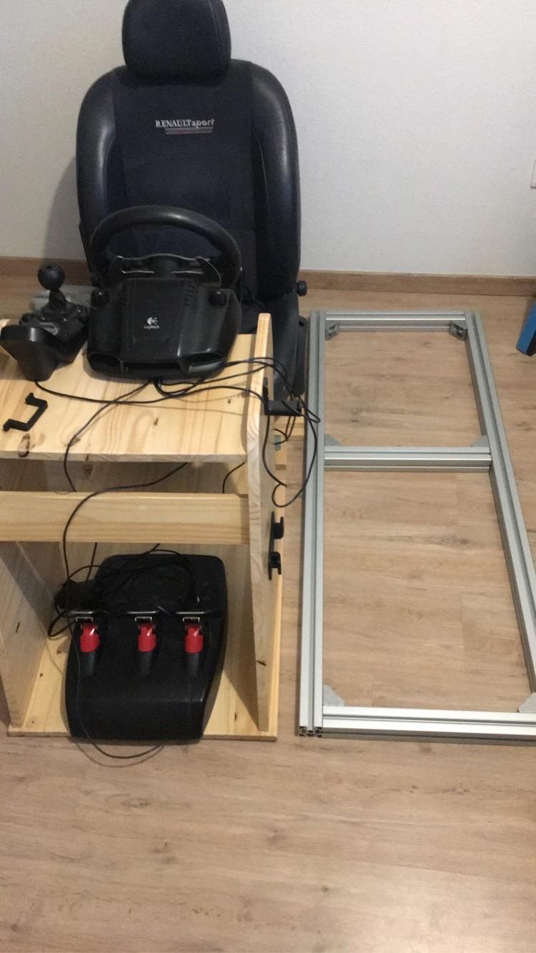

    I started my first 2DOF.

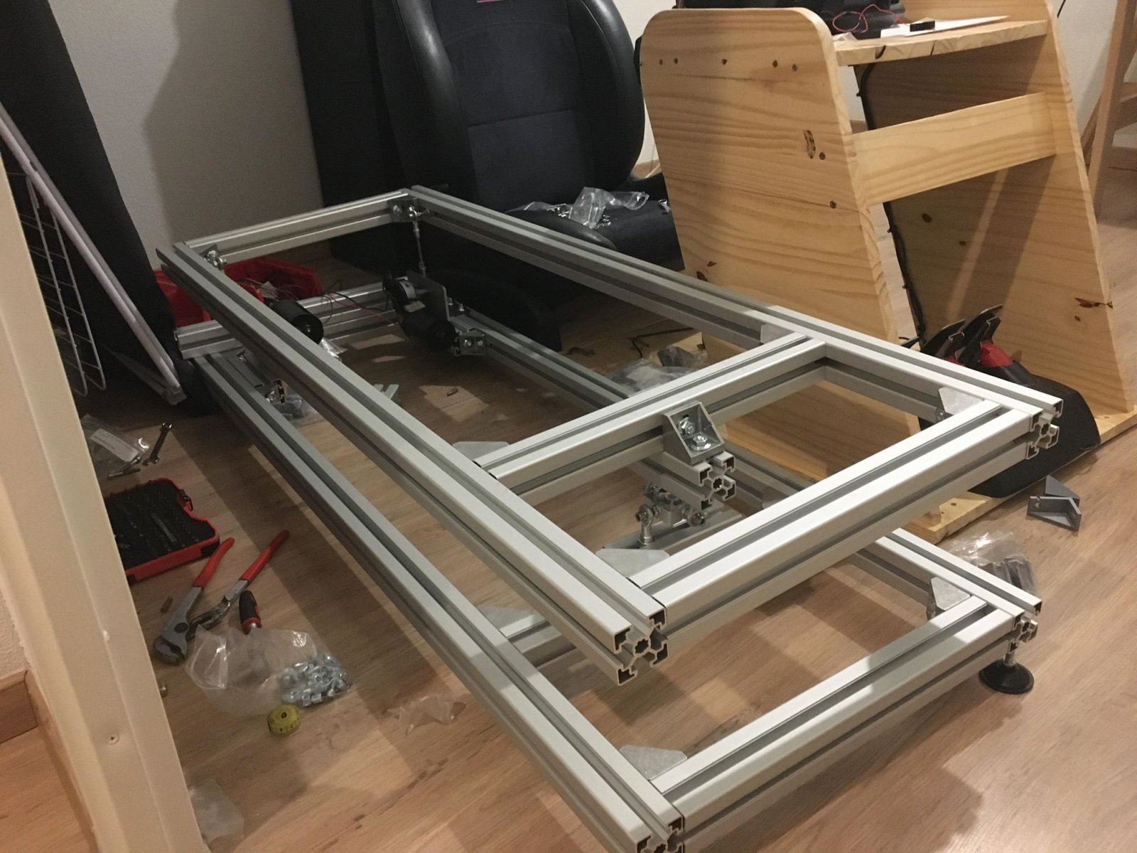

    I already had racing cockpit so i made a platform.

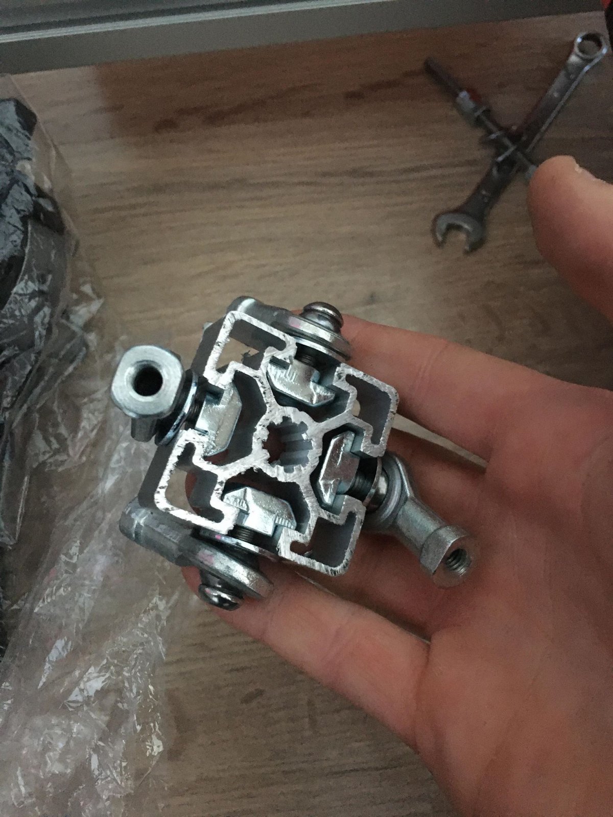

    I use two 12V wipermotor and design this: 81304031_2496328737245935_7361772385717977088_n.jpg 81353525_976424952739581_4964179426133671936_n.jpg

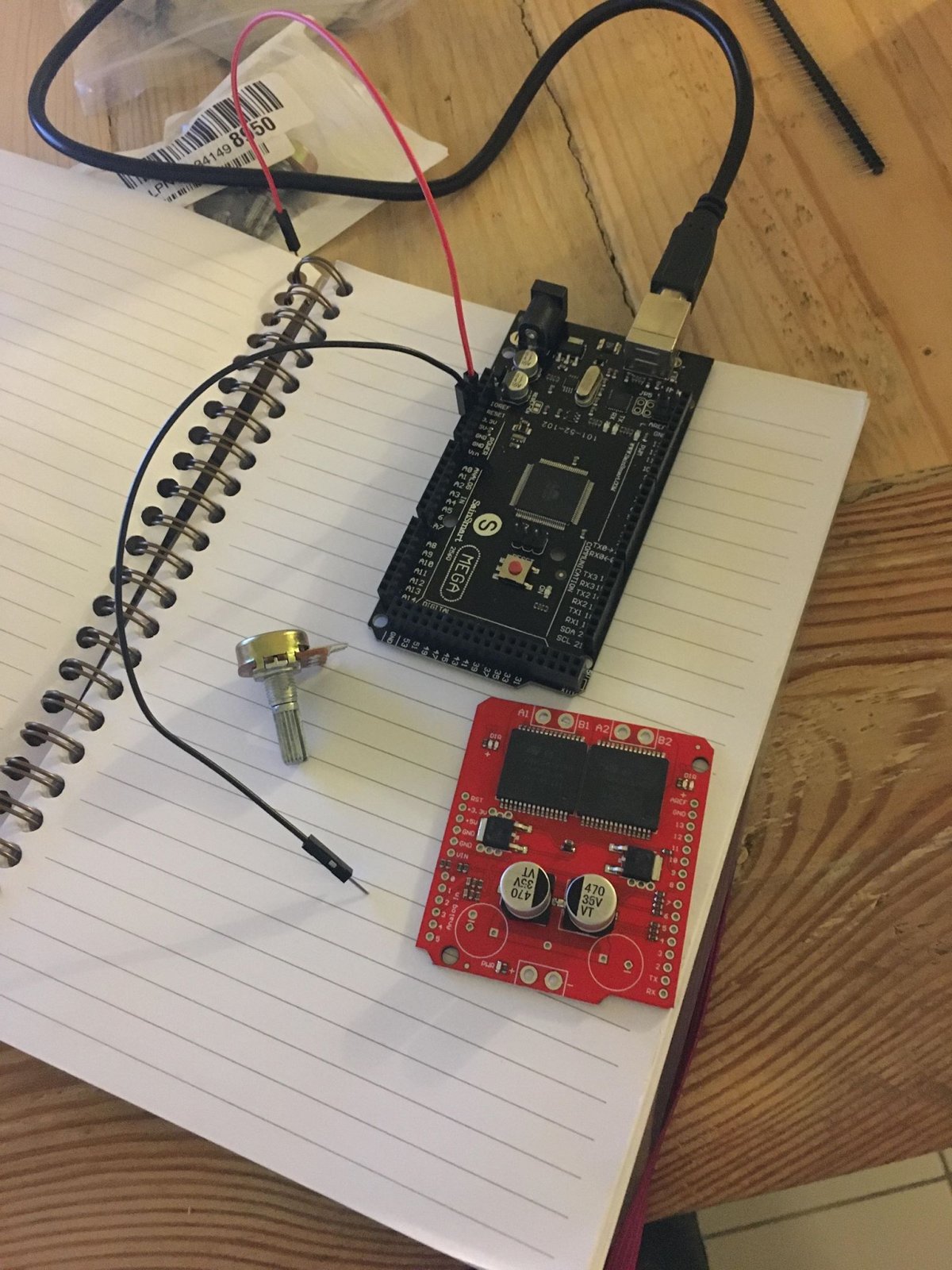

    To control, an old arduino MEGA and Monster Moto Shield 81789147_2394394660821772_6717209304824283136_n.jpg
    The next step: try to control 1 motor

    good job! Aluminium looks nice
    don't hesitate to reinforce your wiper brackets! any play (under stress) will decrease your precision

    Aluminium looks nice but it's a little bit expensive :( . (25€/m but without welding :D)
    Yes, i will put a bearing in front of each motor
    To reduce stress, they are near to the feets

    Yes.. But very polyvalent for future update like deported handbrake or whatever
    Je vais mettre une nervure aussi pour augmenter le moment quadratique.
    La partie mecanique je ne me fais pas de soucis, je fais une base simple que je vais amélioré.
    Je préféré valider l’électrique avant :D
  7. RacingMat
    2,237
    21,047Coins
    yes, you have to add inertia with sides added to the bracket
    c'est cela, il faut ajouter de l'inertie
    voir dans mon tuto le renfort latéral du support

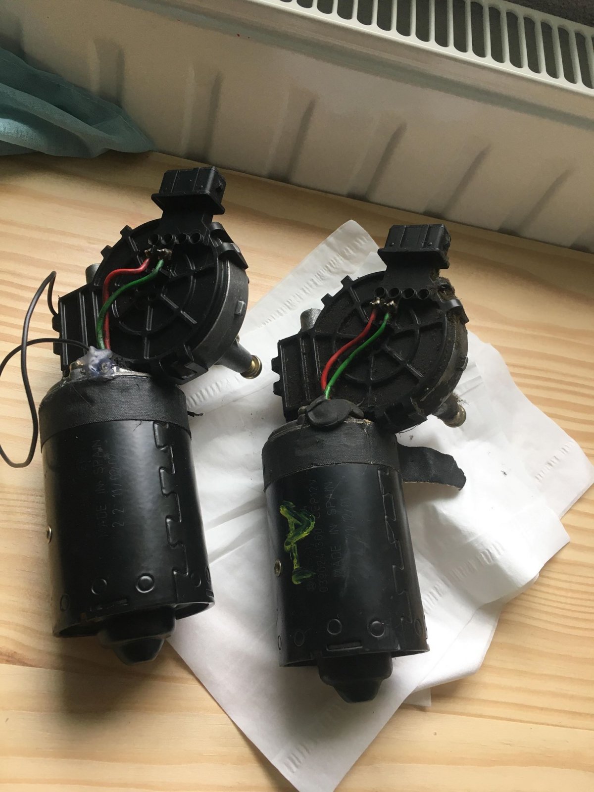

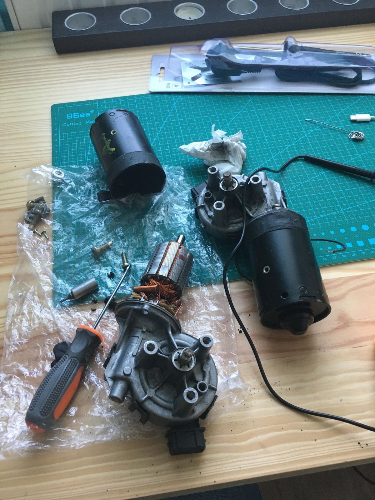

    Pour l'avancement:
    Je viens de récupérer mon deuxième moteur d'essuie glace.
    Je m'inspire beaucoup de ton tuto et ta chaine Youtube.
    Hier j'ai nettoyé, isolé et fait fonctionner le premier moteur.
    Il vaut mieux utiliser la petite ou grande vitesse ? De tout ce que j'ai lu, la grande vitesse est préconisée.
    Merci

    high speed is recommanded indeed.
    don't forget to isolate the ground!

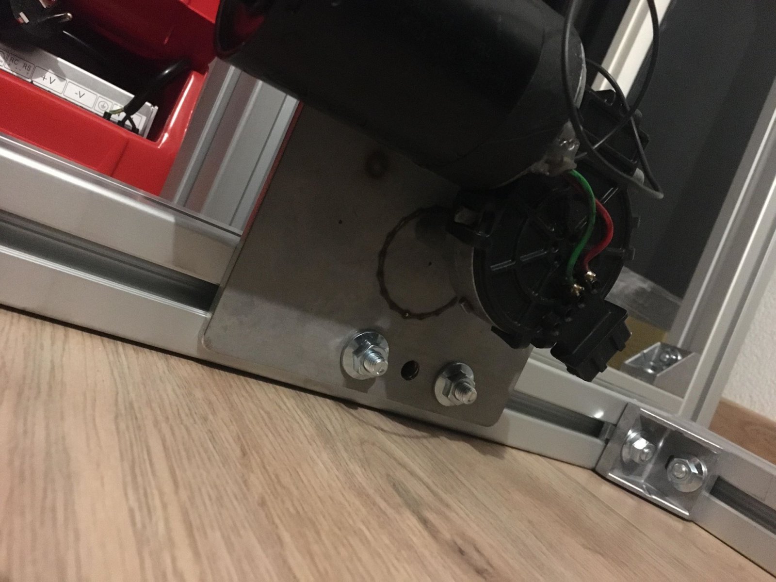

    Hi and happy new year!
    Some news:
    -I have now isolated the ground for the two motors.
    -The Home made joint is ok

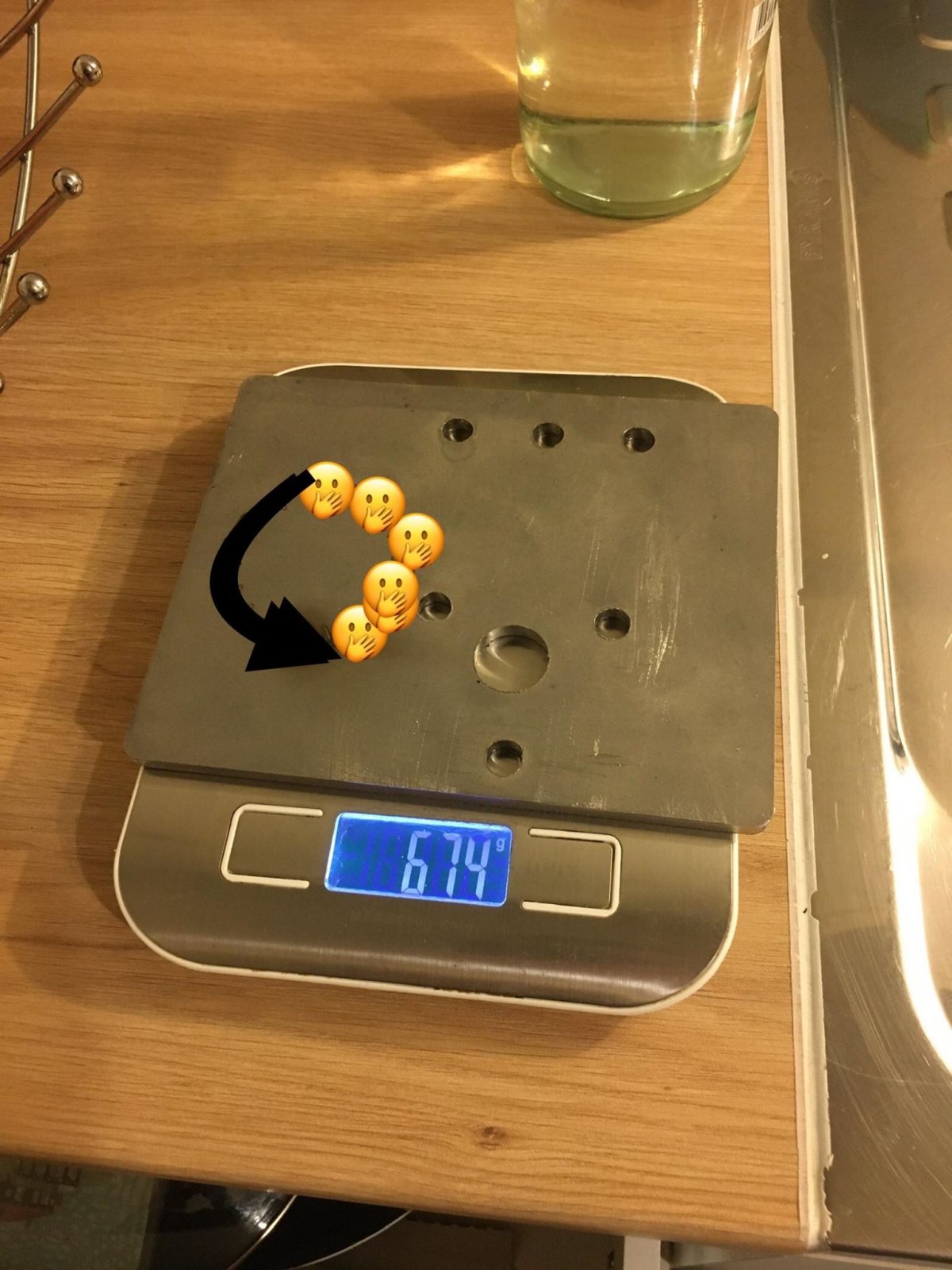

    -The motor support are ok (they will never move :D : 120*120*6mm of steel)
    -Munster moto shield and Arduino too.

    Motor are blocked for 180° max ?

    I am looking forward to your update test.
    Physics dictates that effective torque utilisation drops of rapidly with anything more the than about 40° up and down, so about 80° max movement

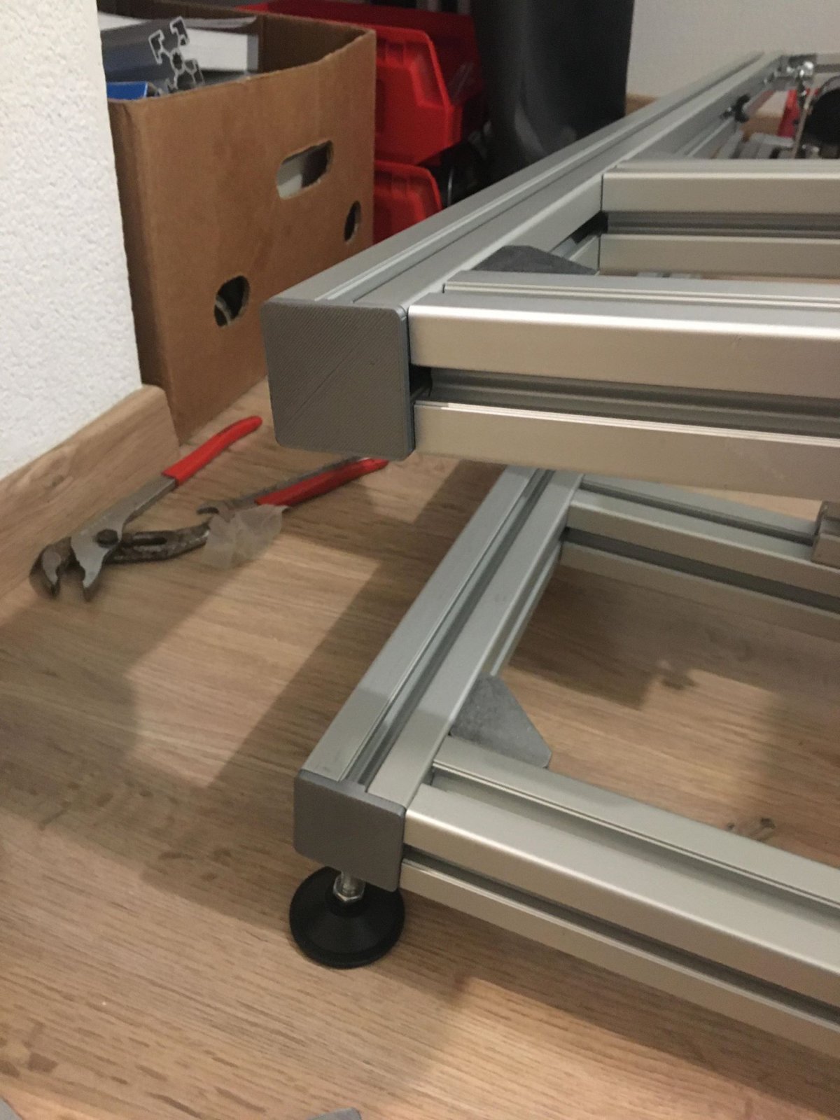

    Ok thanks! In few post i read the reason :)
    Now the mechanical part is pretty ok. I need just to improve my connecting rod.
    Some 3D printing for esthetics.
    82144981_1060019491002459_5757254401584529408_n.jpg 82343952_611179256117621_6563483208300625920_n.jpg
    Next step, Simtools.. :D

    some questions:
    -For limiting the rotation of motor it's in simtools with axis limiting ?
    -how to be more reactif ? If limiting rotation is use axis limiting, so i will deplace motor near to the joint.
    -My PC is almost dead... i will made one. how to use my simtools licence in the new pc ?
    What do you think about my 2DOF ? :D
