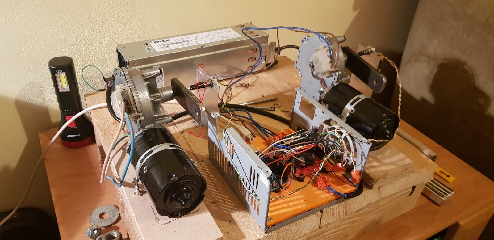

    My first project is based on the Racing Mat idea:
    - 2DOF
    - andruino
    - 24 V wiper motor
    - SMC3 software.
    I made a mini test platform. For a few weeks I was doing tests and everything works fine (SimTools, SMC3 Utility, LFS Game, etc).
    I am starting to build the frame.
    I have one question about the wiper motor:
    When everything is turned off and I press motor arm very strong, it turns.
    Is it normal ? Does every motor behave like this and does it depend on the force used ?

    yes, that's normal. depending on the gear ratio its easier or harder to move them

    A motor that moves when un-powered is called being 'back driven' and as @Skuldi points out depends on gear ratio and is not uncommon.
    As an aside the MM will need a heat sink and fan, otherwise you will damage it.
    It also pays to test clone MMs before use: as many have Quality Control faults: https://www.xsimulator.net/community/faq/monster-moto-testing-before-use.158/
    Wiper motors do need to be ground isolated: https://www.xsimulator.net/community/faq/wiper-motor-mandatory-ground-isolation.25/

    It depends on gear ratio or torque ?

    if the gear box is made with "worm and wheel gears" it's irreversible
    or as Skuldi said, if the gear ratio is very high
