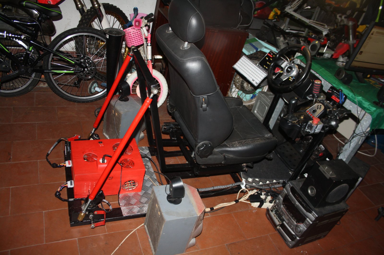

Showroom 2 Dof wiper motor 12v

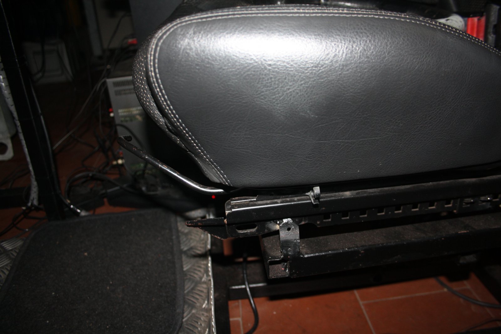

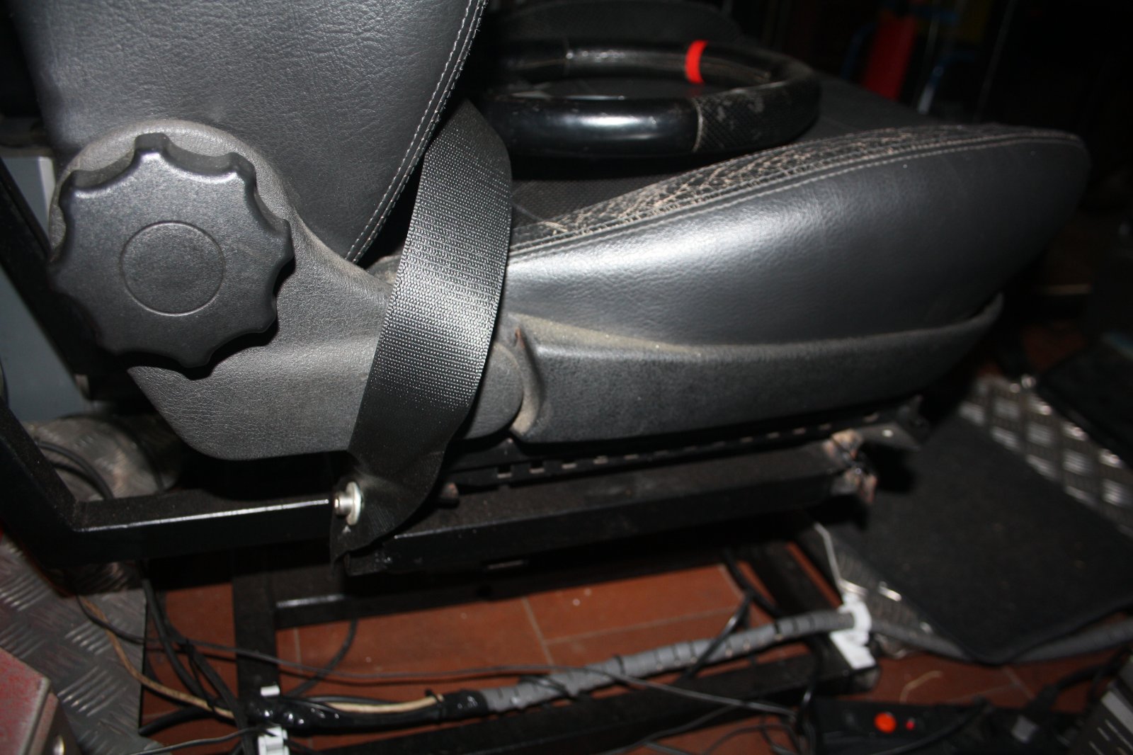

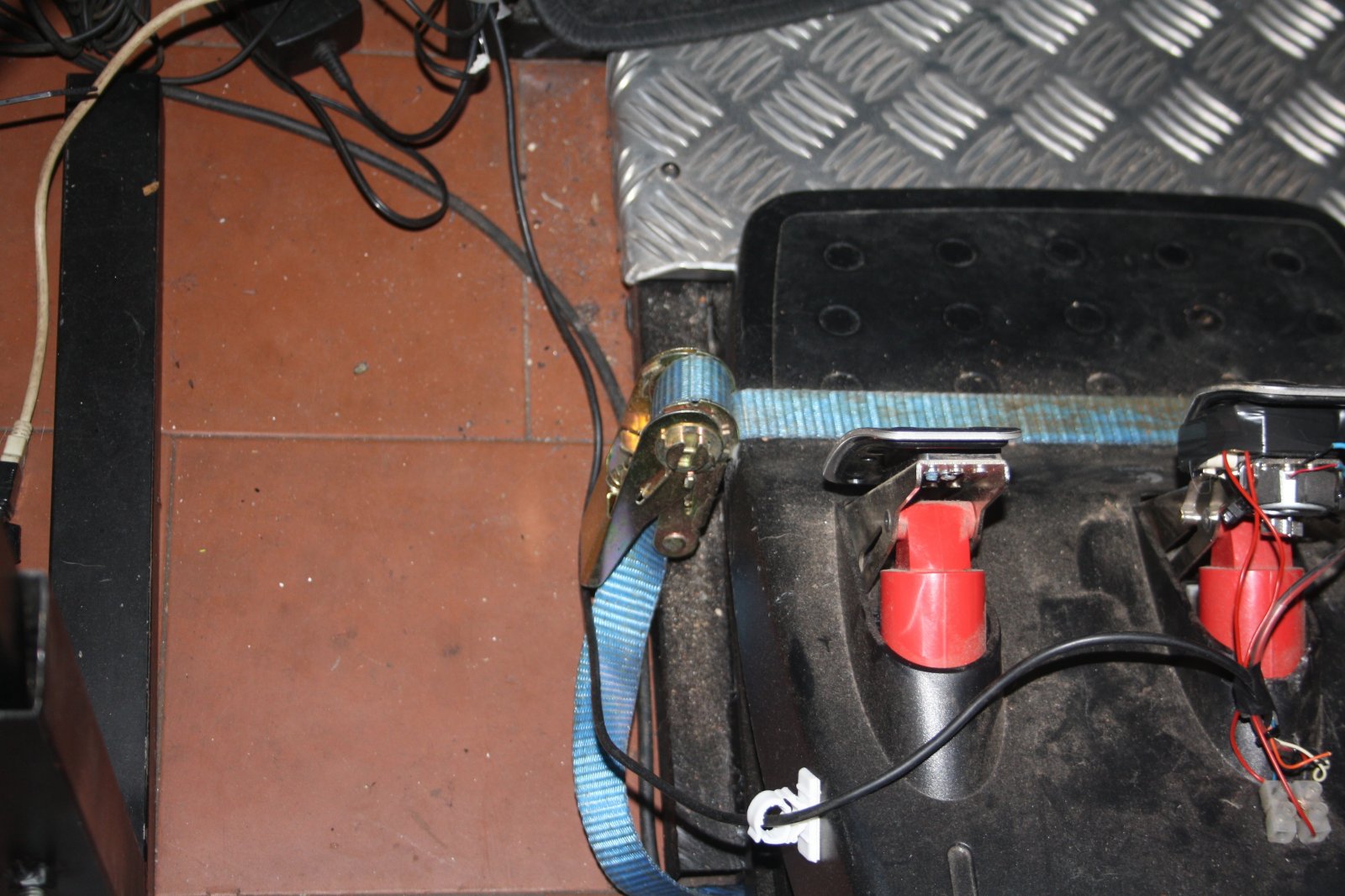

    I have always friends playng with me so i have weld a slider adjust on my 2 dof so everyone can play!!
  2. mariana fino
    mariana fino

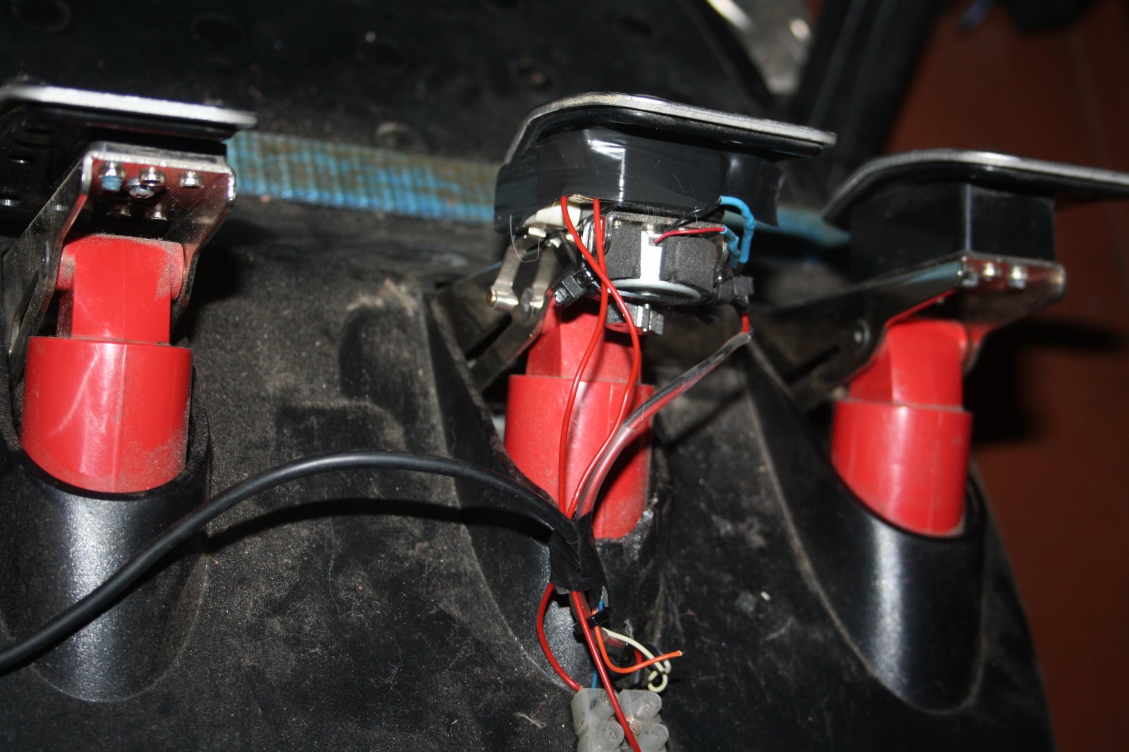

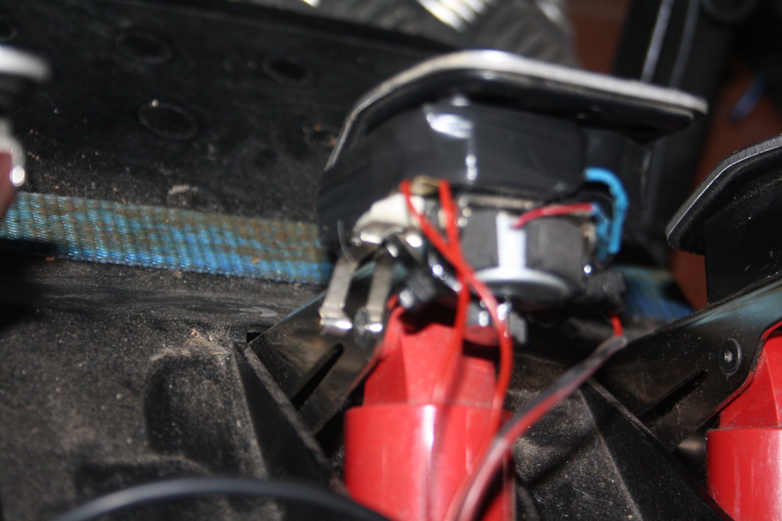

    i have made my brake pedal with vibration, put a motor from a old controller and i connected direct to a 12v power source ,its controled by a micro switch (mechanical adjust only no interface on the pc or other kind of board)so you can adjust at what time of braking you ill fill the vibe!hope you enjoy my cheap solution!!

    Wow great job, nice to see it working so good with wipermotors!!! Job well done:thumbs

    Moving the seat changes the COG and that is not a good idea.
    You could use the same sliders and make the pedals adjustable instead.
  8. mariana fino
    mariana fino
    Hi @noorbeast ,yes i can note that when i slide my seat and the center of gravity change the motors stay working (noise) when i am stopped ,its to correct the C.O.G.i think... so i already put the pedals adjustable,so i can respecte the C.O.G.!!!

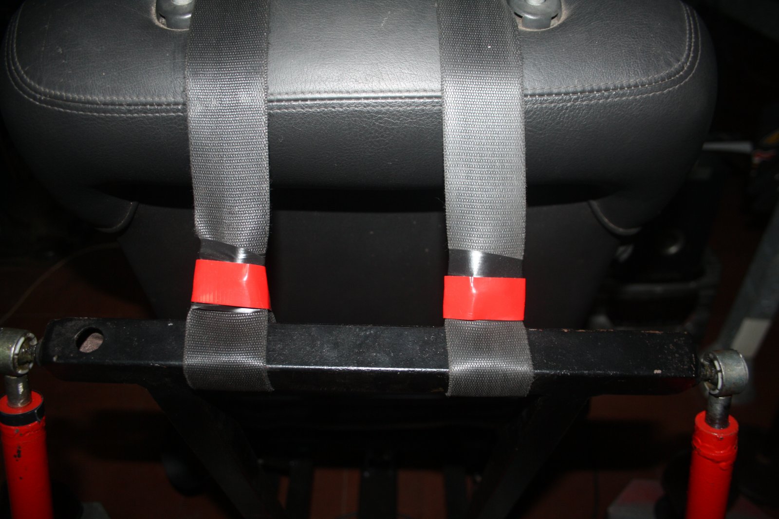

    Hey I really like your build, got a question. what did you use for the red extension rods from the motors to the seat?

    It looks like the back of your rig is wooden. did you have to isolation ground the motor with the fear of frying your power supply?

    I wondered that too. Probably don't have to considering there wouldn't be any continuity between the two motors.
