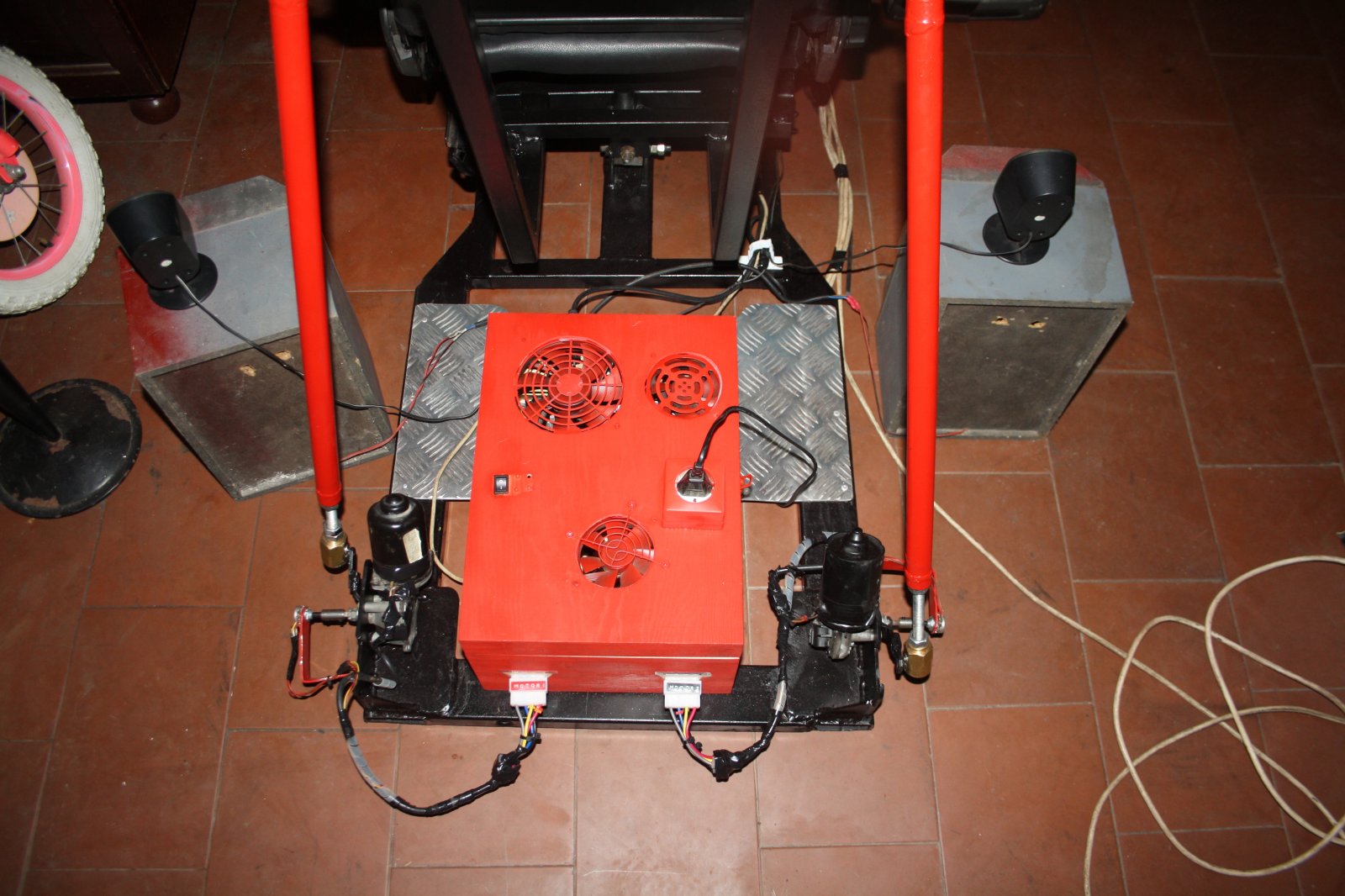

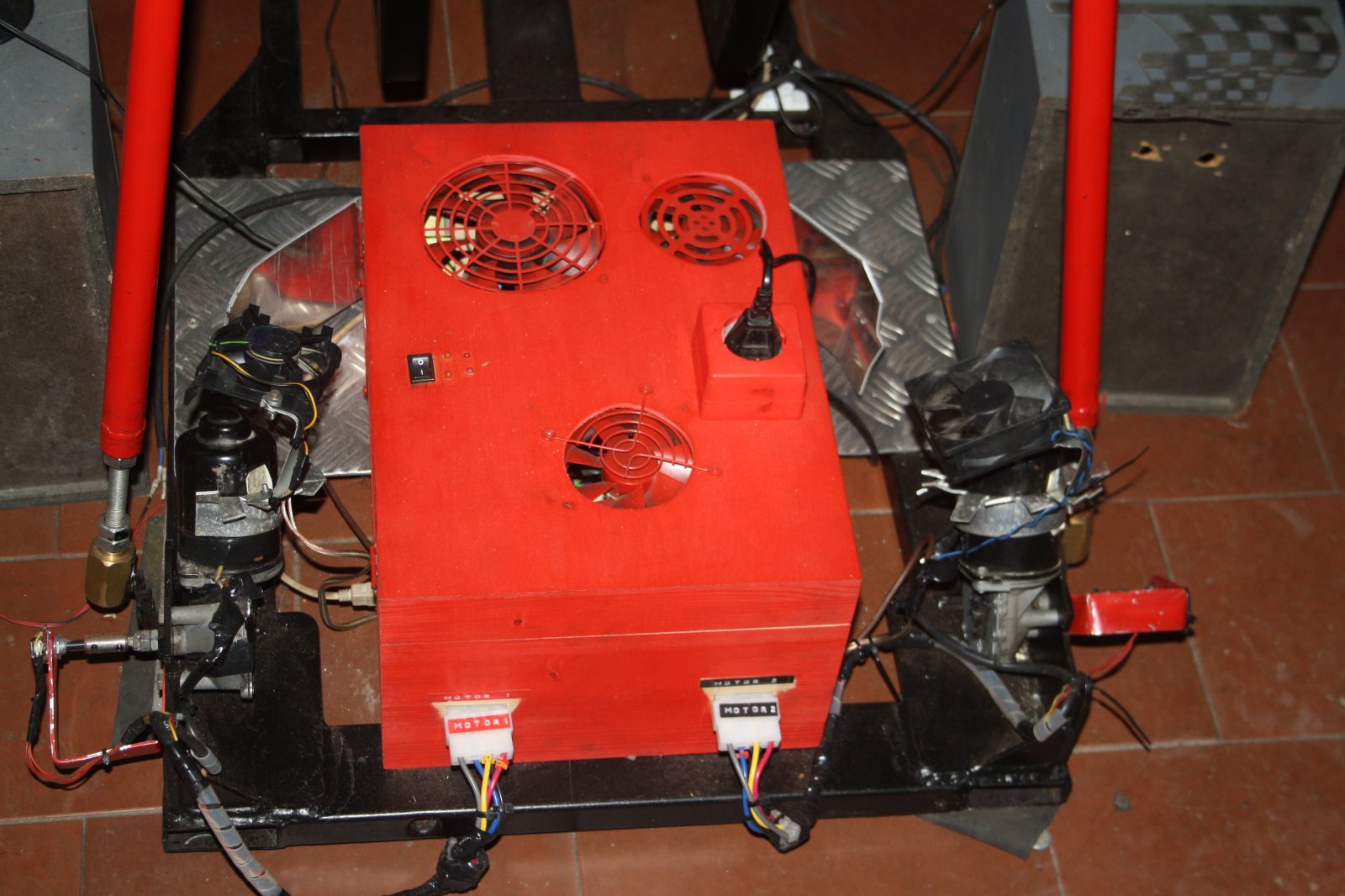

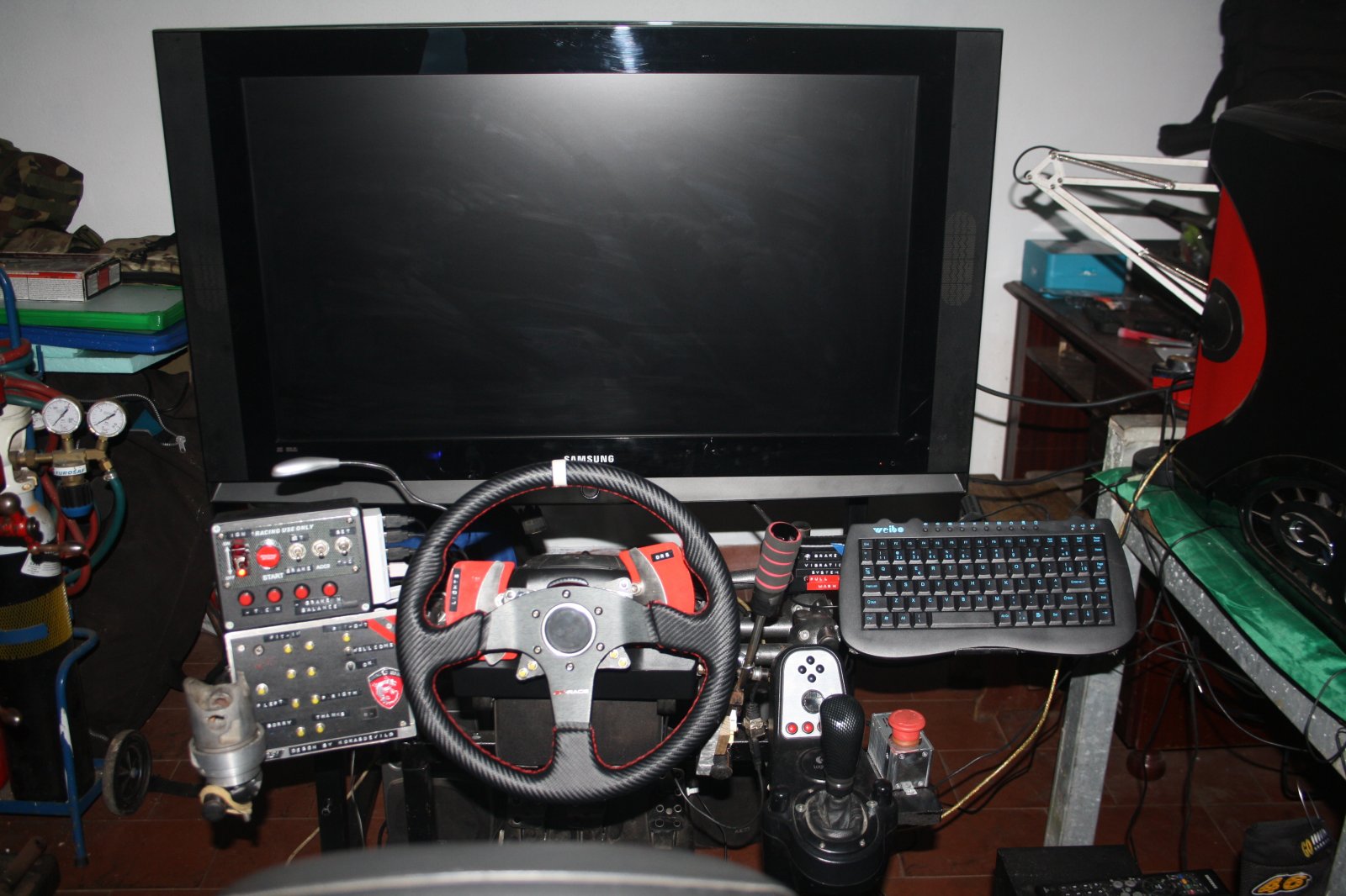

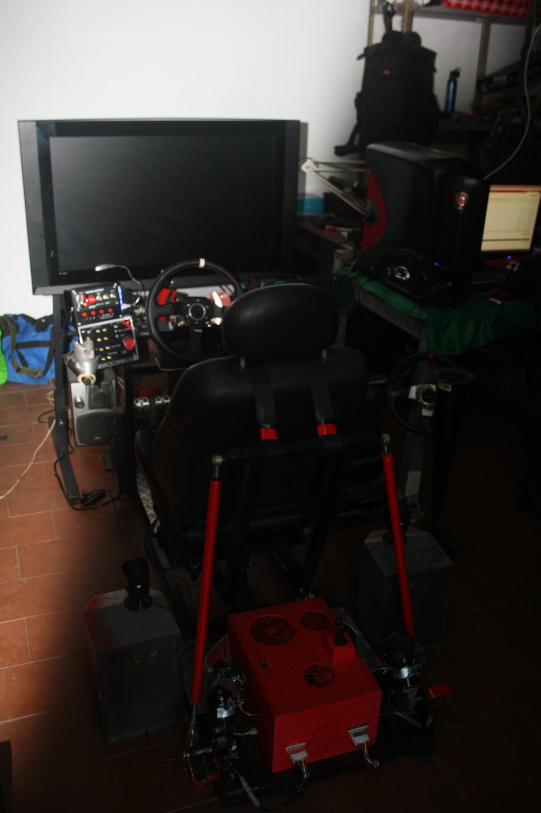

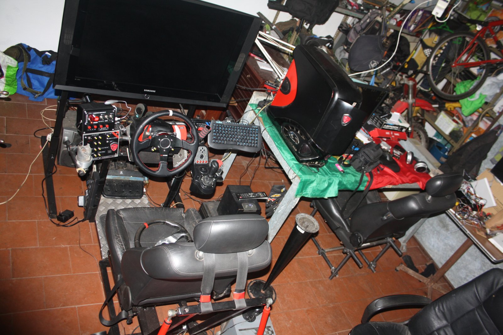

    [​IMG]Hi,everyone,this is my 2 dof cockpit ,i follow all the details in the fórum ,thanks to all ,its 100%funcional,this its a copy of racemat 2 dof seat!only its missing its dirt rally plugin...any questions i can help just ask for it!!!

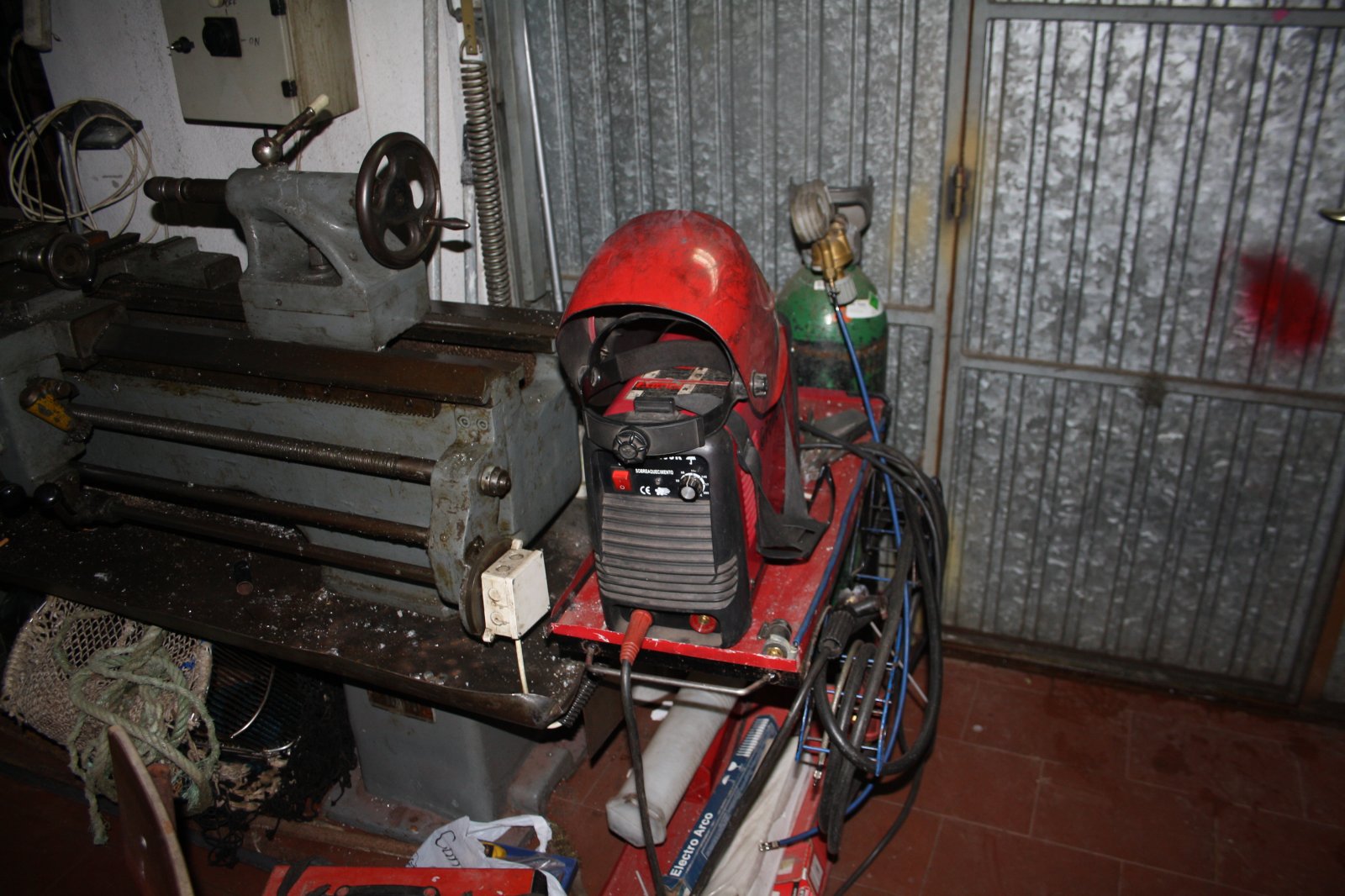

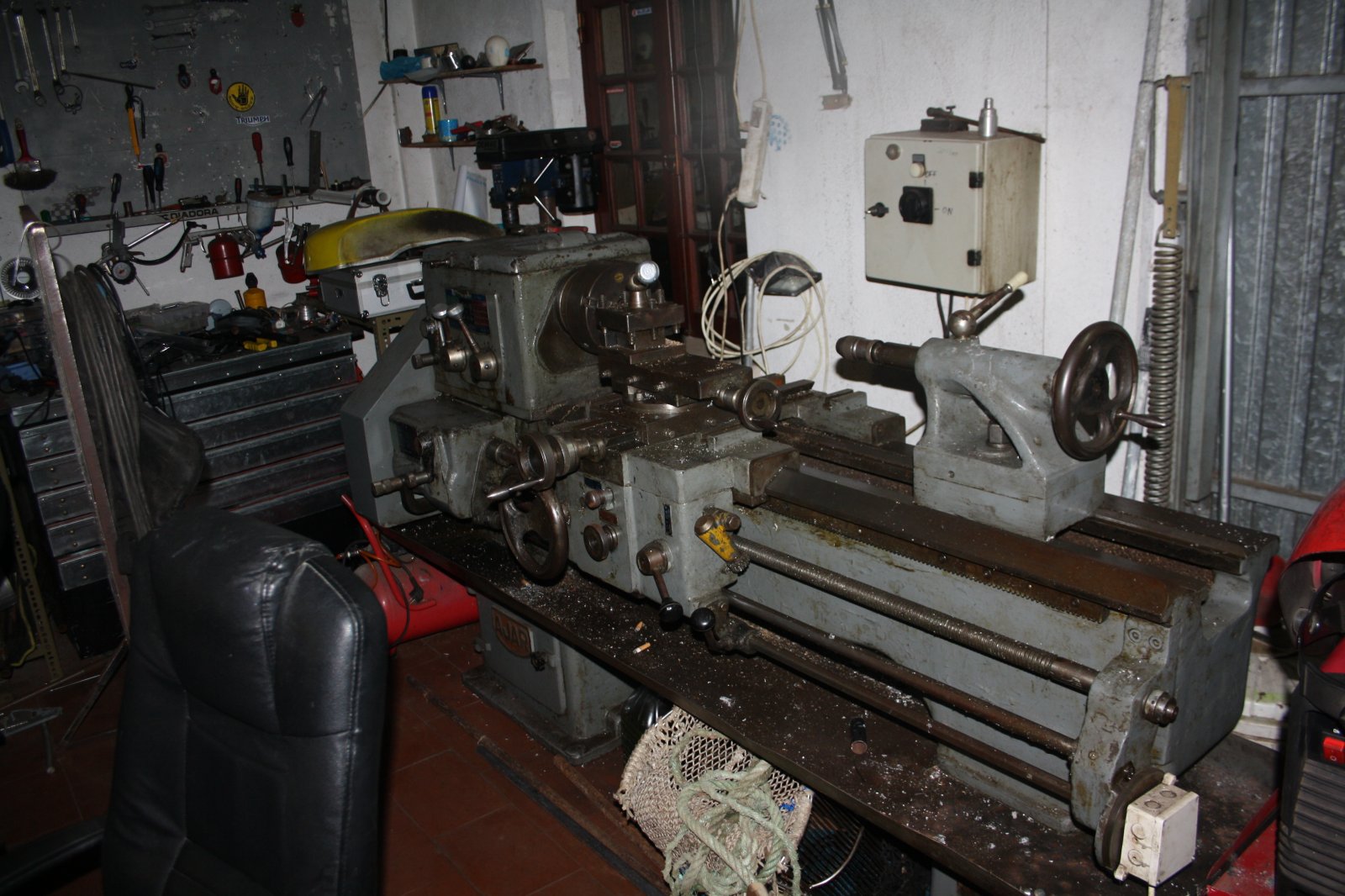

    Some details of my lab tools!!!

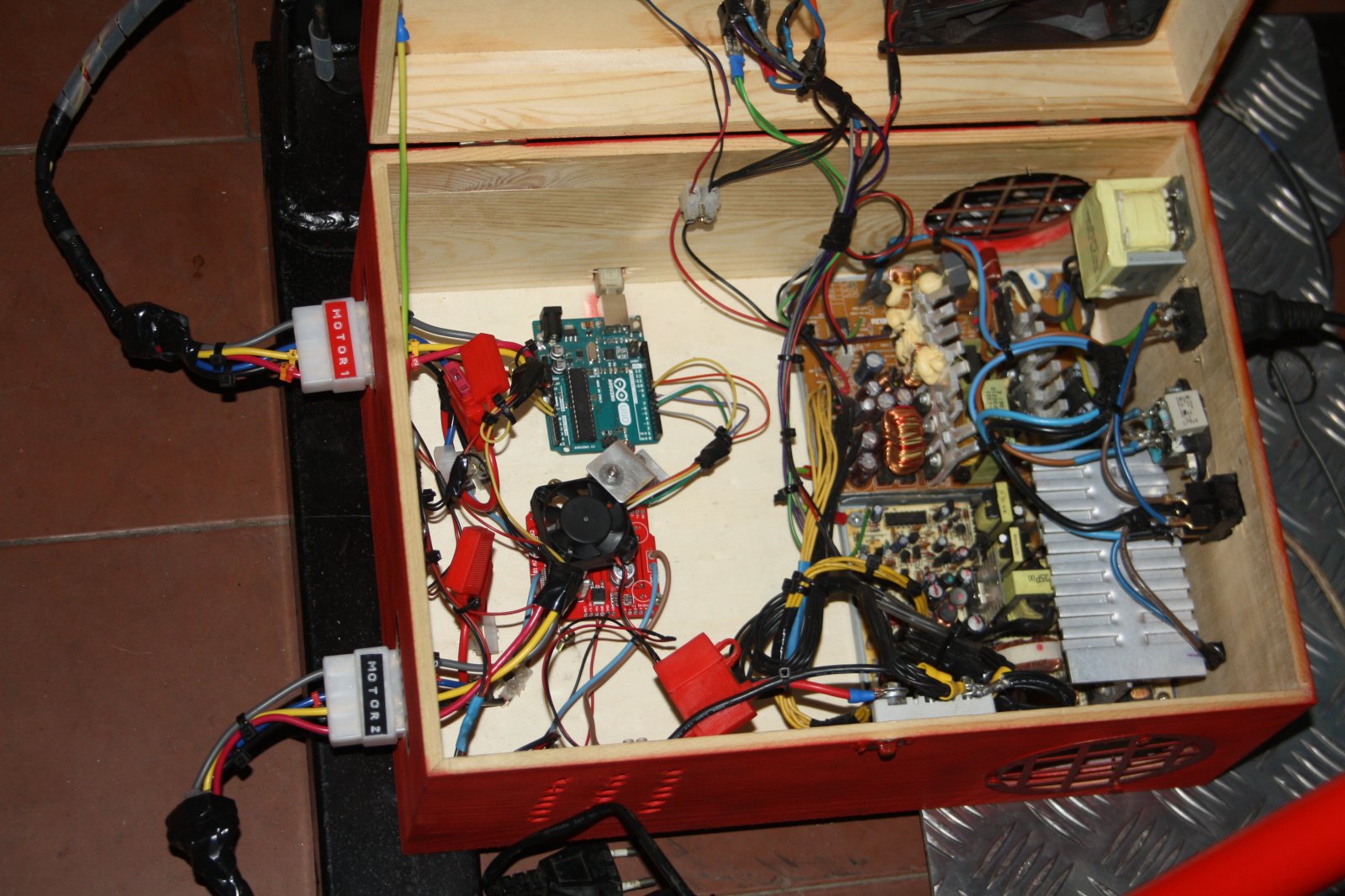

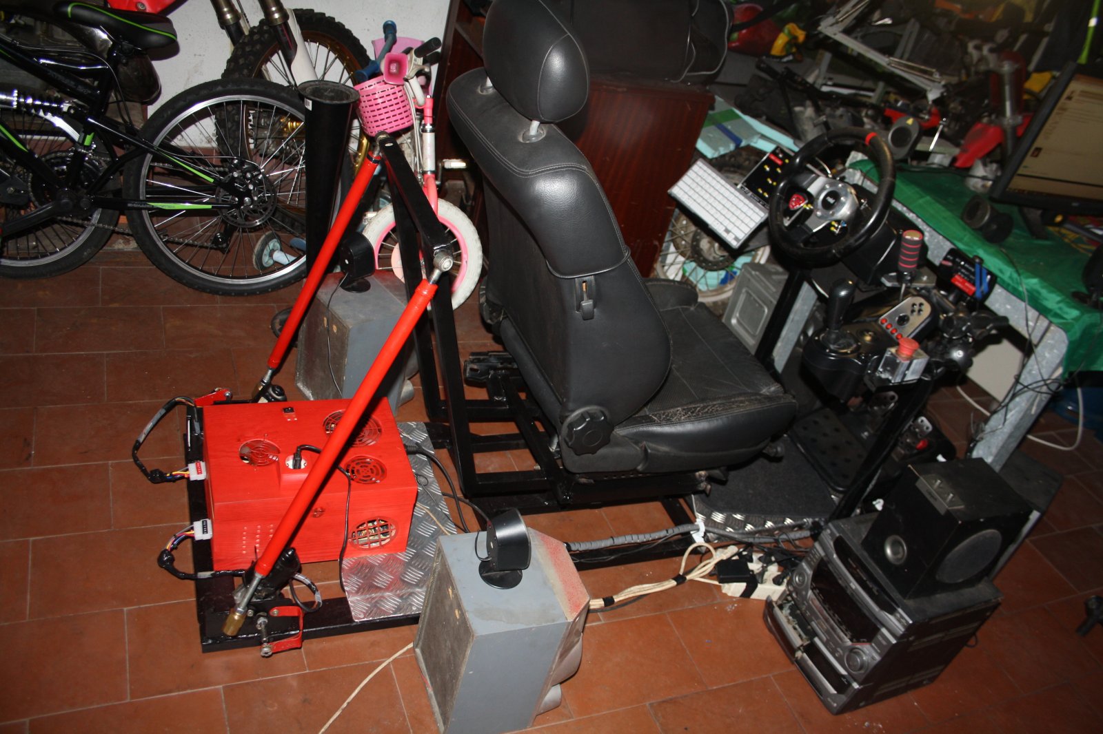

    A few details for power supply i have connected 2 atx with 400w so i can have 12v 40 amps,1 arduino uno r3,1 motomonster shield from china,and racemat code with a few adjusts for my motion sim and simtools the magical software ,this proget born from a small rc motion sim that is also in this fórum ,just test in dirt3 and no heat on motomonster or engines,i think i have the perfect balence point so the motors never enter in overload...vídeo coming soon...

    After a few games i chose to test another game (raceroom experience) and without touch on the code with this game my 2 dof became must more agressive and with faster and bigger moves,after 20 minutes i can feel the motors starting to heat a bit,the mm shield its cool ,i will post a vídeo soon...

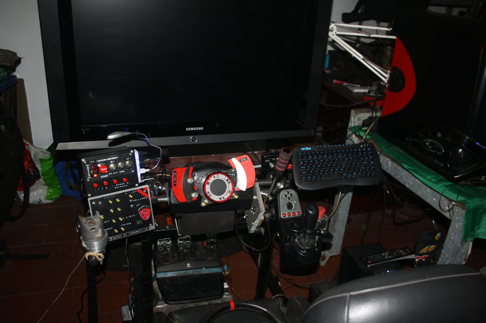

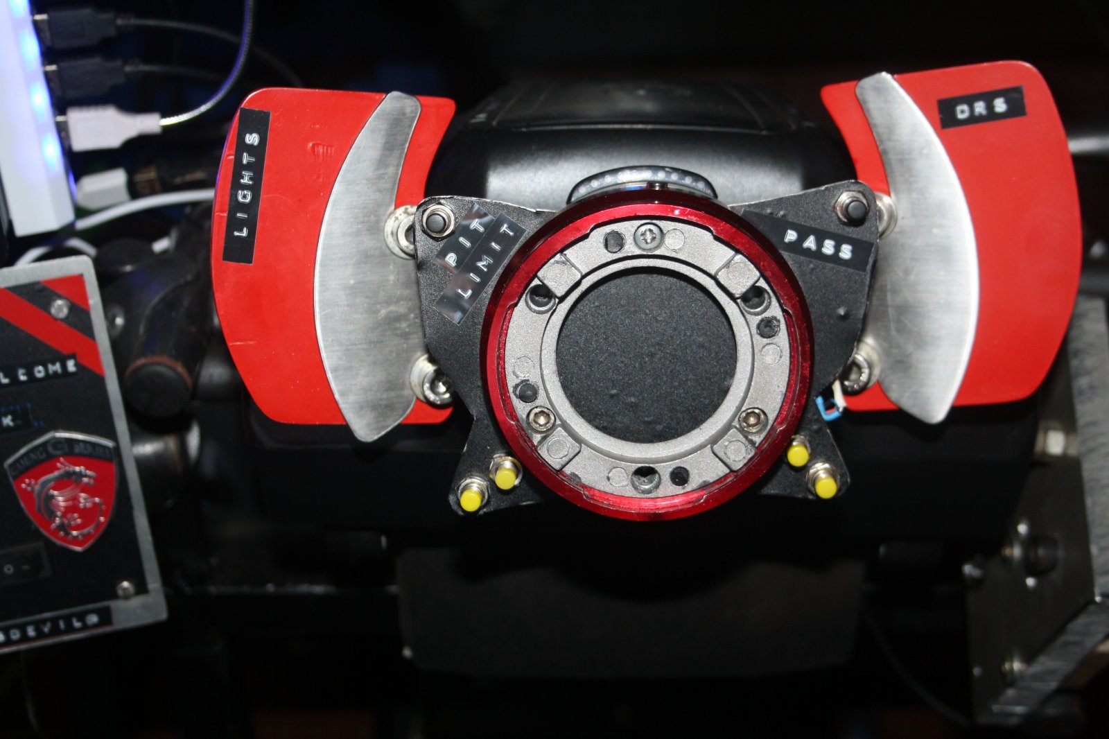

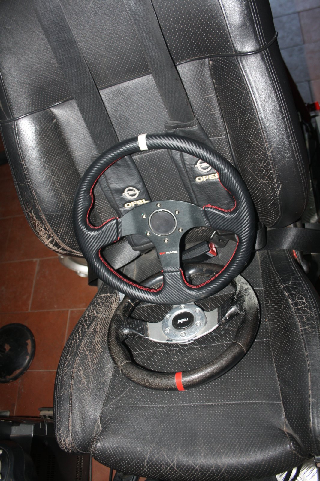

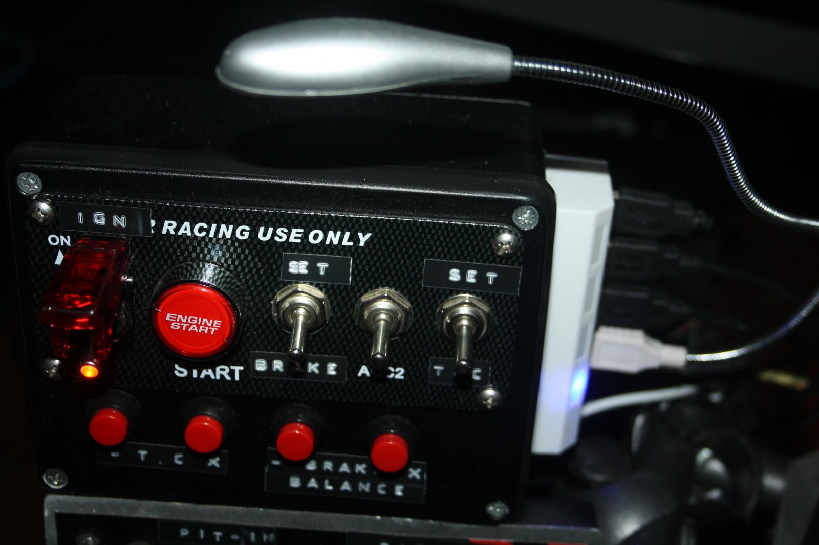

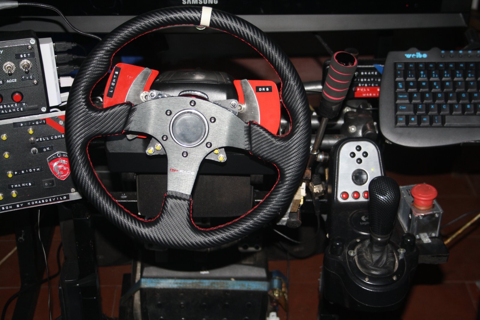

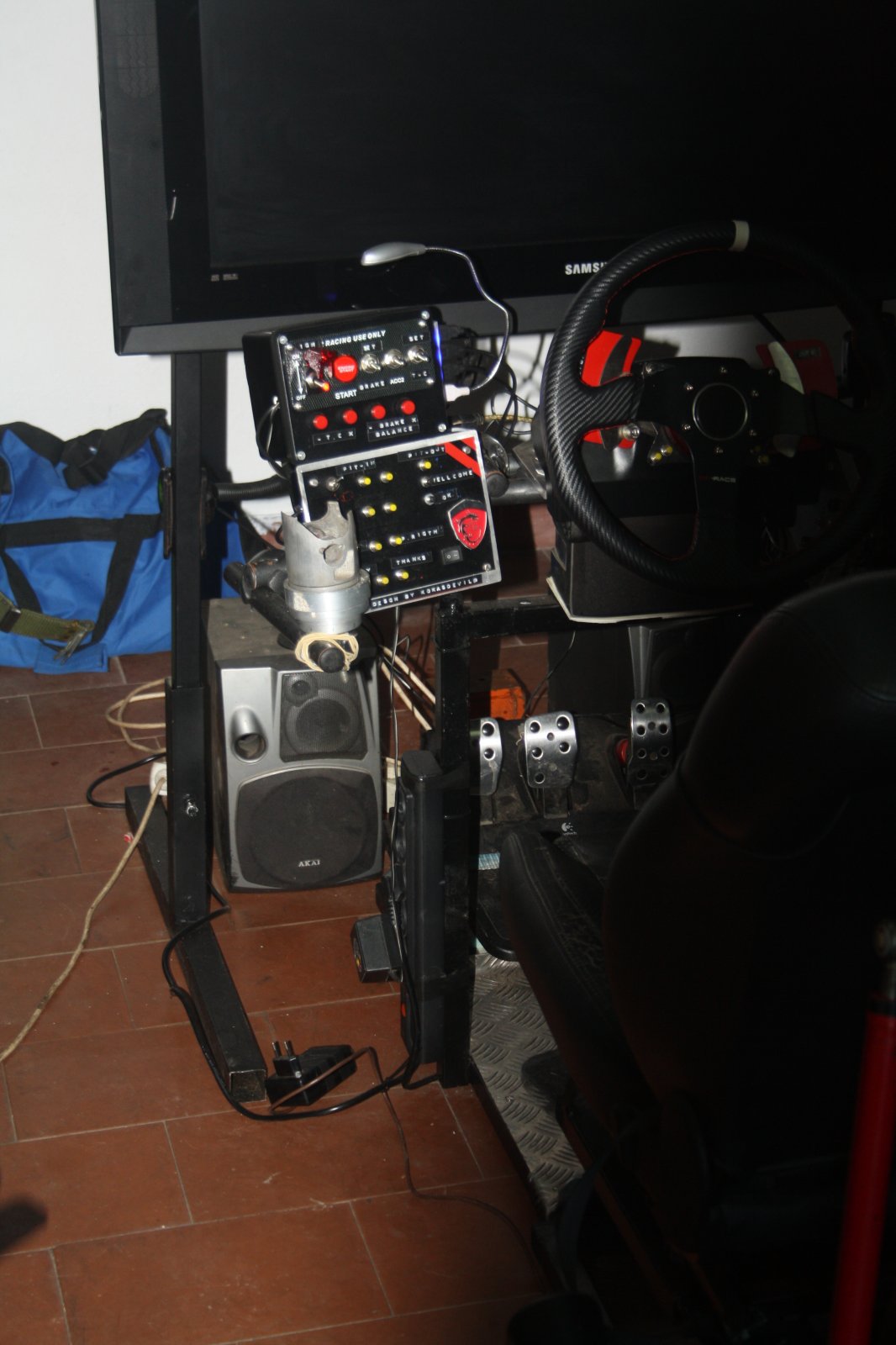

    HI all here it is some changes that i have made!

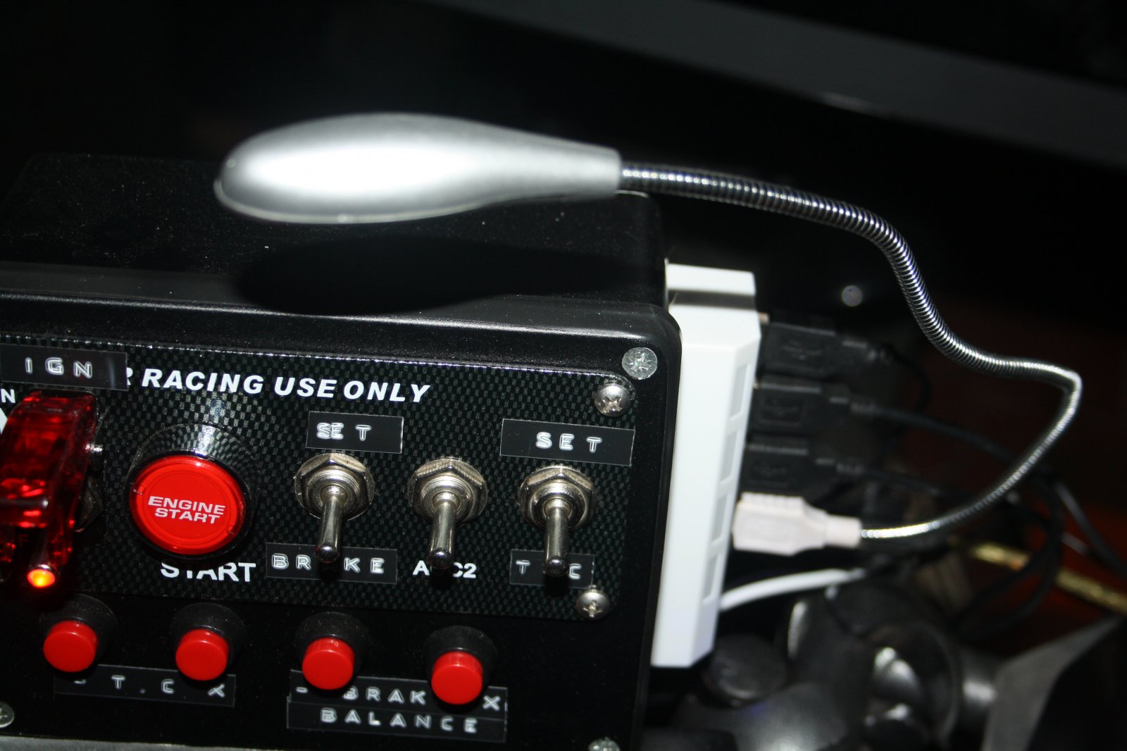

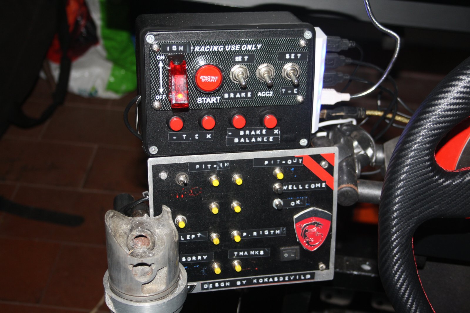

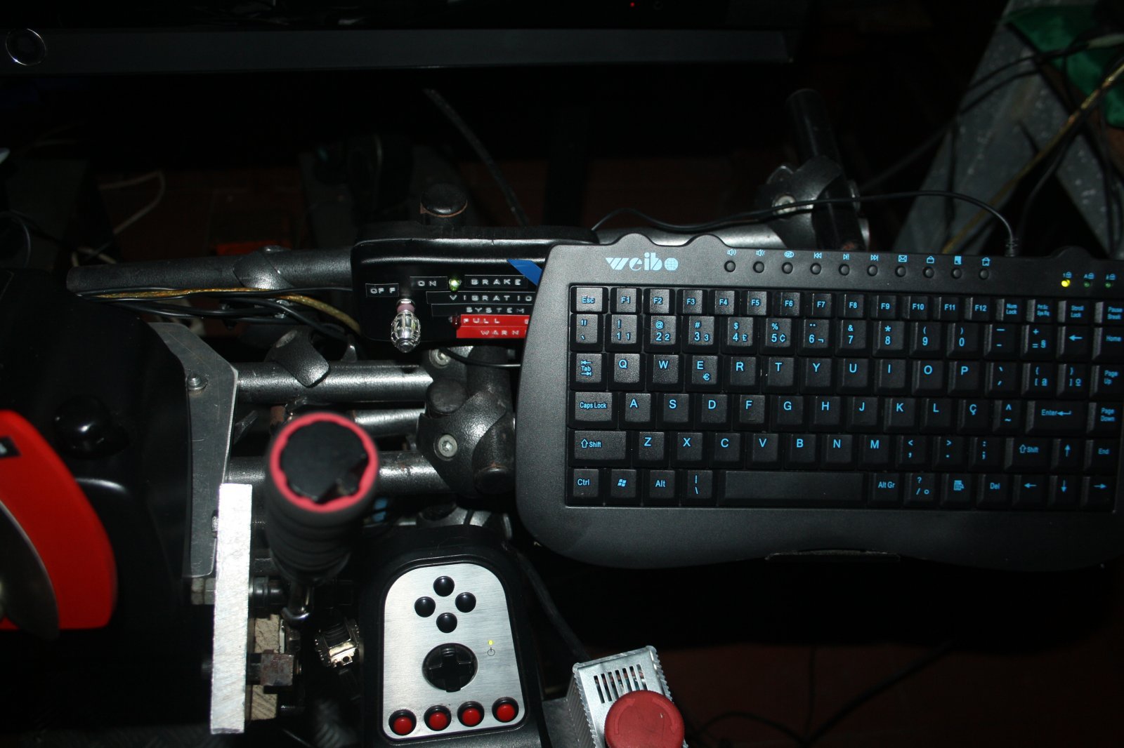

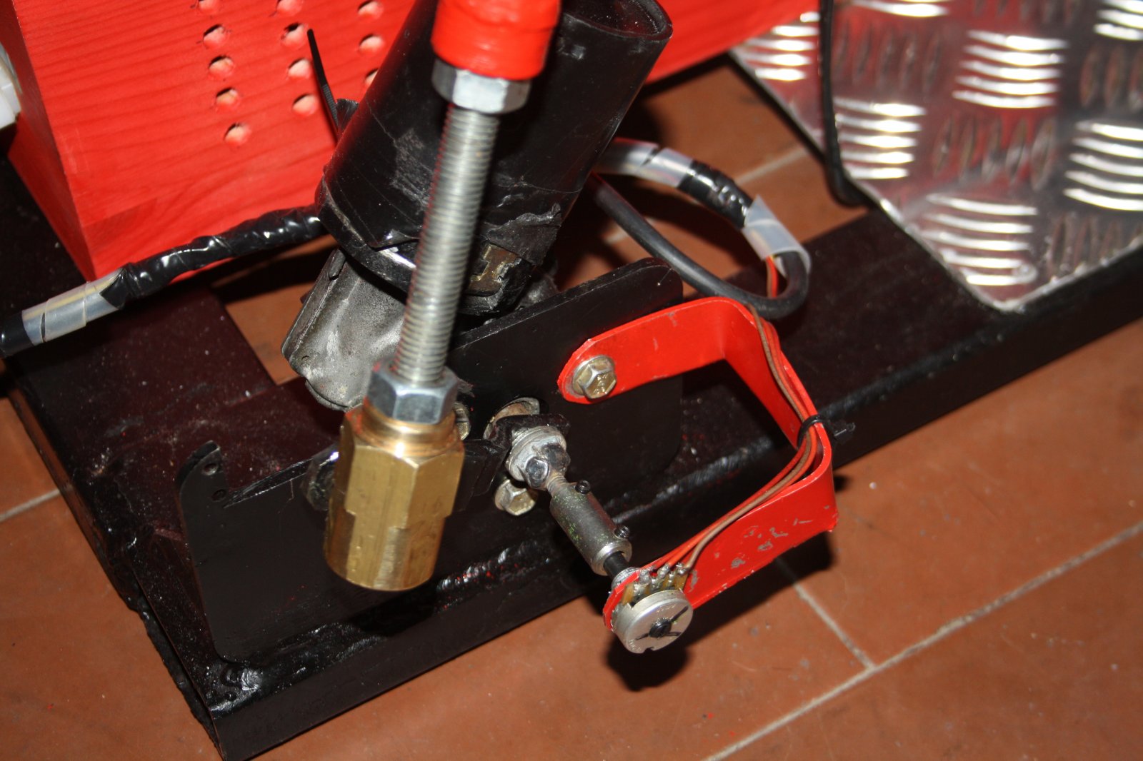

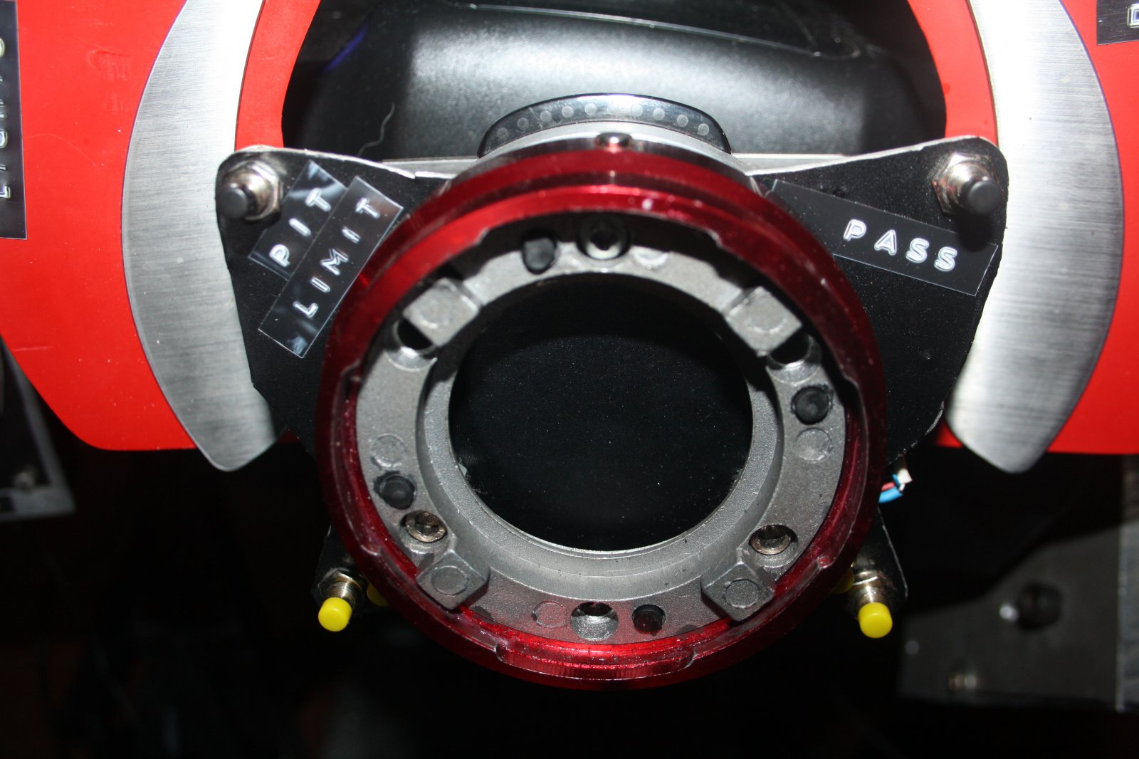

  18. mariana fino
    mariana fino

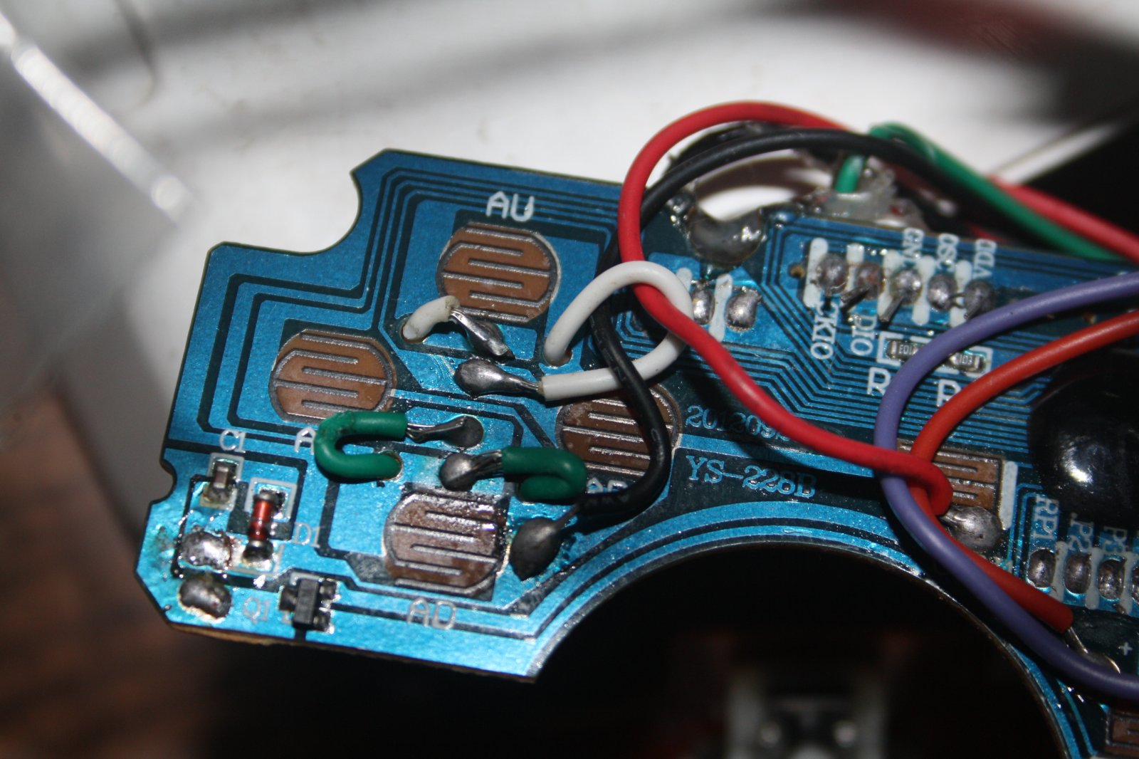

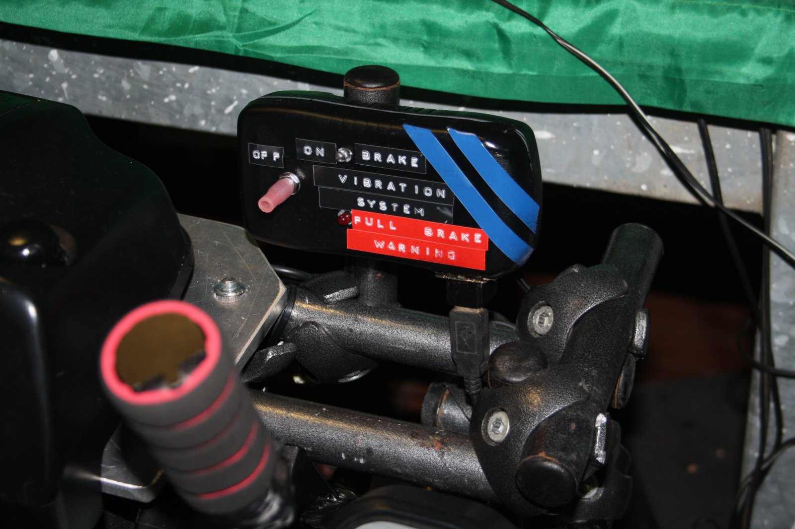

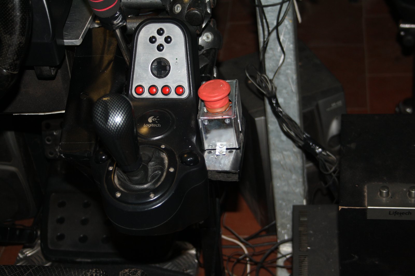

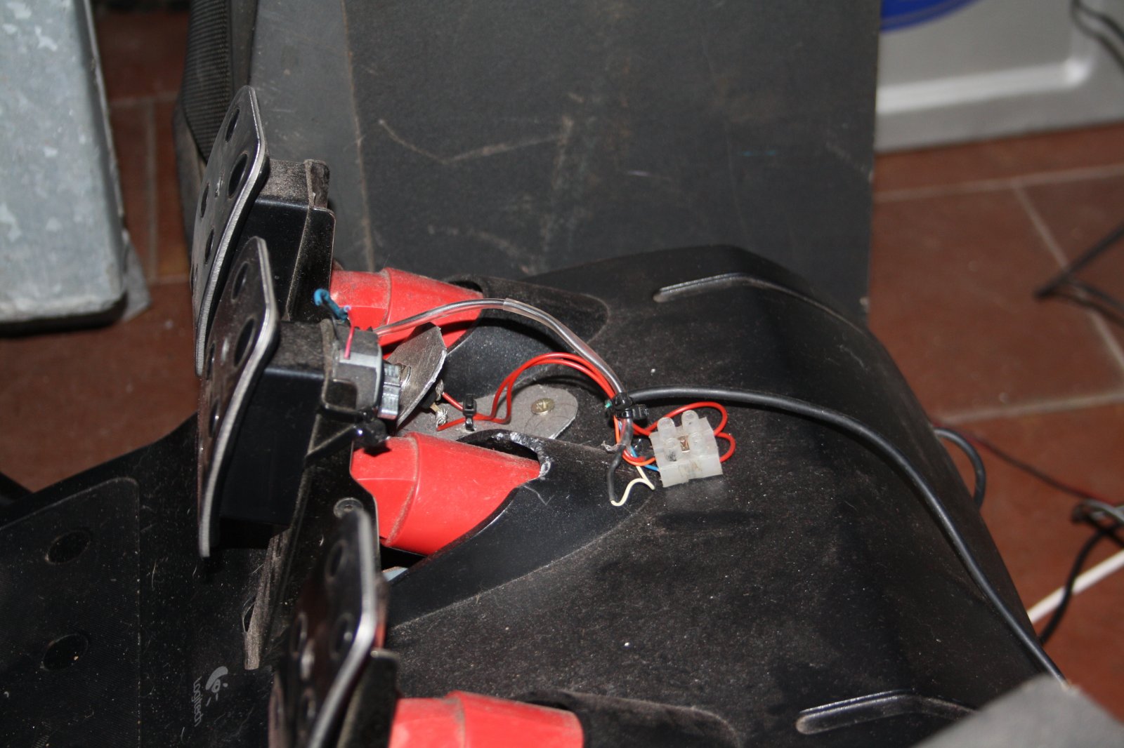

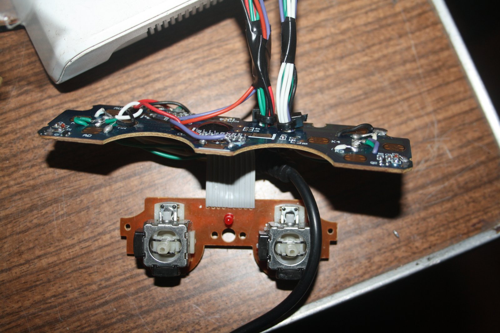

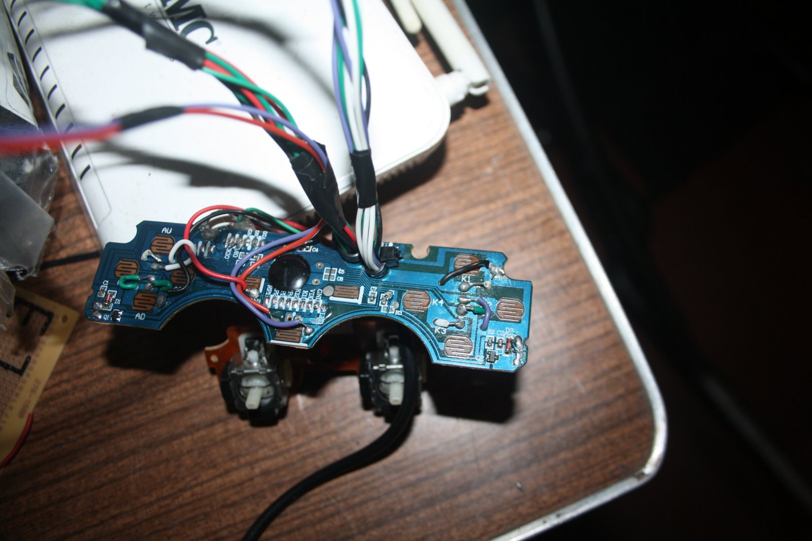

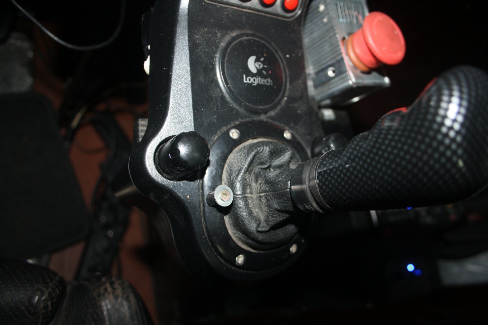

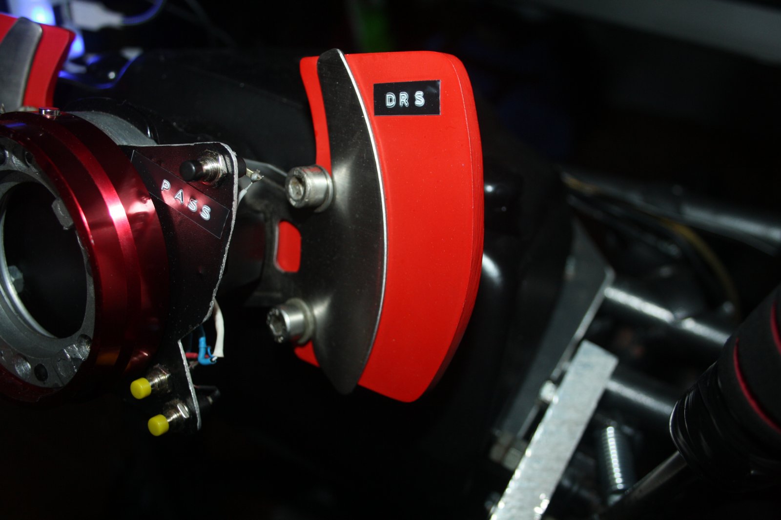

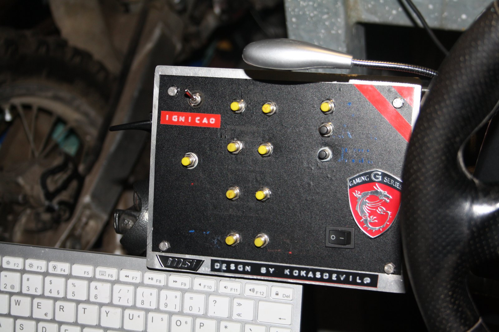

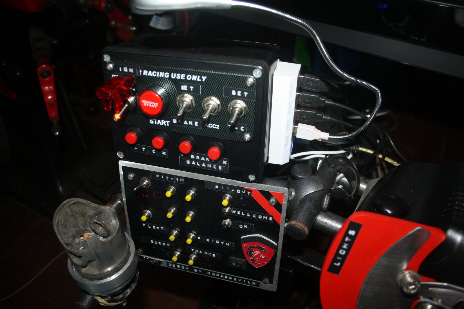

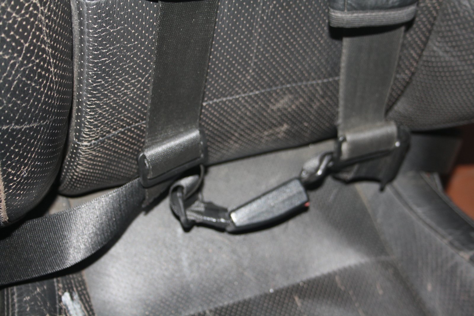

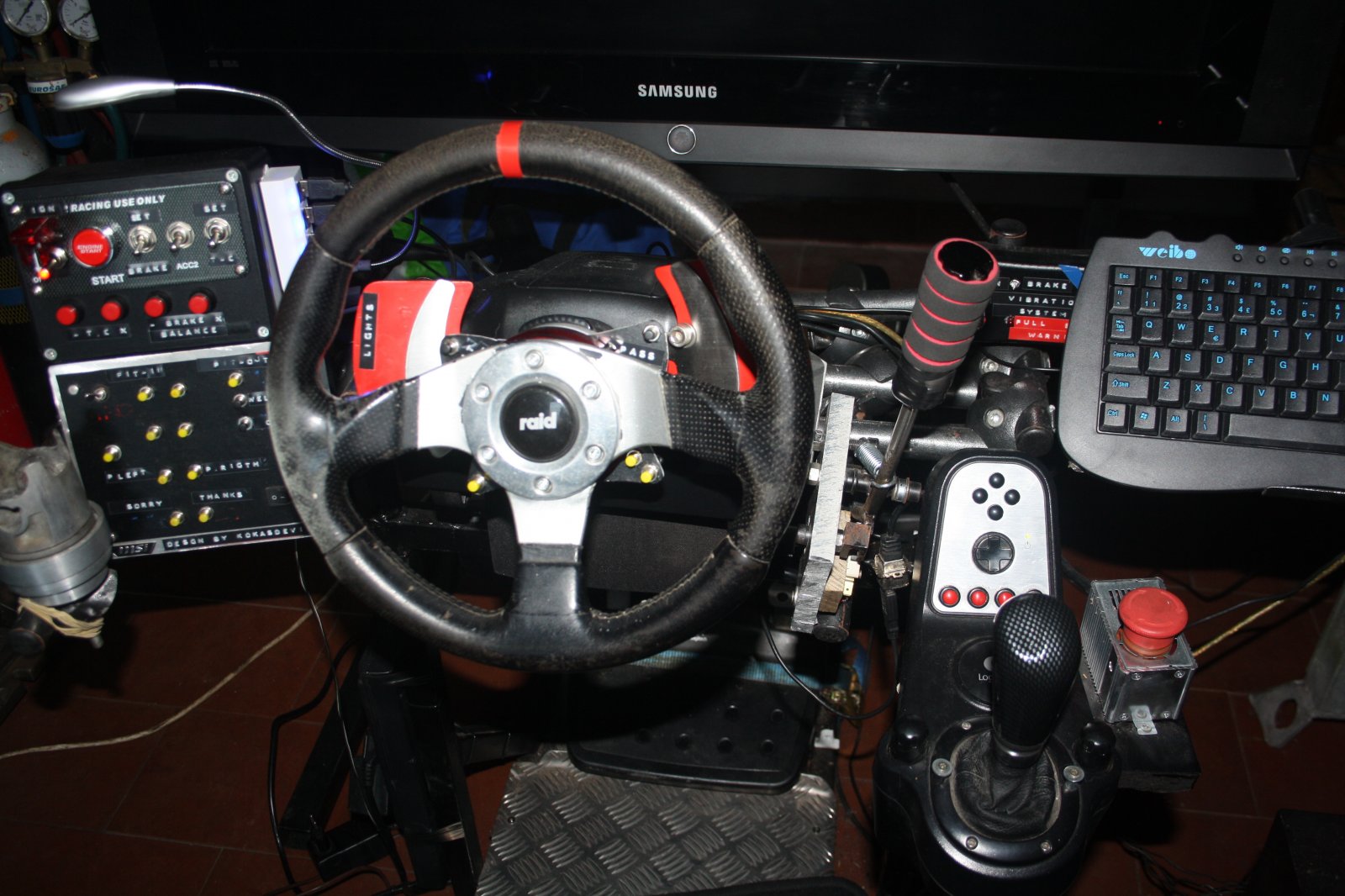

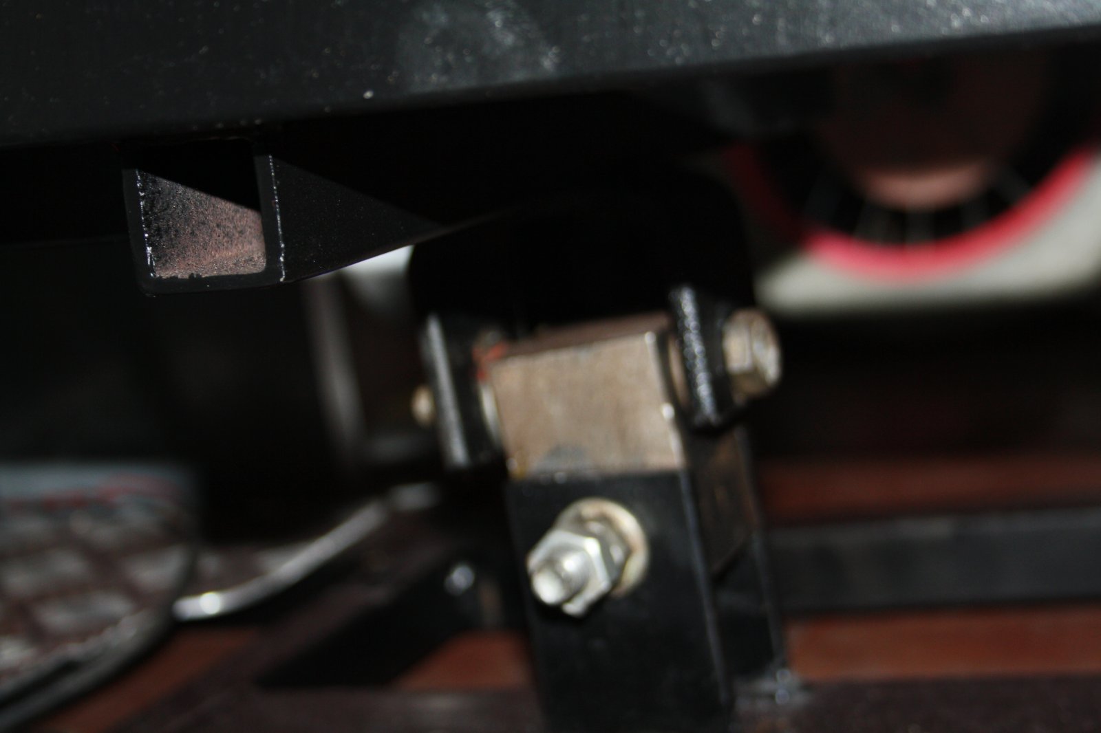

    The 2 button box that you can see are home made with cheap usb controllers!Some cooling on the engines so i can play iracing for long time with out overheat!4 point seatbelt home made also!Handbrake conect direct to g27 gearbox connect with na old usb plug!some cheap solutions!!

    This is how i made my button box!
  20. mariana fino

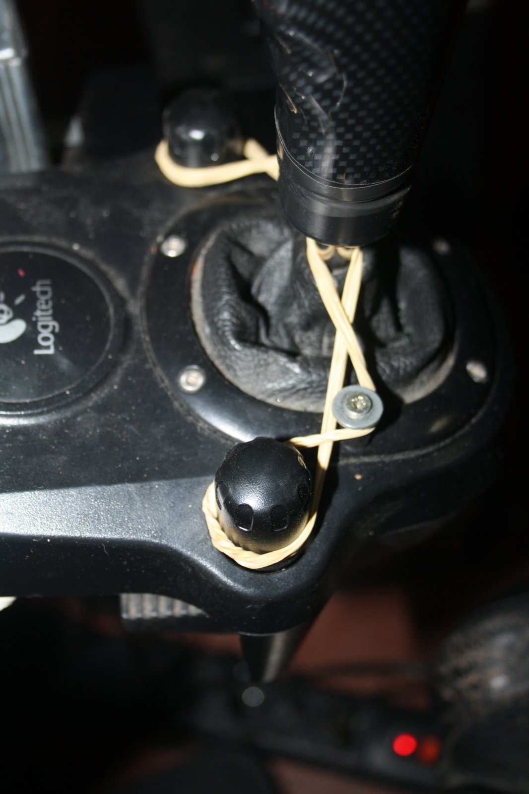

    mariana fino
    Another youtube trick ,sequential gearbox on g27 !
