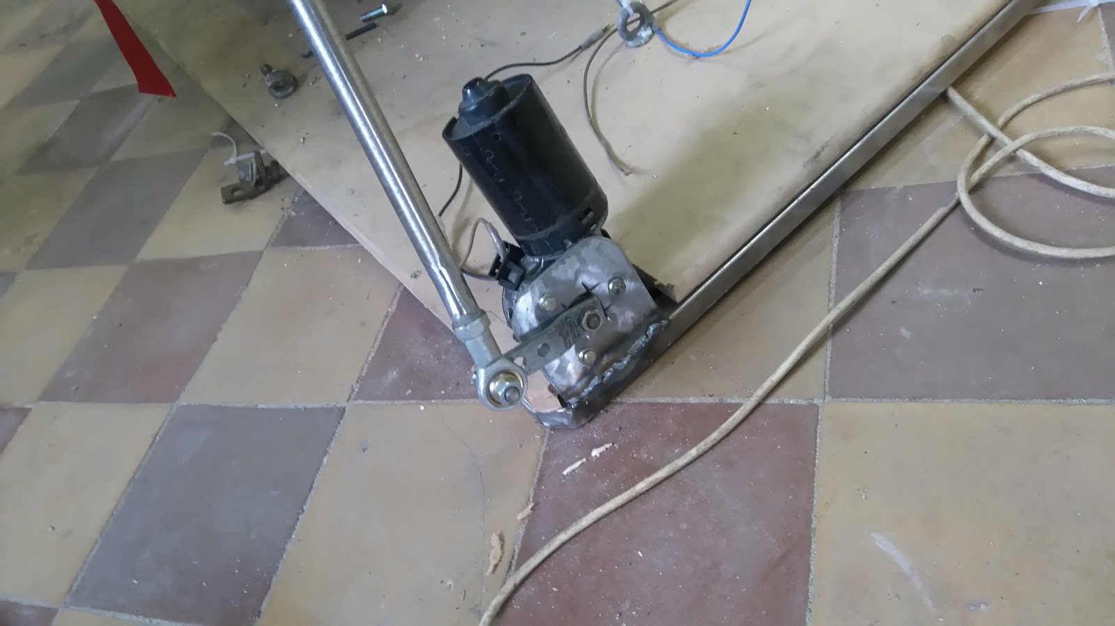

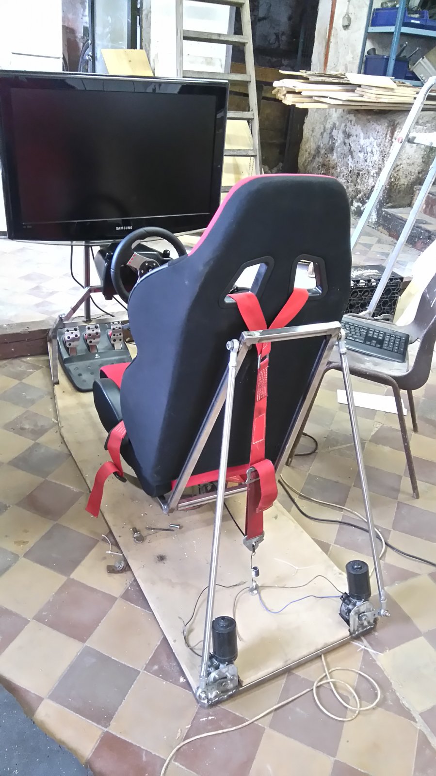

    The levers are done, and so are the rods :)

    Aah, just thought about the angle on the levers... Is it better that the angle is 90 degrees?
    22,185
    154,750Coins
    +11,196 / 57 / -2
    Maximum effective torque is when the lever is 90 degrees relative to the rod.

    Thanks, I'll have to shorten the rods a bit then, I don't know why I thought they should be level with the ground...

    Have anyone tried to make mechanical stops to prevent the motors from spinning around and damaging the pots?
    Would I risk frying something? I will of course make a safety switch.

    do the jrk's have a limit you can set like smc3 max limit?. if so just use that.

    I have no idea, as i haven´t tinkered with the jrk yet :) I just thought that it might be a good idea...? If the pot fails or something, an electronic limit wouldn't help i guess?

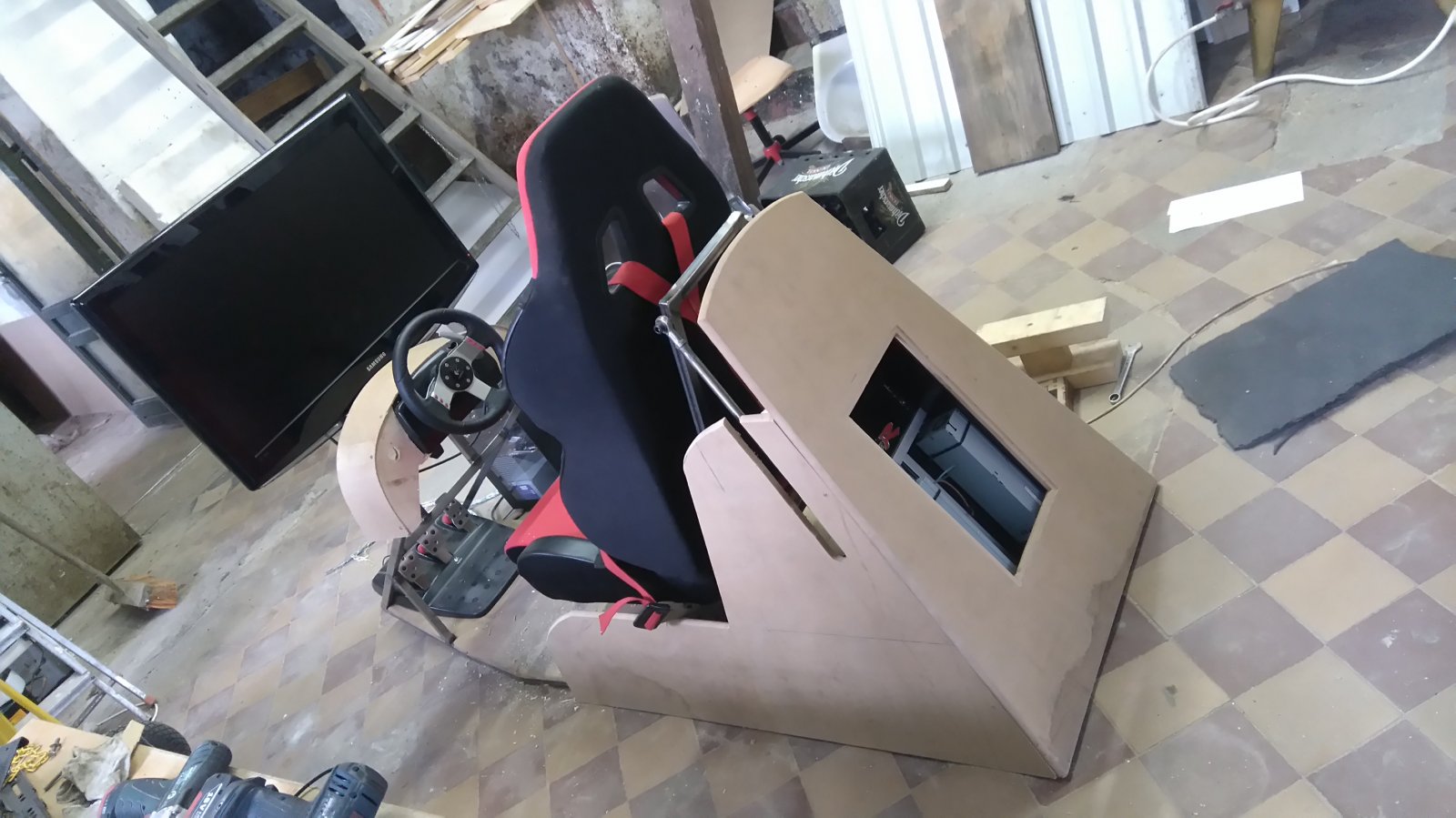

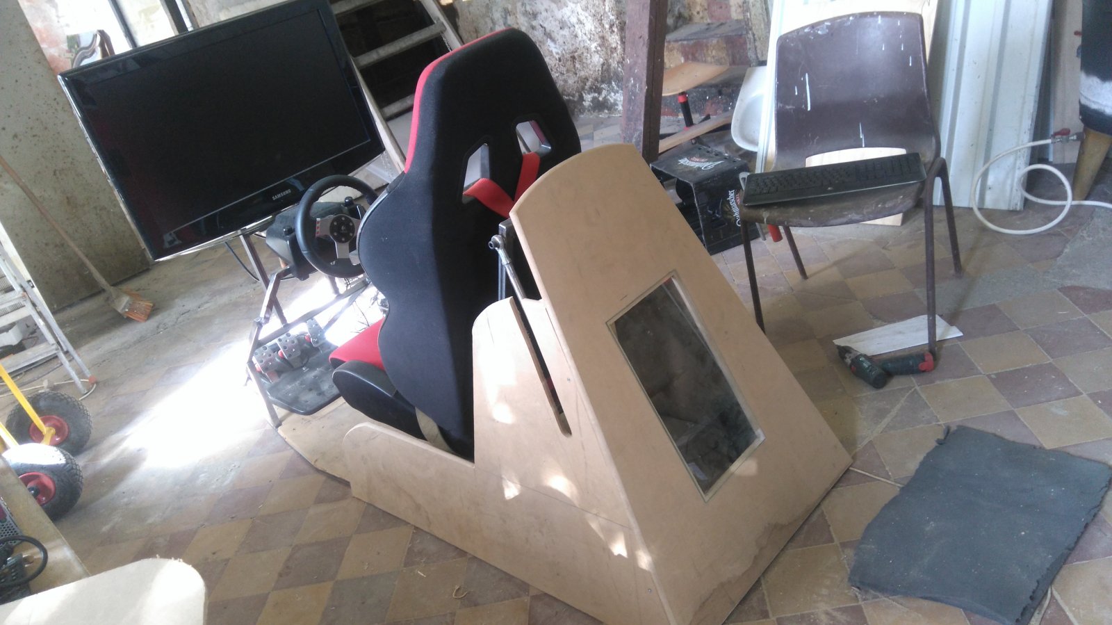

    I've decided to cover most of the sim in mdf.
    Behind the glass I will make a box for the electronics

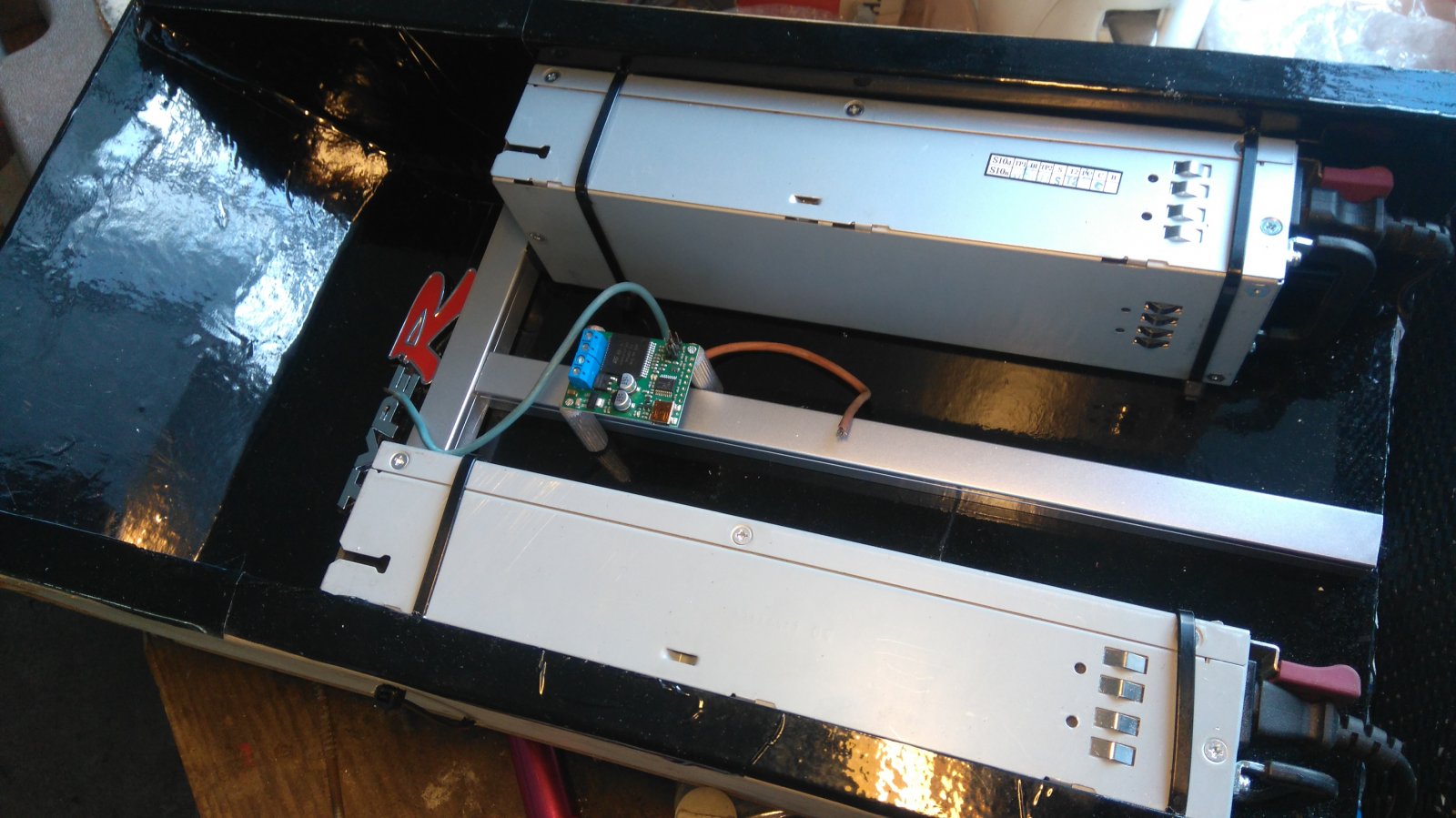

    Nearly finished with the box, the last jrk arrived to day.
    Also made a "dashboard" of a kind, but might have to make some vents for the wheel...
    Where can I find some sort of rough setting for setting up the jrk's?

    Fans and Heat sinks are 100% Mandatory. NO questions asked. Despite what Pololu may claim.

    Thank you very much :)
    I have just added the heatsinks, the fan are still on the way from China, but I'll just use a temporary one while testing.
