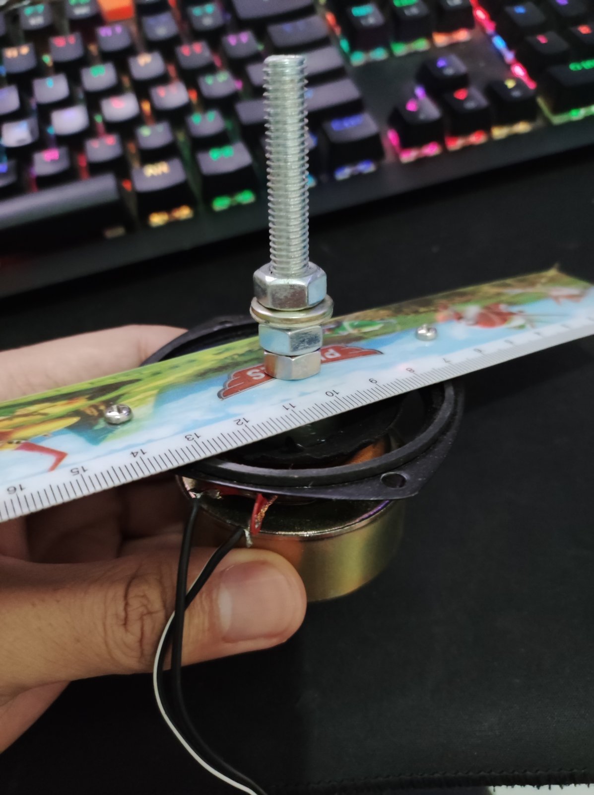

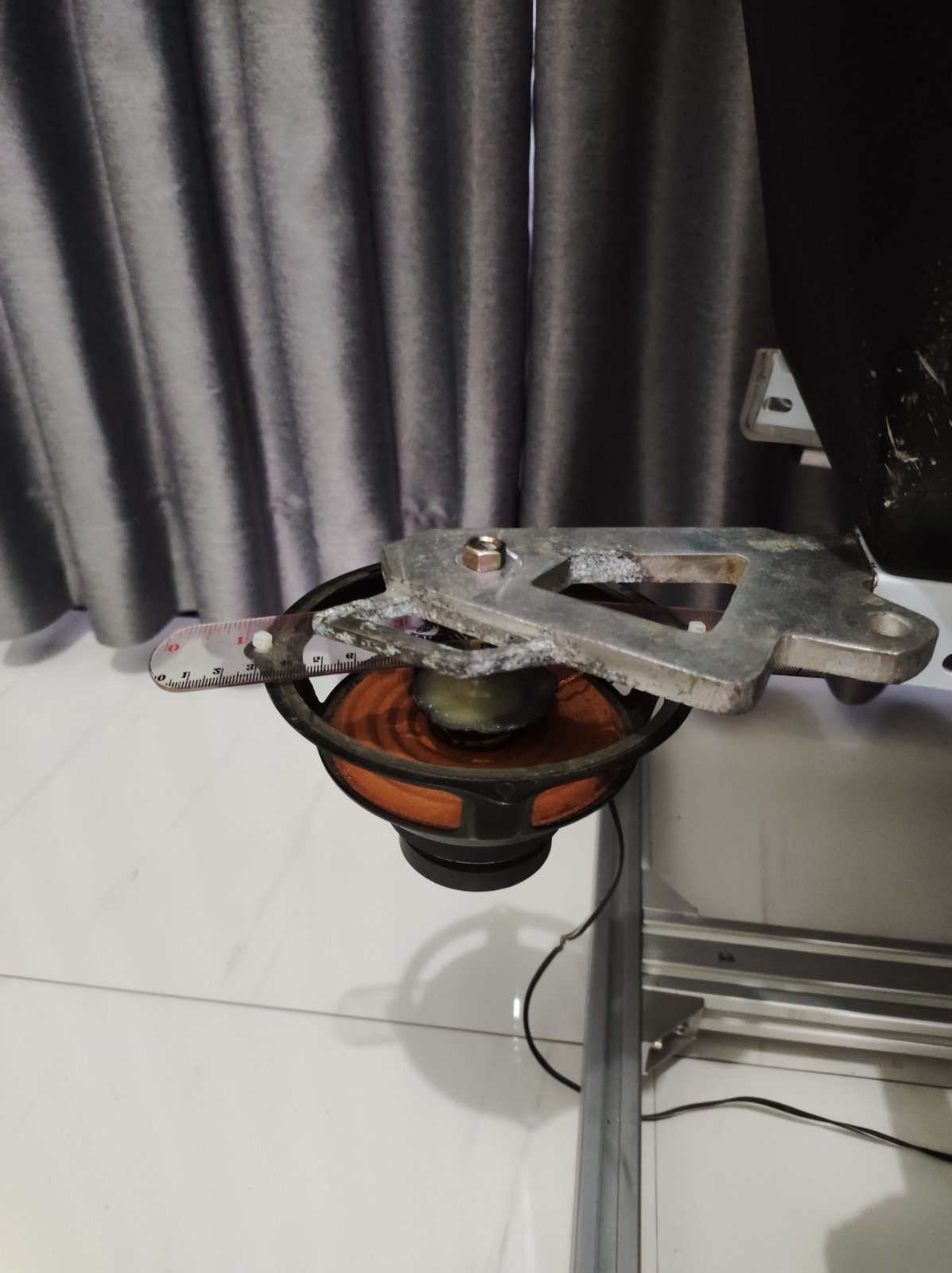

    I build two of it too.
    Place it on front and back of my rig.
    With a used speaker from junkyard its the best option to do a diy bass shakers.

    Nice!,. Good idea with the plastic ruler, You always know the size of your speaker :)
    I have two of the nobsound bluetooth amps, and three speakers. I will try different setupe, and maybe make one more

    here acrylic price a little bit high. and a 15 years old plastic ruler can do the job. lol
    so your plan is placing the speakers on the each corners?

    if I may give some input, its enough to get 1 each under the seat, pedals, and shifter.
    before, I put 4 on each corners, but I doesn't feel different with only 2 front and back.
    I cant feel if the feedback is from where.
    so its gonna efficient with only 3 location like you mention before.

    here is my little shaker for the pedals.
    And yes its the best I ever did to make them for free
