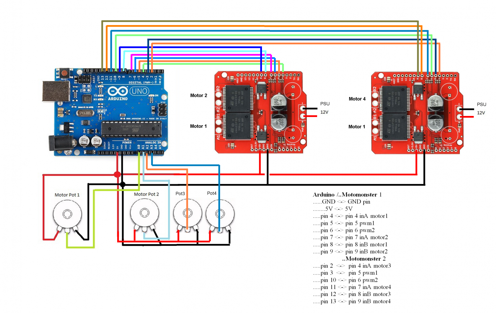

    I'm doing a bit of research into adding more motors to my sim for traction and surge but I am a little confused as to the Arduino code to use, I have read @RacingMat thread on 4dof but its for 1 pin direction, but at the bottom of his tutorial it has the wiring setup for the Arduino connected to 2 motomonsters and 4 motors, so will this code work for this setup 2motomonster.png . I over think things a lot and the my head does 360's
  16. SeatTime
    2,573
    28,321Coins
    Just use another Arduino. Run two motors off each.
  17. stomper
    stomper Member
    Apr 30, 2016
    40
    Timber Treater
    80Coins
    +27 / 0 / -0
    thanks That was a thought I had.
  18. RacingMat
    2,237
    21,027Coins
    I don't understand your worry...
    4 DOF is 4 motors
    and if you use MotoMonster, you need 2 MM for 4 motors
    the code manages the 2 MM which drive the 4 motors: hence the code is fine for your 4 Dof
