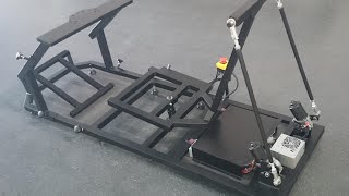

    Hi! I have plans on making my own 2 DOF seat mover for a long time and it's now time for me to jump in! I already have the 2 motors with are 50:1 12v 180w each and i'm now looking for the motor driver and the main board. For the drivers i was looking at : Pololu High-Power Motor Driver 24v12 https://www.pololu.com/product/757 .
    And for the main board .. i don't know what's the best option! I heard that arduino are not the best in resolution but it was 3 years ago. Maybe they've improve that point? I've attached a photo of what the rig will looks like! I look forward to hearing from you guys! Thanks.

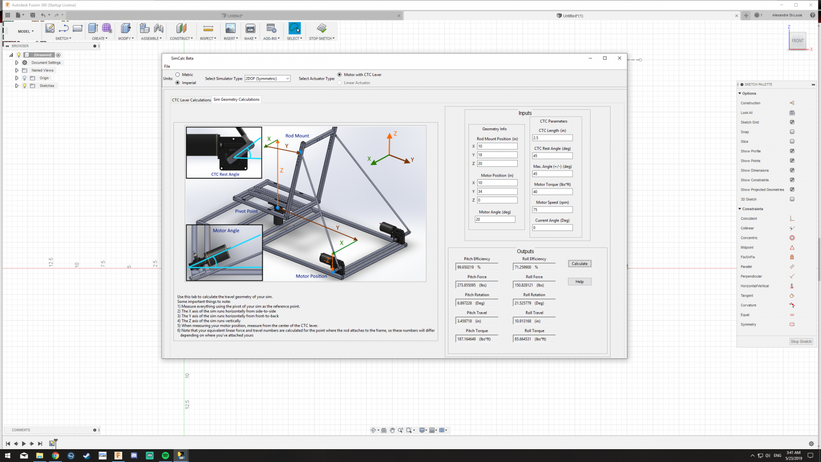

    In particular review the Design section, and have a play with SimCalc to get your head around the trade offs between design and physics: https://www.xsimulator.net/community/faq/design-considerations-resources.24/category

    What do you think of these number? i'm drawing the frame in CAD at the same time!
