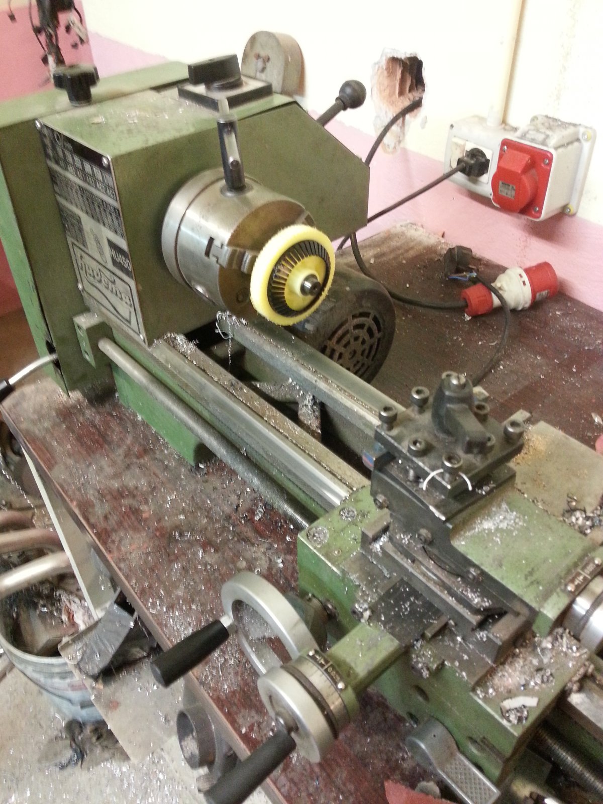

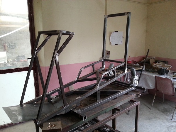

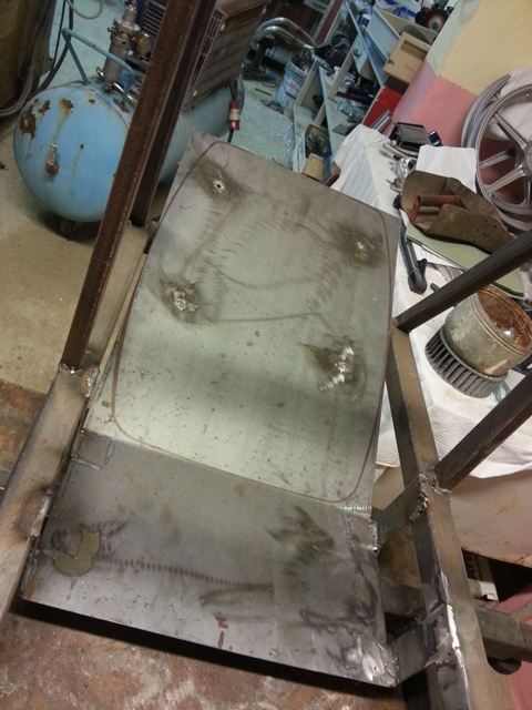

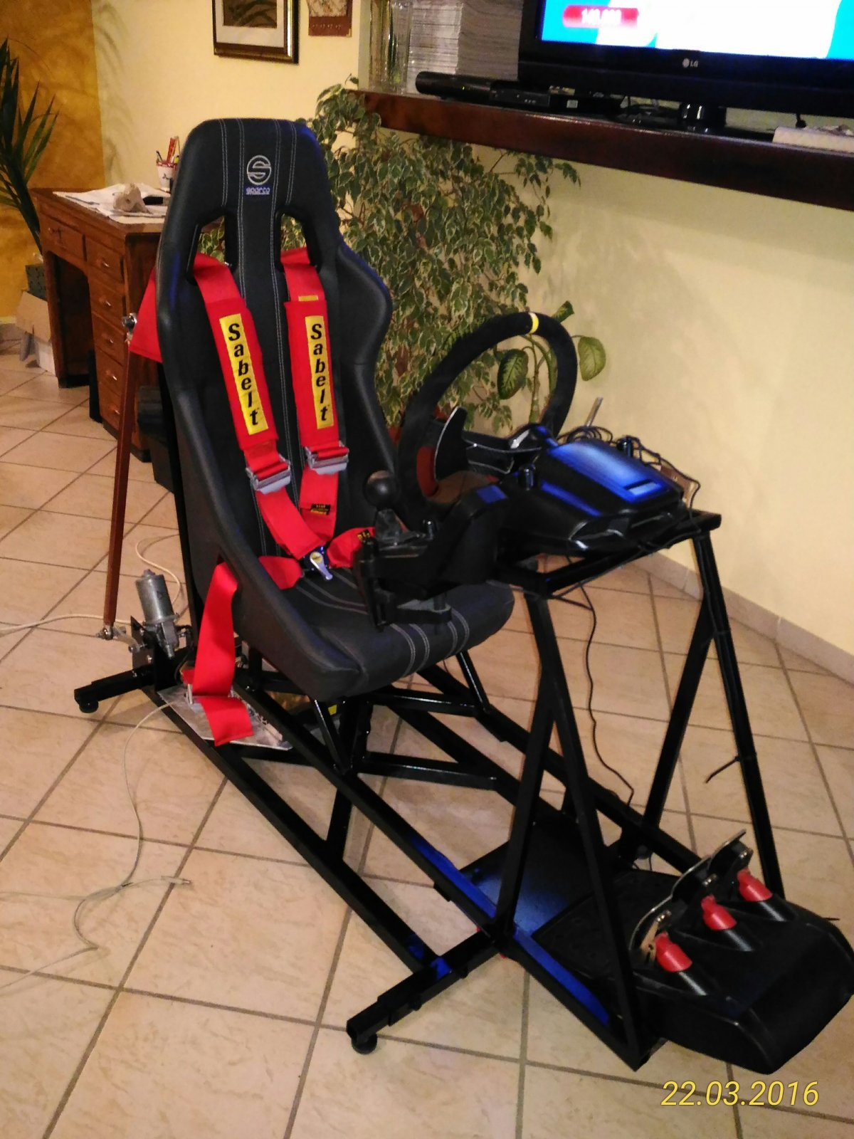

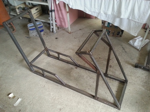

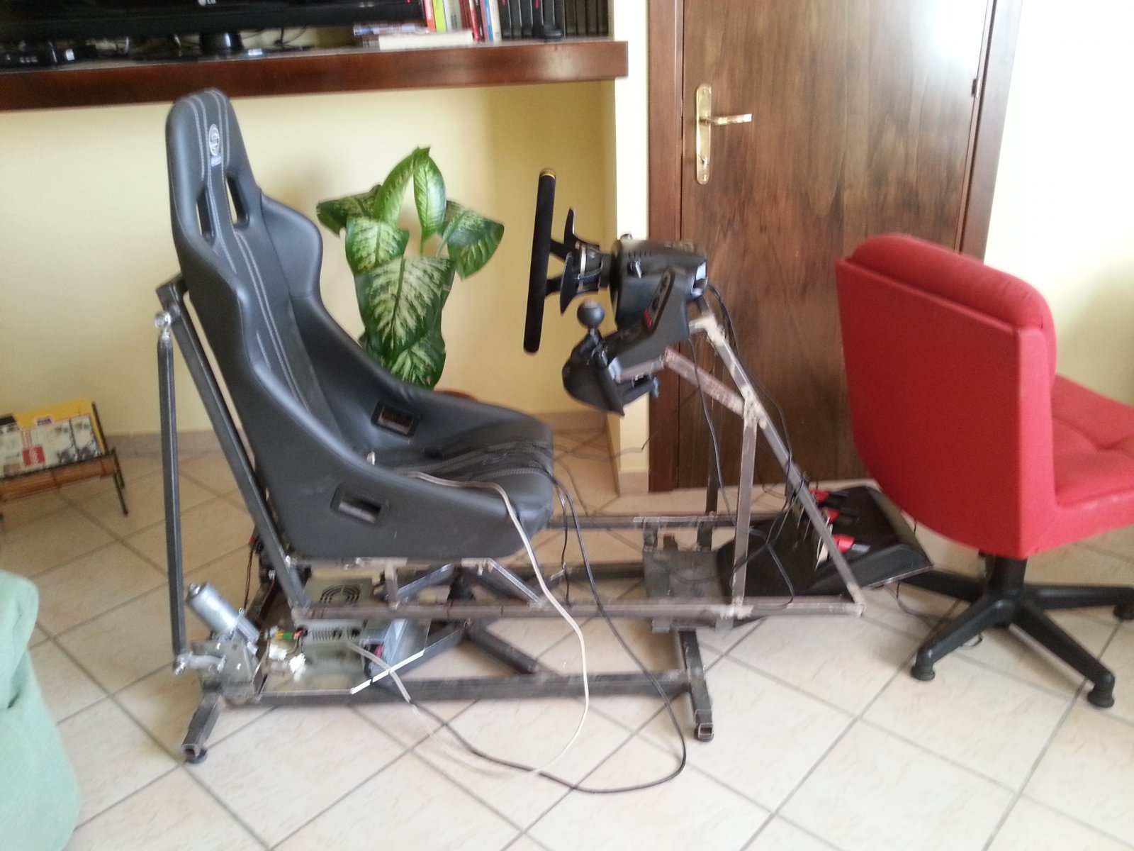

    I present my "sim 2 dof". For my homemade simulator, I chose the iron rods of 35x35mm sp.2mm size for the base and 30x30mm and 20x20 sp.2mm for the upper float. The all welded.
    I will show you step by step my realization.
    P_20160322_194747_1_p.jpg P_20160322_194803_p.jpg P_20160322_194812_1_p.jpg P_20160322_194829_p.jpg
    [​IMG][​IMG]
    ______________________________________________________ Chassis

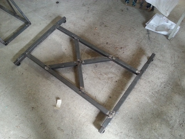

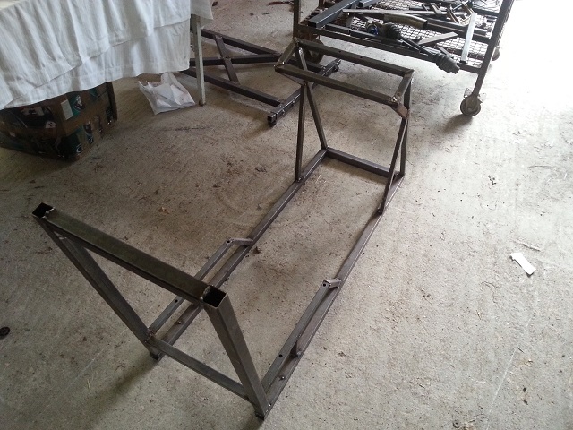

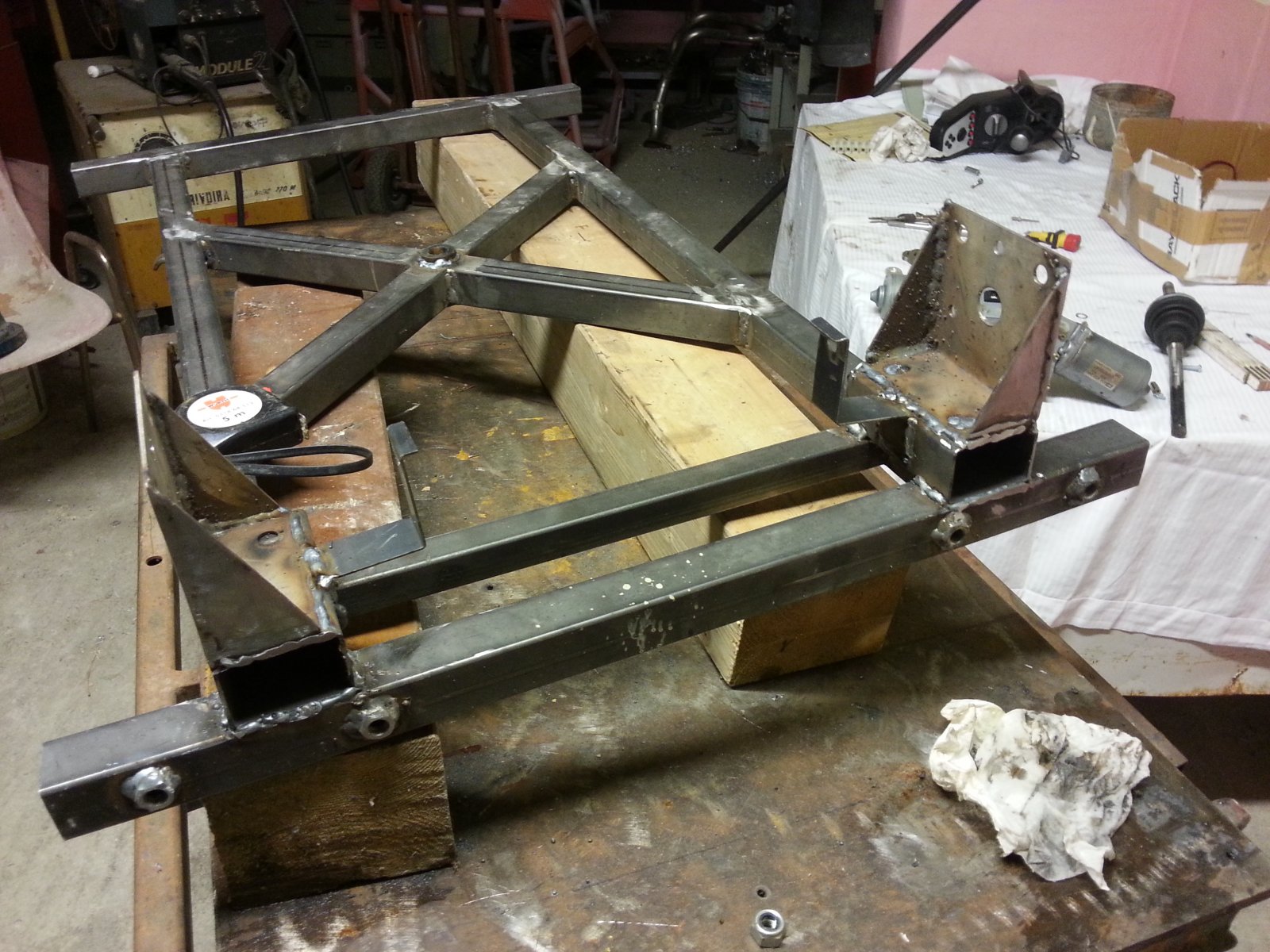

    The upper part of my frame

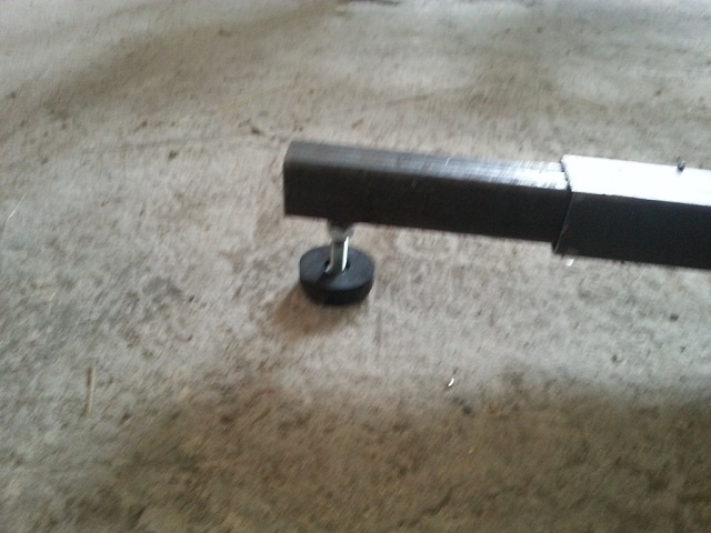

    The lower base with adjustable feet.

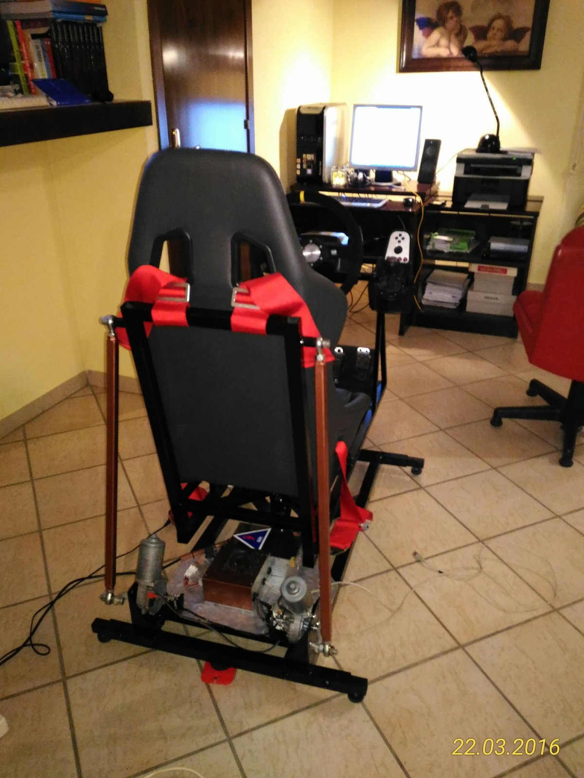

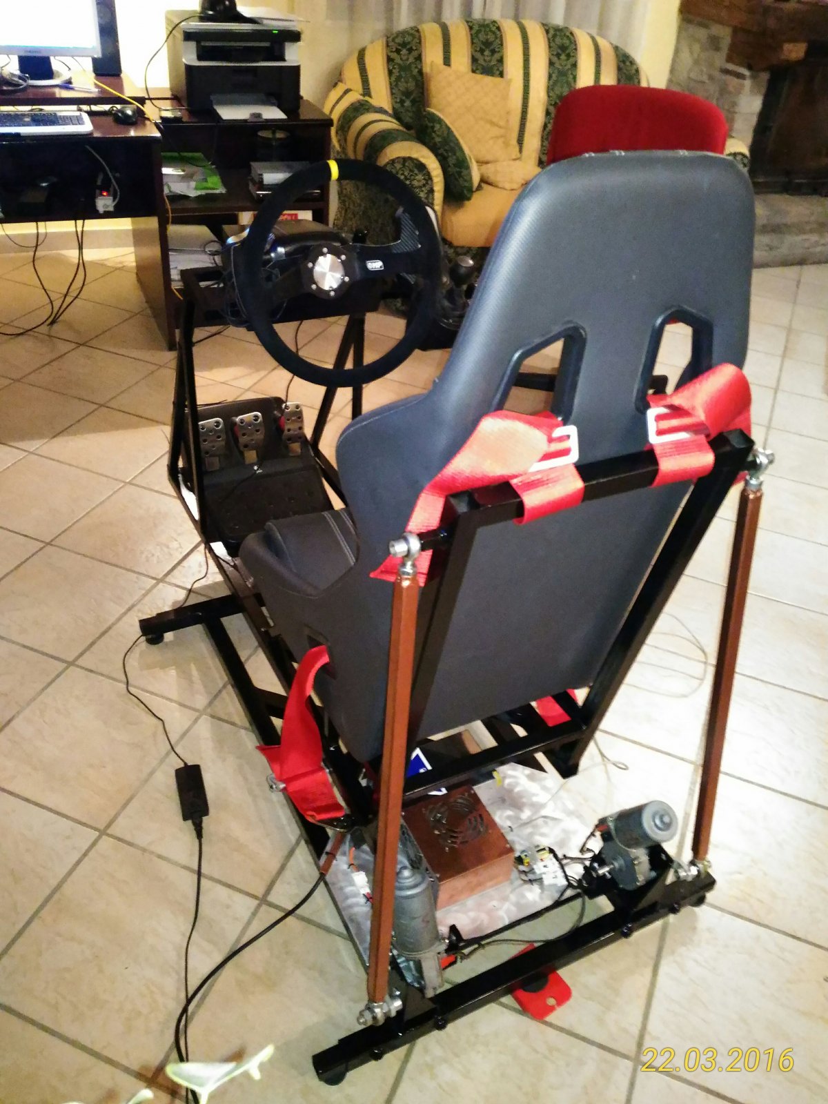

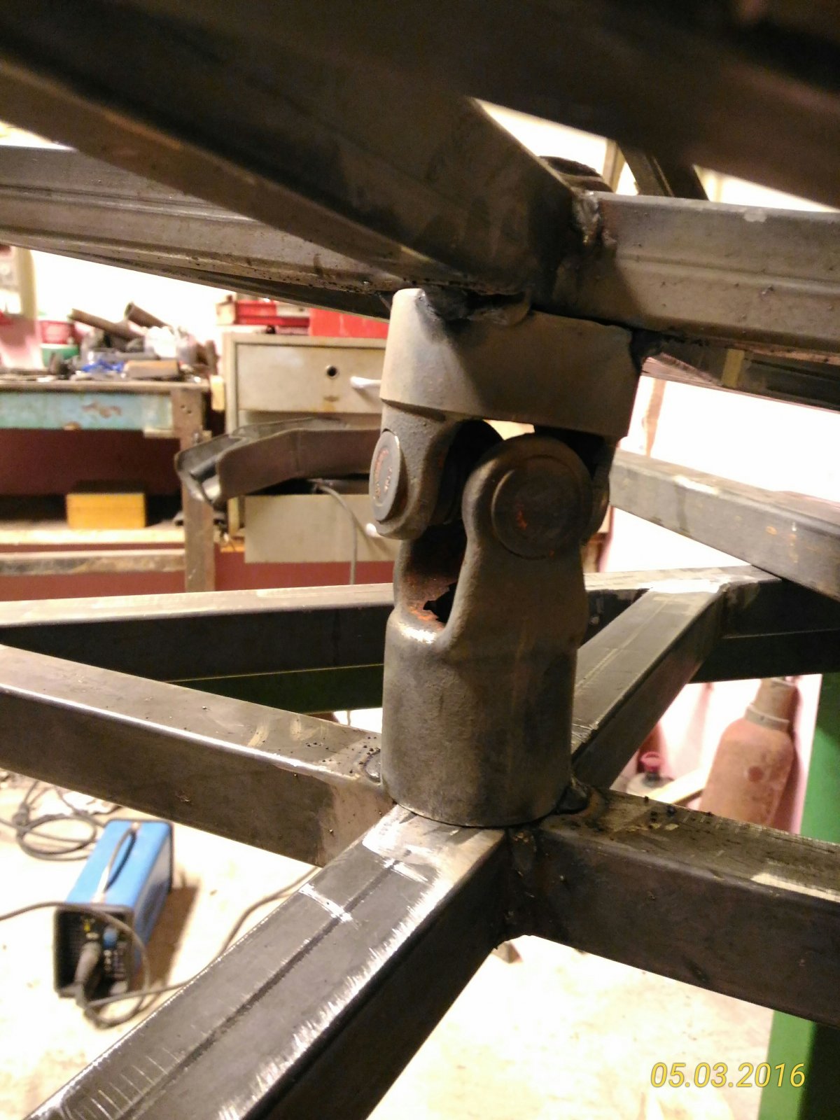

    The cardan joint used in the assembly of the top and the bottom of the chassis.
    It is very important that the joint prevents rotation of the upper part.
    The result is this

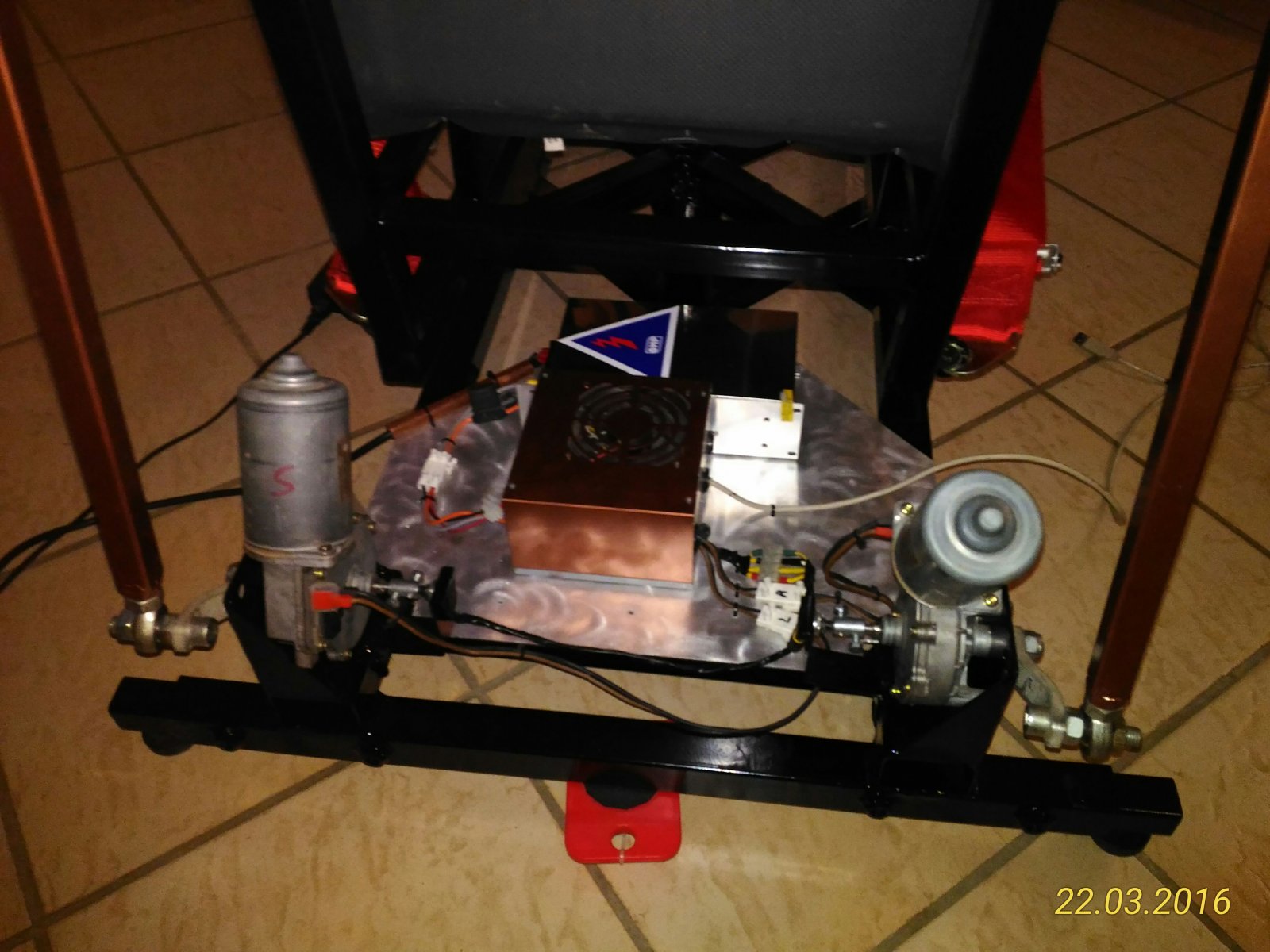

    Electronic and motor

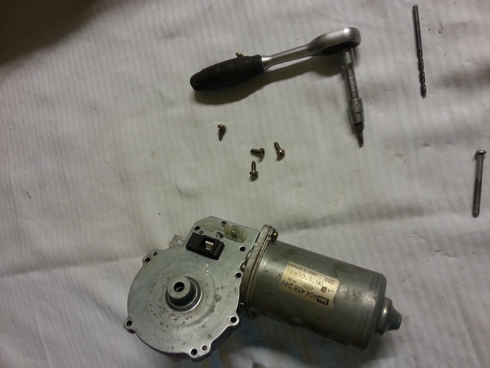

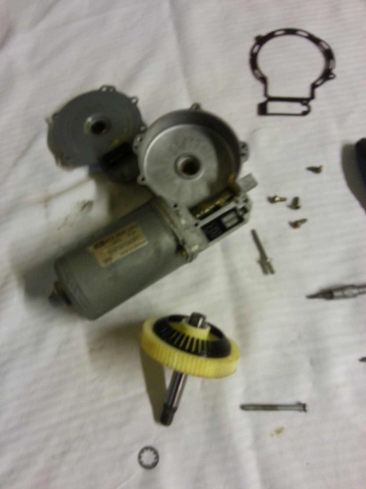

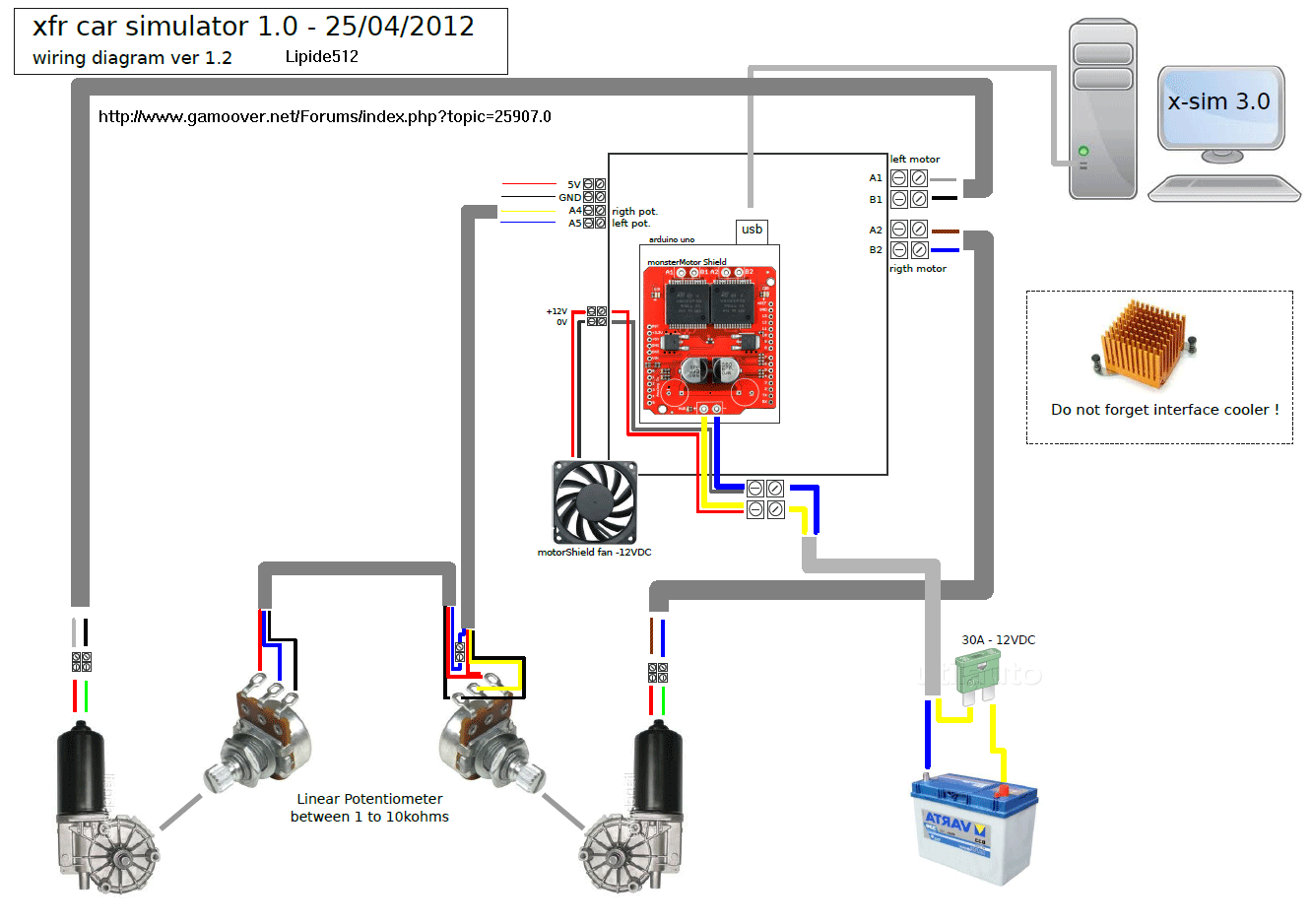

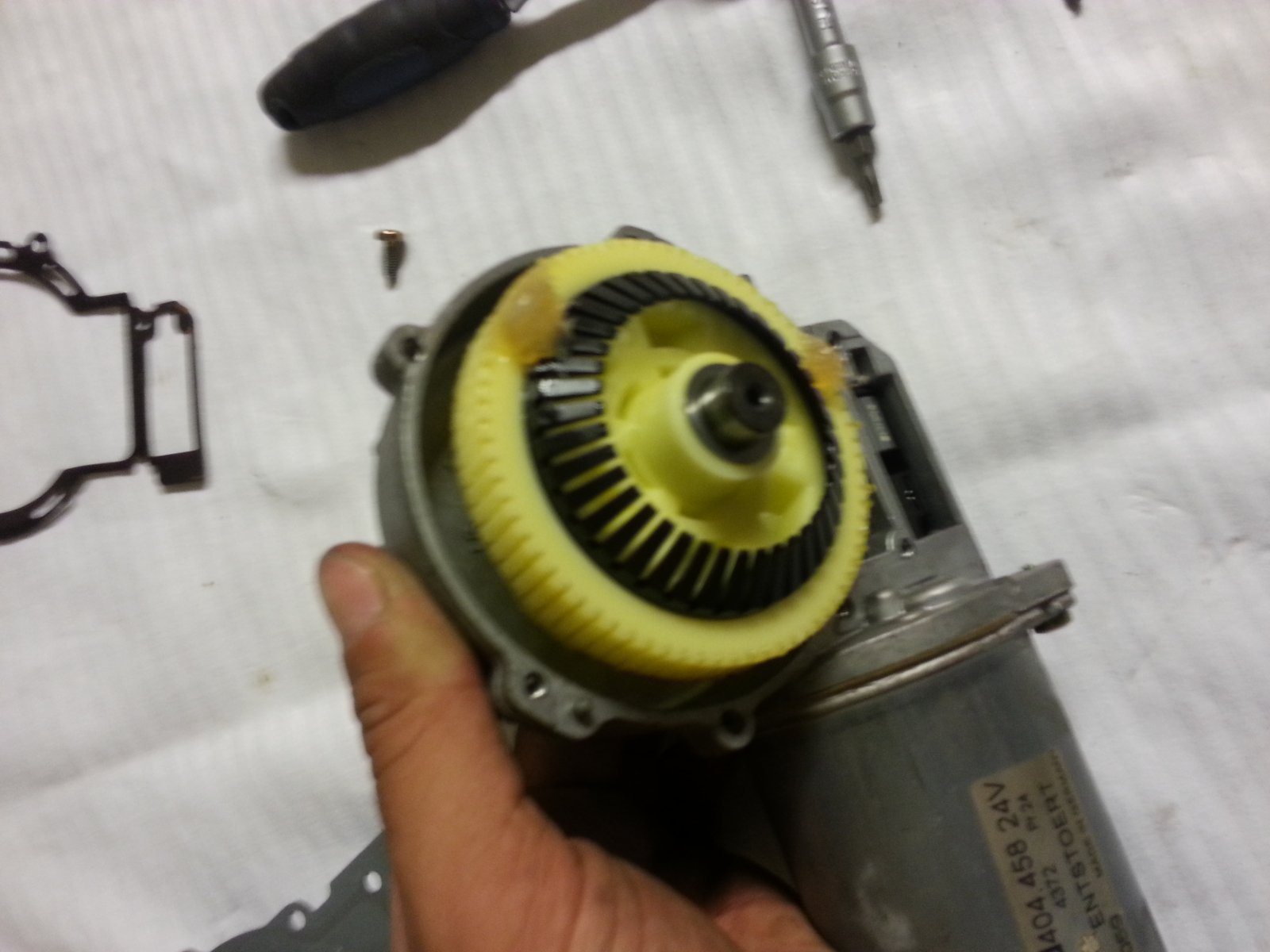

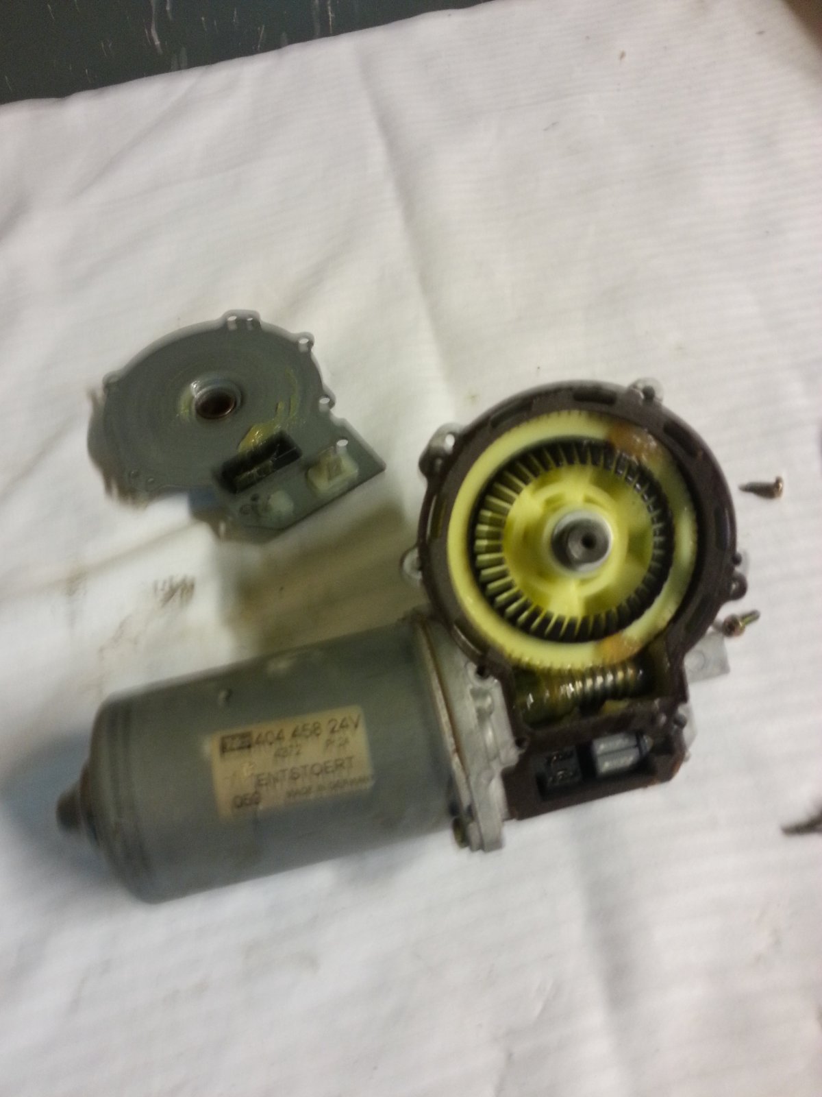

    The utilized solution to move the frame, are two wiper motors, exactly SMOLKA VALEO 404.458, powered and controlled by motomonster card and Arduino UNO, controlled by 10Kohm linear potentiometers.
    This is the assembly scheme.
    I've got all the necessary material on various internet sites.
    Wiper motor - Smolka Valeo 404.458 12V Wiper Motor
    Linear pot 10k
    Arduino and motomoster shield
    Electric cables
    power supply 12V 50A

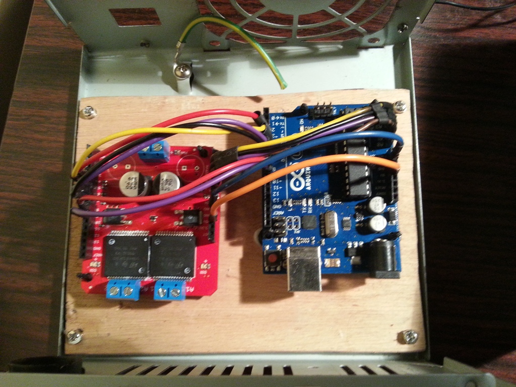

    The motomoster can be attached on top of the Arduino. I preferred to make them work parallel, so there is no danger of a short circuit and overheating.

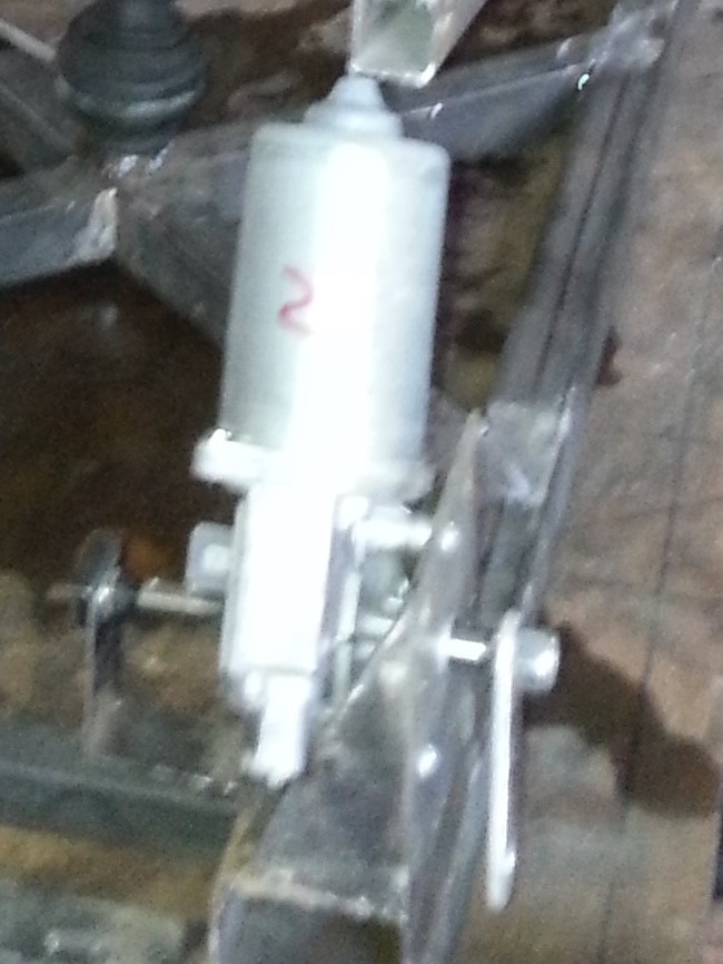

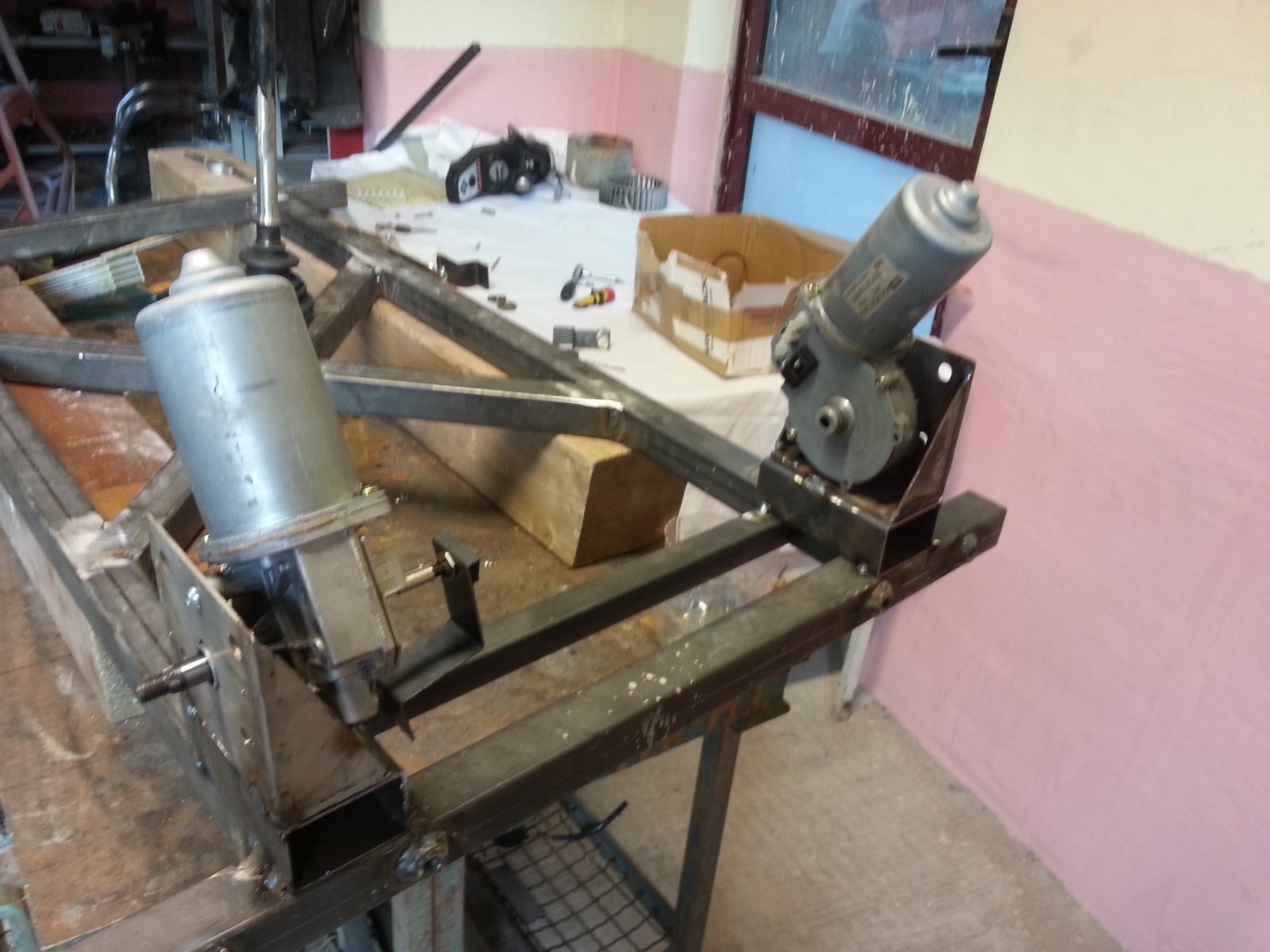

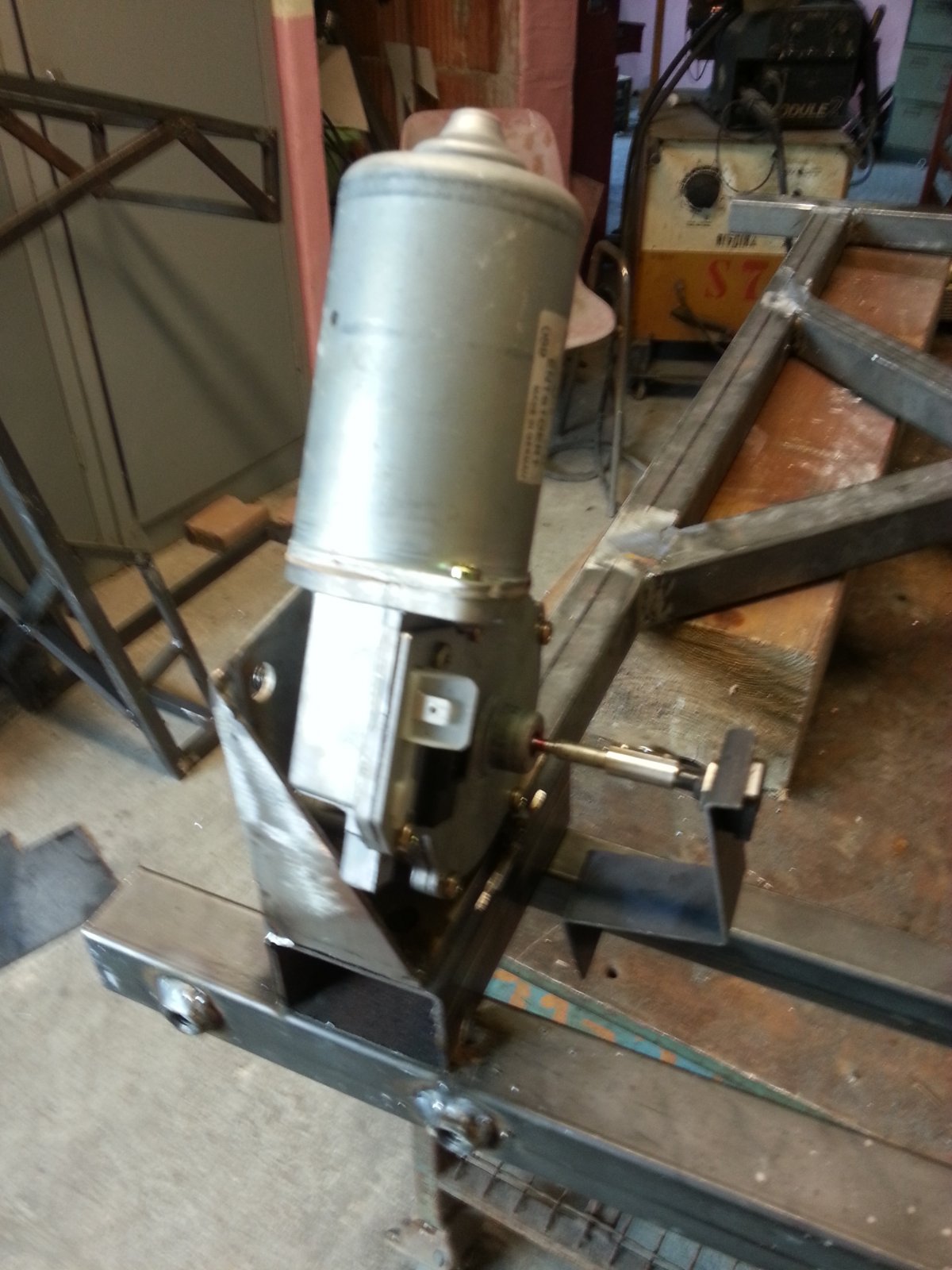

    Once the boards have been prepared, the motors are mounted on the chassis and the potentiometers are connected.

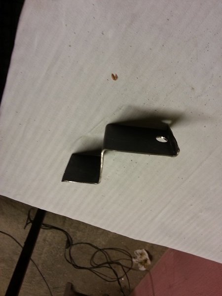

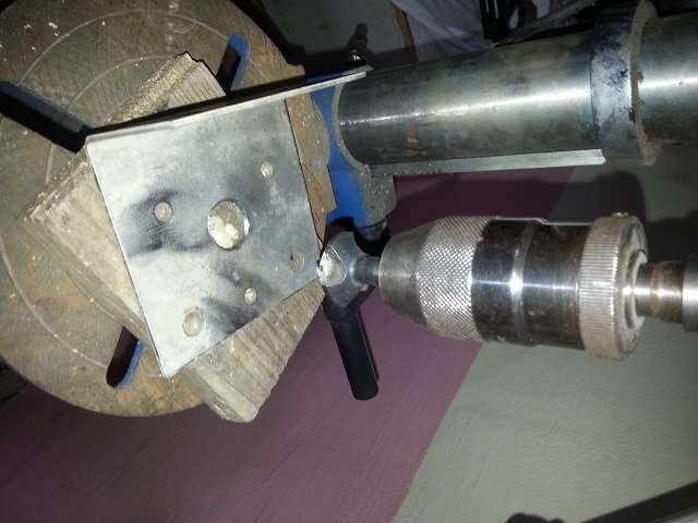

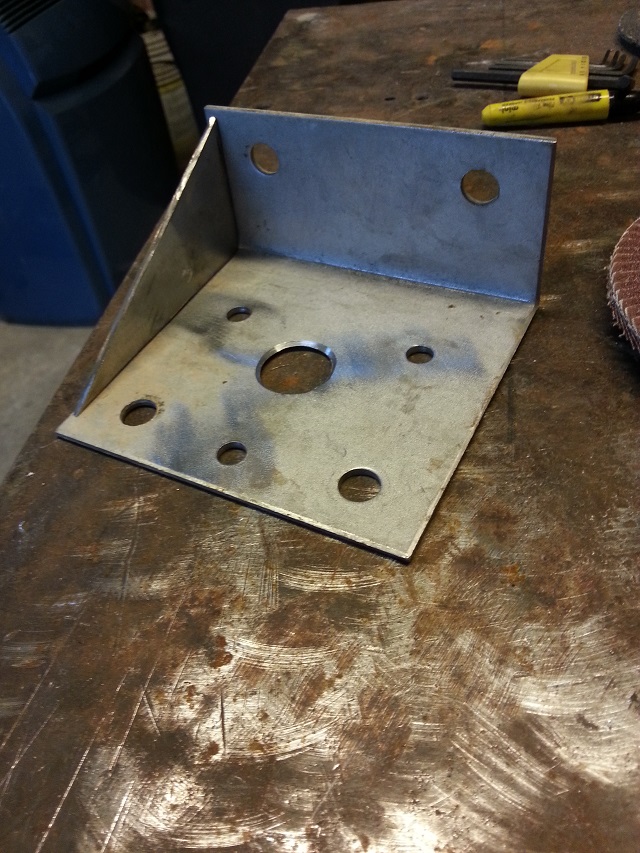

    For the assembly of the engines I have prepared some special brackets.

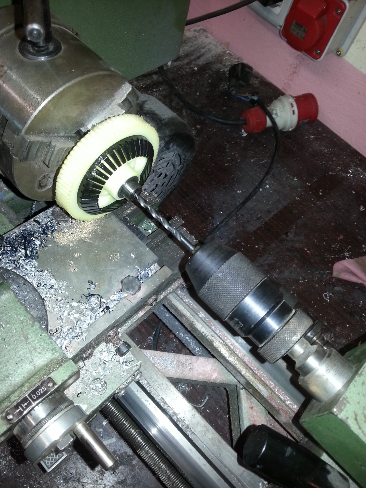

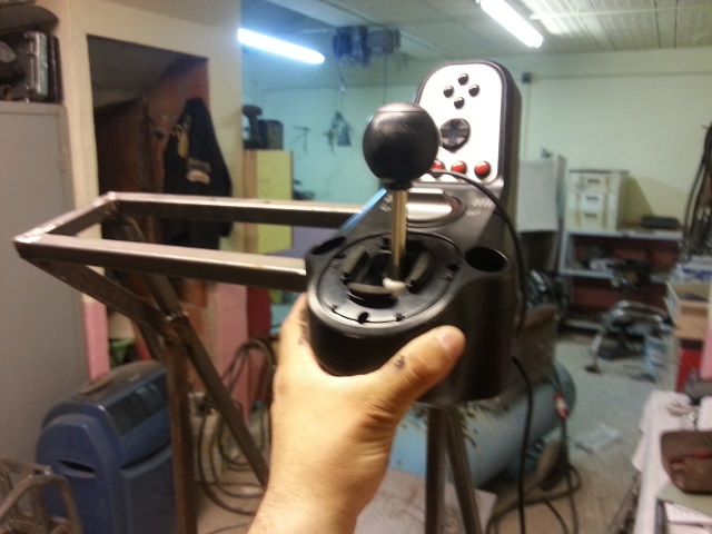

    I inserted pieces for gaming devices

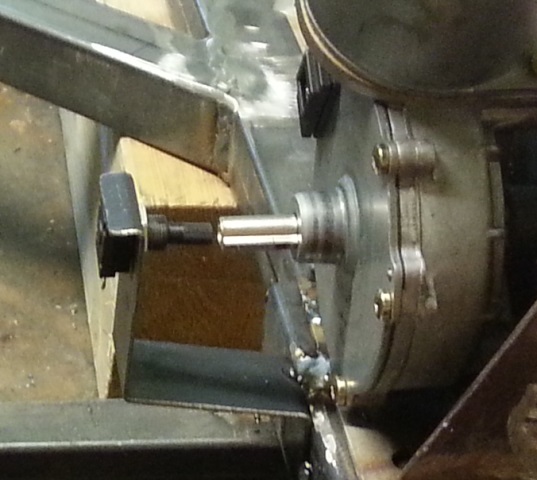

    Finished with the motor brackets and with the chassis, I proceed with the preparation of the 6mm mechanical shaft to connect the potentiometers. I disassembled the engine, created a mechanical thread which I need to screw the created mechanical shaft.
    20150518_214132.jpg 20150518_214231.jpg 20150518_214249.jpg 20150518_214323.jpg
    I created some potentiometer brackets. A flexible material is recommended
    This is the result
    As you can see, the potentiometer is connected to the transmission shaft by means of a 6mm electrical connector with clamping screws.
    Completed the mechanical and electrical assembly, I continued to load the arduino code on the board. In this operation it is very important not to power the motors, and do not tighten the connection screws between potentiometers and motors, it is sufficient to keep only the arduino board powered.
    I installed the computer program with the card via the USB cable and by selecting the card port (in my case) I entered this code.

    when the code was loaded, I turned the engines on. I have the potentiometers on each side in my hand, and I tried to rotate the potentiometer. With the potentiometer positioned in the same way that will be mounted, I tried to rotate, the motor started in the opposite direction (otherwise you need to reverse the power supply wires of the motor) Once this verification was completed, I rotated the potentiometers in the central position and the motors stopped. I connected everything and with the assembly of the pieces to make the upper part move.
    This in the result.
    I connected the card to the PC, I powered the engines, opened the serial warning of the Arduino program and entering these codes the simulator responded as expected.
    In the "Serial Monitor" send the following strings in Hexa and Enter:
    R7FL7F
    -> it should move the playseat in horizontal position
    R64L64
    R3FL3F
    R01L01 (max !!)
    -> it should tilt the playseat backward and a bit further
    R9BL9B
    RC1LC1
    RFFLFF (Max !!)
    -> it should tilt the playseat forward and a bit further
    You can mix for rolling movment :
    R3FLC1
    R01LFF (Max !!)
    -> roll left
    RC1L3F
    RFFL01 (Max !!)
    -> roll right
    The simulator is ready for final test.
    1°test
    I will continue to connect with simtools later on.
