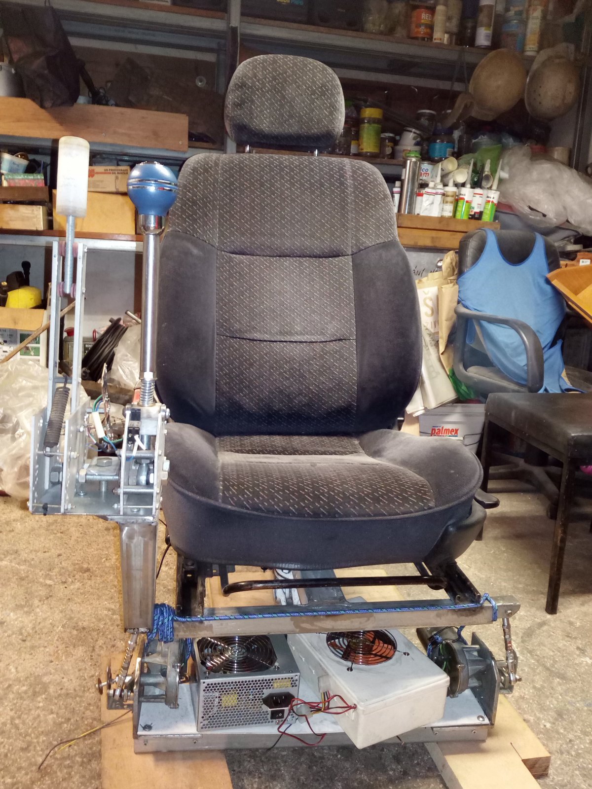

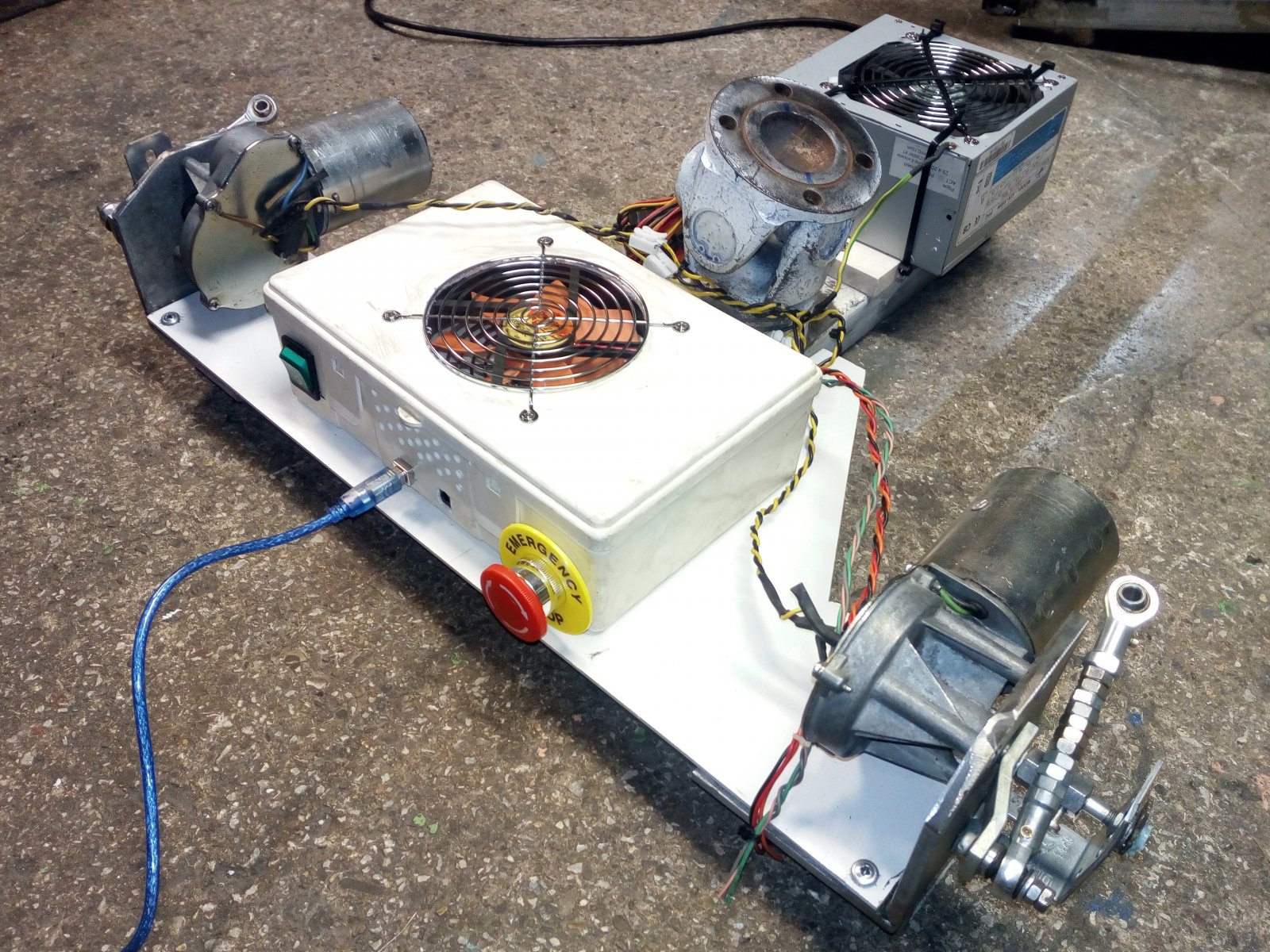

    I started a simulator procject with 2 DOF / Arduino / 12V DC wiper motors from czech car (Škoda Felicia).
    The car games (Dirt Rally, Dirt 4, Asseto Corsa, F1 2017, Project Cars 2)
    Will anyone please send me simtools plugins for these games?
    I will use one computer setup:
    CPU Intel I7 950 3GHz
    RAM 16 GB
    AMD Radeon R9 380 Series
    I use the Logitech G25 driver modified to 320mm and DIY sequential gearshift + hand brake taken from the rally cars....
    In the future, I want the simulator to complement the virtual reality of Oculus Rift.
    Motion platform:
    - the frame with cardan joint from truck Avia
    - seat from classic car

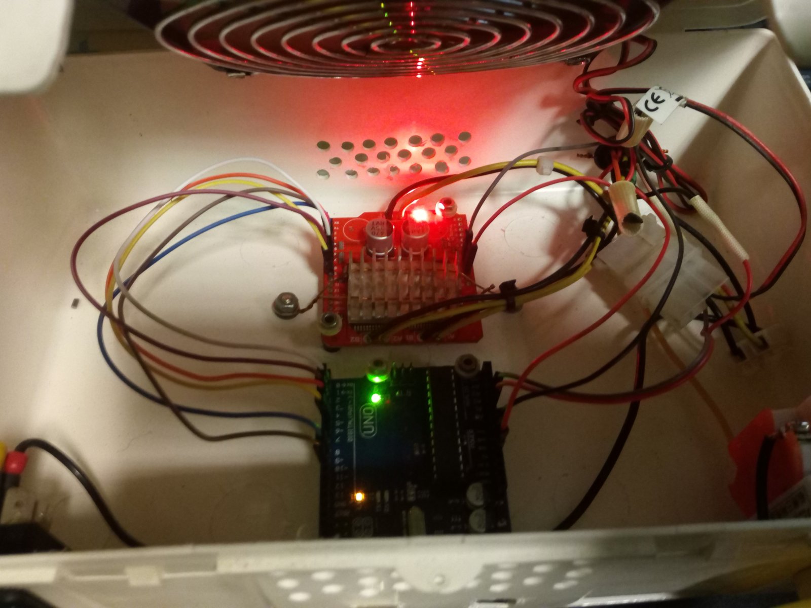

    - electronic:
    - Arduino UNO R3, ATmega328P
    - Arduino Monster 30A motor shield VNH2SP30
