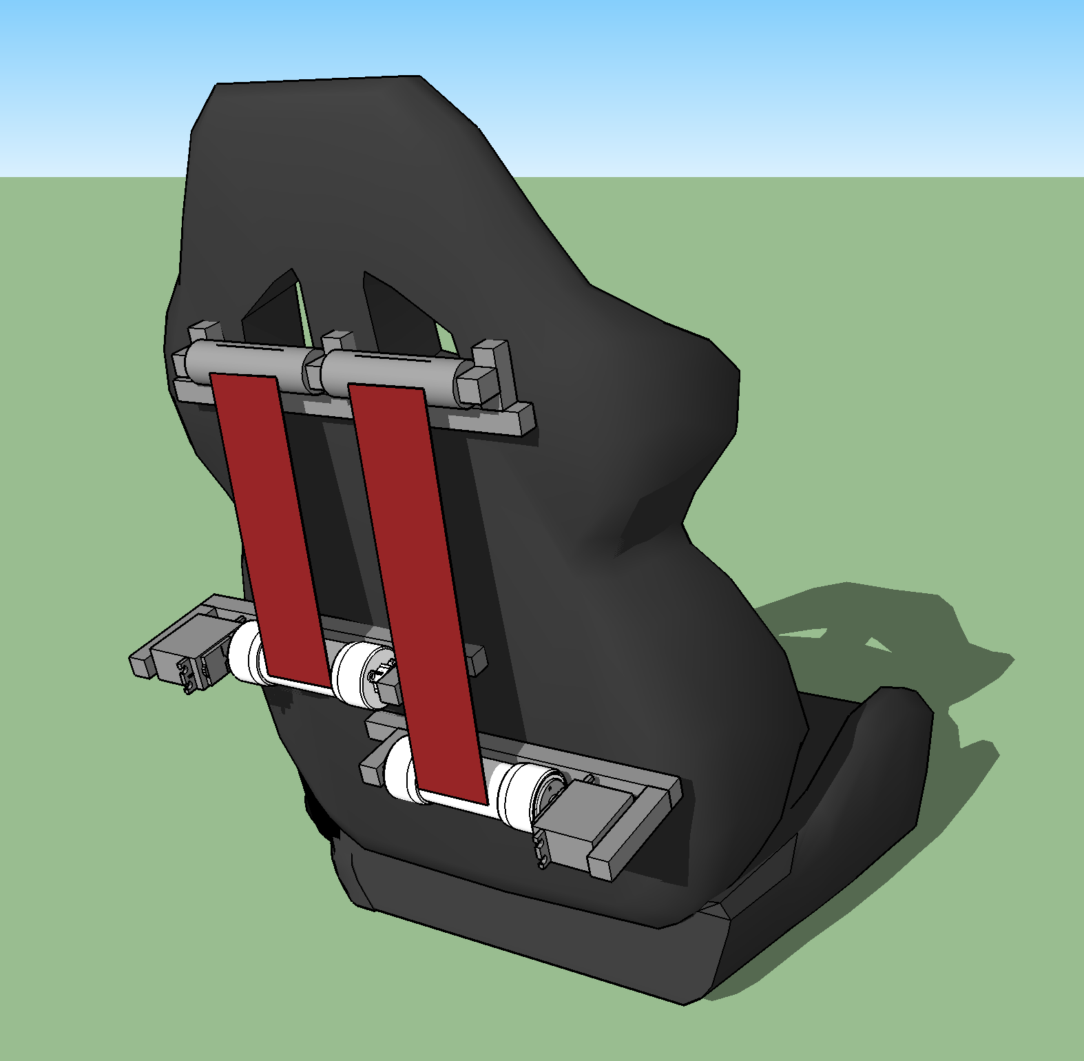

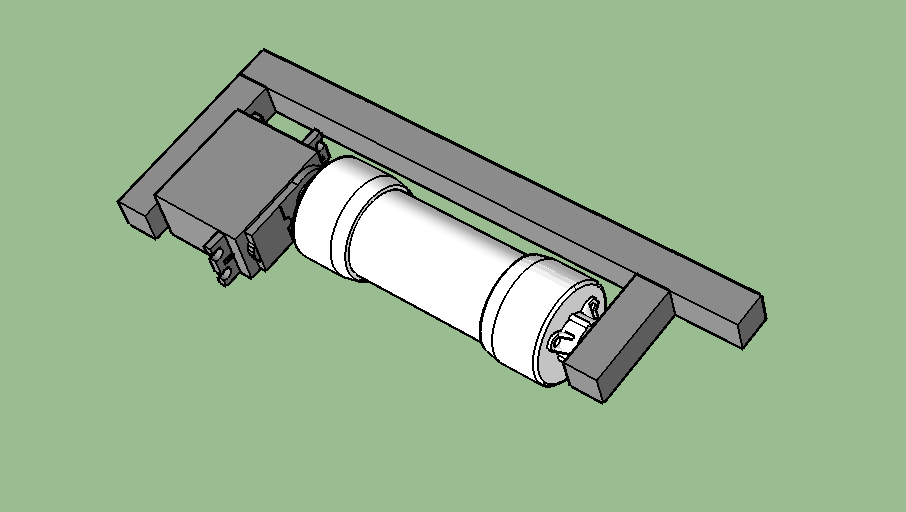

    Some more background on my current setup. I have built a simple box that my seat sits on that I can move around relatively easily because I don't have a dedicated space for my rig. I have a system of turnbuckles that connect my seat box to my pedal box so I can move them around when needed. Because of this I want the belt mechanisms to be attached to the chair itself so I can:
    1) Move the system easily with my seat
    2) Keep the belt size the same even when I change the seat angle - I use the seat to fly DCS(upright) and drive iRacing (reclined). If the belts are attached to the back of the seat the belt tension will always be the same.
    My plan is to use off-the-shelf 2020 aluminum and PVC for the mechanisms. In doing some simple 3D modeling I discovered that each belt mechanism will be too wide to sit side by side. The current design is to put one slightly higher than the other as shown below.
    One thought - if I can make the 2" PVC caps shorter by cutting them and still get positive connection between the caps and the pipe I might be able to put the two mechanisms back to back and attach the inside ends to opposite sides of the center 2020 post. I will have to get some parts and take accurate dimensions from my chair.
    Any thoughts or advice greatly appreciated!
    Thanks,
    Mars

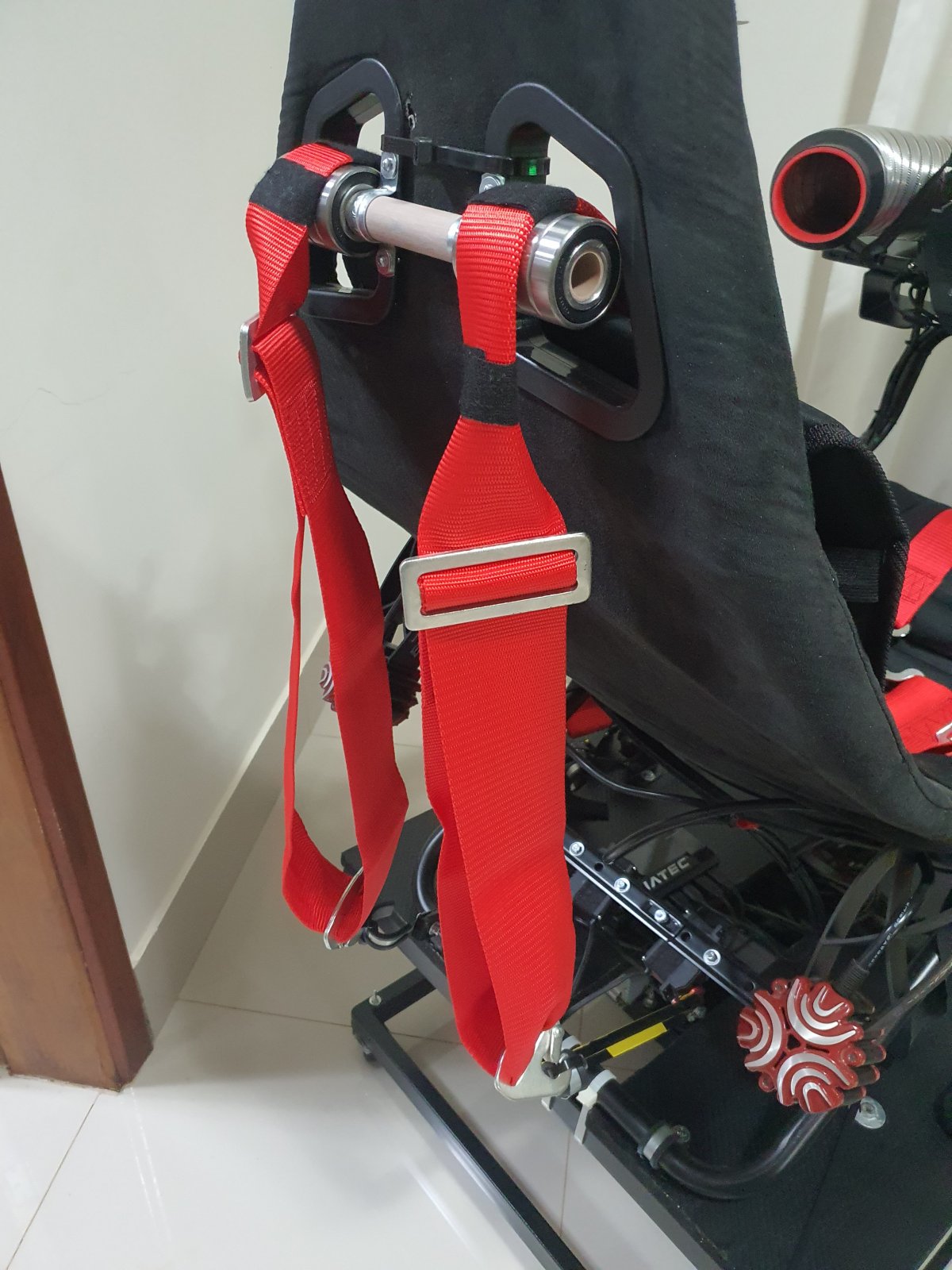

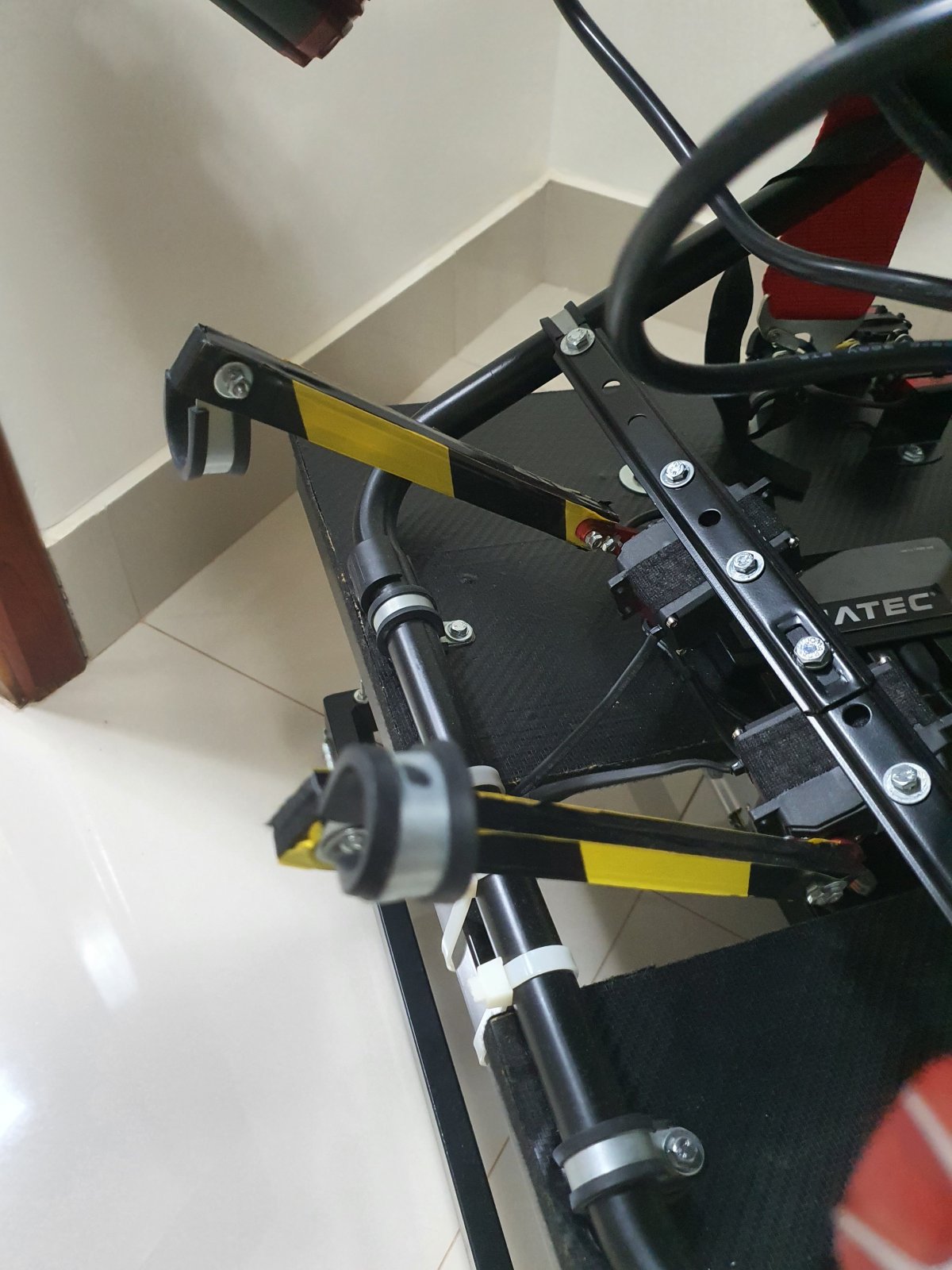

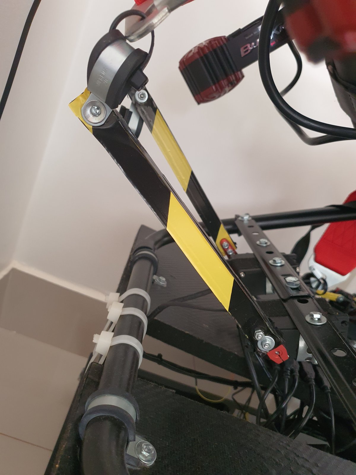

    In my setup i use rods. The response time with the rods appeared to me to be faster than the system like yours. Besides that with the rods I can use the 180 degree servos.

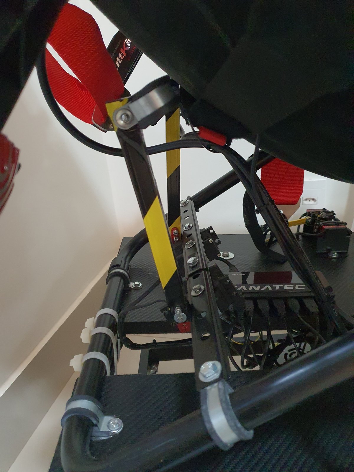

    If I understand your system correctly the yellow and black rods swing with the servo arms. How long are the rods, how much motion do you get at the end of the rods (length of throw), and what size servos are you using? When the servos move, how many degrees do they swing through? Is the full 180º available?

    Yes the yellow and black rods are swing with the servo arms. The rods are 26 cm. The angle of movement of the servos will depend on the size of the rod. In my case it does not exceed 70 degrees. Below is the link to a test I did. I use 60kg servos. You also have to be careful to make a smooth roll system on the top of the seat so as not to lose yield. I used a set of bearings. Yhe photos I have here are from when I was assembling the system, the belt was not yet adjusted.
    YouTube video:

    1) If your servo arms are 26cm long and swing through 70º your belt movement should be ±30cm. In your video it looks like you are getting more like 5-7cm. Is this because the motion in the video is smaller due to the type of test you are doing? When you are using the system what do you estimate the maximum belt pull length you need to get a good feeling from the belts?
    2) Do you have a spring in your system that gives if the servos get to stall? It seems like some systems have a spring and others do not and I am trying to decide whether I need one or not.
    3) How are you powering your servos? I am thinking I will get a 7.5V power supply.
    I plan to use 60kg servos as you have. I also plan to build a simple roller system at the top to keep friction to a minimum.

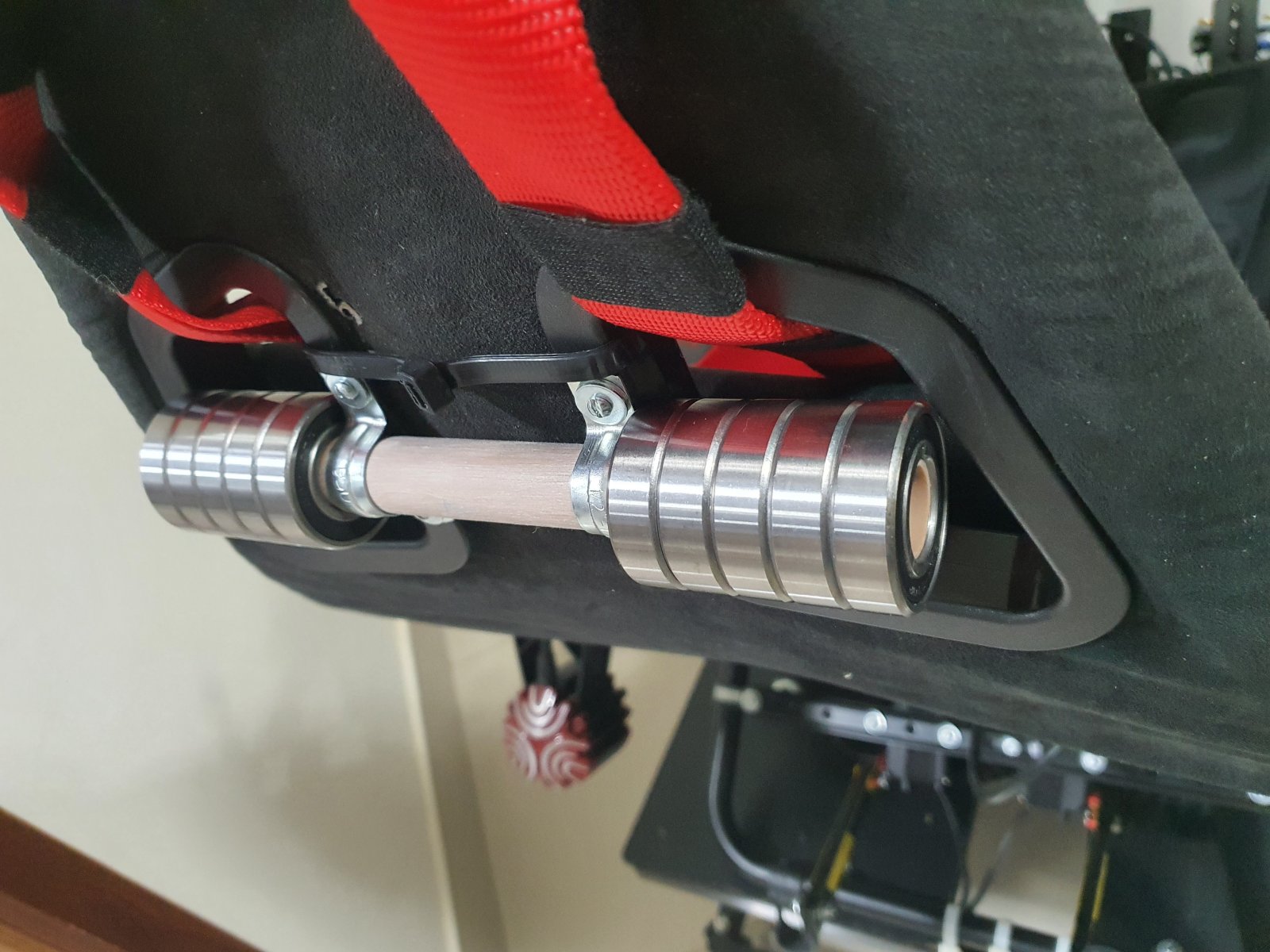

  9. EduardoMoreira
    EduardoMoreira New Member
    Jul 5, 2016
    26
    182Coins
    +19 / 1 / -0
    Mars that's the intensity I use. The human body is not malleable like the pillow. What looks a little like a pillow is not the same on the body. The feeling of tightness is very good, but if I want I can still increase it, because the intensity of the effect is 74%. Regarding the stall, in the regulation that I'm using the servo makes a maximum force of 42kg, which avoids the stall. I use the maximum voltage allowed by my servos, 7.4V
  10. mars
    mars New Member Gold Contributor
    Jan 13, 2011
    27
    Architect
    Northern California
    195Coins
    +30 / 0 / -0
    Thanks Eduardo - your video and photos are very helpful. I think I will continue down the path of using rollers and plan for a belt tension length of ±5-7cm. I can imagine if the belts start off "snug" then this amount of pull will feel quite realistic and plenty strong to relay the feel of the car through the belts. If my system ends up feeling too slow I will switch over to a system with arms like yours. The only reason I will continue with the drums is that it seems that it will be easier to move my seat without damaging the system if it has rollers vs. arms. This is a requirement that is unique to my rig as I do not have a permanent home for my rig...
    How do you regulate the force of your servos? I plan to use my Arduino Uno for the signal and a 7.4V power source for the servo power. Is there an easy way to regulate the servo force?
    Thanks and I will continue to post updates here as I move forward.
    Mars

    Mars when you are not playing, you can manually move the rods so that they are very close to your seat, preventing anyone from bumping into them. The amount of movement of the rods you can adjust in the simtools

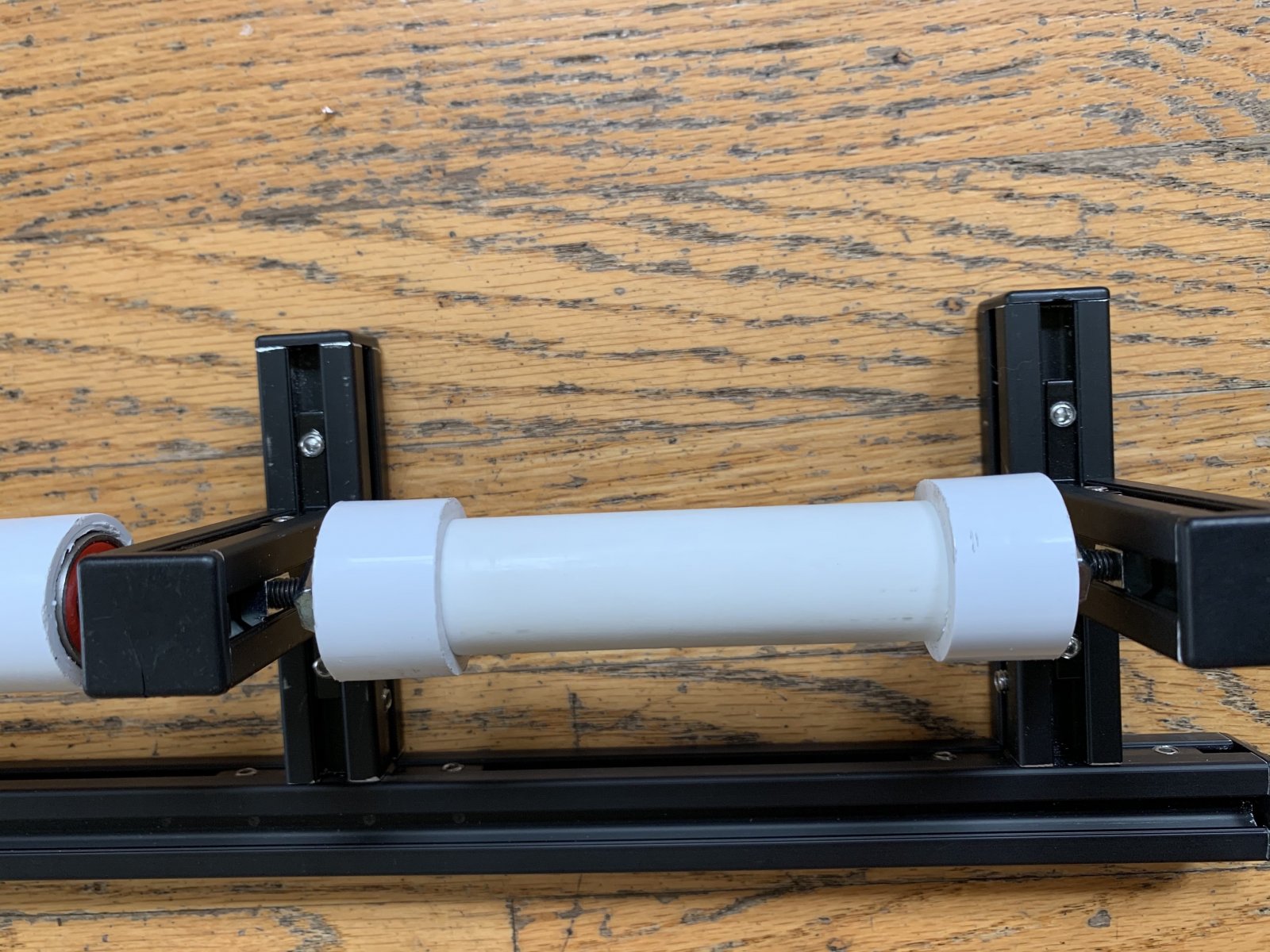

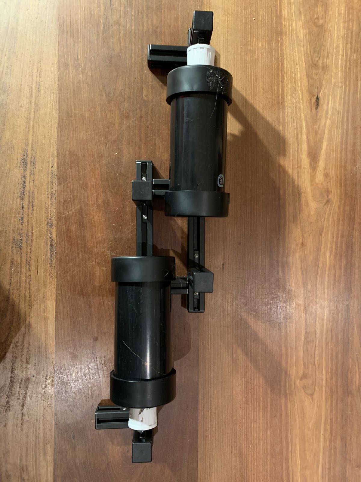

    Progress! I have costructed the top rollers from 2020, PVC, and skateboard bearings. Now I need to attach it to my seat and build the lower roller mechanisms.

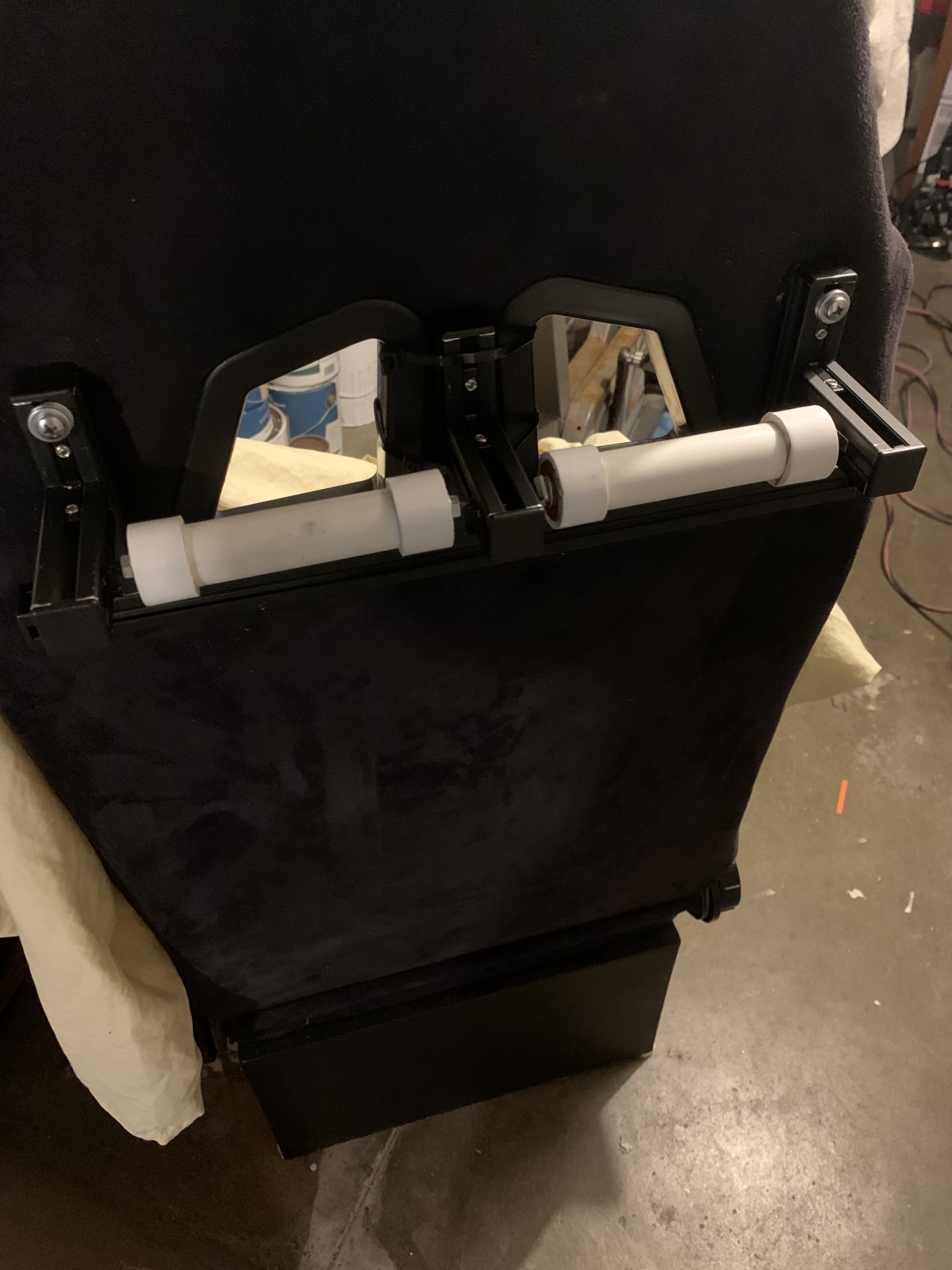

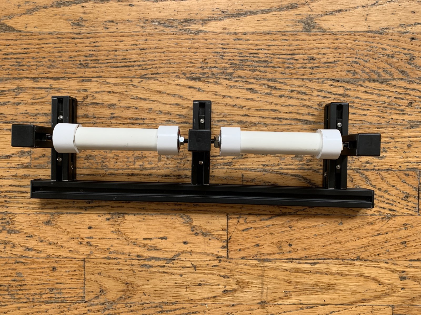

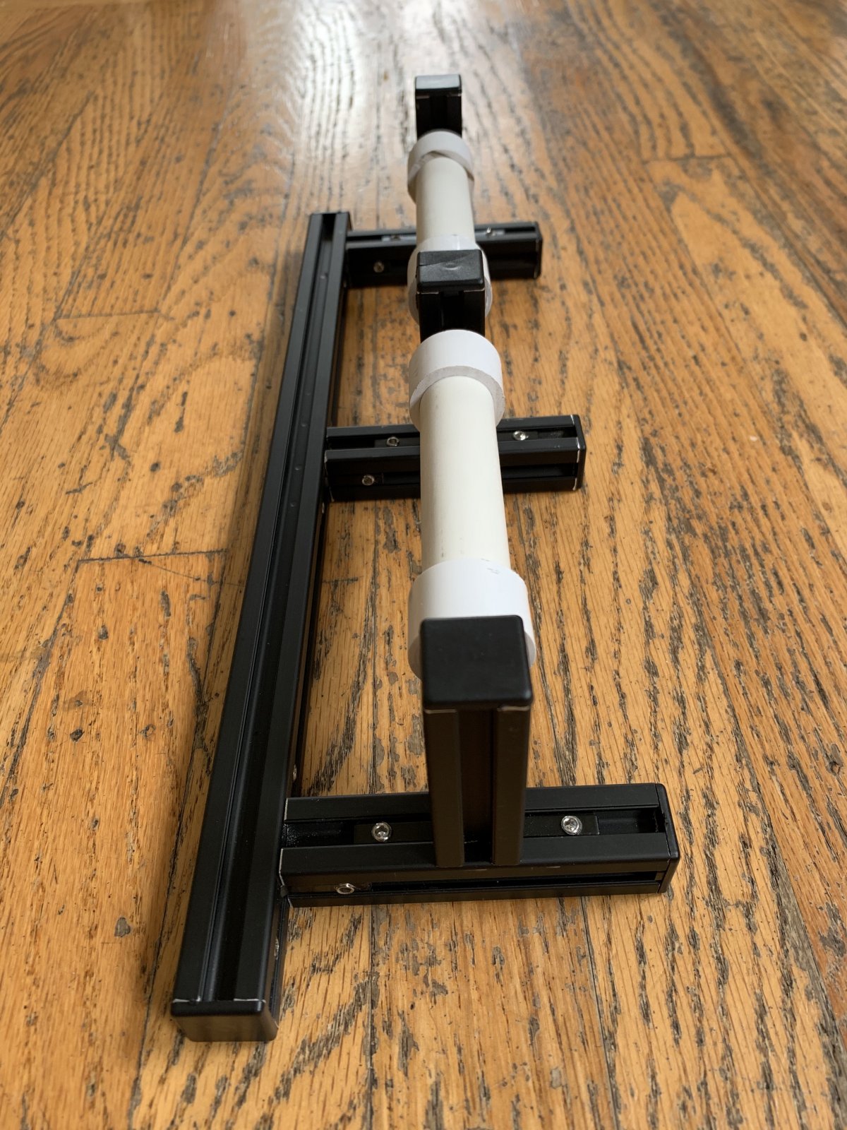

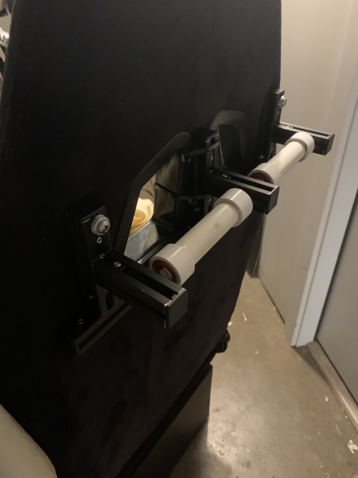

    More progress!

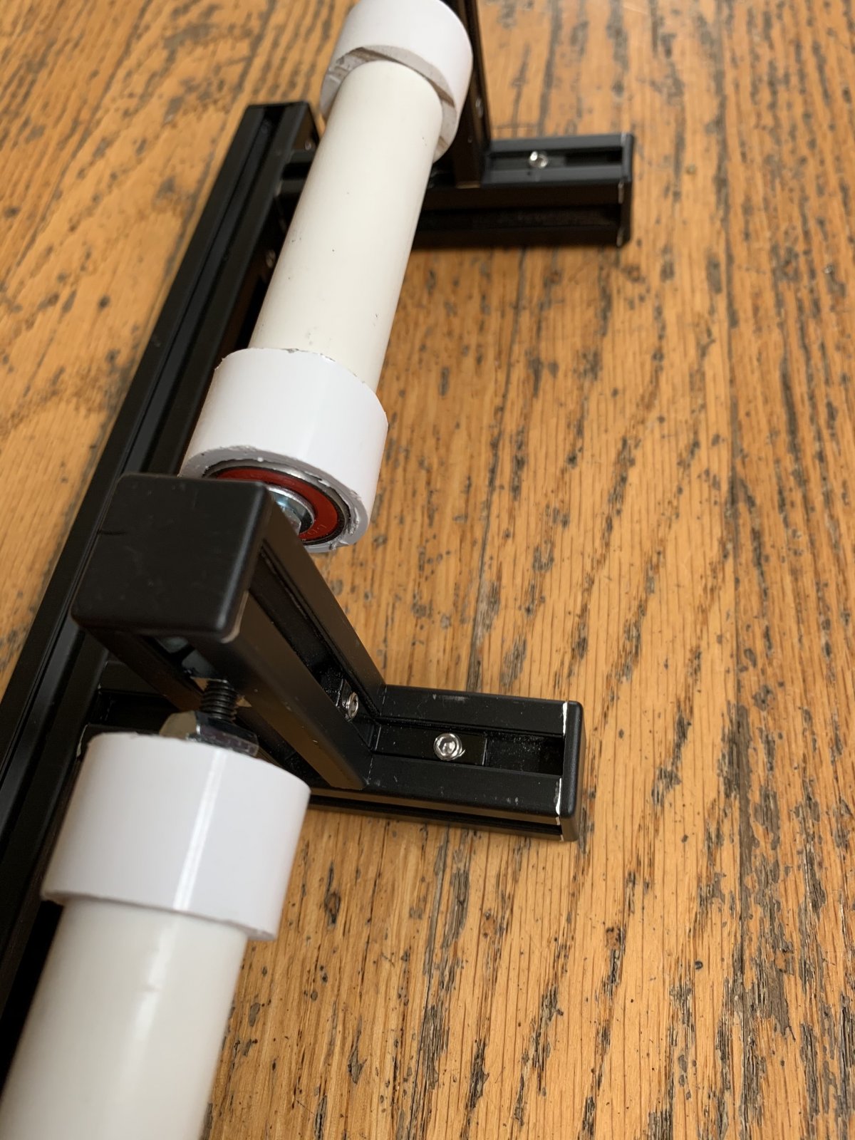

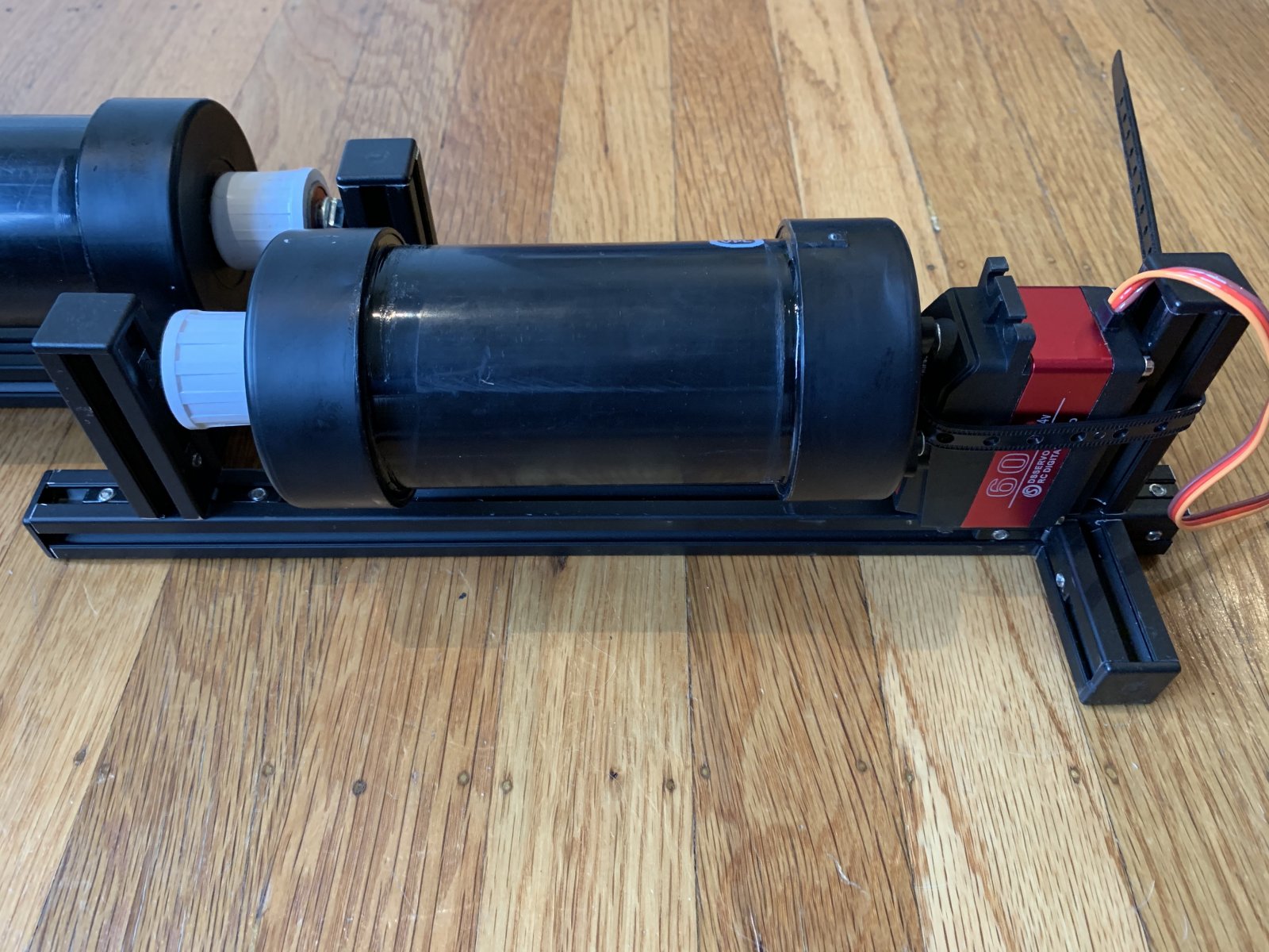

    my intent was to make all of the mechanisms with readily available parts as I do not have a 3D printer. The frames are 2020 aluminum extrusion and the rollers are made from PVC and ABS pipe.
    here is the frame for the large rollers that will be actuated by the servos:
    The servo horn will be screwed to the end of the ABS roller and fixed to the 2020 frame with a plate and zip ties.
    and here are my top rollers attached to the back of my racing seat:
    I am looking forward to getting my servos and belts this week!
    Mars

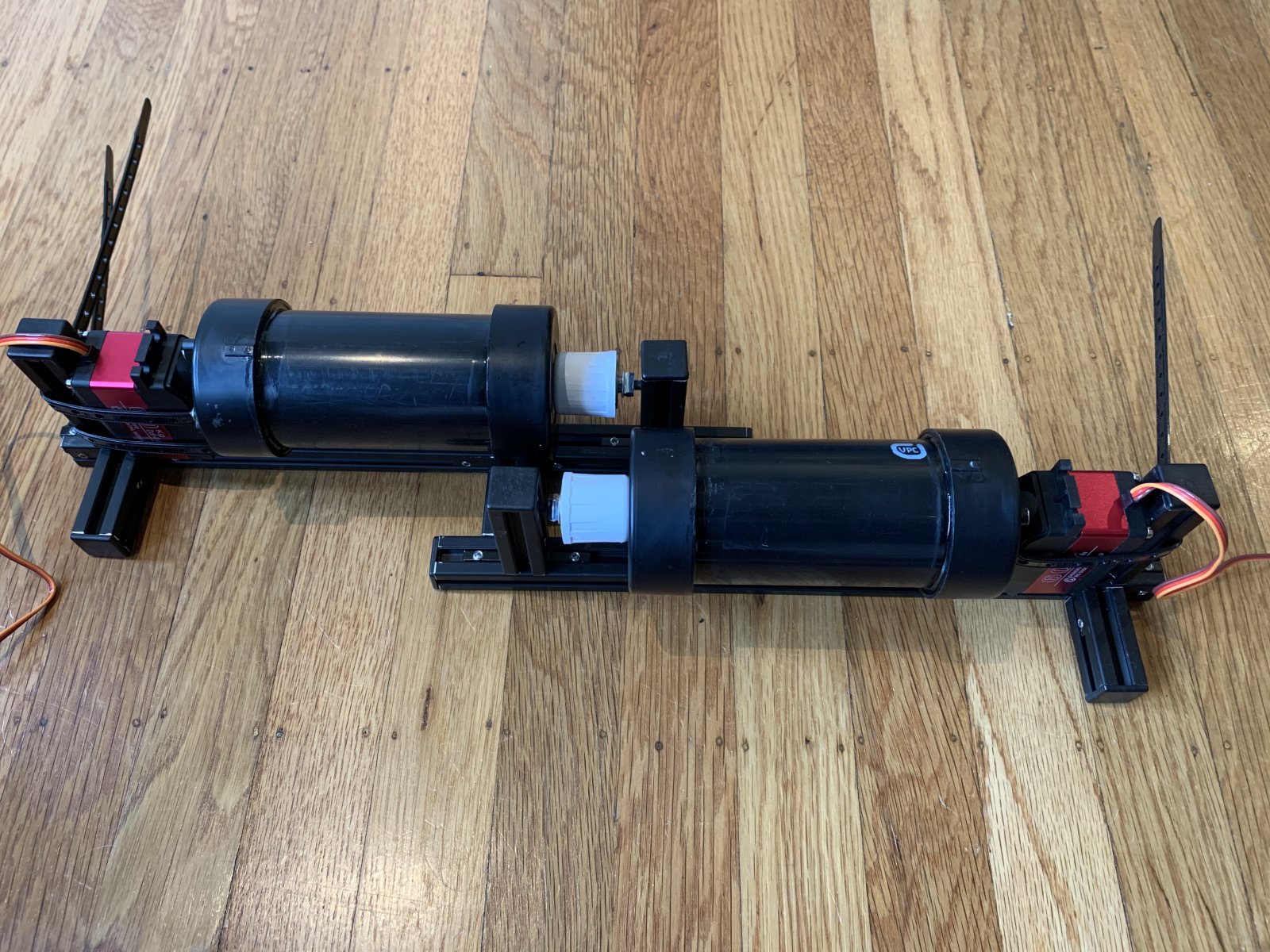

    Servos arrived but I still need my 2020 metal plates to permanently secure them to the frame. I used zip ties for testing and everything seems to work well.
    Here are the lower rollers with the servos temporarily installed:
    Now to mount the frame to my seat and attach the belts.
