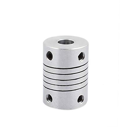

    I have one small final problem to fix now and that is the motor to pot connectors which I have been using reinforced rubber fuel hose and hose clamps which can occasionally
    slip a small amount which is enough to make one side level not equal to the other at it's home position, so I am replacing the hoses with some flexible anti-backlash connectors
    which should remedy that little problem.
