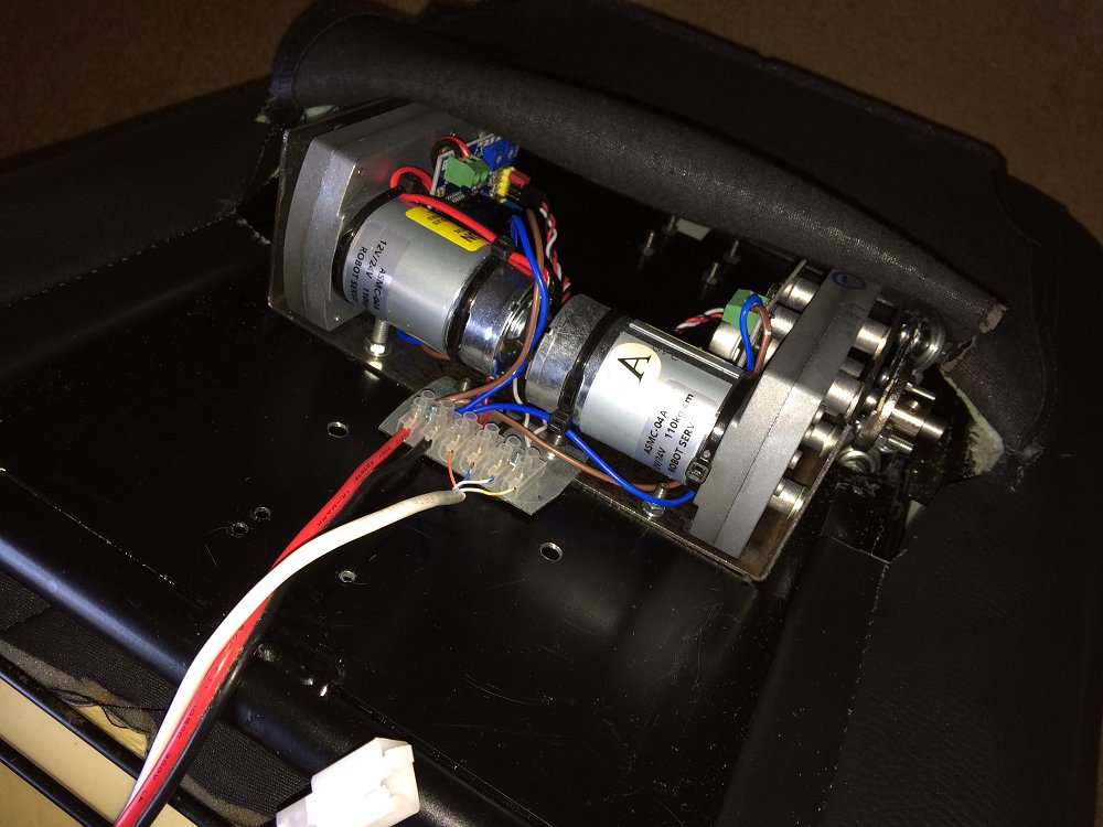

    Secret Hidden 007 G-Seat Finished (Well, you know...)
    I finished the g-seat this weekend. By that I mean it is all wired up, all 4 servos are working and under control of Arduino and responding to game telemetry. I'm still tuning a bit - trying for example to get the surge flaps and heave flaps to give an even kind of pressure when on a roll. Mechanically I also intend to reposition the surge flaps at some point as they don't come up high enough, so despite a good pressure in my back it isn't as convincing as I think it could be. I'll make the surge flaps extend higher and will see if I can get a bend in there to allow them to extend more to the edges of the seat. When I started this there were a few scenarios I hoped the seat could provide a believable physical feedback for:
    1. Landings - I wanted to feel the difference between a light or heavy touchdown. In fact I wanted heavy landings to be off-putting to encourage me to fly better
    2. Turbulence - I wanted to feel it if there was turbulence
    3. G forces on take off, banking and strong acceleration or climbs
    I would say that I am getting some of all of this now and I hope for more realistic sensations as I tune it better. I dialled up the turbulence last night and was really pleased to see the effect of being buffeted about, so much so that I had to quit the game when I could smell a servo overheating. That's another little improvement - I've just ordered a pair of these for the heave motors. The motors have a vent slot as they're designed to spin fast and can get hot, but when used in a servo this built in cooling mechanism can't take effect. One good thing about this servo model is that if I do burn out a motor I can replace it for about £8 as they are standard 550 size. In fact I plan to experiment with swapping the motors to see if I can get better performance. Something like this for example.
    Time for pictures:

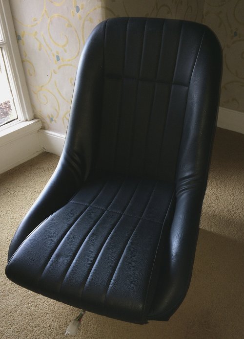

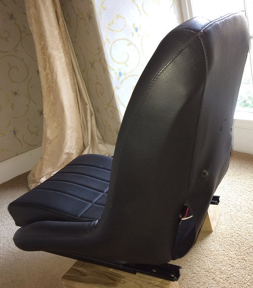

    As a reminder this is how it looks externally (bought for £70 off ebay):

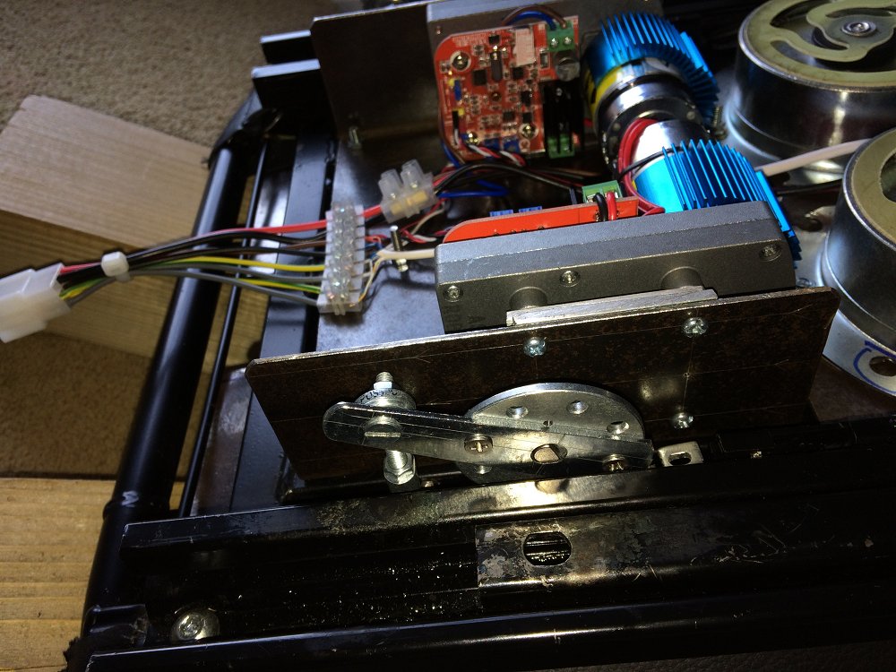

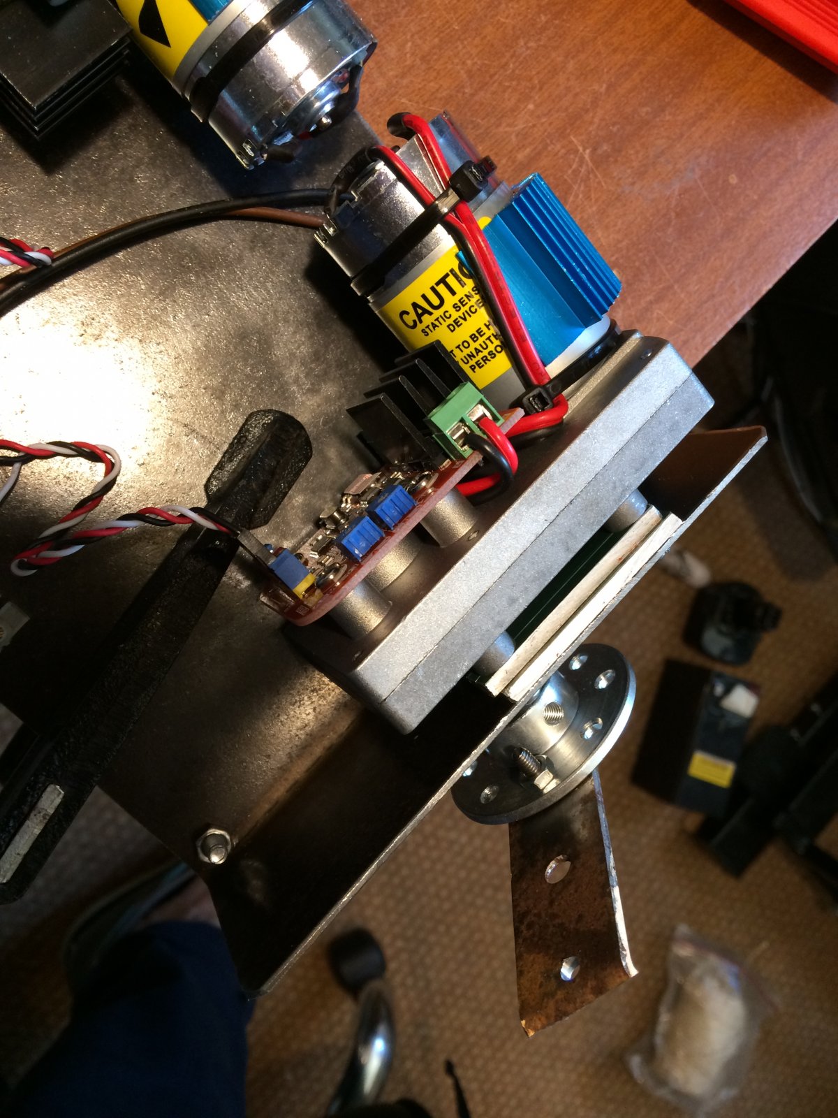

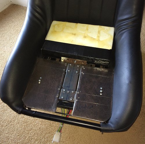

    Underneath I now have 260kgcm servos powering the heave flaps attached to some folded 2mm steel plate that just spans the main crossbars of the seat base. The blue finned heat sinks are about to be replaced by fan assisted heat sinks as the base gets pretty warm if you work it hard. Reassuringly its the motors that get hottest not the circuit board as motors are cheap to replace. There's very little room to spare with the servo arm and lever. I had to shim the servo back precisely to give the arm space and used countersunk screw heads to minimise the space it used. I also had to cut away the seat's handle and mechanism for adjusting forward position on the seat rails.
    The servos came with strong servo arms that I very much recommend. I tried some other flange couplings that took an 8mm shaft but they just couldn't cope with the forces and slipped. The arms have a D shaped slot so can't slip.
    Here's the back. I constructed the surge flap assembly attached to a steel plate before I attached it to the steel plate seat back, using the extra plate as a template for drilling holes through the seat back. The extra plate also provided reinforcement as the seat back was quite flexible. The depth of the motors and cage is about 65mm so hides quite neatly under the back flap of vinyl. These servos are 110kgcm and feel quite adequate for the job.
    Lifting off the seat cushion now. I had to cut up the seat cushion into two parts. The rear is not lifted by flaps so you feel the lift through your thighs only. I had to cut into the front part too, removing a 50mm wide channel from the top and bottom, to give it as much flex as possible rather than have it resisting the surge flaps. There's a stop plate on the picture below to prevent the rear seat base from sliding forwarding and getting lifted by the surge flaps.
    In the end I had about 4.5cm of leverage on the surge flaps which produced around 7.5cm of lift at the very edges. I did a lot of tweaking of the limits of movement, eventually setting the neutral position for both heave and surge flaps to about 20% extension so that there was a more immediate feeling when they acted rather than them just using up slack.
    I was pleased with the addition of the 2.8mm 9-way car mini connector kit as I had to remove and replace the seat so many times during the build. For wiring I'm going with 1.5mm 2 core for the 24v (only about 0.5volt drop over 2m) and some 6 core alarm wire for the 4 servos+grnd+5v.

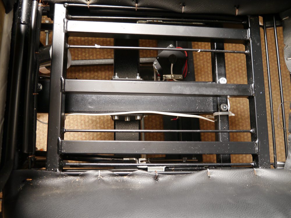

    Step 1: Choosing a suitable seat
    I've been asked how to get a seat like the one I used to build this. I got very lucky there as I wasn't planning to build a G seat when I bought this cheap seat off ebay. At the time I was frustrated I couldn't get a cheap JEGS seat in the UK, so bought a second hand Cobra Classic seat that had been in a Triumph Spitfire for £70. I see one for sale here
    http://www.minispares-online.co.uk/...st-basketweave-classic-seat-for-classic-mini/
    The important features (for this build) are as follows
    1. The seat base was flat made of cross sections of steel about 2cm square as per the picture. I could easily bolt the flaps to the top and the servo cage underneath
    2. The cushion lifted off with some simple unclipping.
    3. The cushion was a single piece of dense foam that I cut in half (front and back) then I cut into the front half down the middle to allow it to flex on each side. All the pieces then fitted back into the vinyl cover
    4. The seatback was accessed from the front by removing some wire twists that held the vinyl to some steel rods, so I could get under the vinyl and slide surge flaps up
    5. The rear of the seat had very easy access. There was a flap held by a clip that I could simply release
    Here's the base mounted on my 3DOF. The previous posts show it with seat cushion on.
    If you want to build one of these, then starting with exactly this seat is obviously a safe bet. But if you can't get hold of one of these, I don't know what else would be suitable.
    Does anyone with experience of vehicle seats have any ideas?

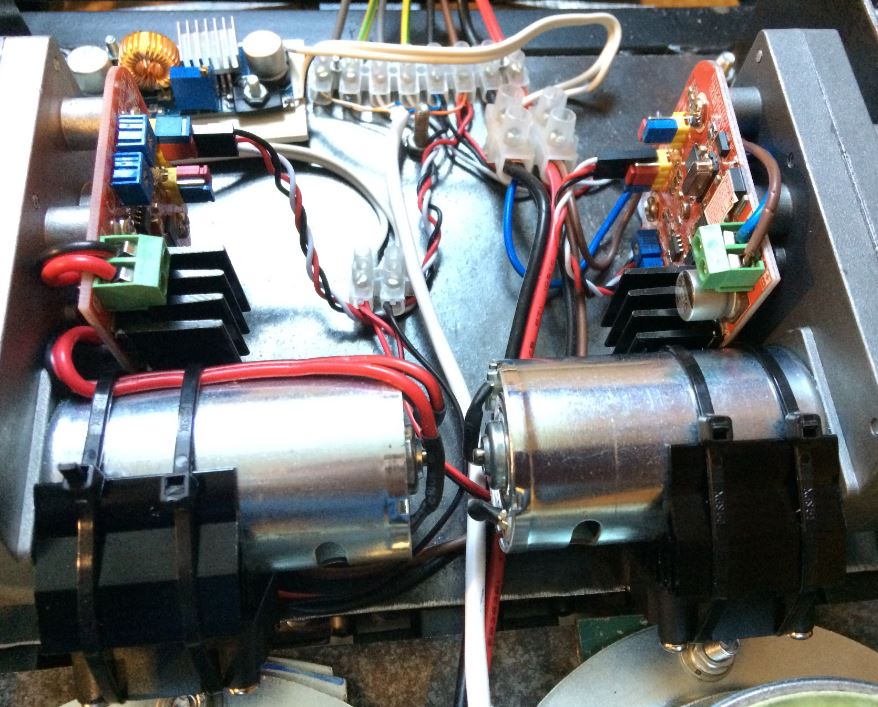

    Solving the hot motor issue
    These heave motors are working hard given their size but I think I've solved any overheating risk by attaching one of these to each of them.
    This is how it now looks
    I had the strangest experience when I first strapped these things on. They wouldn't work. After trying everything, checking voltages etc etc I finally worked out that the strong magnets in the servo motors were preventing the tiny fan motors from working. I found that by rotating the fan motors around to a particular place on the servo I could get them to function.
    For power, they use 5v but rather than power them off the Arduino I use a **very** cheap buck converter (top left of my picture, seriously it was £1.60 inc. postage) to take a feed off the 24v power and reduce it to 5v. This means that that the fans stop when the servos are powered off rather than going constantly via the USB power.
