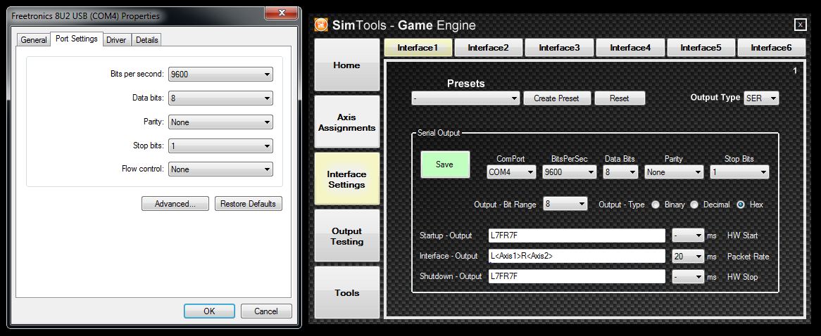

    Hi guys, Figured i'd post in here because it relates directly to arduino to Simtools with RC servos (Aka, following your thread!)
    I've used the script from the wiki/download (there's a typo in the one on the front page)
    I've installed SimTools, uploaded the correct config to Arduino, and I've followed the SimTools quickstart guide at http://www.xsimulator.net/simtools-quickstart/ and I'm at the "set the interface settings" and then do the "output testing"
    I've followed the pictures on the Quickstart guide exactly, and it failed.
    Ive set the BitsPerSec to 9600 (same as it's set in Windows and in the Arduino script) and it's still not working.
    When the "output - type" is set to Hex (as per the quickstart guide) the servo will reset to 0 position, but absolutely no movement when fiddle with stuff on output testing window.
    When the "output - type" is set to Decimal it moves one servo to 90 degrees, then halts there. No movement with the output testing. Turning off "output testing' resets the servo back to 0 position.
    When the "output - type" is set to Decimal it moves one servo to 180 degrees, then halts there but continues to tick as it wants to move more.
    Obviously I've done something wrong. I've had both servo's moving using other scripts I found on the Arduino site so they are both functioning on the ports they are connected too.
    Does the Output Testing window not work with Arduino/servos? I move the sliders both directions, and nothing happens
    Help?

    Can you post some screen shots of all your settings, I am pretty sure it should be set to serial, 9600, 8 bit.

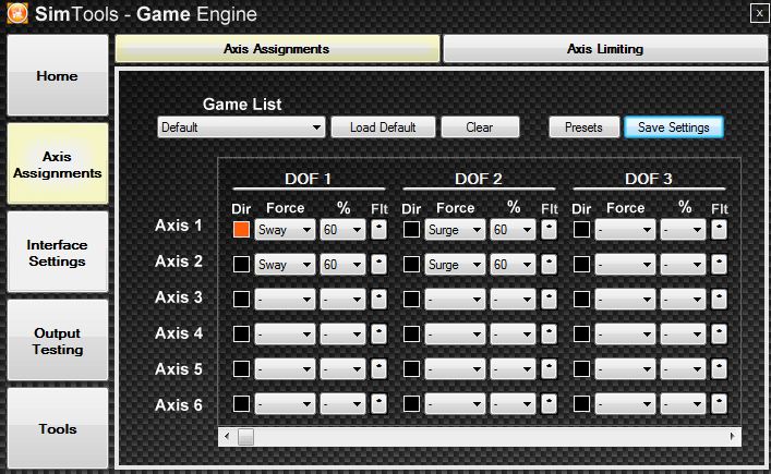

    And your axis assignments?
    The settings looks right to me, other than the startup and shutdown which I have never bothered with. @eaorobbie can you advise further?

    I just selected the Stock standard SimForceGT setting as per the quick guide?

    Success! I've had to fiddle a bit with those settings, but I've got it working, and I even did 2 laps of Live for Speed :) so I'm going to call that a success.
    Unfortunately, if I drive the motors with %100 Main Level in the Profile Editor on Game Manager, it seems to shit itself. I suspect its either attempting to do to much power, or I've got a faulty arduino. (To be fair, It's spent ~1-2 years sitting in a metal tin. It's possible I've broken a contact somewhere or even that my PC has a faulty USB port. I might pull out the laptop and connect it to that, but for now, huzzah for me. :p

    It would be worth posting your settings so there is a record for anyone else.
    As a starting point for this and other testing split the axis percentage to total 100%, normally testing starts at 20% for each DOF setting, doing one at a time until satisfied with the results.
