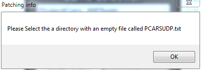

  6. SBDESIGN

    Cheers,Patching what? xbox one game?

    Sorry when I clicked patching I didn't realise the messages change. I made a bad assumption that it said find install.
    I have now done that, and now it does say GAME RUNNING
    But still nothing moving in game engine testing visual axis
    I'l try rebooting everything now I am a step closer. thank you!!!!!
    EDIT: tried rebooting, still nothing.
