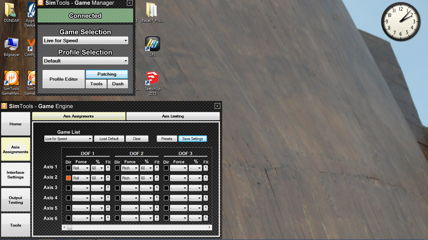

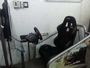

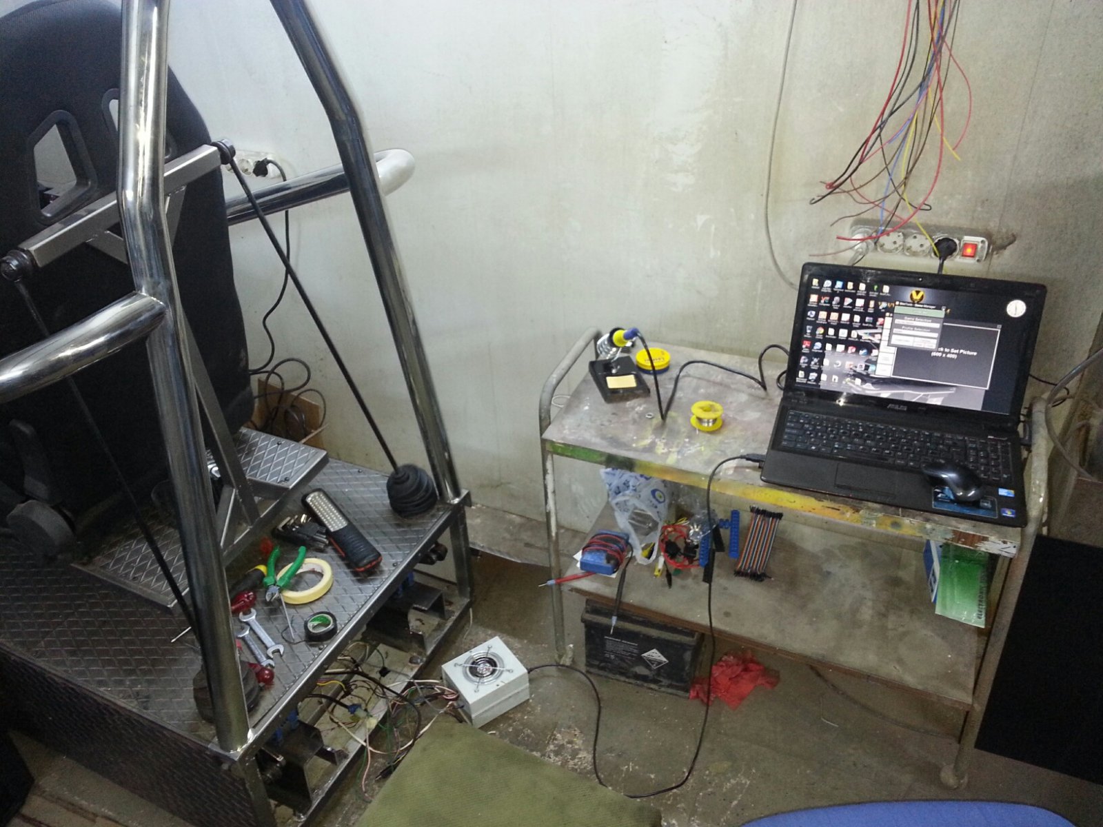

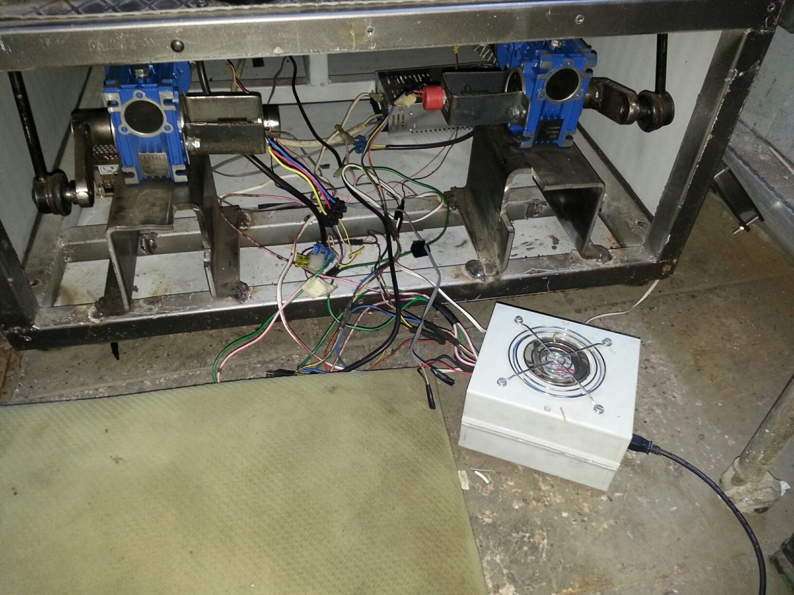

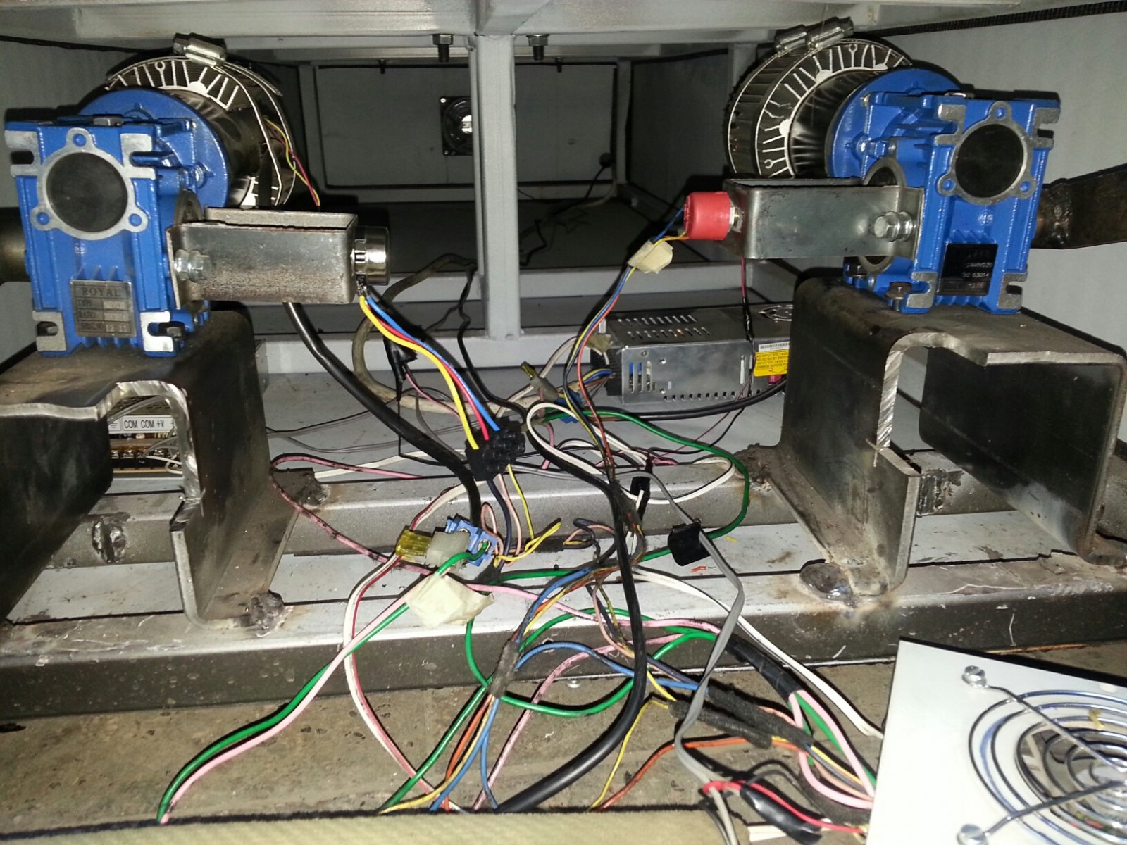

    Hi friends, moved the seat, I will use the LFS, but I have a coding error, unstable movements, help :)

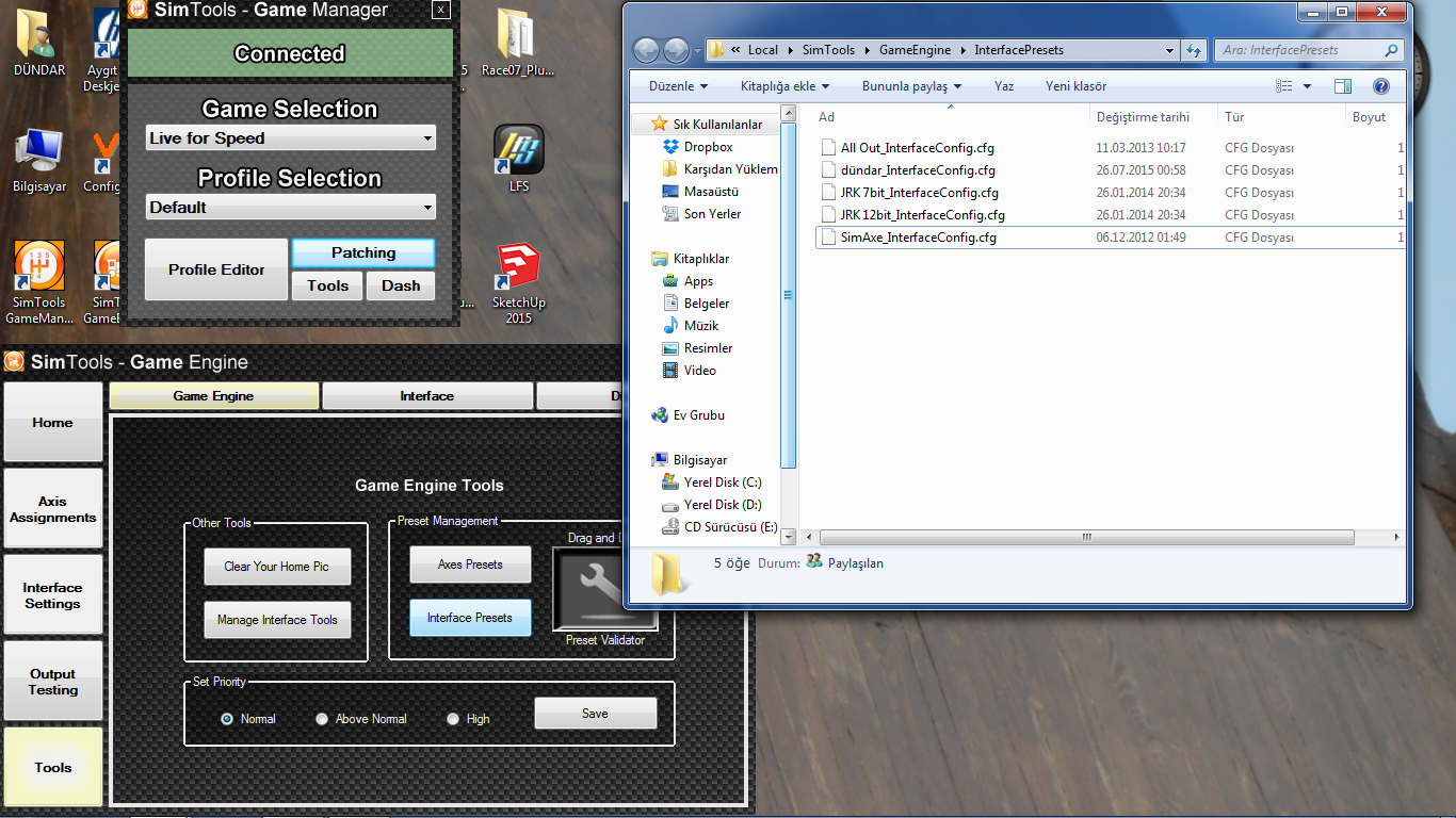

    hi friends, I guess I am having trouble in setting interface, you do not get the full results, you look at the settings on the timeview?

    I am not sure I understand what you mean, I think Google Translate lost something. Can you please post a picture of your setting with arrows to what you mean.

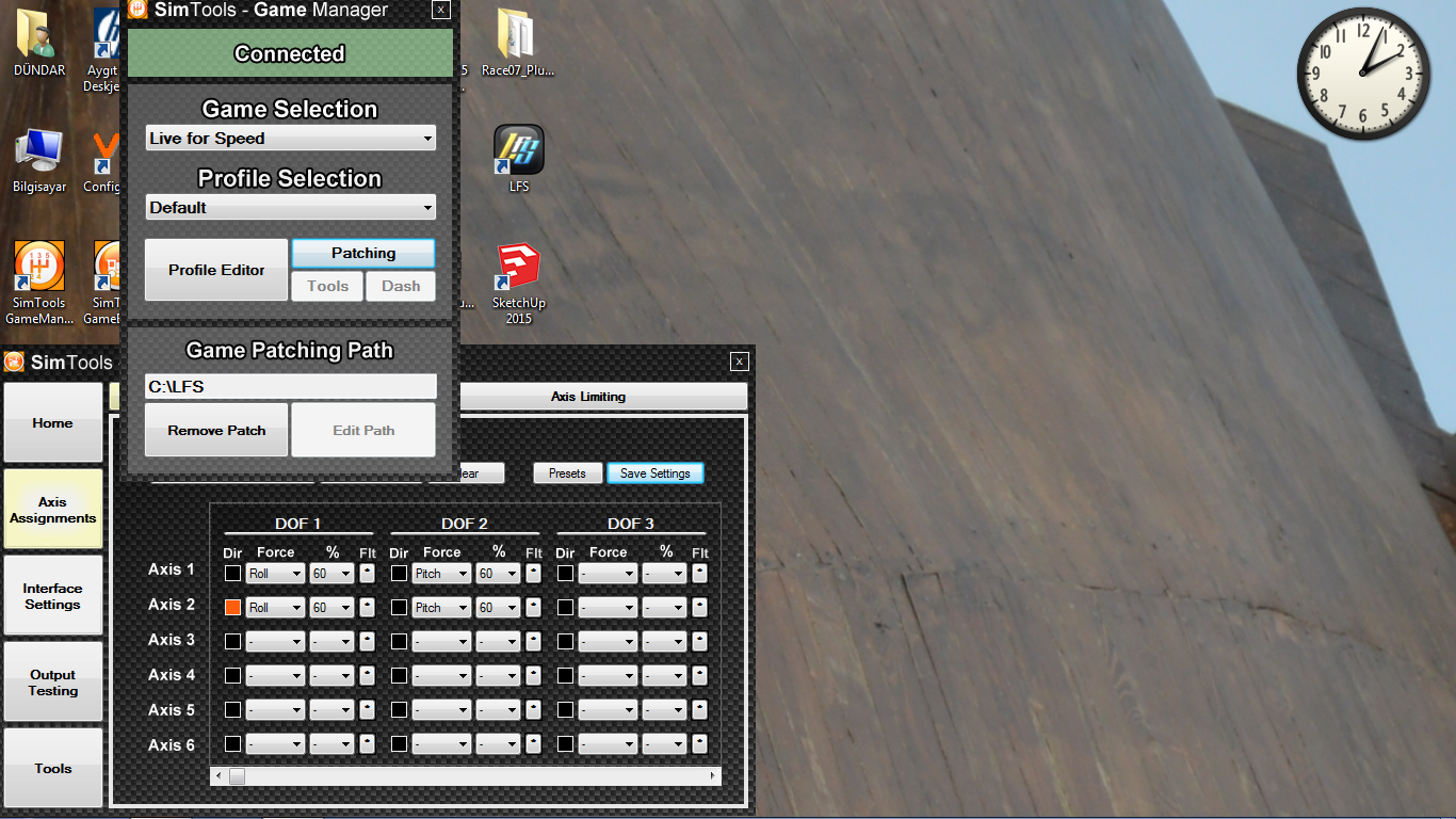

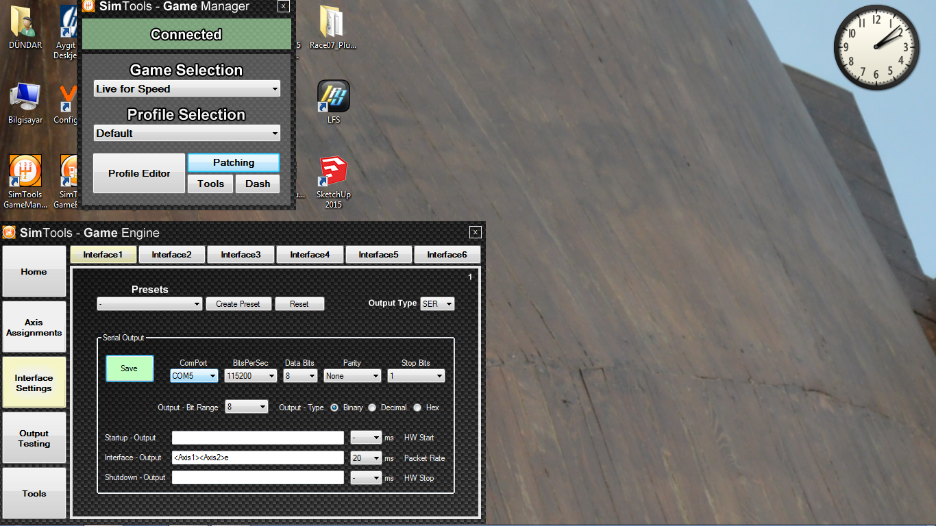

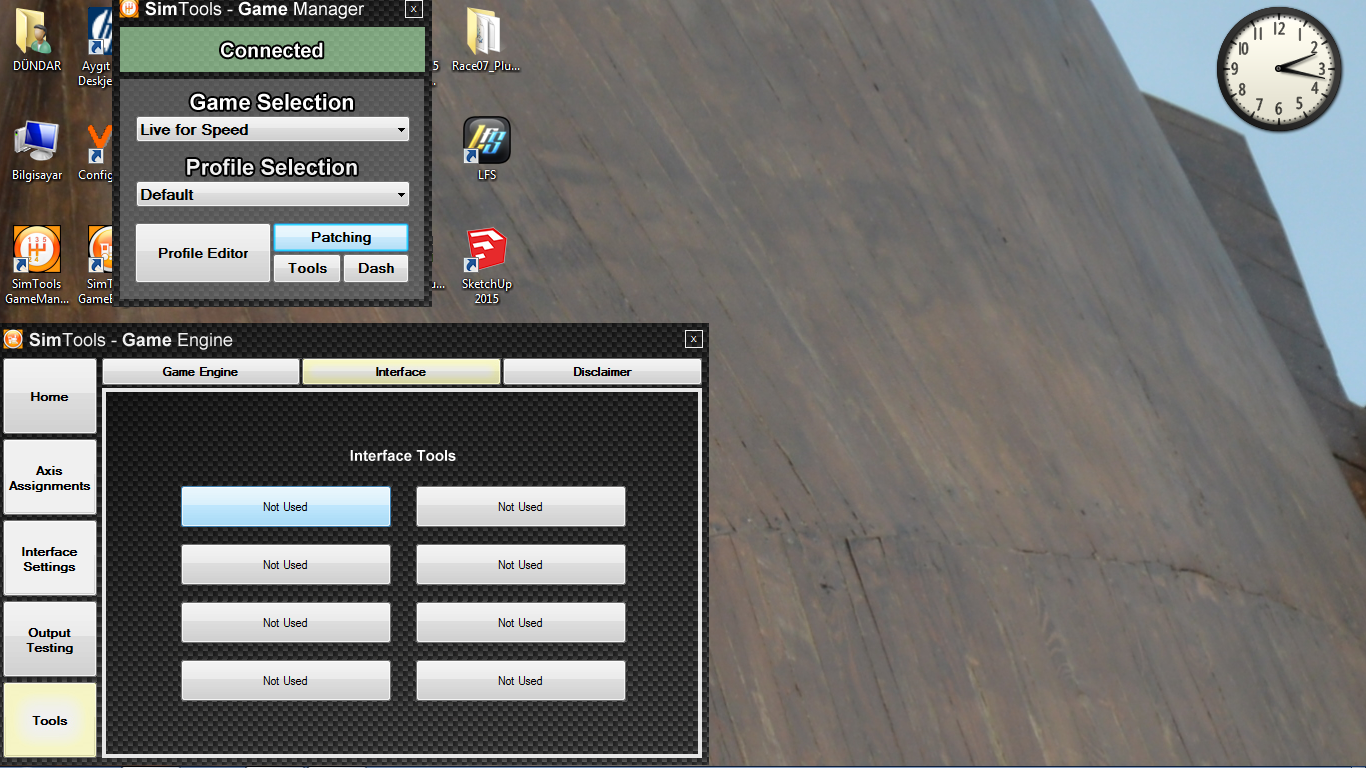

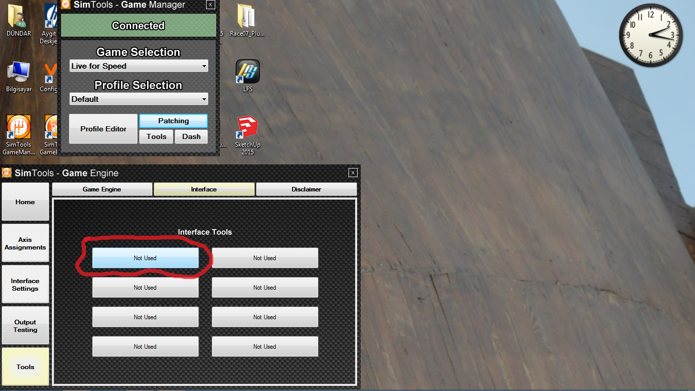

  19. bruce stephen
    Jun 7, 2015
    1,286
    general contractor
    michigan
    9,110Coins
    +1,238 / 9 / -0
    you dont need the interface tools area to be populated to use simtools. Are you doing flight or racing? pitch and roll are good for flight but if you are using it for racing start with surge and sway.
    as @noorbeast has suggested read here
    http://www.xsimulator.net/community/faq/simtools-settings-tips-and-tricks.18/category
    in photo with interface settings should be value of 10 for output bit range
    and on interface output the code is wrong it reads
    <axis1><axis2>e
    and should read
    [A<Axis1>][B<Axis2>][C<Axis3>]

    In the above picture, the area I marked gonna stay empty?
