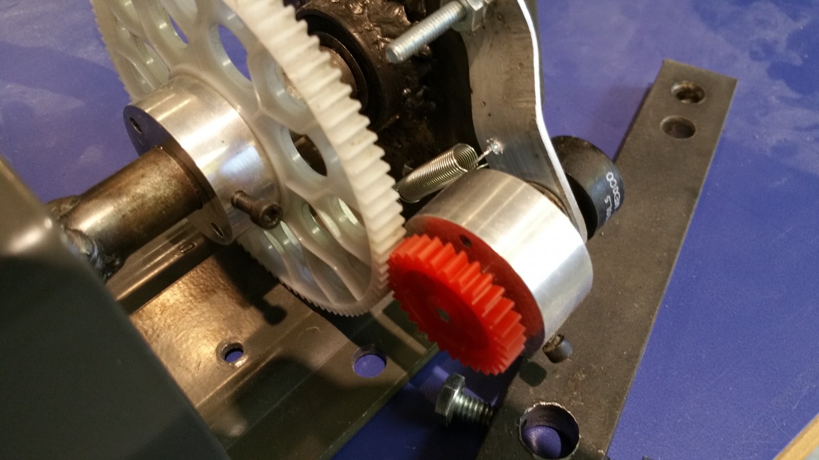

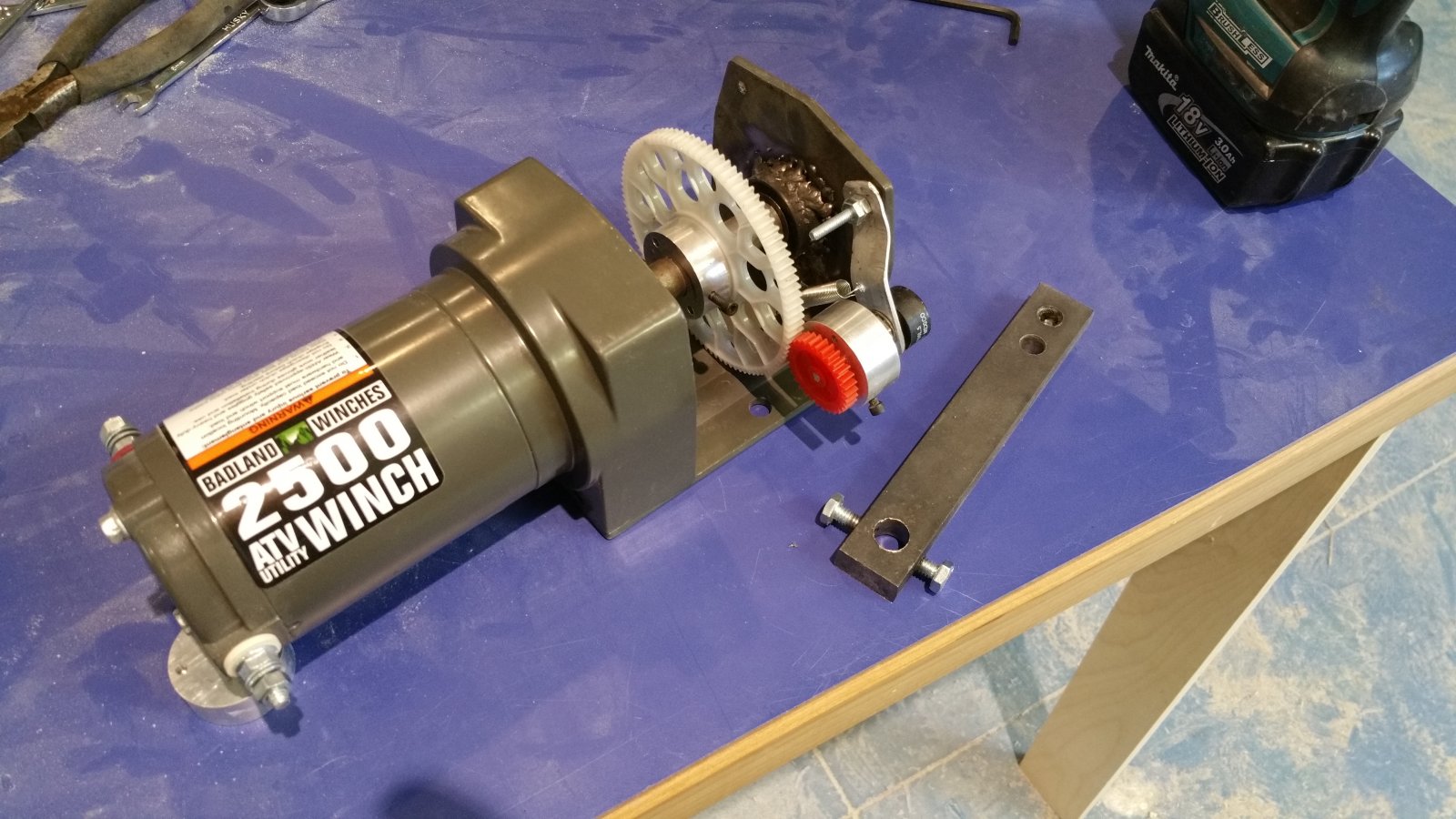

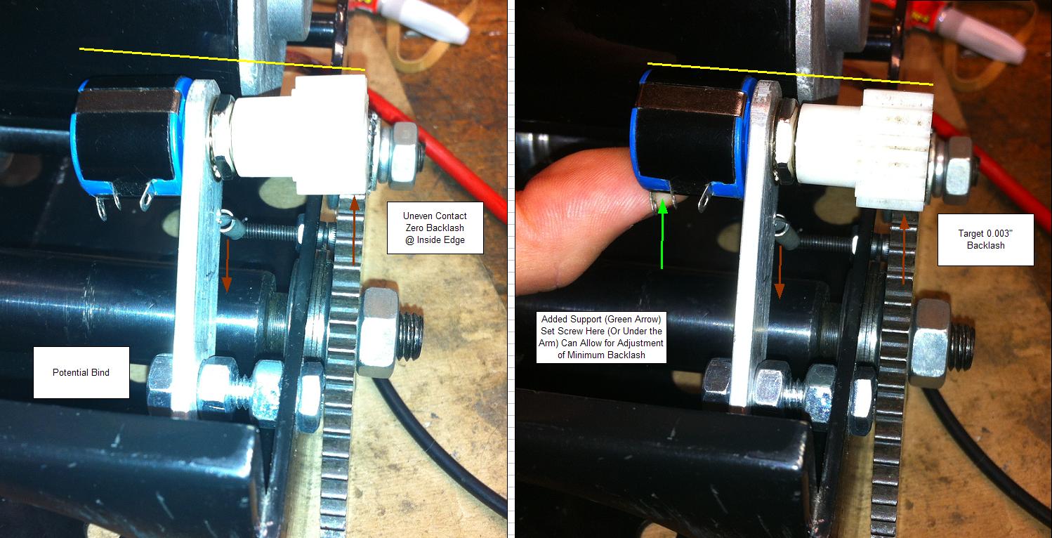

    Ok, here we go; I finished buffing the countertops and have to wait to get someone to help me load them this afternoon so I worked on my connection idea.
    Basically the shaft is 5/8" so I made an aluminum adapter for both gears which allows a good solid connection. But, since I did not want much sideforce on the potentiometer shaft from the gears I made a slide system where the tension against the shaft gear is created by a light duty spring. It should still give precision and accuracy and save my expensive pots.

    So the spring keeps tension on the gears? Nice design.
  7. Nick Moxley
    17,054Coins
    +2,504 / 30 / -2
    Interesting idea, Similar to Noorbeast setup but with a Free join and spring. VERY clever
  8. Historiker
    2,158
    9,176Coins
    +2,159 / 19 / -1
    I like this setup, it will allow me to adjust the position with the pot and then reengage it.

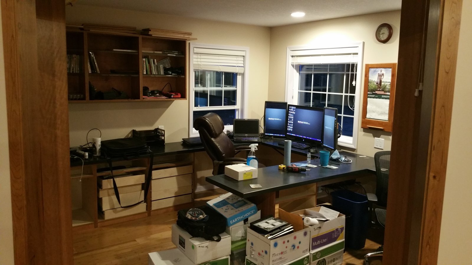

    So I needed a bench....so I built one. My wife has been anxious to have our home office completed so I got busy with the solid surface (acrylic) countertops and installed them today. After a year it is soooo good to have all three of my monitors back in operation. The entire right side of the room is my test bench! I should be able to tinker with the motor drivers tomorrow afternoon and I have all three winch motors converted and ready to connect to the motion platform :D

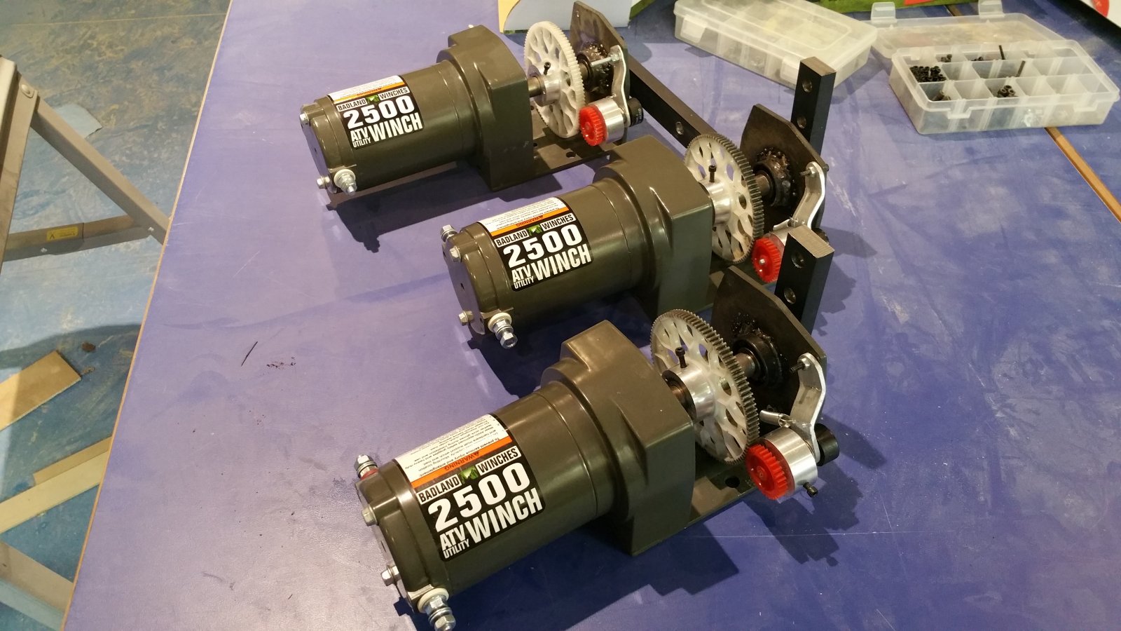

    So, here are the three little lovelies. All ready to be mounted on the sim. I still need to redo the electronics but I have six Pololu 755s (15amp motor controllers) sitting on the bench ready to be joined in pairs. Just need to think about my cooling options. I thought maybe I would buy CPU coolers and use my CNC to cut the bottoms to fit the mofsets on the motor drivers. This means a larger case so my Mr Fusion will have to go :(

    @Historiker, I can't tell from your pictures but you may want to consider a set screw to act a stop under the arm of the spring loaded Potentiometer. I was experimenting with your idea shown in the image below. A stop screw would allow you to set a minimum backlash so that the spring is not pulling the pot gear tight to the drive gear. A good target is about 0.003" between the gears (A sheet of paper can be fed between the gears to set the gap).
    • Useful Useful x 2
  18. Historiker
    2,158
    9,176Coins
    +2,159 / 19 / -1
    That is a great idea Scott, I had not thought about it. I used a light duty spring which doesn't create a very tight connection but a set screw would also be a good idea. Thanks for the tip.

    Had my first evening on the rebuilt rig. The planetary gear winches are louder than I thought they would be, even with extra grease packing but they should be really easy to enclose so that will take care of most of the noise. I like how compact they look compared to the old winches.
    Using two Pololu 755s per motor gives me 30A of power for each, they really shake the cheezwiz out of you :D
    Couple of problems that I have run into though;
    1. The traction loss motor has too much slop in it (luck of the draw I guess) and so bounces back and forth trying to center itself. I have tried increasing the dead zone in SMC3 to no avail. I will tinker with it some more later. Right now I just unpluged that motor.
    2. Motor 1 keeps dropping out after 10 minutes or so of hard use. It takes an Arduino reset to get it back online. I know that this issue has been brought up before but I cannot seem to find it on the forums. If anyone remembers please drop me a link.
