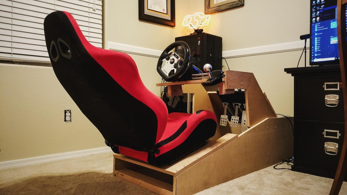

    Hey guys I've been a lurker for a while enjoying all the posts and trying to learn as much. I'm a mechanical engineer in real life, but have dabbled with embedded systems so very familiar with micro controllers and Arduinos.
    I have been sim racing for a while and have been wanting to get some sort of tactile feedback. My main goal is to simulate G-Forces as a driver would feel (to a lower magnitude of course) because of this I have decided to go with a seat mover. My current is below:
    My plan is to cut of the seat attachment and redo the design to accommodate motion. By utilizing a U-Joint under the seat.
    Currently I'm in the accumulation phase and I have the following ordered. I do not know how to weld so I'm still trying to figure out how I will be able to attach the push rods to the motor, I did see a post on where users could weld a bolt to a servo arm, but again I do not have access to a welder nor do I know how. Any advice would be helpful in this area.
    My Current Config.

    [​IMG] Got everything in the mail so day 1 started. Made some motor mounts out of a steel angle. Only had 3 hours today but got the motors mounted and the PSUs in place.

    Just finished her up this morning, first impressions are took a little time to understand simtools and get the "feeling" I wanted. Turned down the pitch and increased the roll. However, I seemed to have lost force feedback when shifting which kinda sucks. I'm guessing because I turned it down to far?
    Anyways here is a picture of the final result. Overall very happy, for my fist simulation rig.
