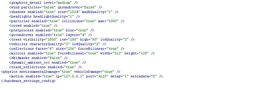

    For the Games Dirt and Grid it is easy - first you have to change the config file: own files - codemasters - Grid - hardwaresettings - hardware_settings_config.xml. You can open this file with the editor and change this; <motion enabled=false ip=127.0.0.1 port=20777 delay=1 to <motion enabled=true ip=127.0.0.1 port=4123 delay=1
    Now you start the profiler and the Force-Sender with the NeedForSpeed Plugin (Dont forget to give the Sender the IP of your profiler, if you dont have them at the same computer), the game and you will get the data's. No yoda need :D

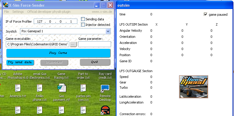

    Hi here are my setting in the grid file and one print screen of the sender you can see always is paused and I did all that you say thank you.
    Charly.

    Please consider that Yoda is a Force-Feedback Scanner, and the Force-Sender LFS-plugin and LFS-outsim do output game-memory offsets.
    These are different approaches to get game data.
    The LFS plugin is totally off-topic in this thread, as the topic title is Yoda Scanner.
    To keep it on topic here, we should try to find out, why Yoda2 is not working on your system. Is Yoda1 working on your system?
    Once again, please describe your steps, with X-Sim and NFS MW!
    Number them (1,2,...)!
    1. Starting Yoda
    2. ....
    If you wont give us more info, we cannot help you.

    The yoda2 is working now but when I start the post I say that the Grid didn't work and Martin talk me change one file in the grid that I did but now Martin you say that I have to change 2 file let me what exactly I have to change thank you I attac my grid page with file changed but only one.
    Charly

    I have downloaded the Demo of grid and did the test. It work also with the demo. And as you know now, you dont need Yoda for the latest codemaster games (Dirt, Grid). You have only to change one file to make it work, forget the other thad i sayd. But you have to know there are two config files: one in the Game directorie and one in your own data directorie (same name, same look). The change of the file in the game directory doesnt have an effect! So be shure you pike'd the right one (or change bouth ;-) )
    :cheers:
    Martin
