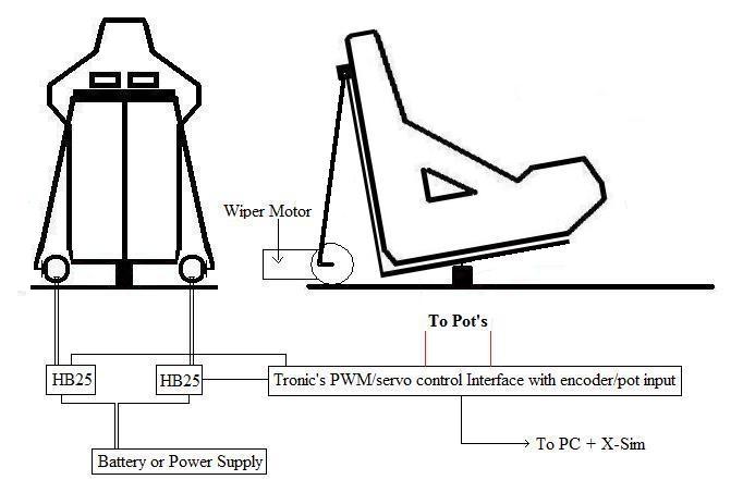

    In anticipation of “Tronic's PWM/servo control Interface with encoder/pot input” I have decided to try to build a frex type setup driven by simple wiper motors.
    I’m really only at the stage of collecting the parts and trying to put together my plans for the chair.
    update:
    http://www.youtube.com/watch?v=TnR0C7ENzIw
    Here are some Ideas / pic I have come up with..
    From what I can see, I will need at least:
    1 VN2 Dual Motor or HB25’s
    2 Wind shield wiper motors
    1 Tronic’s PWM servo Controller
    1 12v car battery and a way to charge it
    This covers the materials needed to make it move not including pot’s or frame / chair.

    421Coins
    +10 / 1 / -0
    @yobuddy
    Please edit my sketch and remove the pots!
    I dont want anyone to make this mistake once again.
    The encoders or rotary pots have to be mounted directly to the motors. Take a look at EvanF's pot mount.

    Hi yobuddy
    Looks good!
    But, are you sure are you going to drive the cockpit directly from the wiper motors? I believe they might be weak to lift the weight as fast as they will lower it. Maybe you should add to your design some bungee cords that counterbalance the main weight and help a little the motors. And a small simple pulley system will add more motion distance.
    See a picture from Roland's design (http://www.simprojects.nl) that did something simular to his simulator:
    (ignore the lower part of the picture)
    Regards, Thanos

    Dont mention. They are strong enough. The seat is balanced out. Just for comparison: The SCN5 have 10kgf max.
    For lift movments both actuators have to move which results in 2times the force of one wiper motor.
    To build such a bunjee cord system would be waste of time Imho.

    @tronicgr – I don’t believe the motors will have a hard time running the chair directly,
    because most of the weight of the rider will be transferred to the pivot point under the chair,
    so all the motors really have to do is move the chair around.
    And like ego said, there are two motors working for every action of the simulator, which results in twice the force.
